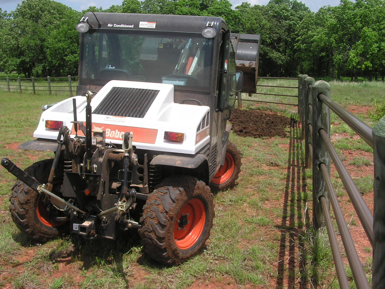

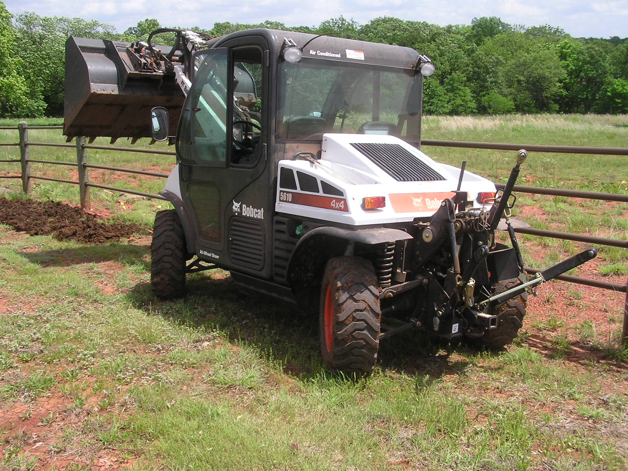

and the real gem #3. Crab steering. You had to have wheels straight ahead to change modes, but you could get right up next to a wall if you wanted to, pop it into crab steering and both front and rear wheels would turn the same way so you could get away from a wall that was only a few inches next to you. That was a lifesaver in a few situations.
The Toolcat has manual crab steering, very handy:

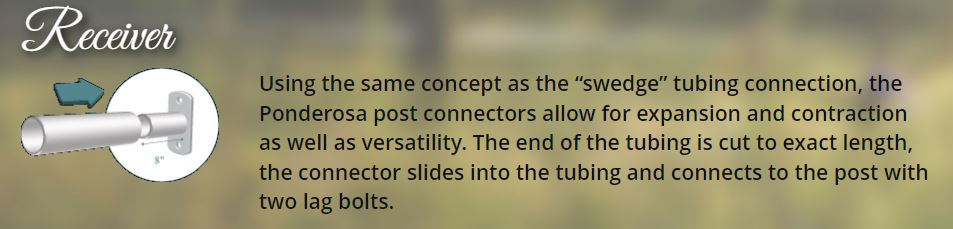

Nice pics of the crab capability of the Toolcat - my question is about the fence. That's a fine looking fence with painted metal rails thru the posts, and round tops.
Is this fence/post/rail something that was fabbed by you or purchased components? Also I see the end's/corner are welded flanged then lagged?
Looks to be about 5' high, 7' posts? Length of each run of metal 20'? Did you paint? How was the assembly done/connecting the rails - welding or sleeves? Rough cost Per Linear Ft?

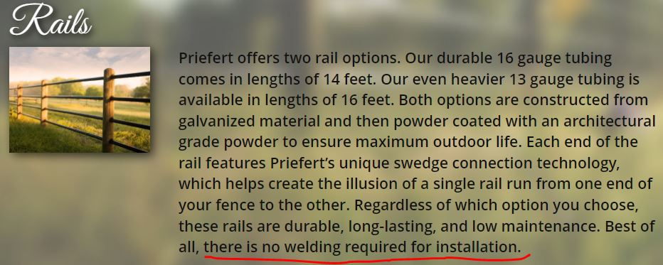

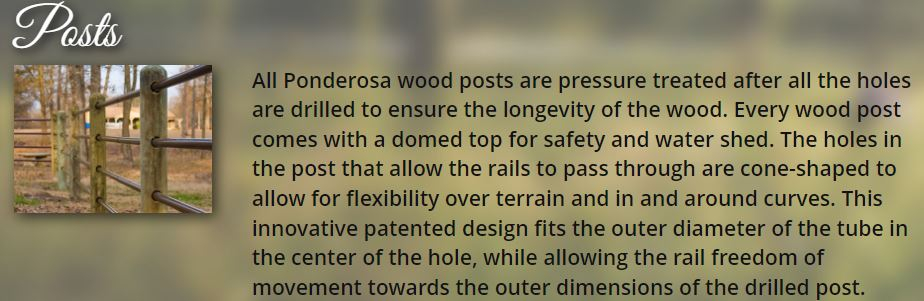

Purchased in 2011. Priefert’s Ponderosa Fence: Priefert Fence | Fencing

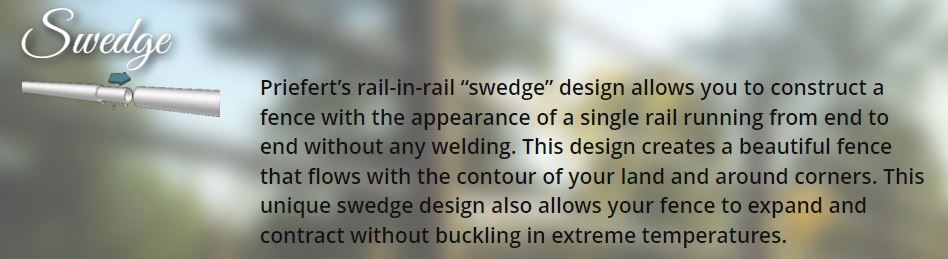

No welding:
