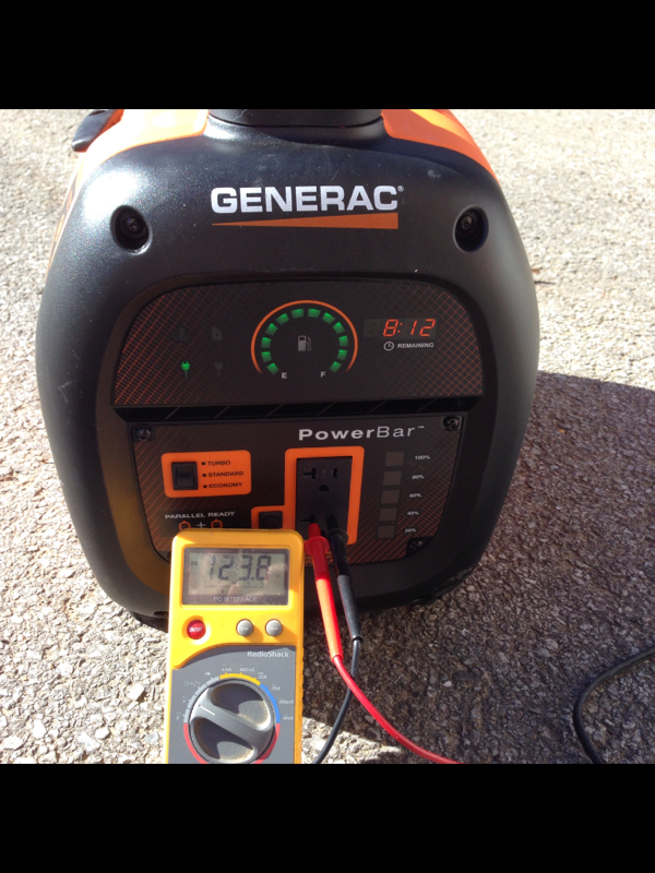

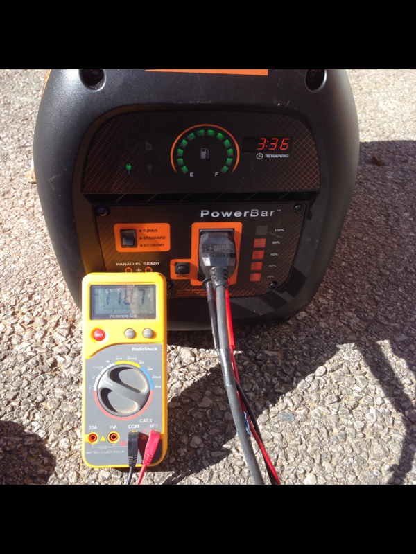

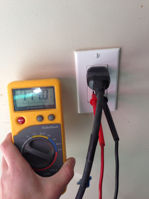

I went outside and tested my Generac generator. It runs amazingly constant, but doesn't handle high start up loads well. It runs with about 1 volt either way of variation which is pretty darn good for a generator. It puts out about 123 volts under no load. Under 80% load which was a 1500 watt heat gun it maintains about 119 volts. My house outlets maintained 117 volts with the same load and about 125 volts under no load. What kills the electronics was start up voltage. The generator dropped to about 110 volts by unplugging and plugging the heat gun up. That is acceptable, so I decided to try a miter saw. This miter saw was rated to pull 10 amps, but start up must have been much greater. My generator is rated to produce a tad over 13 amps continues. Starting the miter saw dropped the generator down to about 40 volts. After about 3 attempts to start it it tripped the overload on the generator. I have a cheap, extremely loud 3,500 watt generator that I'm going to test later. The miter saw dropped the house outlet down to about 100 volts. We recently ran the house for about 5 days with a 8,000 watt welder/generator that had about 10 volts variation. It was loud and very thirsty.
Older consumer level generators used to come with Tables in the Owner's Manual, that gave listings of typical motor Running watts and Starting watts. Startup takes way more power than many people realize.
In an extended outage, the odds keep creeping up that with a fridge, sump pump, freezer.... connected, you may have a chance alignment where more than one motor tries to start at the same time. Makes upsizing a gen or a solution like 90cummins is using attractive (4kw inverter w. Gen assist).
IMO any well designed consumer product should be able to handle short-term brownouts (a reality with some grid connections too), but it's nothing I like to push my luck on - I bought a 7kw gen last time.
Size up your loads, add at least 25%, then buy the quietest generator that fits your budget is what I suggest to real-world friends.
