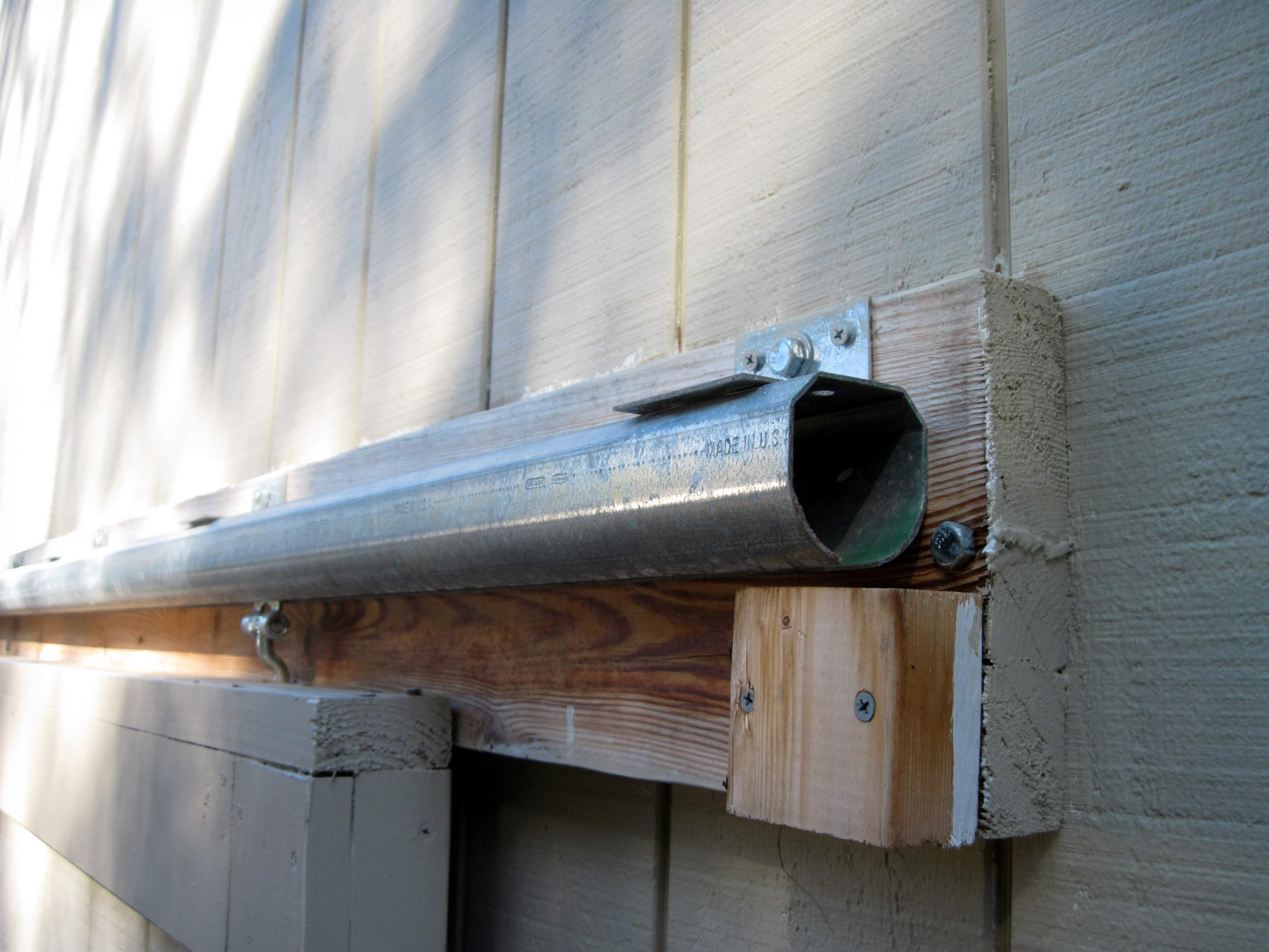

Wow, great pictures (I had no trouble viewing them, by the way). Who made your horse stalls? They are really nice, I like that "arch" at the top of the doors.

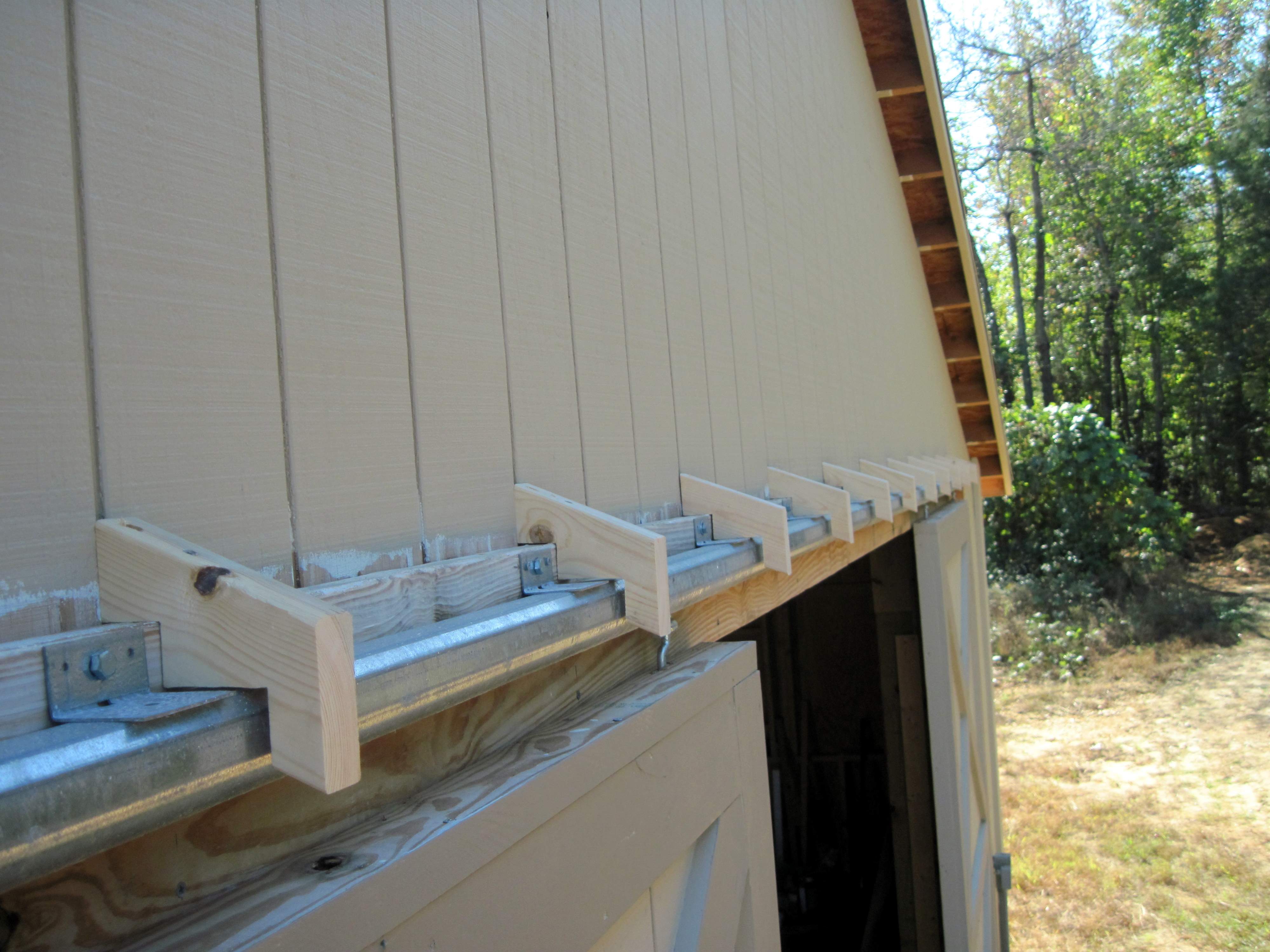

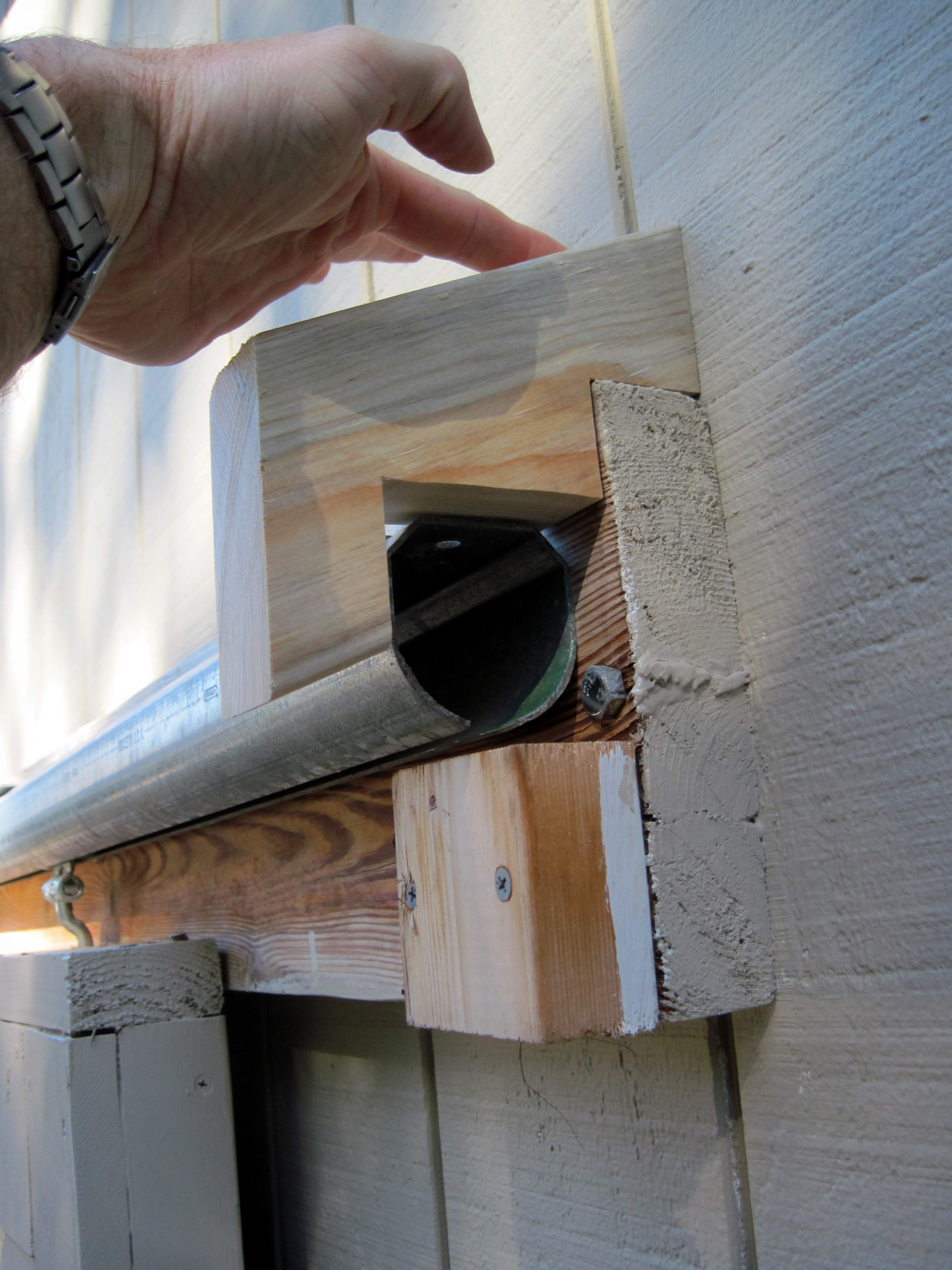

Very neat idea on the stay roller issue for the exterior barn doors, looks like it works well. Always looking for new and innovative ideas, thanks.

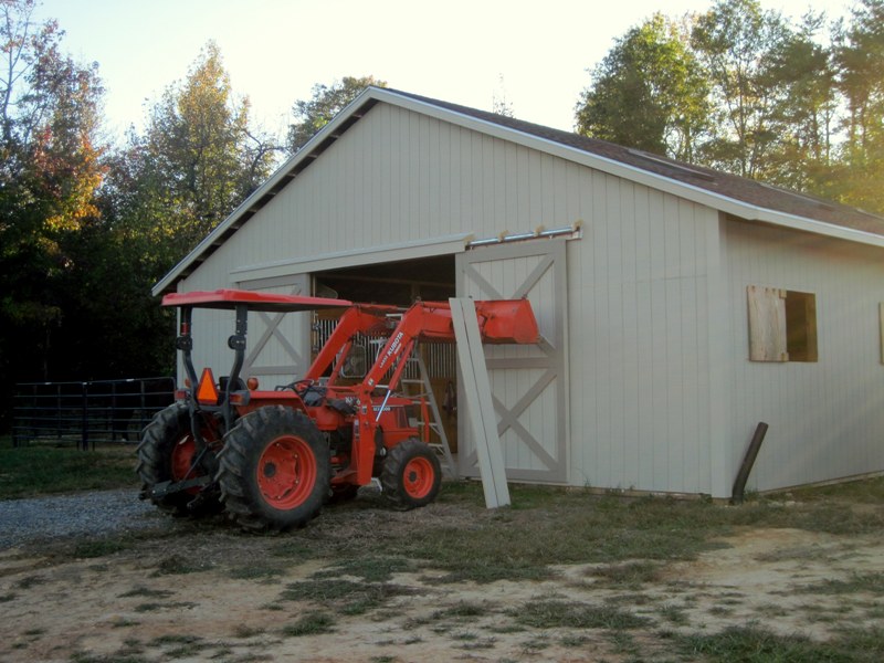

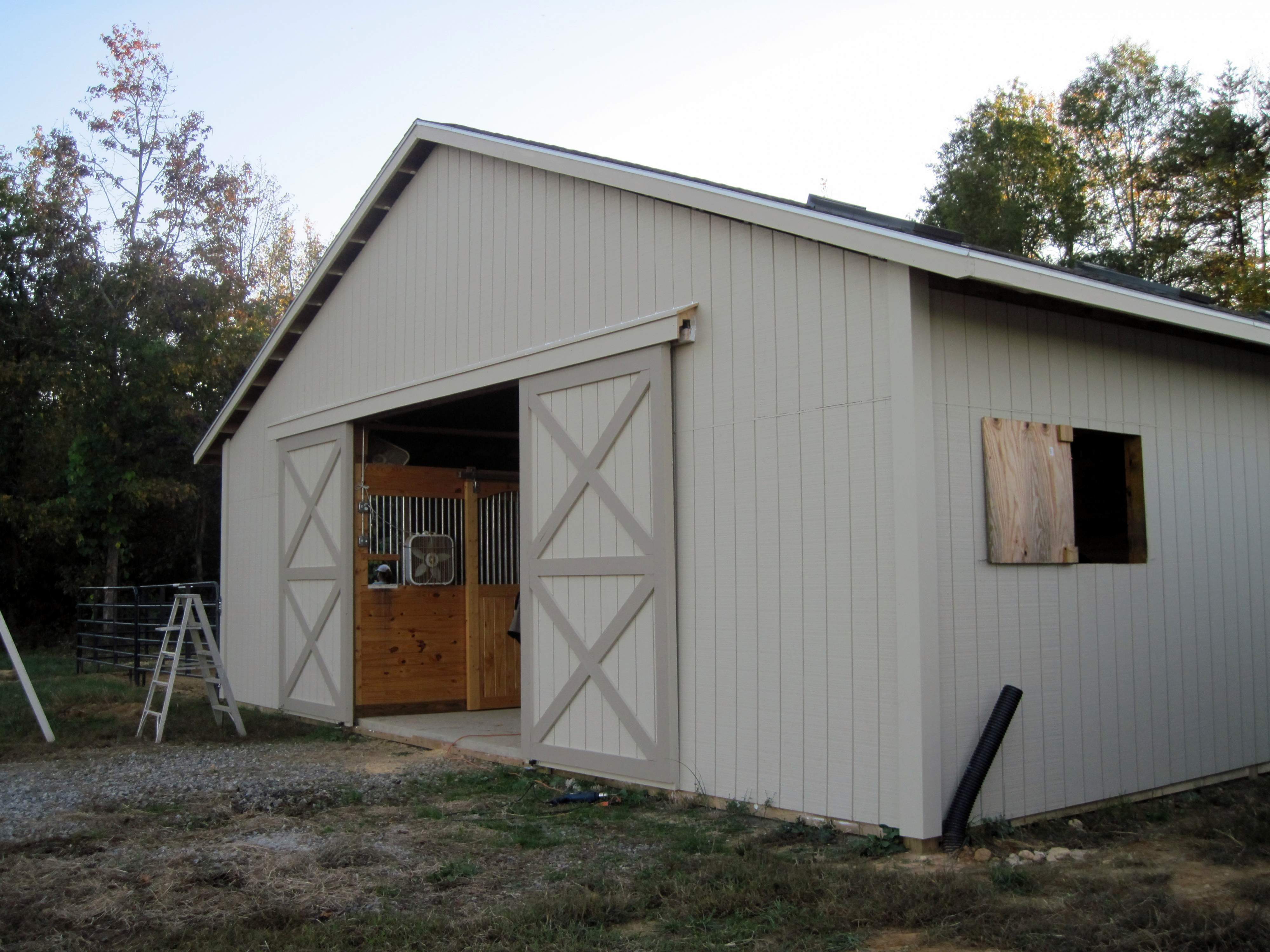

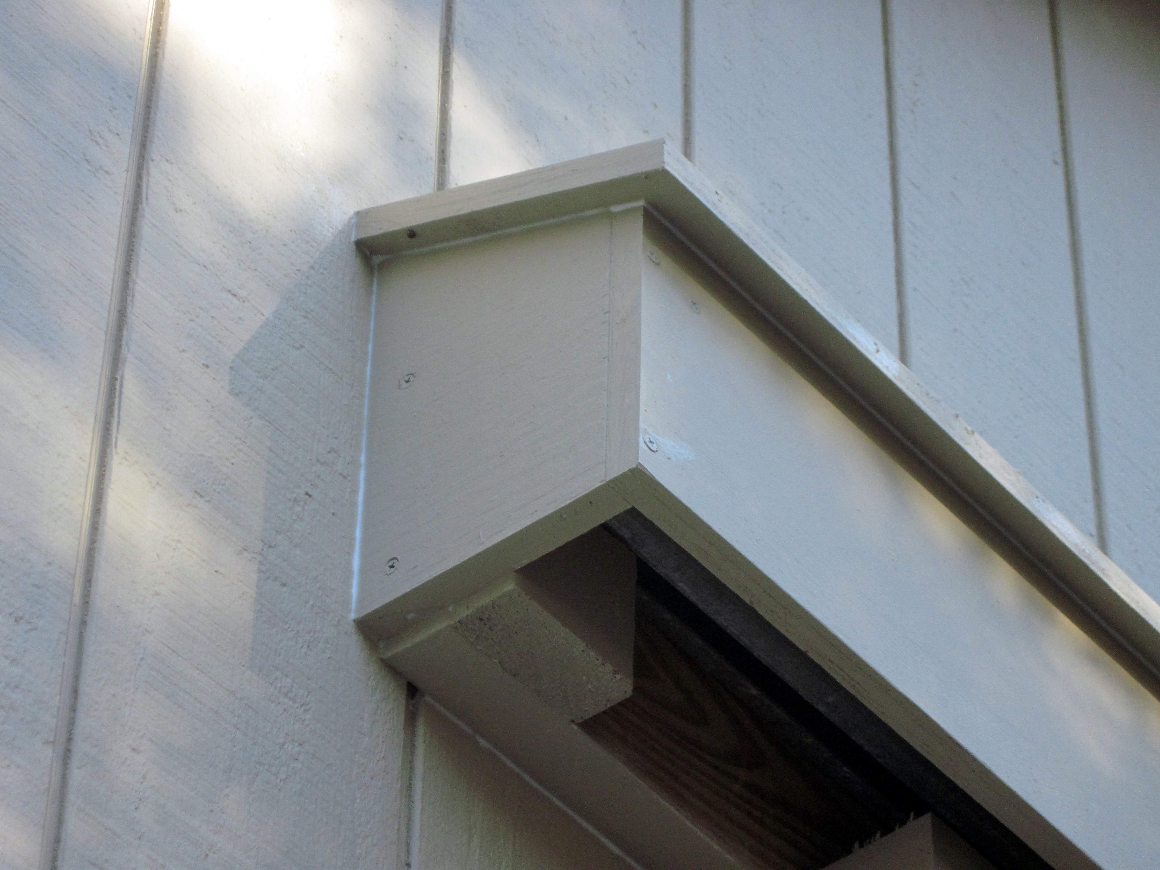

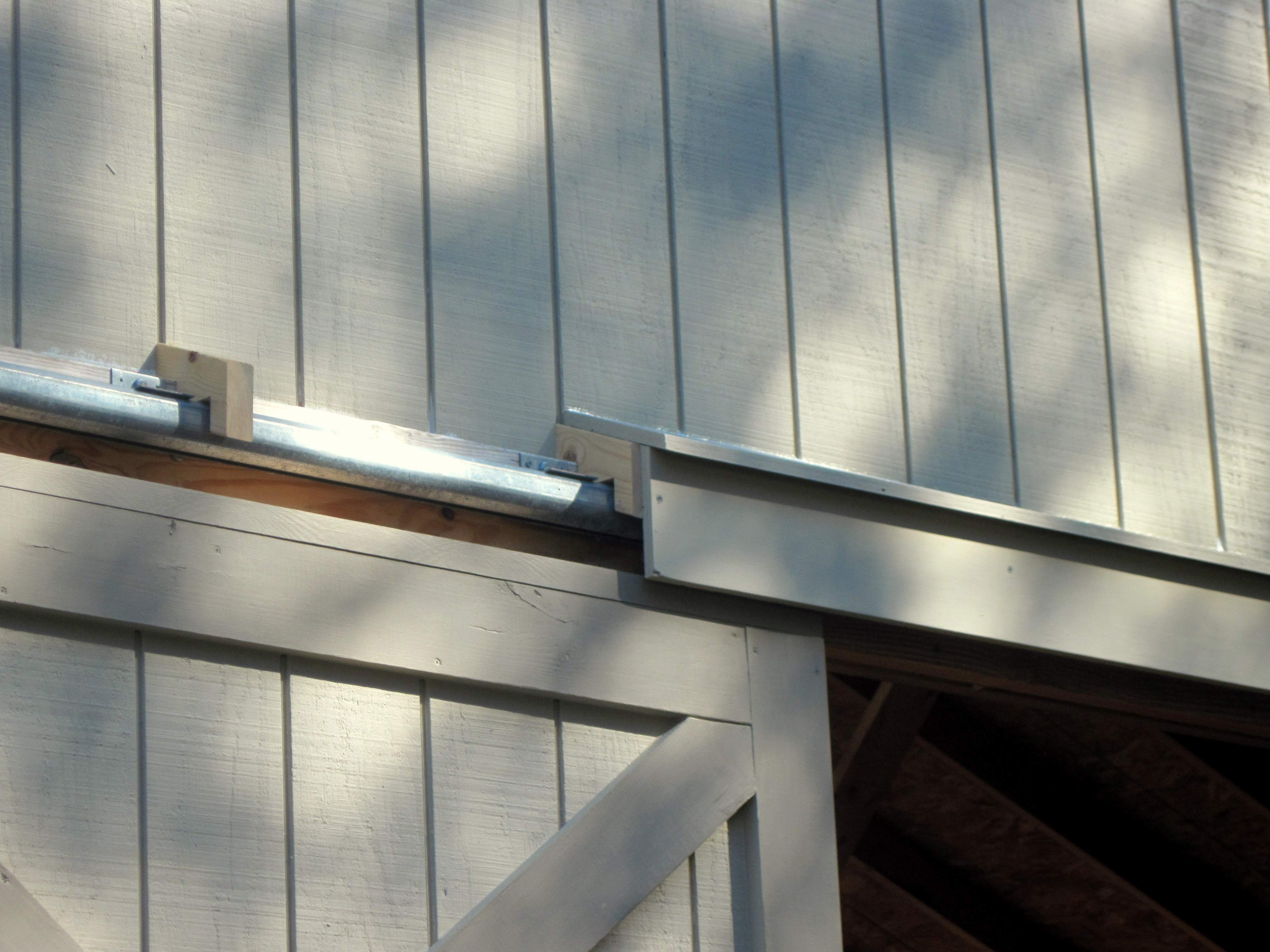

Step 20: Pent roofs.
In case you're not familiar with the terminology, a pent roof is a small shed-style roof projecting out from the side of a building, usually over window or door openings. I needed to add pent roofs over the sliding doors on either end of the barn to make sure that water running down the wall would not run behind the doors and inside the barn.
I didn't do anything particularly fancy here. If I had planned properly, I would have framed and built these before sheathing the barn so that I could have run flashing up underneath the T1-11. However, having never done this before, it didn't occur to me at the time.
I cut support brackets for the pent roofs and attached them through the T1-11 to the studs. Then I applied the roof and facia, which I made out of exterior AC plywood. I prepainted everything on the ground so that I wouldn't have to worry about dripping paint or primer onto the doors or walls below. Once everything was screwed in place, I caulked the heck out of it where it meets the wall of the barn.
As always, here are some pictures. To keep them from displaying too wide, I've attached two versions of each - one at 800x600 and one at the full 4000x3000. Only the smaller versions are included inline with the text. If you want to see the full-resolution versions, they're the first nine attachments at the bottom.

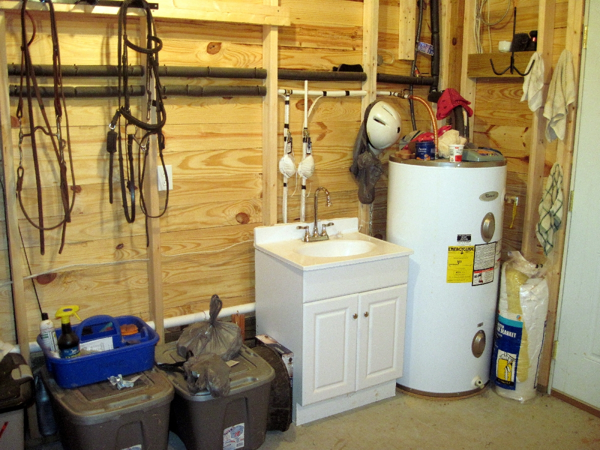

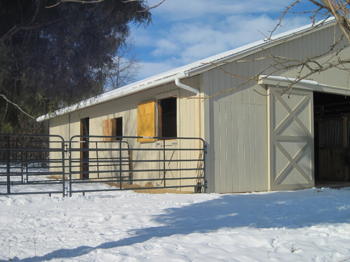

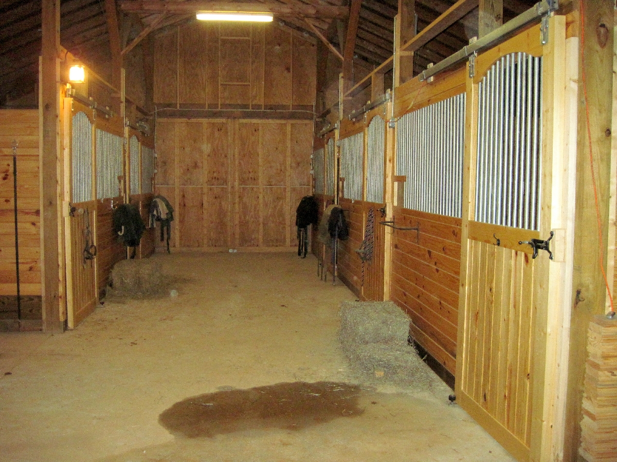

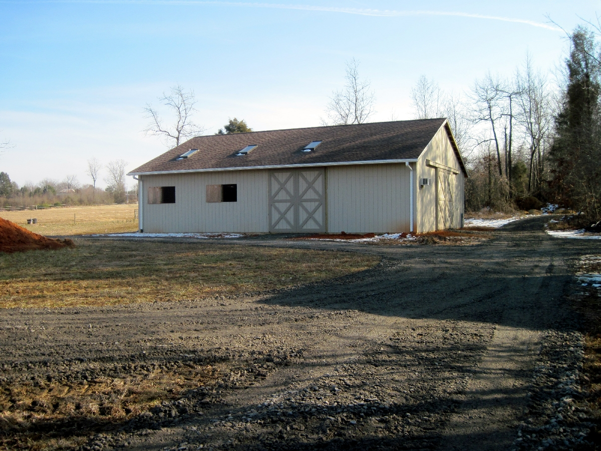

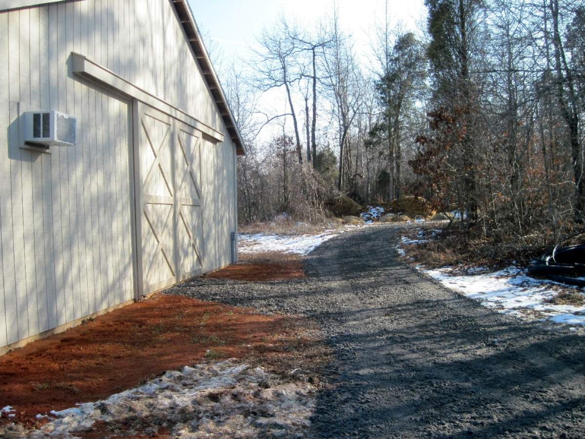

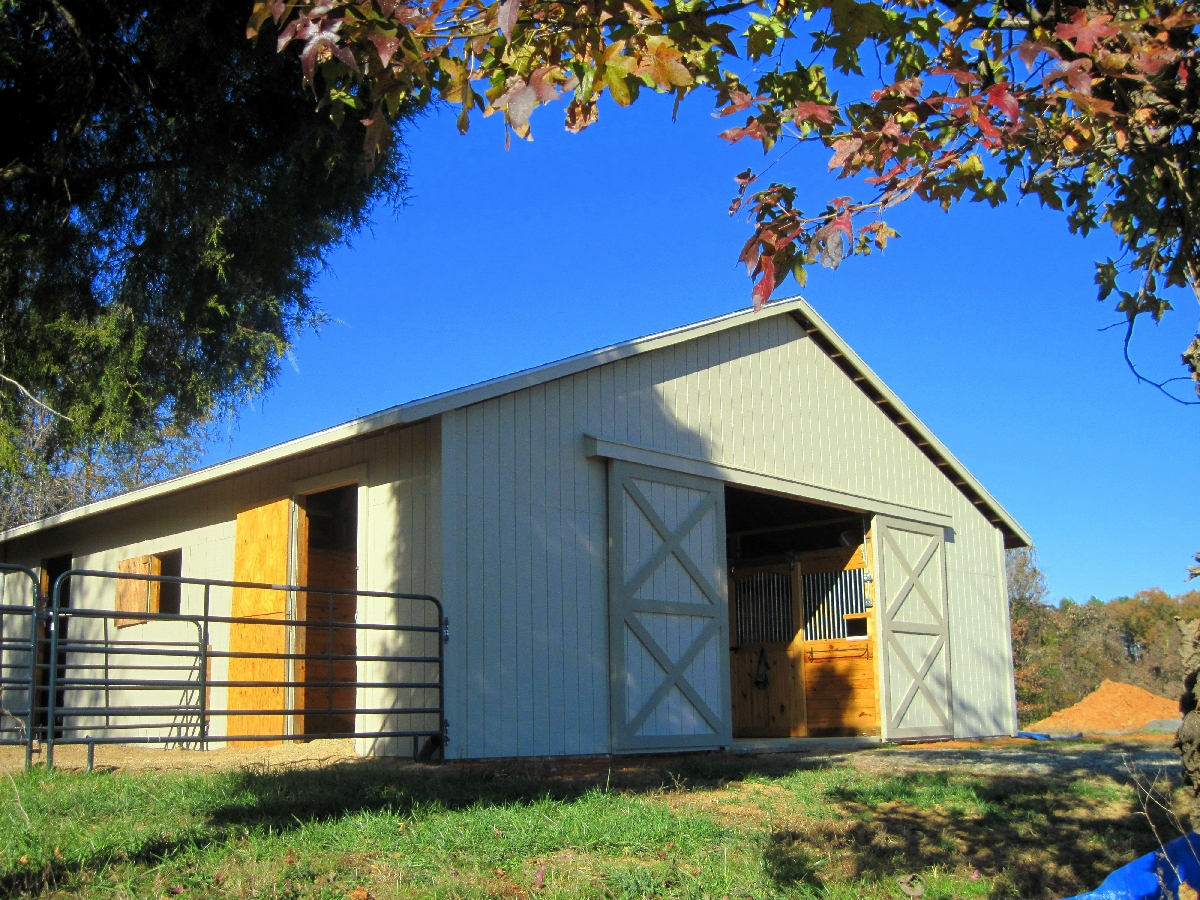

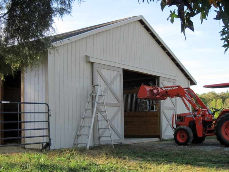

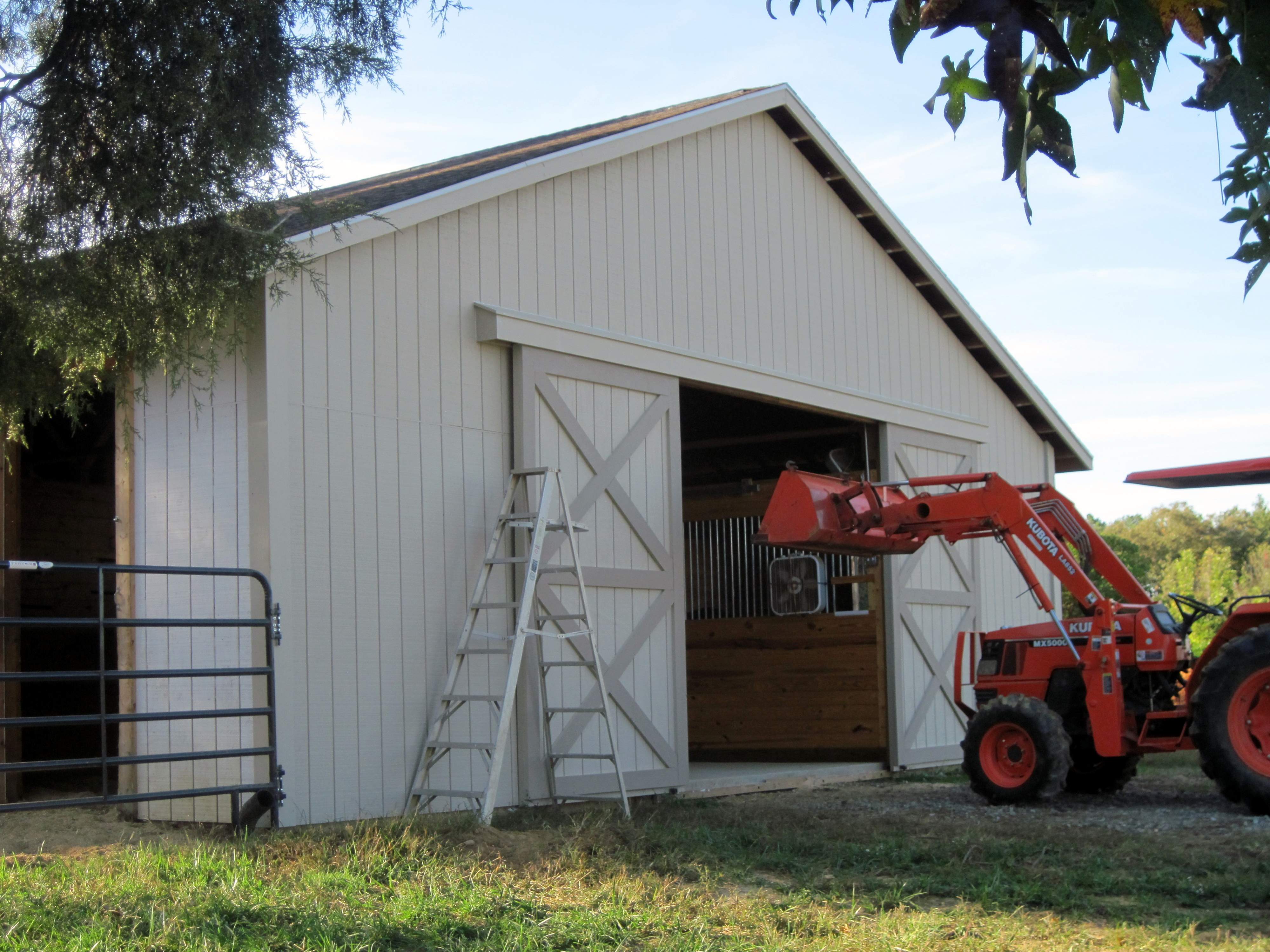

It's been a while since I've posted any updates here. 18 months since I started, and the barn is almost finished (though it's been functional for quite some time now).
Here are some of my accomplishments in the last few months:
I got the last two stalls finished and ready for horses. One of them is now occupied by a boarder.

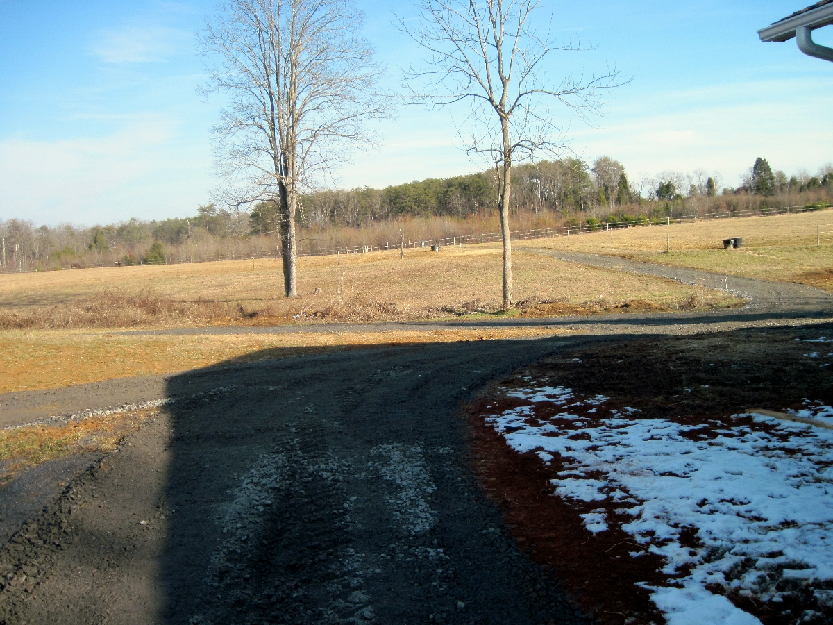

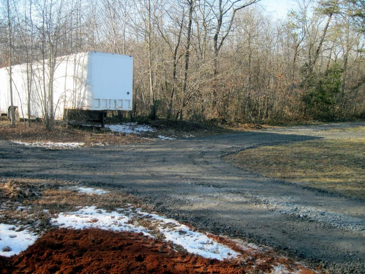

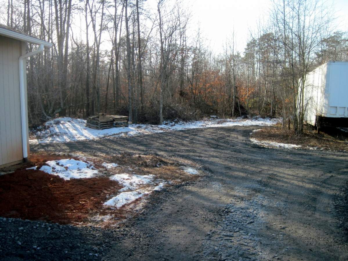

I finally got the gutters done, so no more mud splashing up on the siding when it rains (though there are still some mud stains that need to be scrubbed off). I priced out the materials to do it myself - around $300. Then I called around and got some quotes for seamless gutters - around $300. Seemed to be a no-brainer. Other than pouring the slab, that's the only other step I haven't done myself.

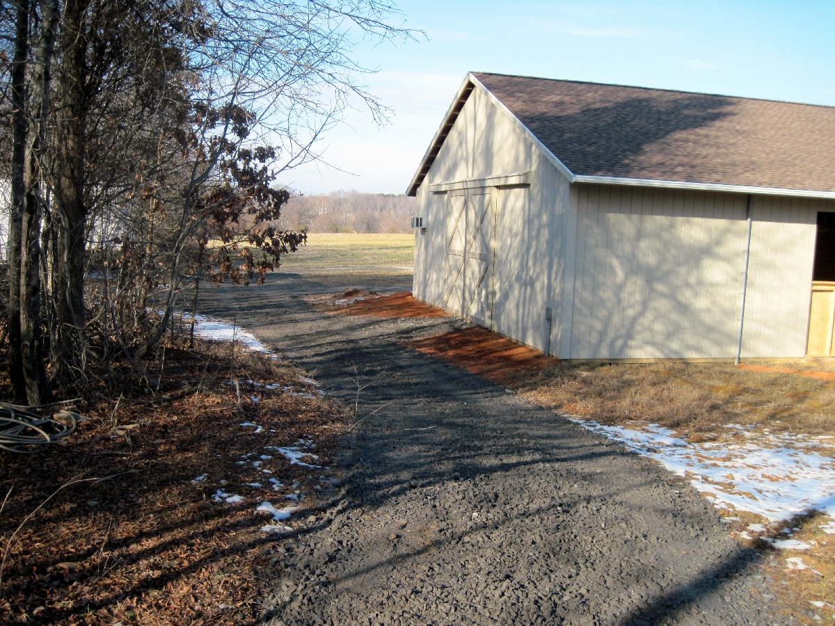

I got the various driveways around the barn finished. That includes a big loop to be able to turn around horse trailers, a parking pad for boarders and visitors, driveways to the hay shed and manure pile, and a separate parking pad for our horse trailer. It took five loads of crusher run, most of which had to be spread with my tractor since it was too muddy for the dumptruck to dump-and-run.
I also got the sink plumbed in the tack room, loads of hardware hung in various places (blanket racks, saddle racks, bridle hooks, etc., etc.), the heat tape wired up, the outdoor outlets in the pastures working (along with trough de-icers), and most of the indoor electrical work finished.
Here are some recent pictures:
