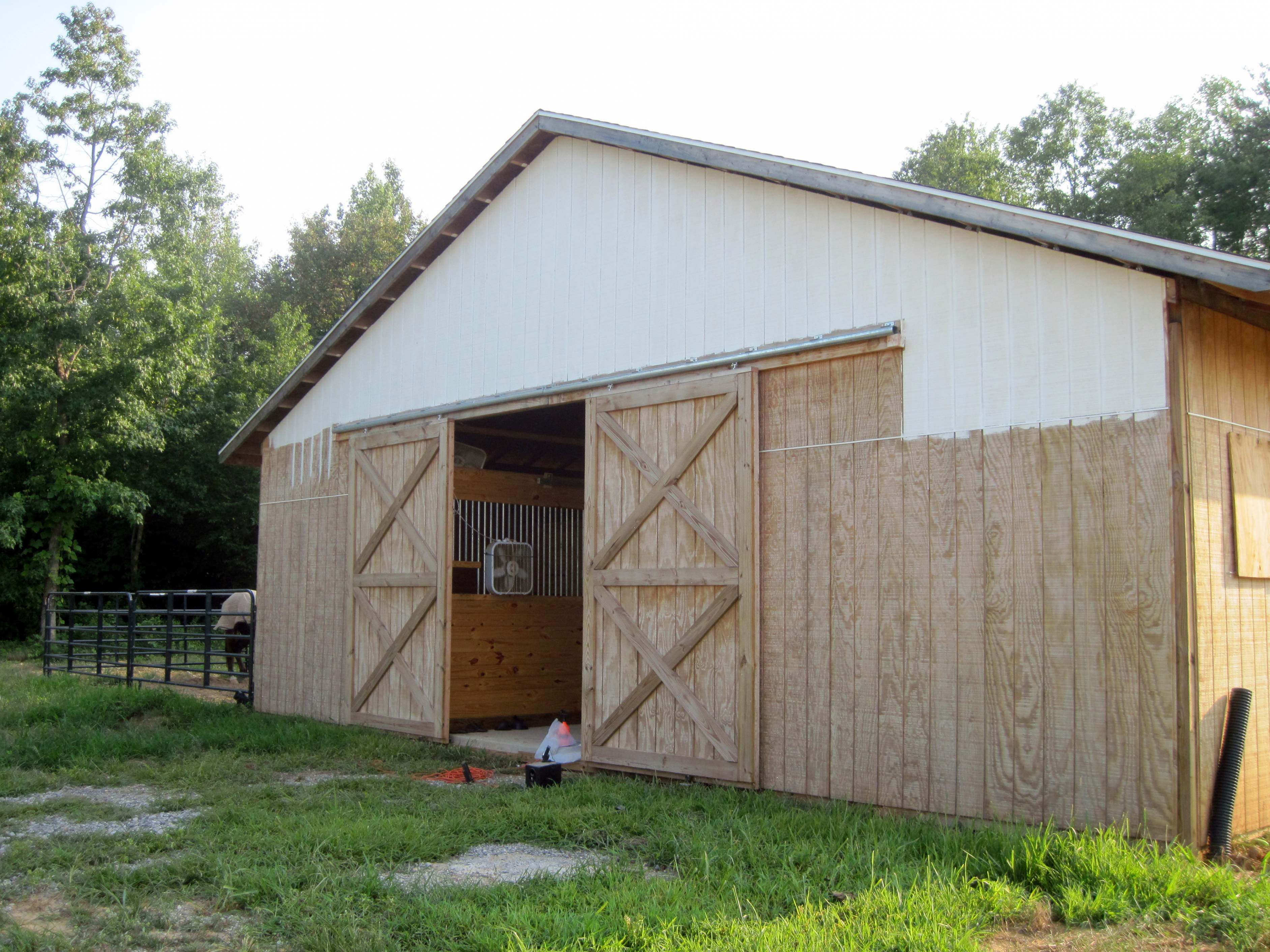

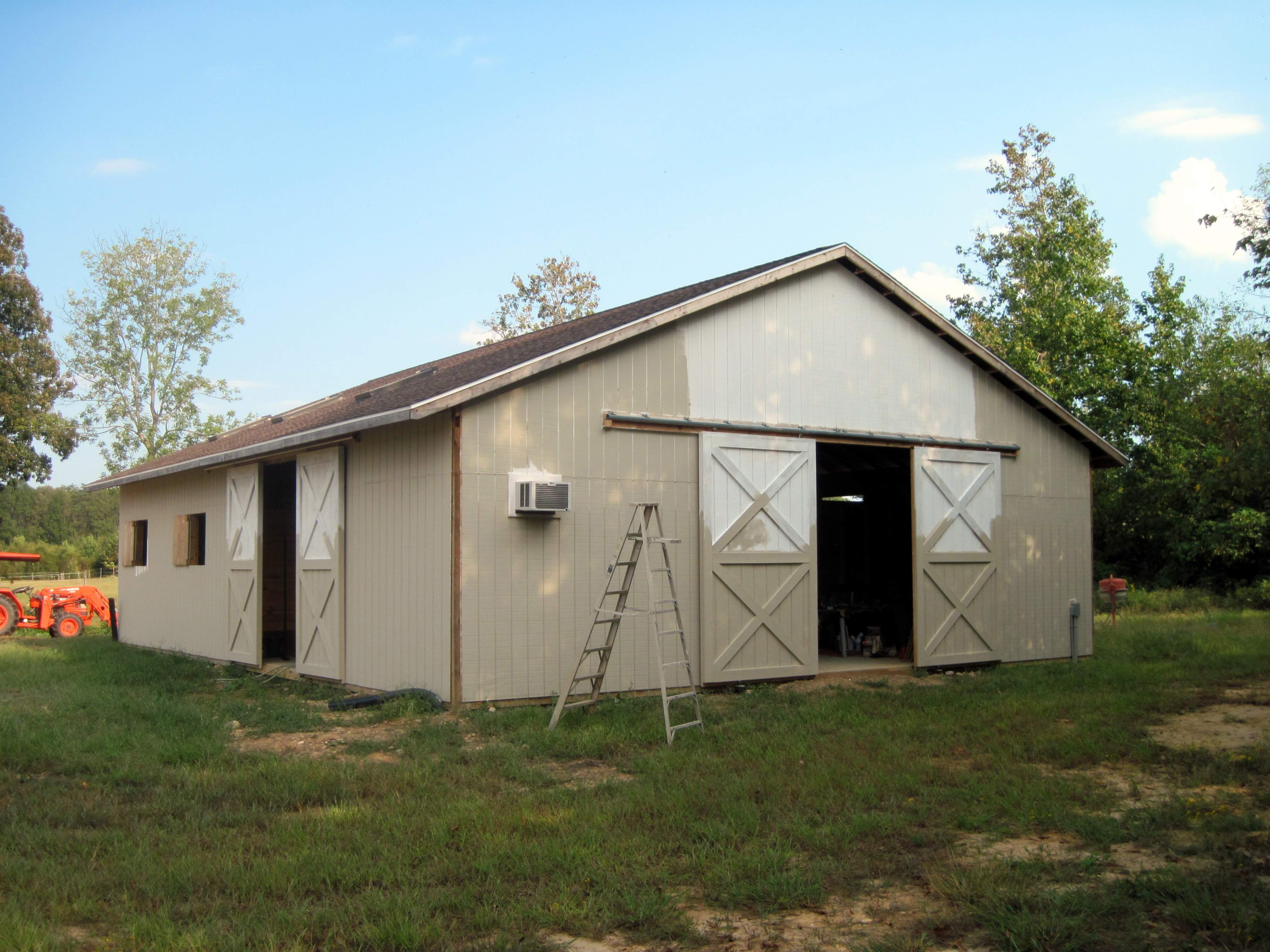

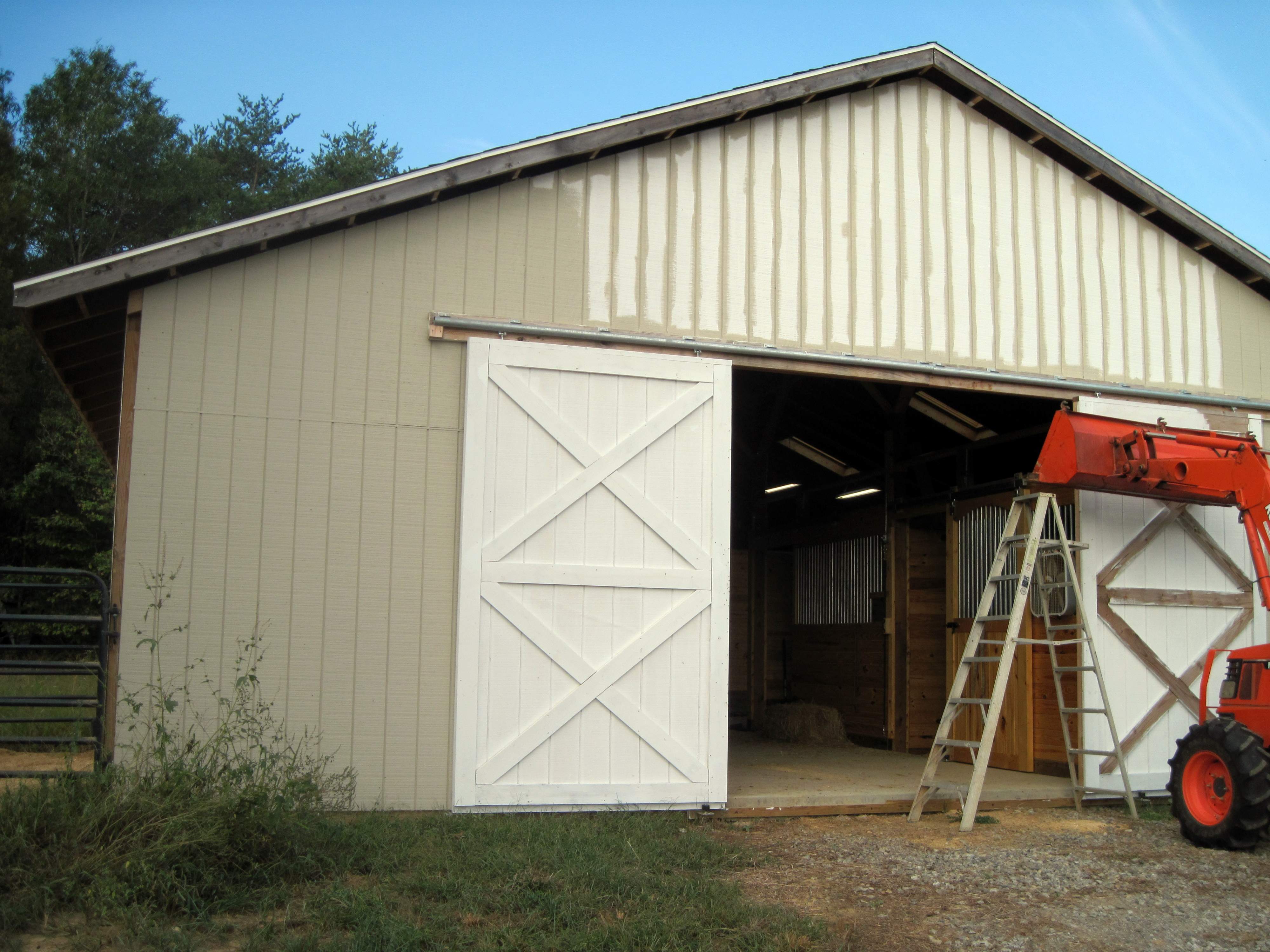

Here are some pictures of the progress:

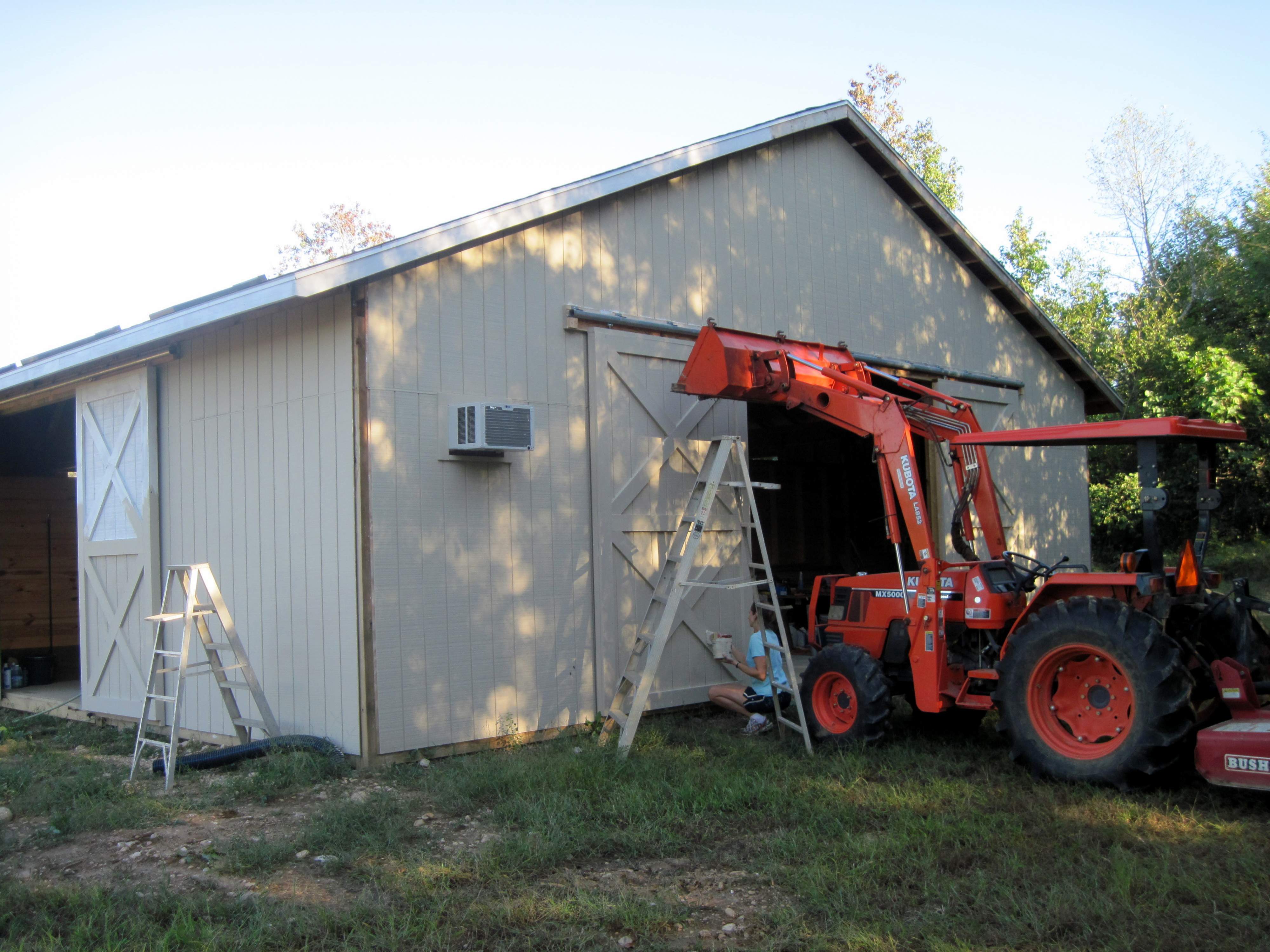

The priming done up high on one of the gable ends.
attachment.php
The priming all done and most of the first coat of paint on one of the gable ends.
attachment.php

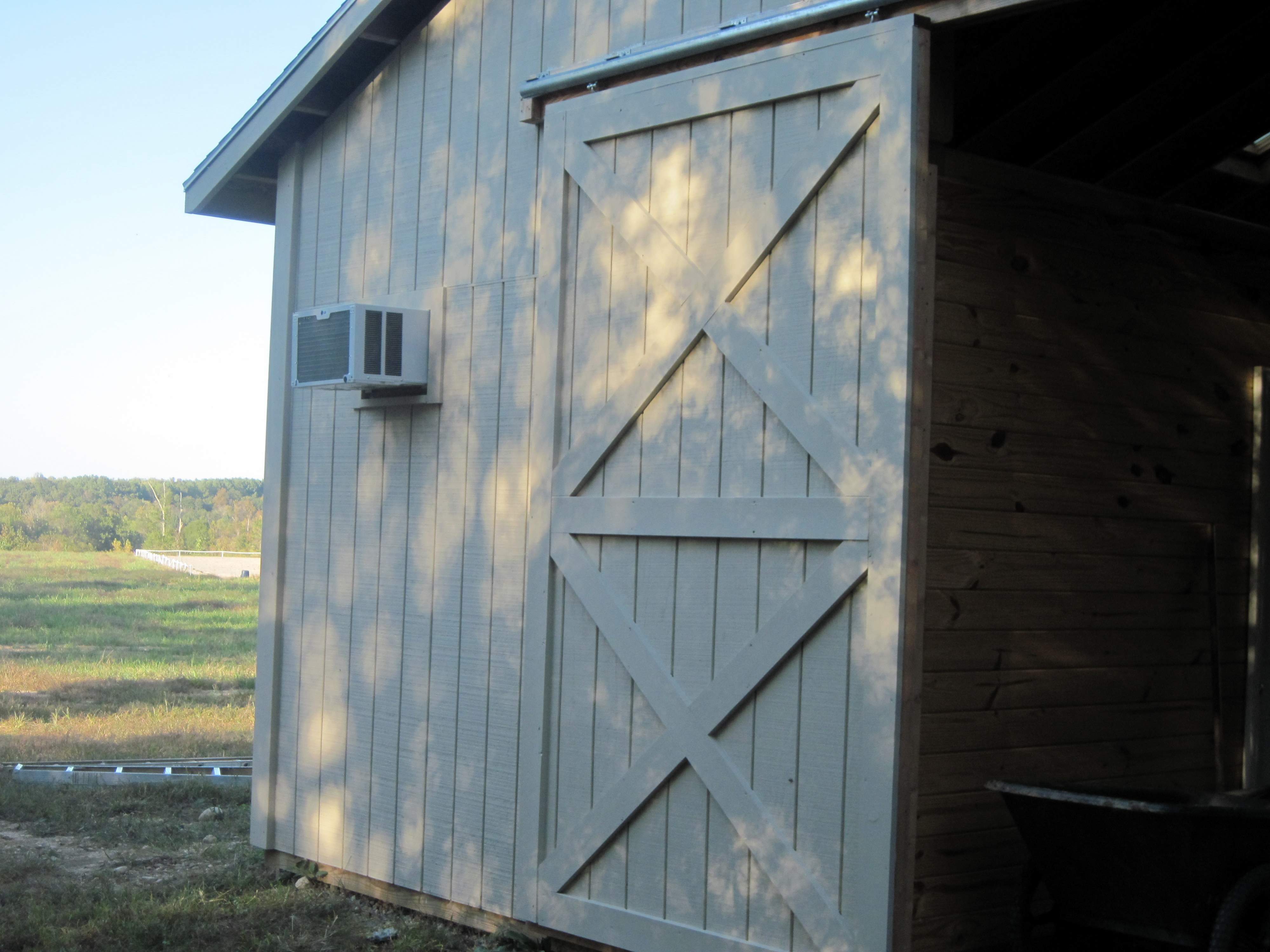

The opposite wall with the AC unit sticking out on the left.
attachment.php

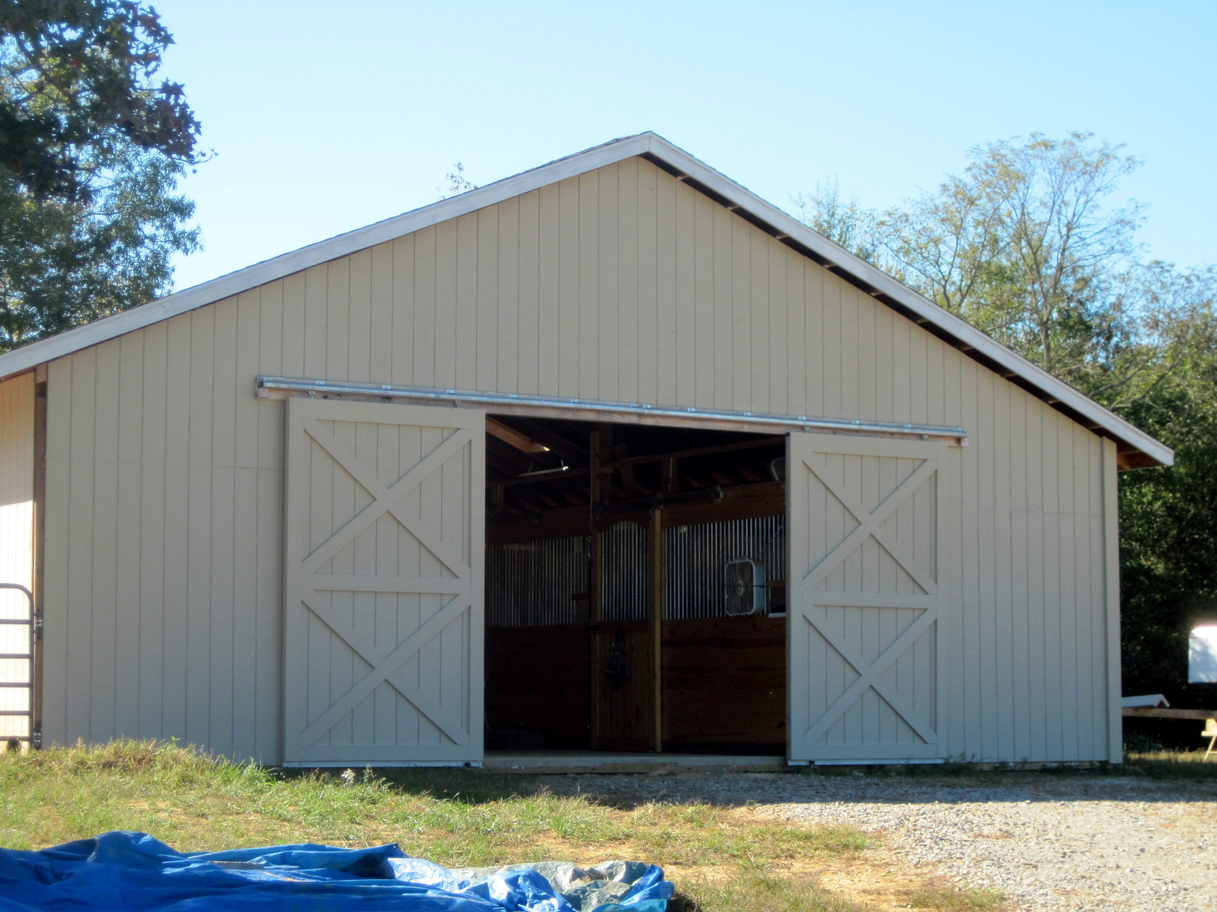

The front of the barn with a full coat of paint.
attachment.php

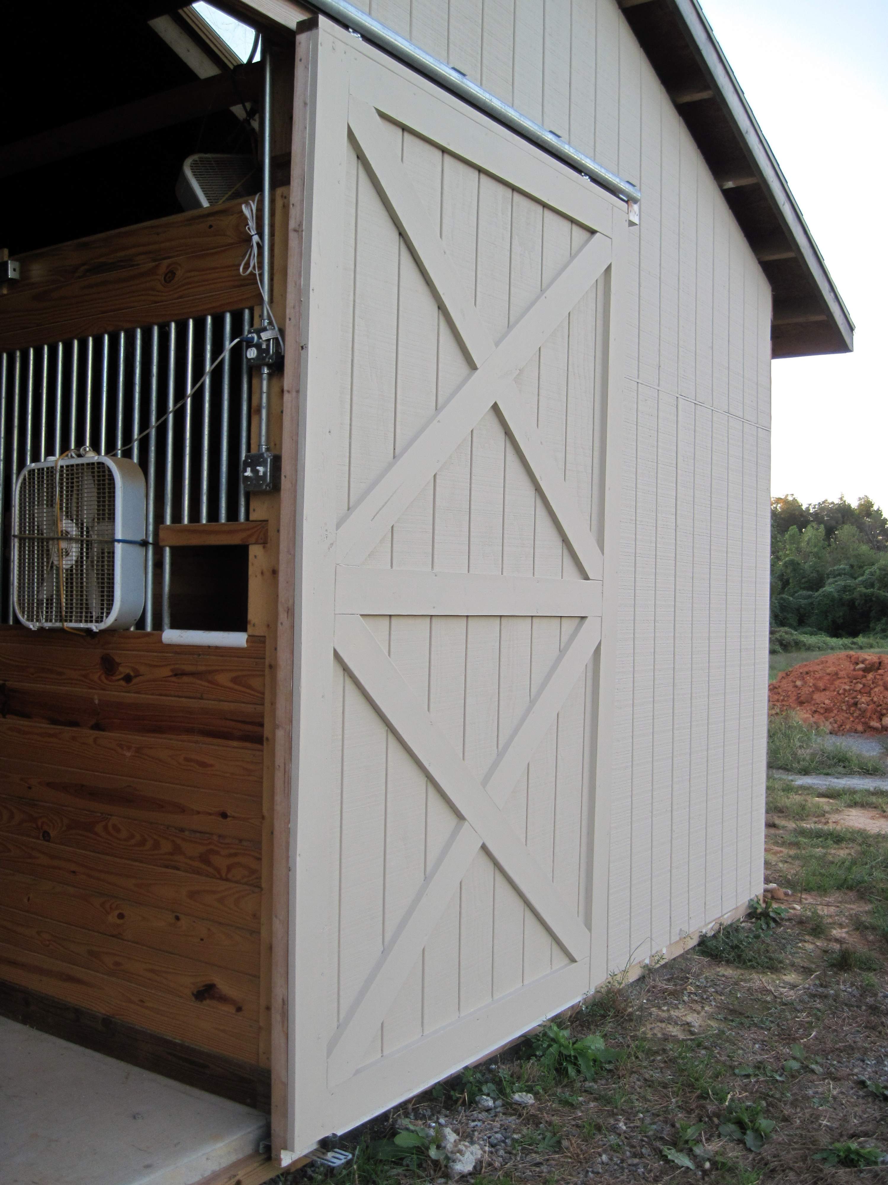

One of the front doors with its first coat of paint. Eventually the crossbucks and perimeter will be a different color.
attachment.php
The wife painting one of the rear doors.
attachment.php

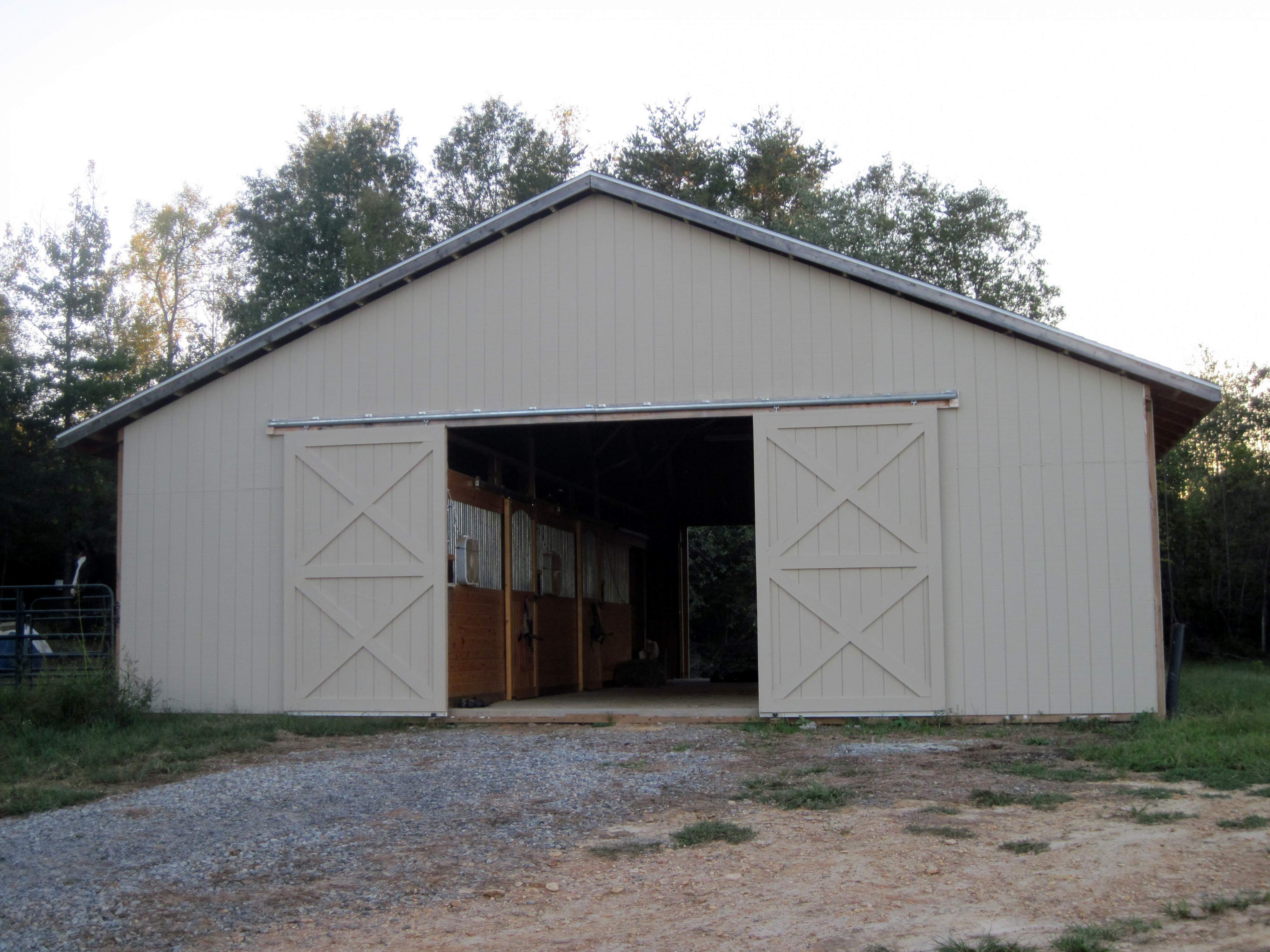

The front of the barn with the facia primed and the post and T1-11 edges covered up with trim on the right corner (I have to temporarily disassemble the paddock fence to do the opposite corner).
attachment.php

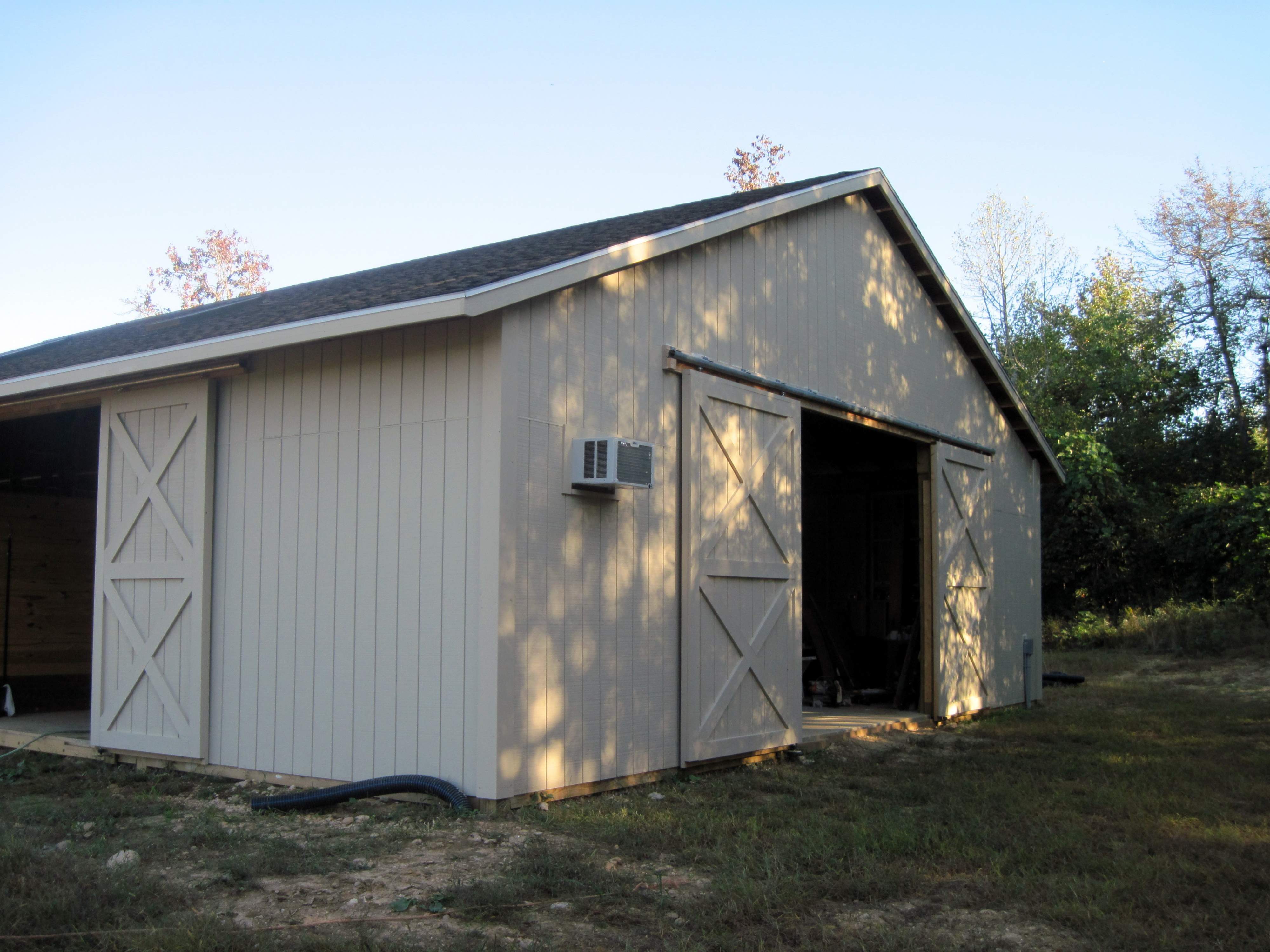

The back side of the barn with corner trim installed and the facia boards painted.
attachment.php
One of the back doors with the AC unit sticking out of the tack room wall and the riding arena in the background.
attachment.php
