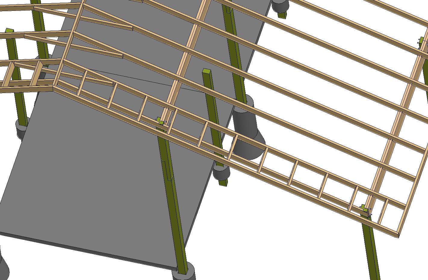

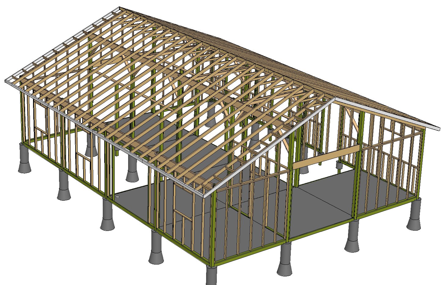

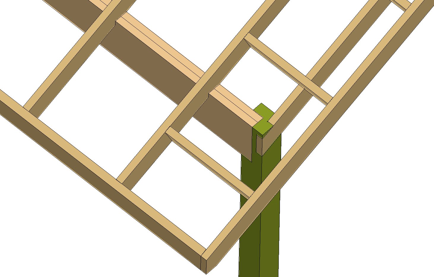

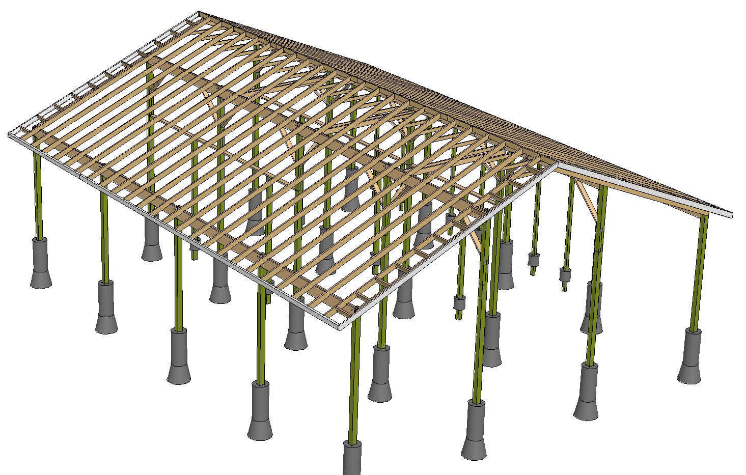

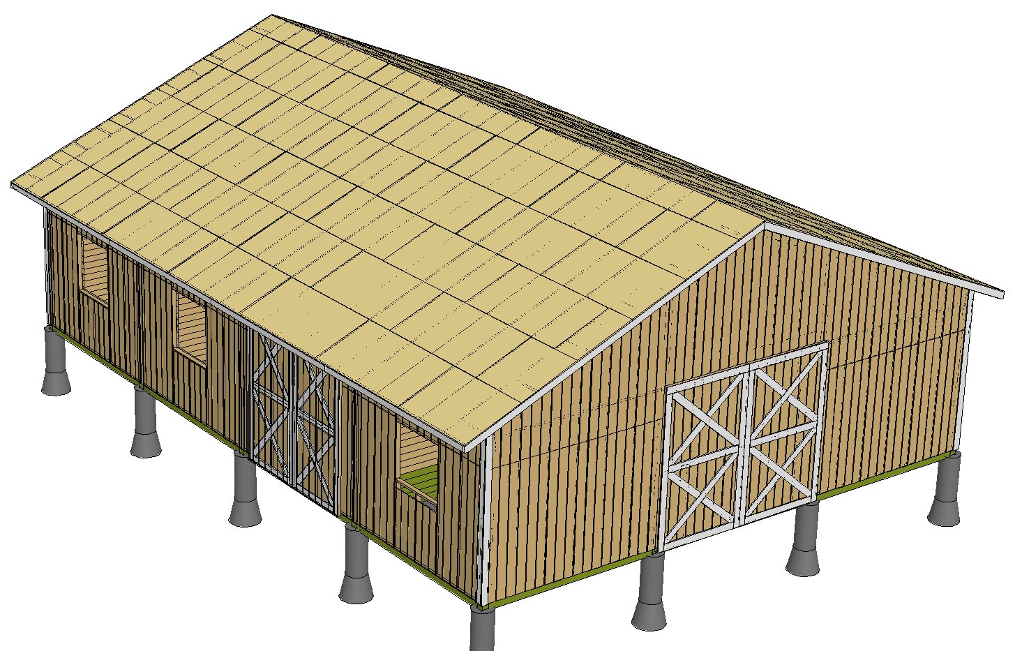

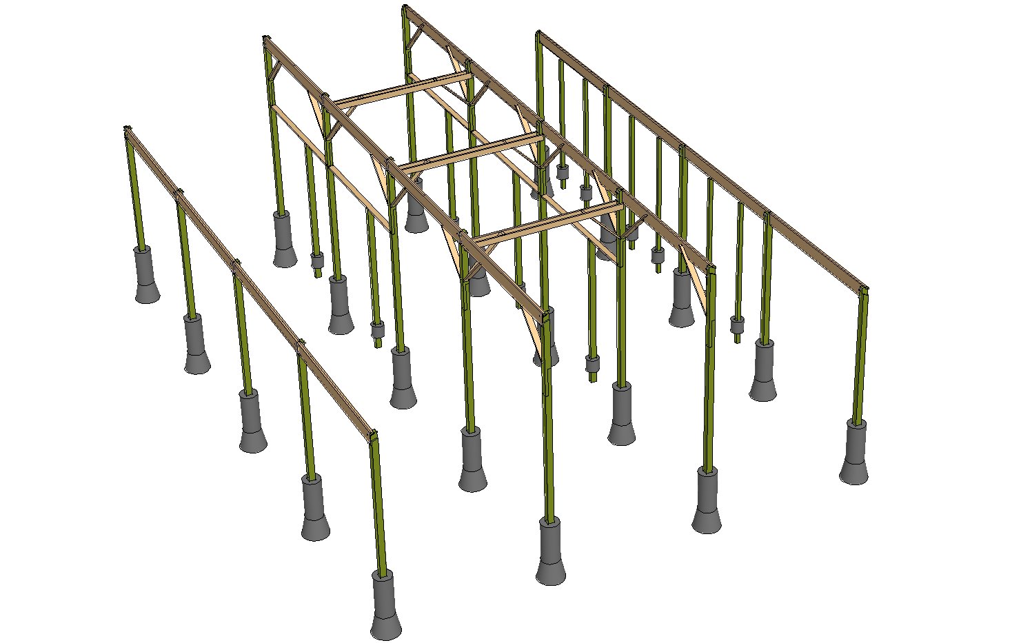

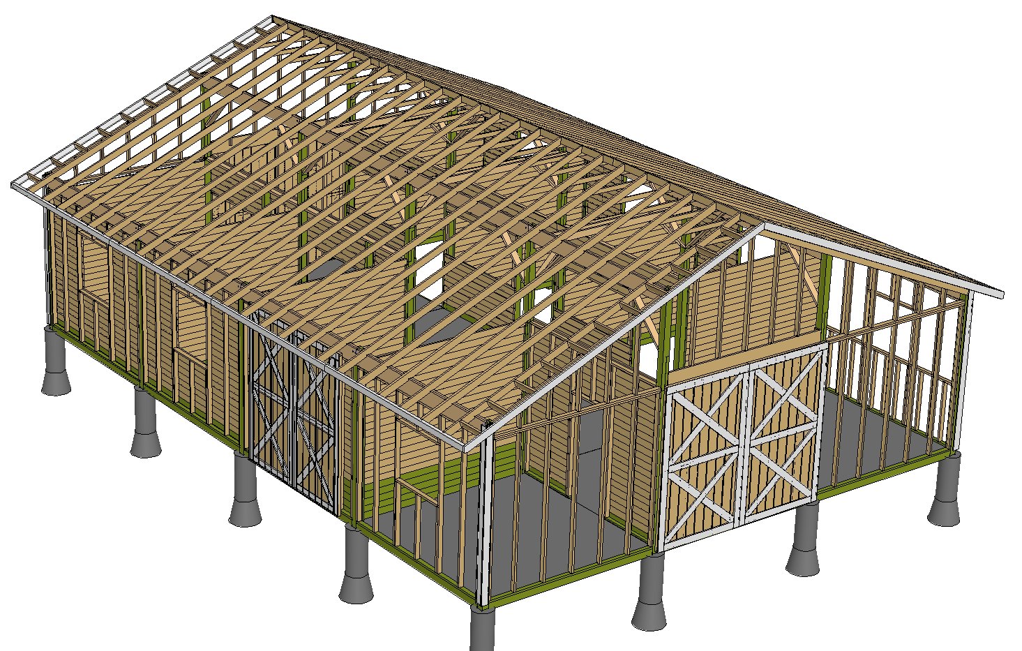

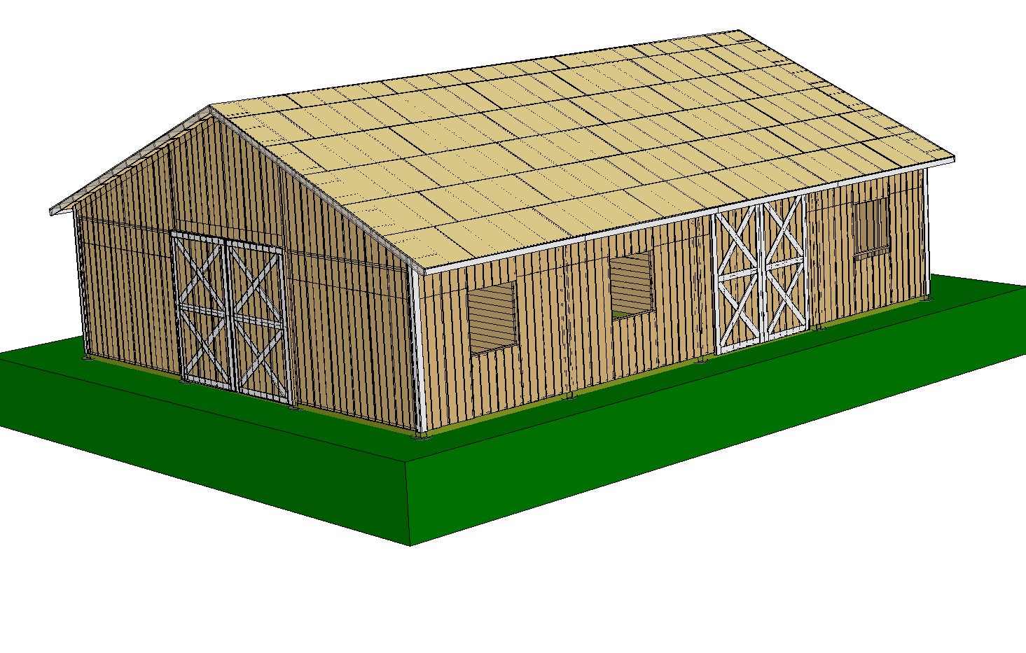

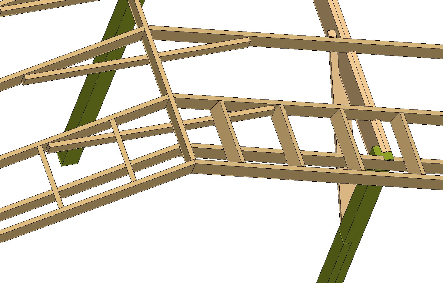

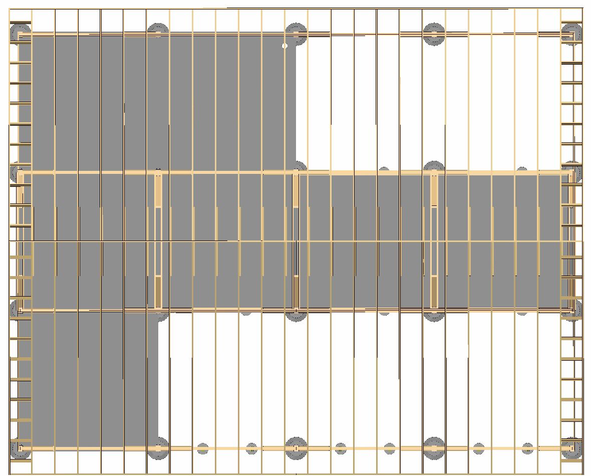

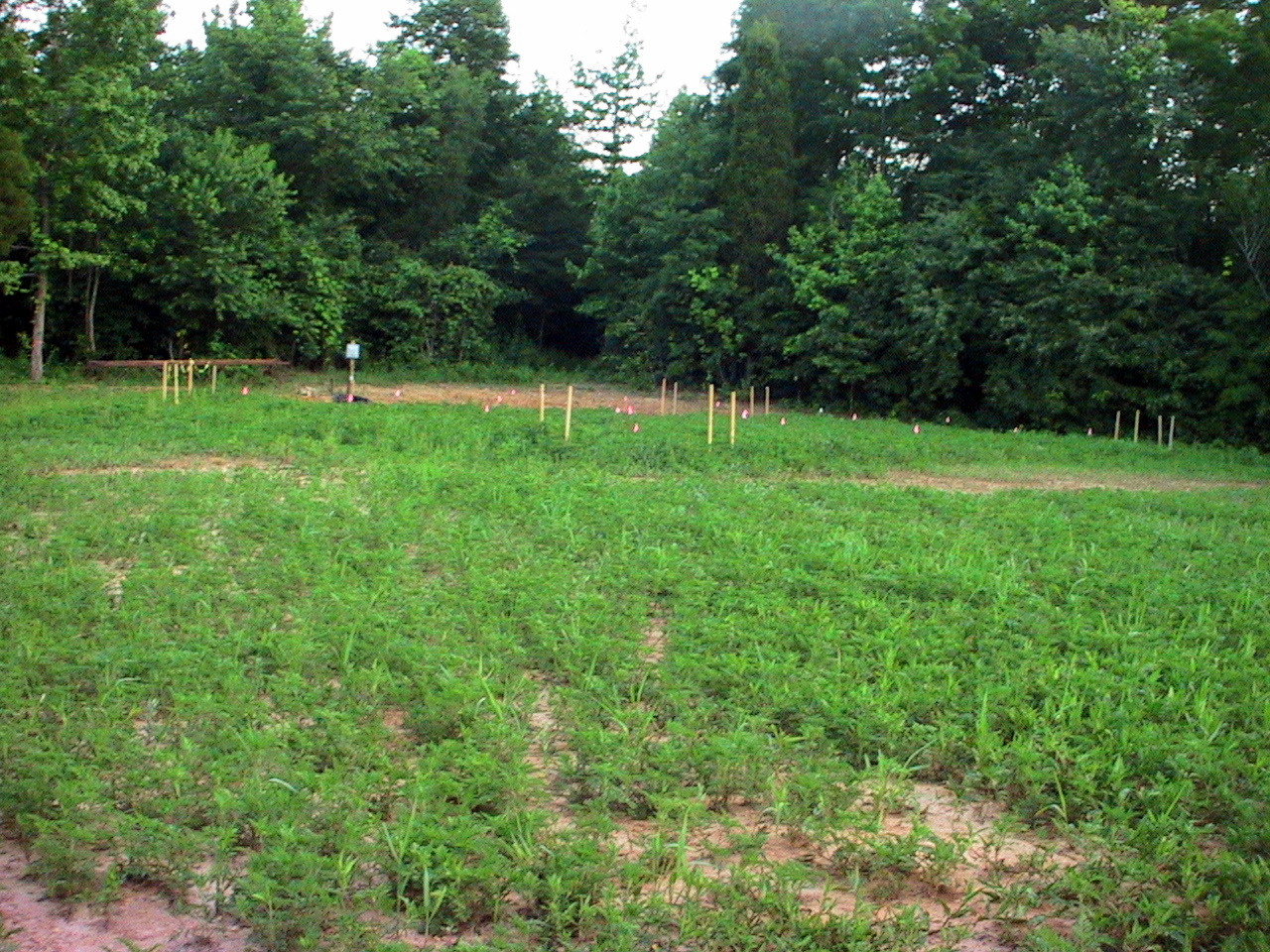

Step 1: Design
After much consultation with the wife (the horse expert of the two of us), we came up with a floor plan and some of the design features. To avoid assembly snafus, I decided to draw the whole thing in 3D complete with every stud, rafter, and panel.
The basic design is a 36x48 pole barn divided into 12 different 12x12 sections. The four sections running down the middle (the long way) make up the center aisleway. Of the remaining eight "rooms", there will be five horse stalls, a tack room, a feed room, and a washrack.

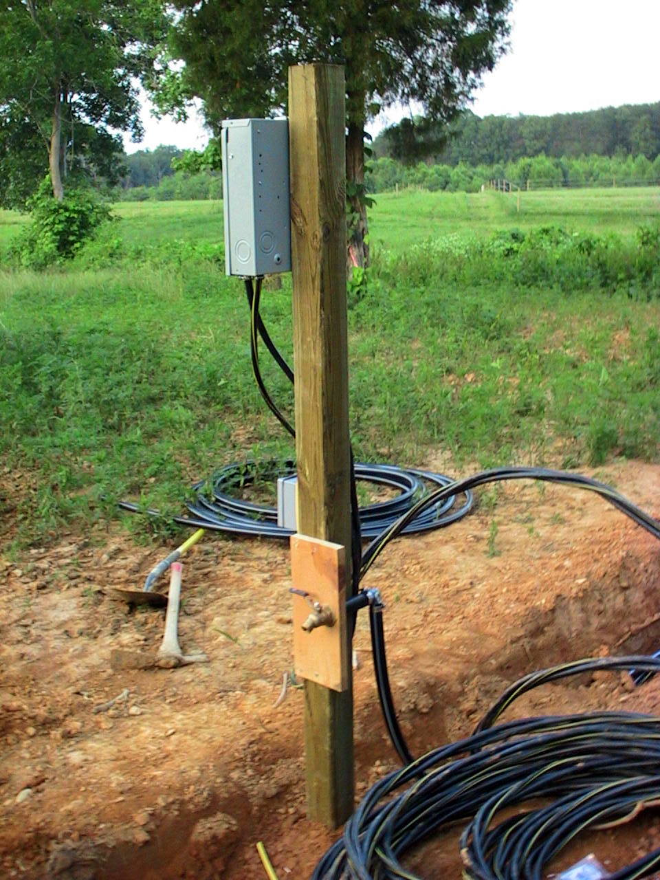

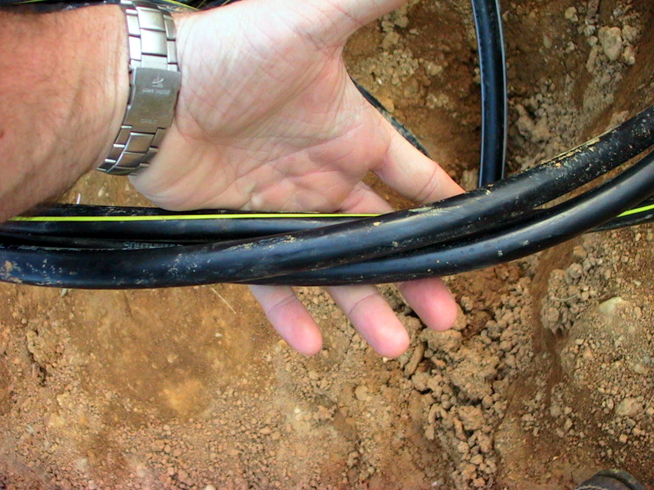

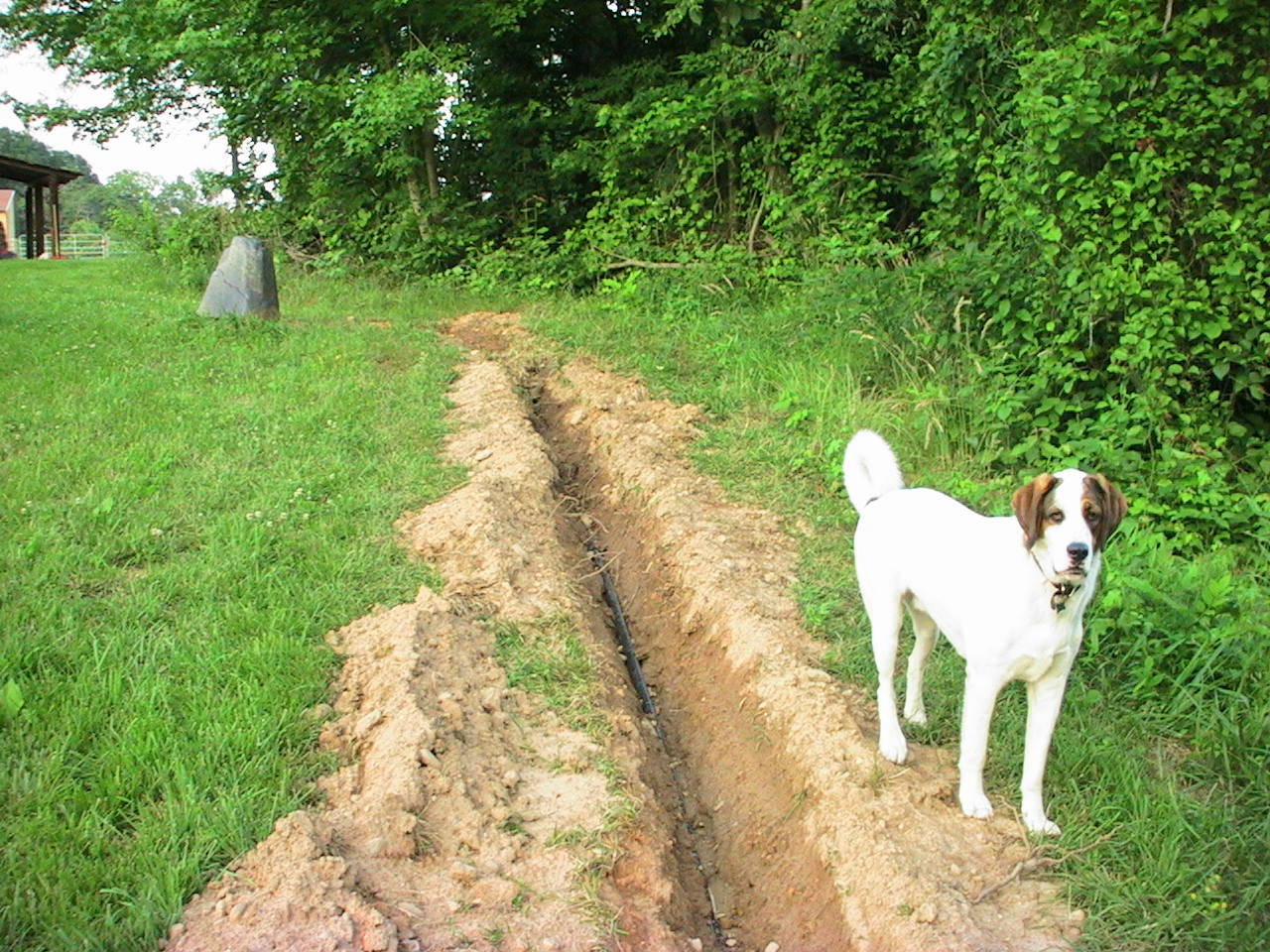

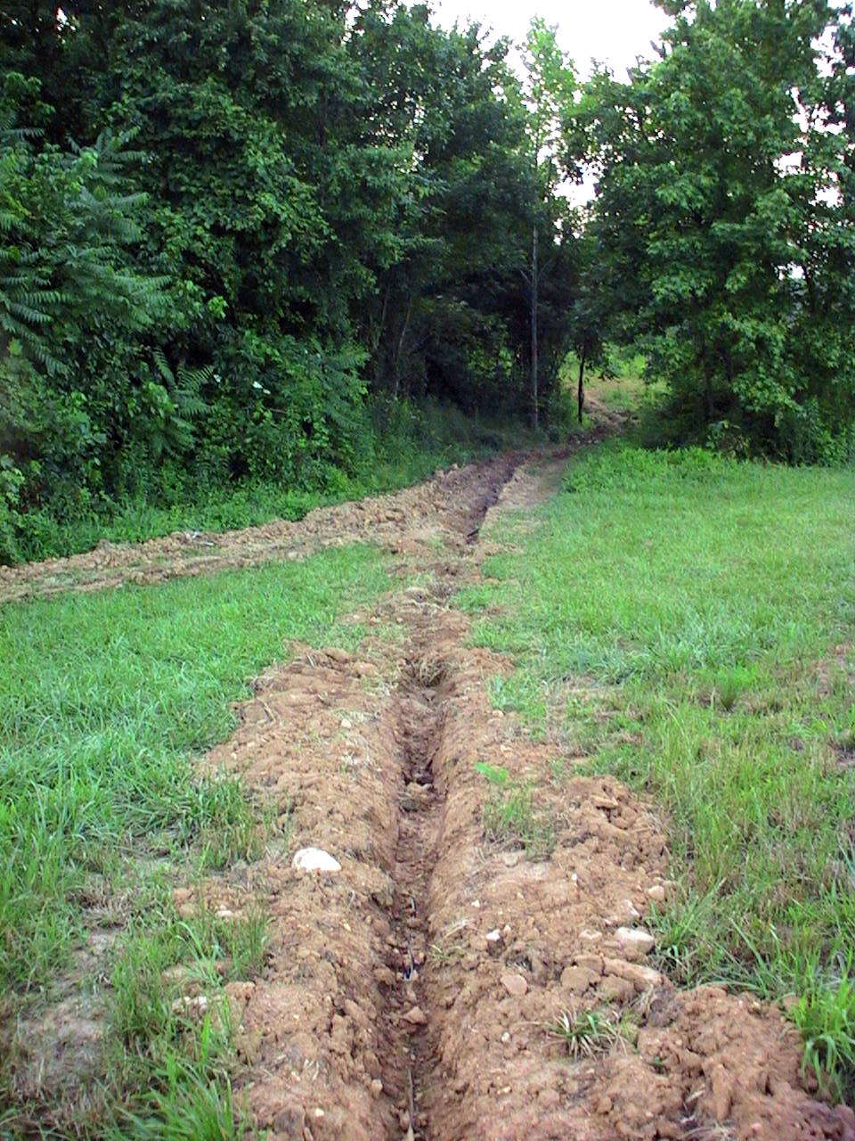

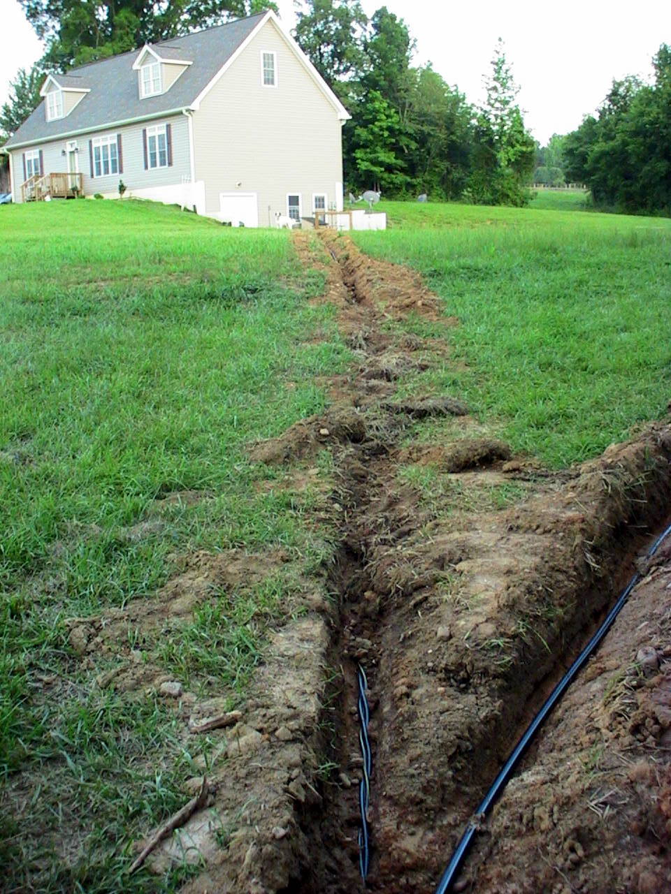

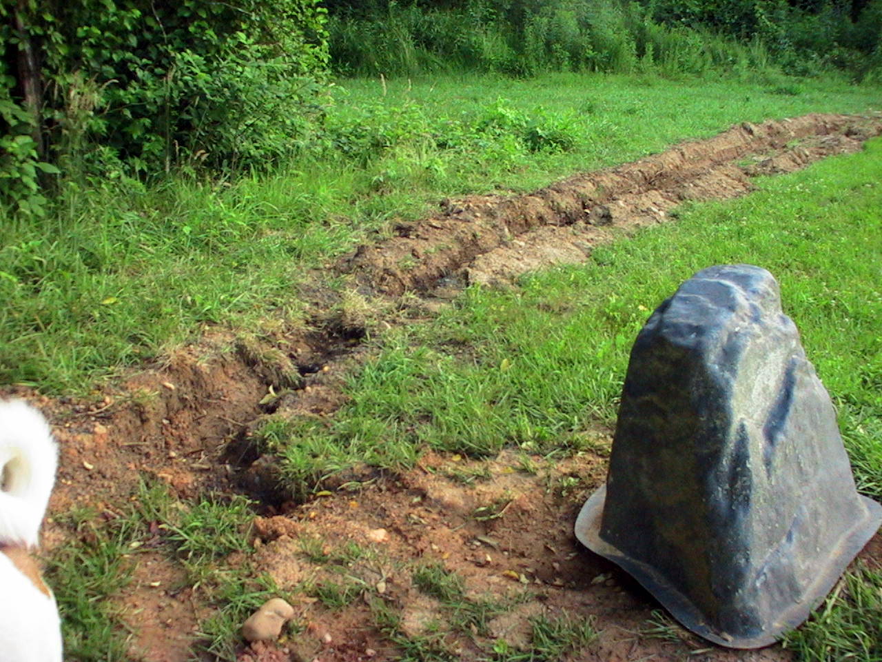

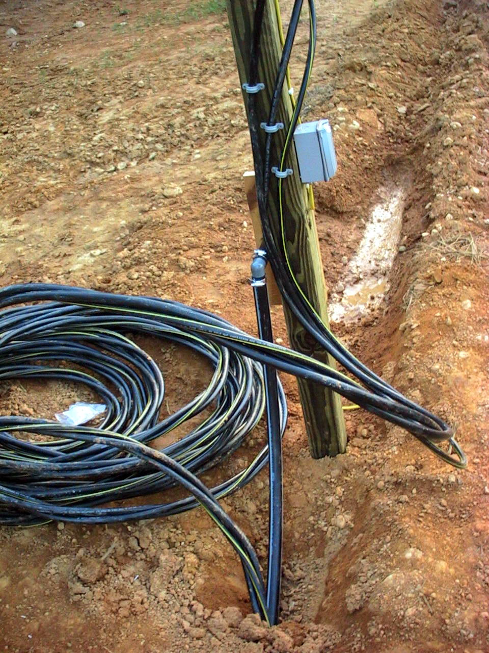

Step 2: Water and Power
The barn is about 450' from the house and about 600' from the well, so I had a whole lot of trench to dig. The tractor came in very handy here. I used my subsoiler to dig down about 18", and a potato plow to kick most of the dirt out. I had to get the last 6" or so out of the trench by hand, but at least the subsoiler had loosened it all up.
I ran 1" PE pipe from the well. I installed a shutoff valve at the well head and will eventually put a second expansion tank in the barn in addition to the one already in the house.
In addition to the typical lights and outlets in the barn, we plan to have a hot water heater, a clothes dryer, some pretty high power arena lights, and a 220V outlet for a welder. I managed to get a 500' spool of 4/0-4/0-2/0 underground service entrance wire for about half price. The wire's rated for 200A, but I put it on a 100A circuit so I don't get too much voltage drop over that distance. That should be enough current for everything I want to do.
I ran everything to the barn site and hooked it up onto a temporary pole.
Sorry. No action pics with the tractor.

/ My Horse Barn in Progress #4
That looks like a good design
If you are putting a in a sub panel you should have 4 wires out there to meet new code if applicable to you.
hot, hot, neutral, and ground.
At least add a ground rod out at the panel to be safe.
tom
tom
Thanks, Tom. I realize the new code requires a ground, but I'm not required to get any of this permitted since this is an agricultural building on a registered farm. Therefore, I'll pretend it's still 2007 and put a couple of ground rods at the barn location.
Ive put 100's of sub panels in the old way and never had a problem.
I just didn't want you getting burnt by inspector or "shocked" with out ground rod. (pun intended)
tom

That looks like a fine horse barn. I'm from Michigan so the 18" deep buried water line seems shallow. I go about 48" here (minimum 42) but you must be in the sun belt somewhere. Lot of work ahead. Best wishes on your project.
/ My Horse Barn in Progress #12
2' down is required down here for electric or water. Up north in Ohio, or other cold climates, it needs to be below the frost line.
#13
I'm in NC, and code here is 12" below the frost line, which works out to 18". It may be a bit more in places; it's just down as far as my subsoiler would go. Deeper is better for frost, but shallower is better to fix the inevitable leaks that will someday happen.
More to come, including maybe a pic or two of some horses and the dogs when they're not quite so clean.

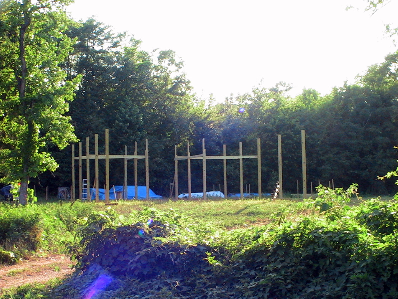

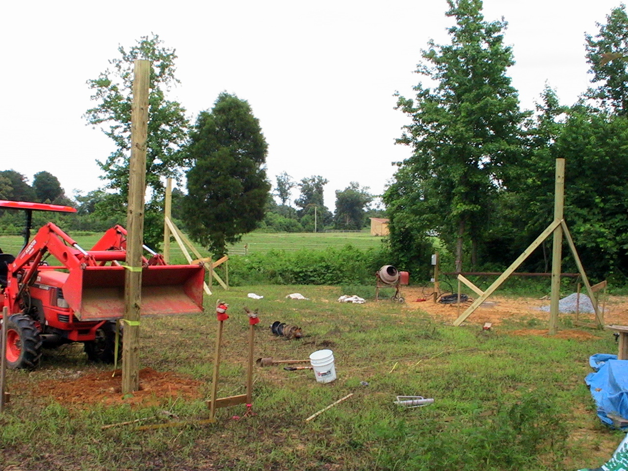

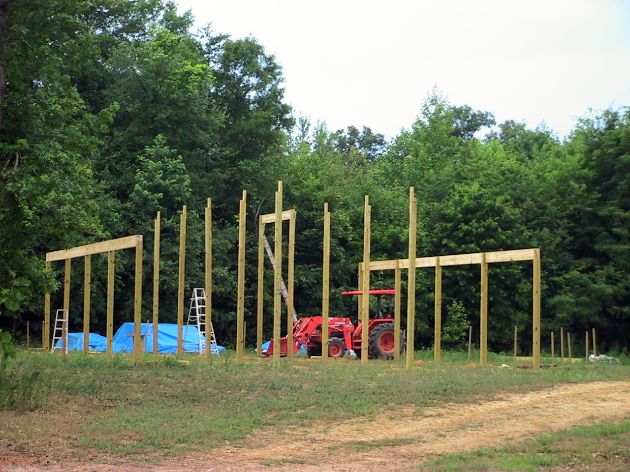

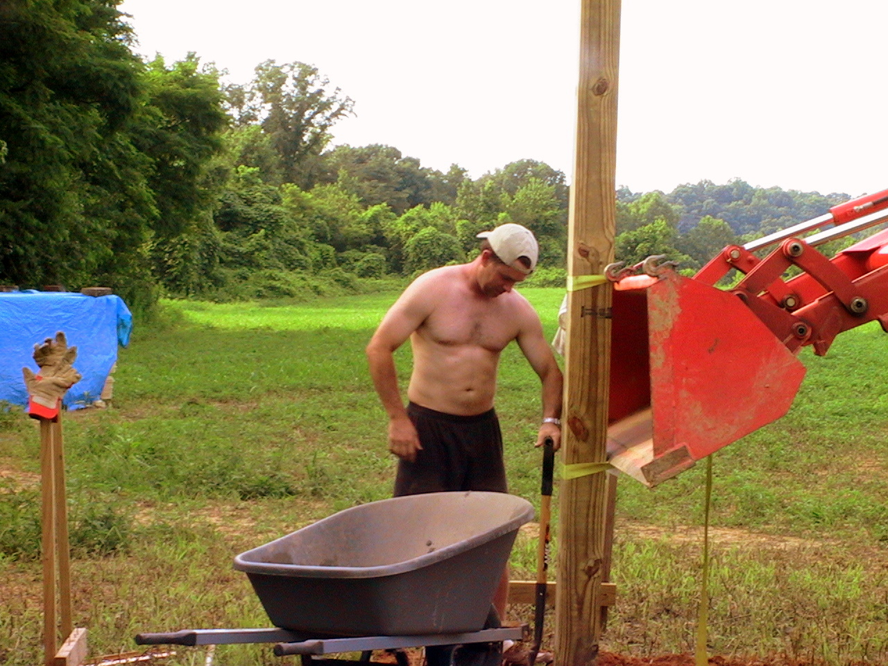

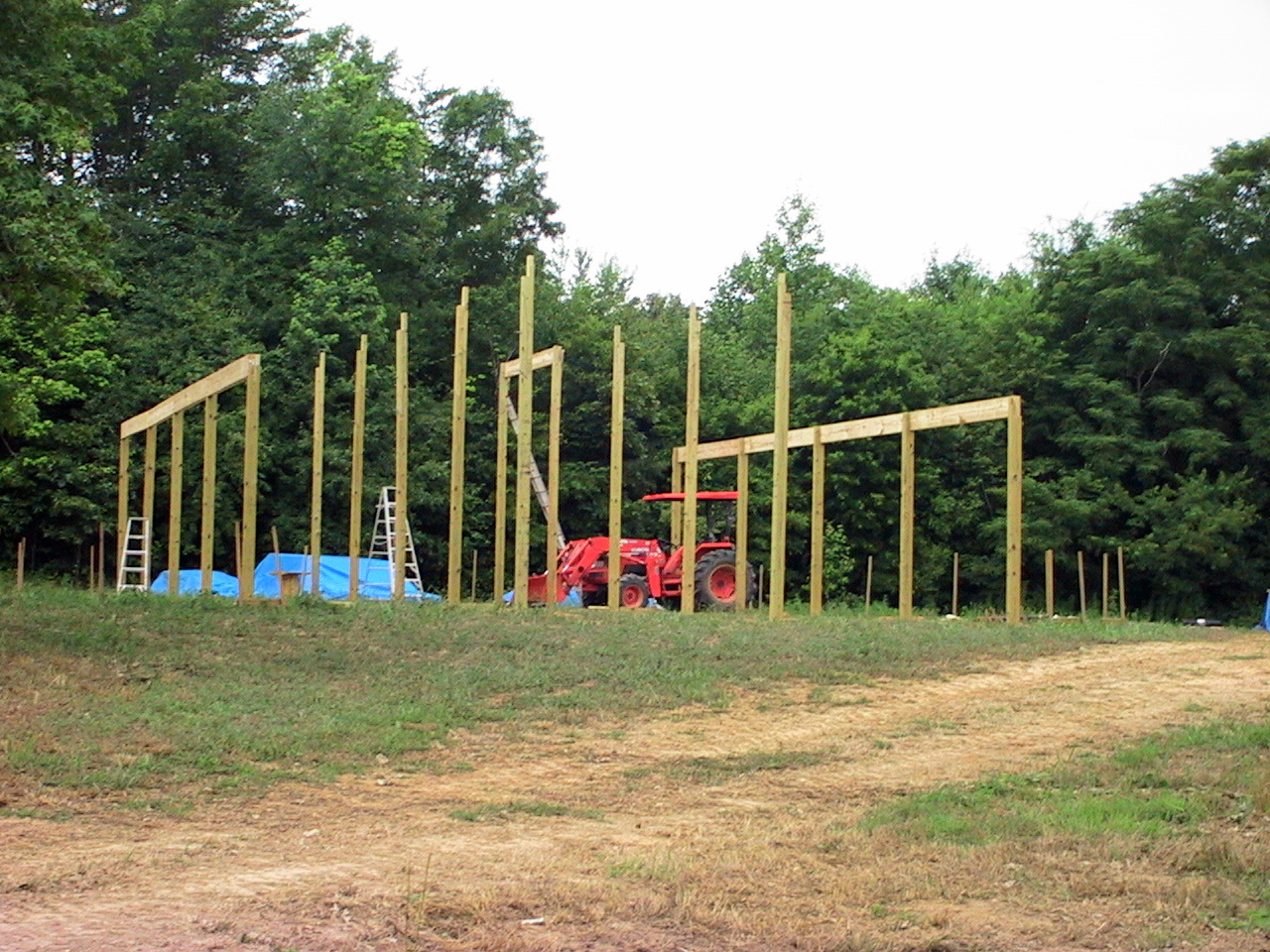

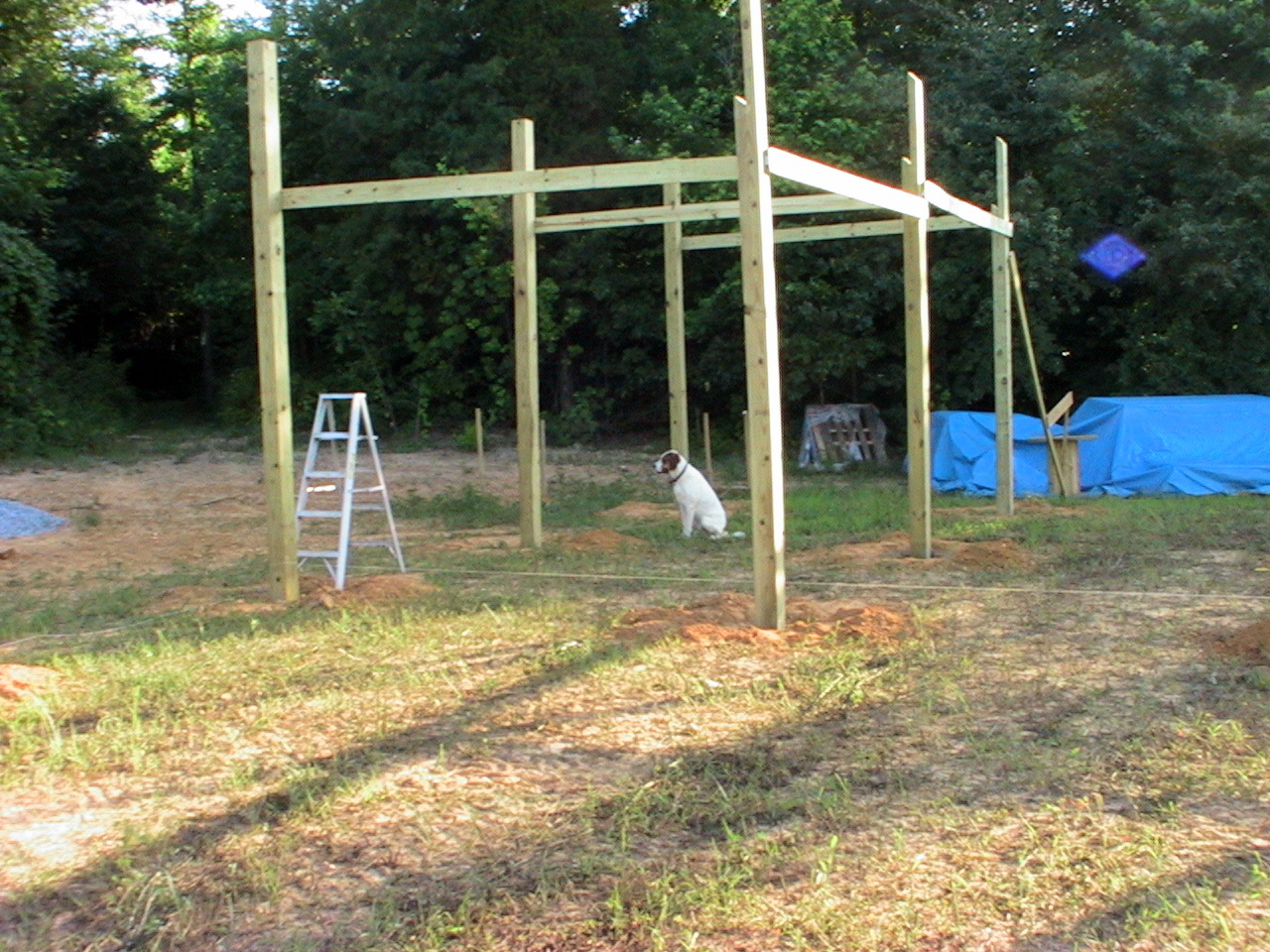

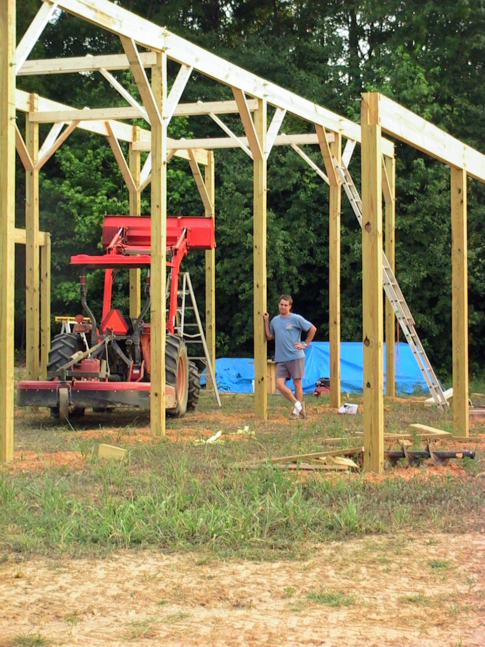

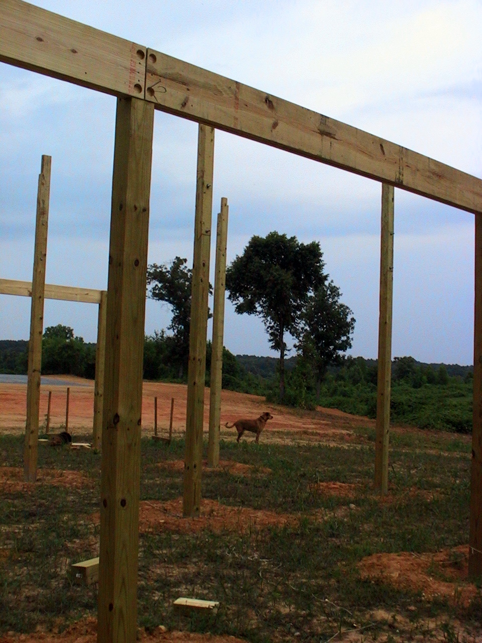

Step 3: Posts
I'm using 6x6's for the posts. The outside rows of posts, where the eaves are, are about 11' out of the ground. Since I can dig down to almost 48" with my 3PH auger, a 16 footer works just fine. For the interior rows, I need 16' out of the ground. However, the cost for 6x6x20's is ridiculous - about 3x what I paid for 6x6x16's. So I used 16's and spliced on an extention with a dovetailed lap joint and some big honkin' hex bolts. It turned out to be a lot of work cutting all those joints. I had to make a pass on each side with a circular saw, finish with a sawzall, and clean up with a block plane. In the end, they're rock solid though. And it saved me about $500.
The Kubota was an incredible help in this whole process. Since I'm doing all this work by myself on weekends, you can imagine how difficult it could be to move all of these posts. Anyone who's ever tried to lift a 6x6x16 PT post knows how heavy they are. With the tractor, I could pick up a bunch of posts with forks, drive them to a different location, and set them down with one end resting on a 6'-tall stack of OSB. That leaned them up at enough of an angle that I could then drive up to the low end, tilt the bucket all the way down as far as it would go, lower the bucket down onto a post, and strap it on with a 5000-lb ratcheting tie-down. Then it was simply a matter of lifting the whole post and tilting it upwards at the same time until I got it sticking straight into the air. After that I could drive it over to a hole and slowly and carefully lower it in. It's an iterative process to get the posts just right in the hole. The loader travels on an arc, of course, not straight up and down, so as I lowered the post I'd have to back the tractor up a few inches at a time to compensate. Meanwhile, I'd have to continually tilt the bucket up to compensate for the downward tilt from lowering it. By the time I'd done the 20th post (several weekends after starting the process) I was able to get everything square and plumb and within about 1/16" of the mason's lines I was using to set the position within about 15 minutes of strapping it onto the bucket.
While each post was still strapped to the bucket, I'd brace it temporarily, then untie the tractor and back away. After I'd get a couple posts set, I'd mix up some concrete and start filling them in.

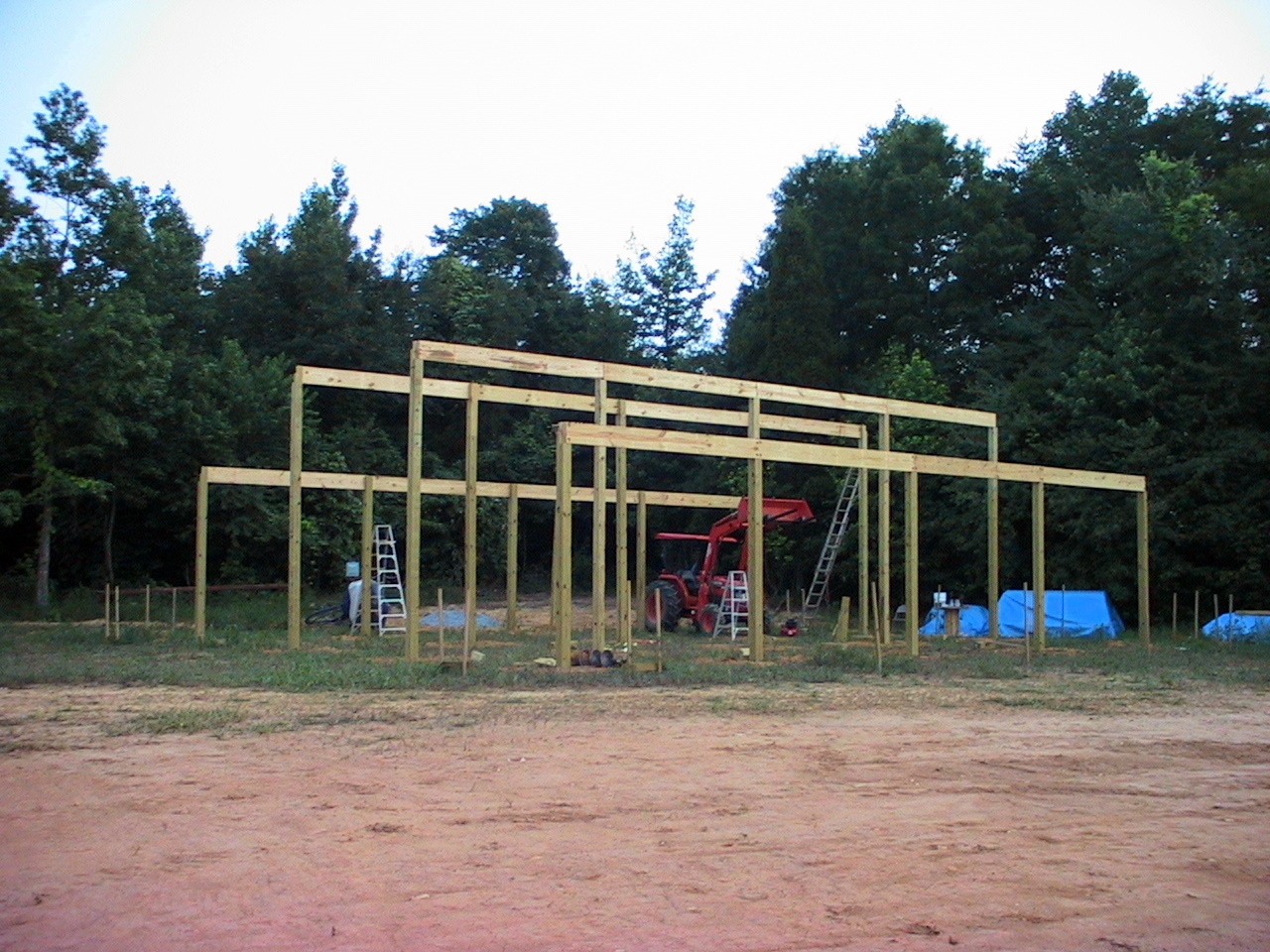

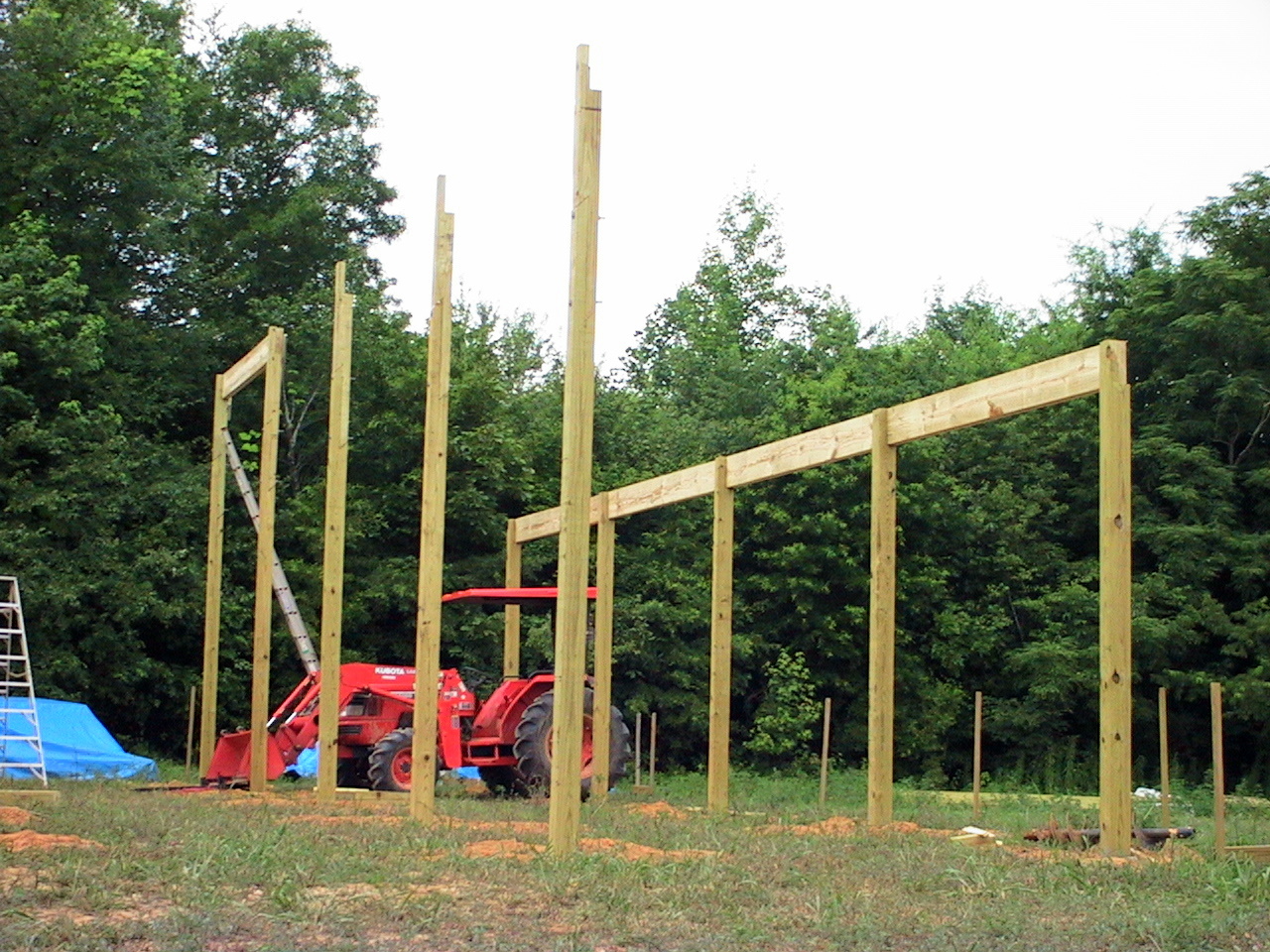

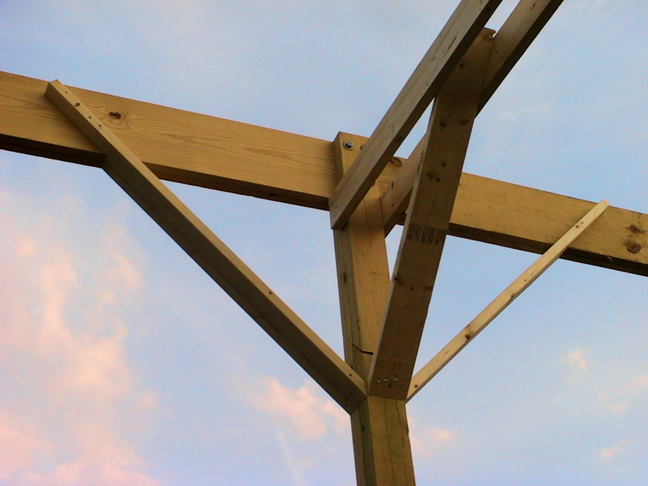

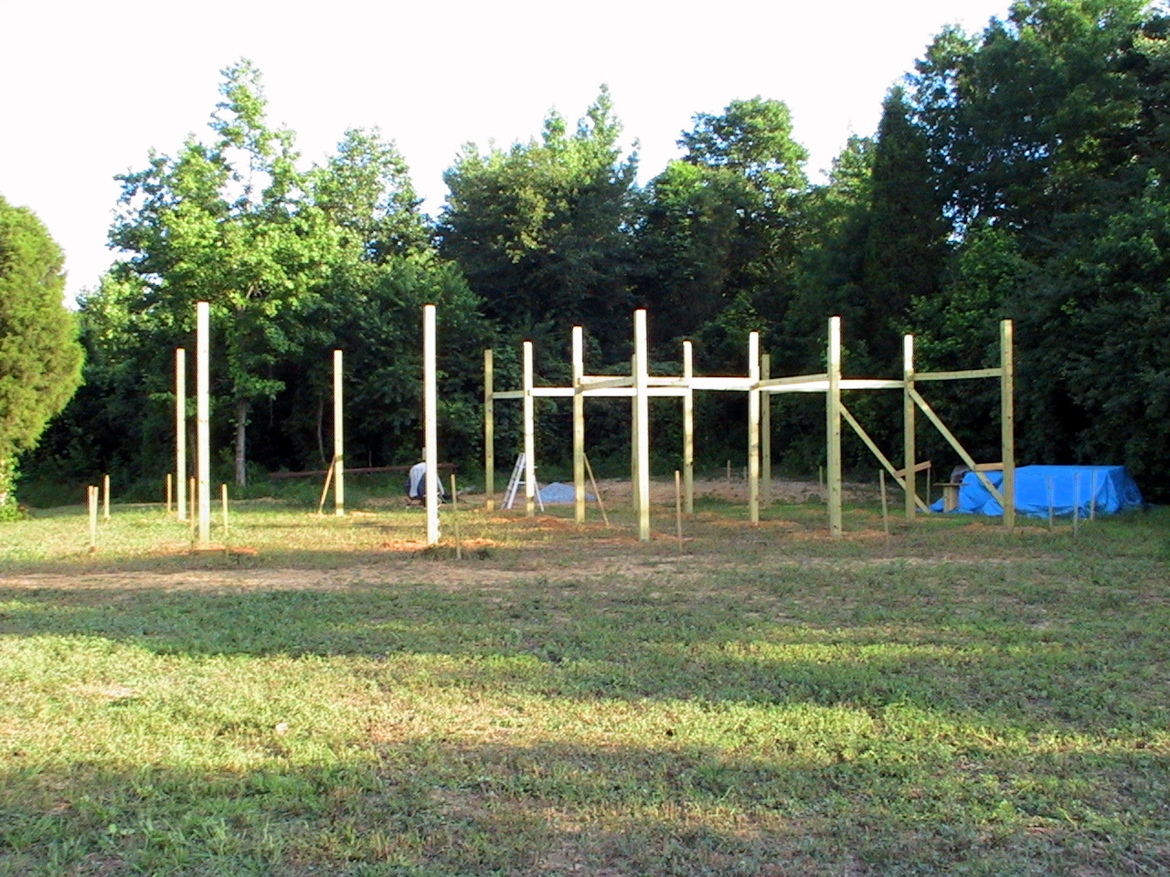

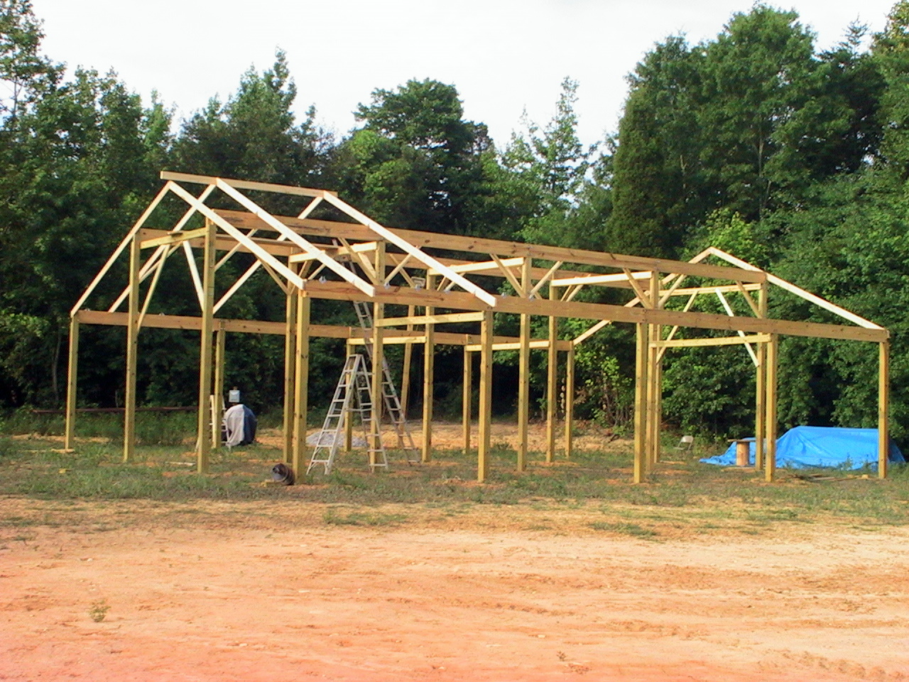

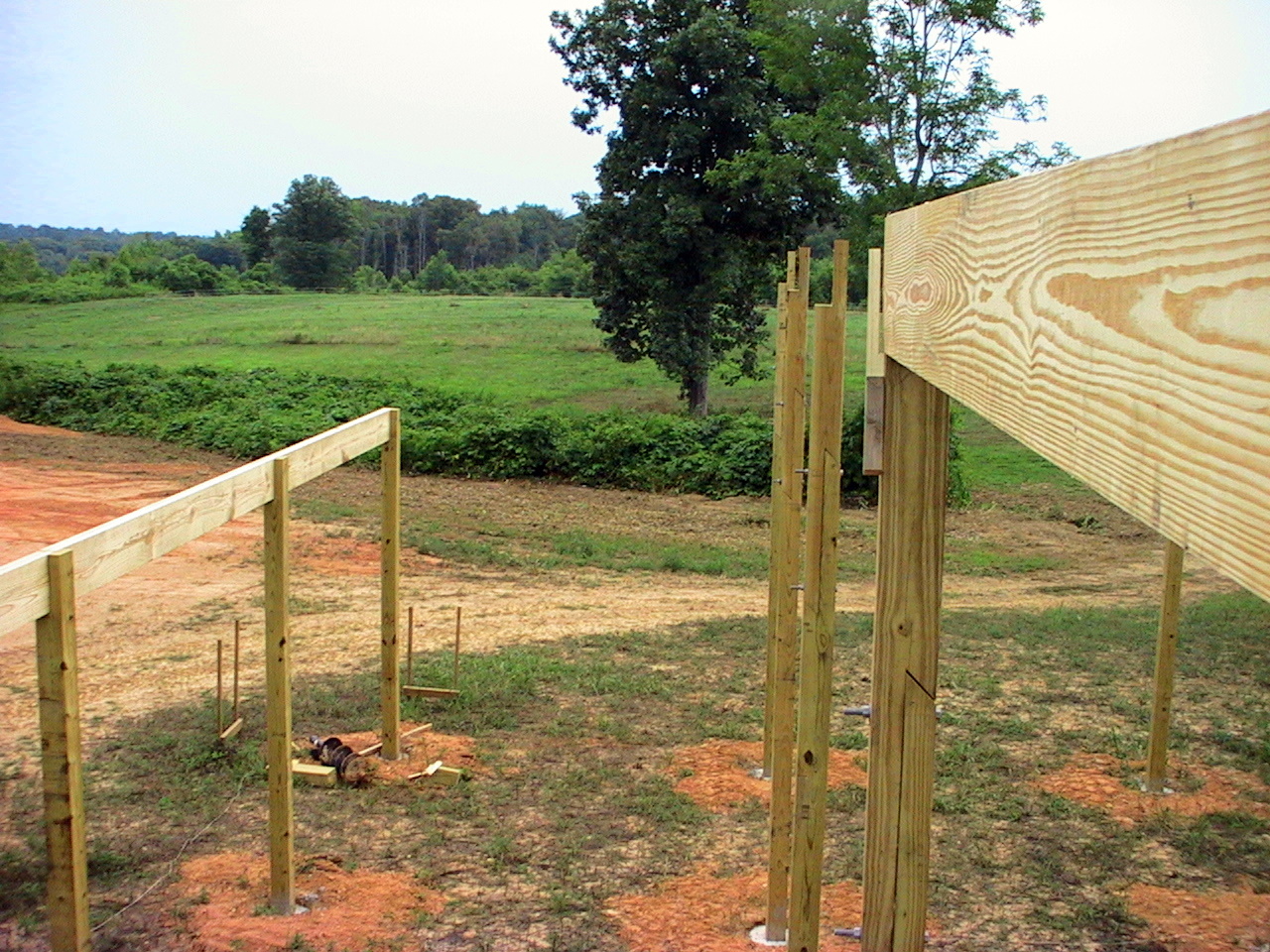

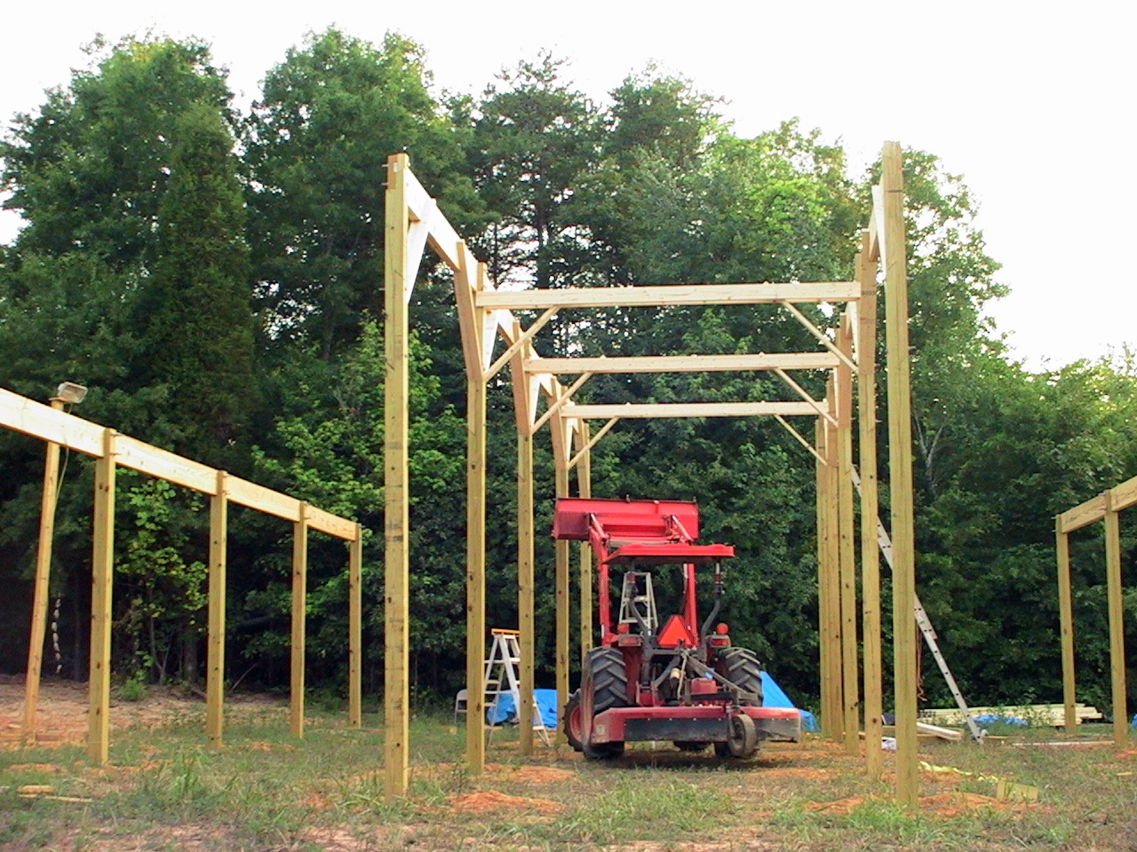

Step 4: Girders and cross bracing
With all the posts planted in concrete the next step was notching the tops and erecting the girders. I set a level line on all the posts using a transit. Then I measured up and notched the outside row. For the inside rows, I measured the existing height to the top of the splice, then notched the extentions at the right length in my workshop before attaching them permanently - much easier than doing them in the air.
The girts are double 2x12's, nailed and glued together. Like the posts, they're pretty freakin' heavy and unweildy, so the tractor was a major help. It can't reach 16' in the air to do the tall inside posts, but at least it could get me up high enough so I could stand in the bucket and set them in place myself. It would have been impossible to do that working off a ladder - oh the joys of working alone. I attached the girts to the posts with a couple of 5/8" hex bolts at each end.
I added diagonal bracing to all the interior posts. The exterior ones will have sheathing and rafters to hold them firmly in place.

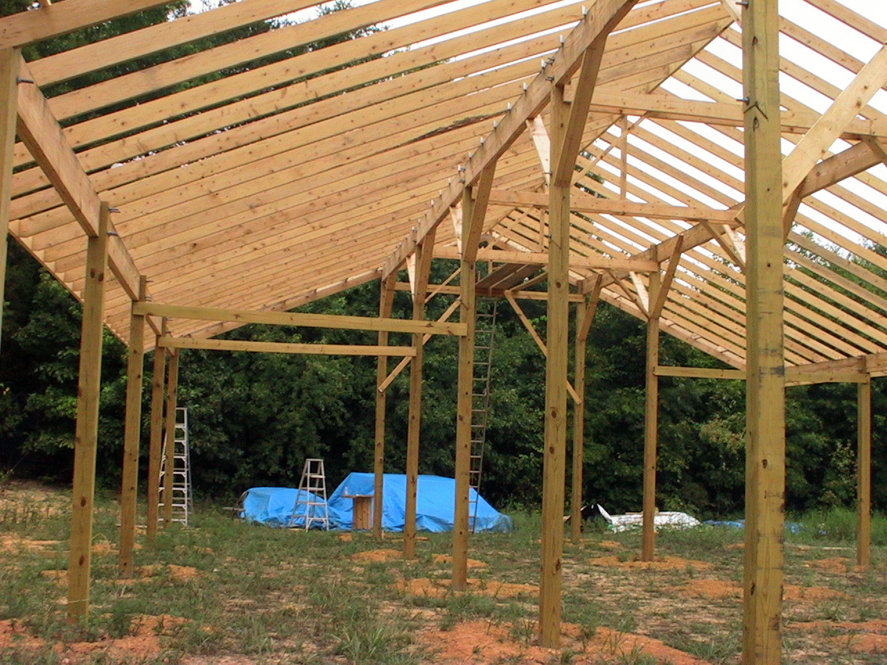

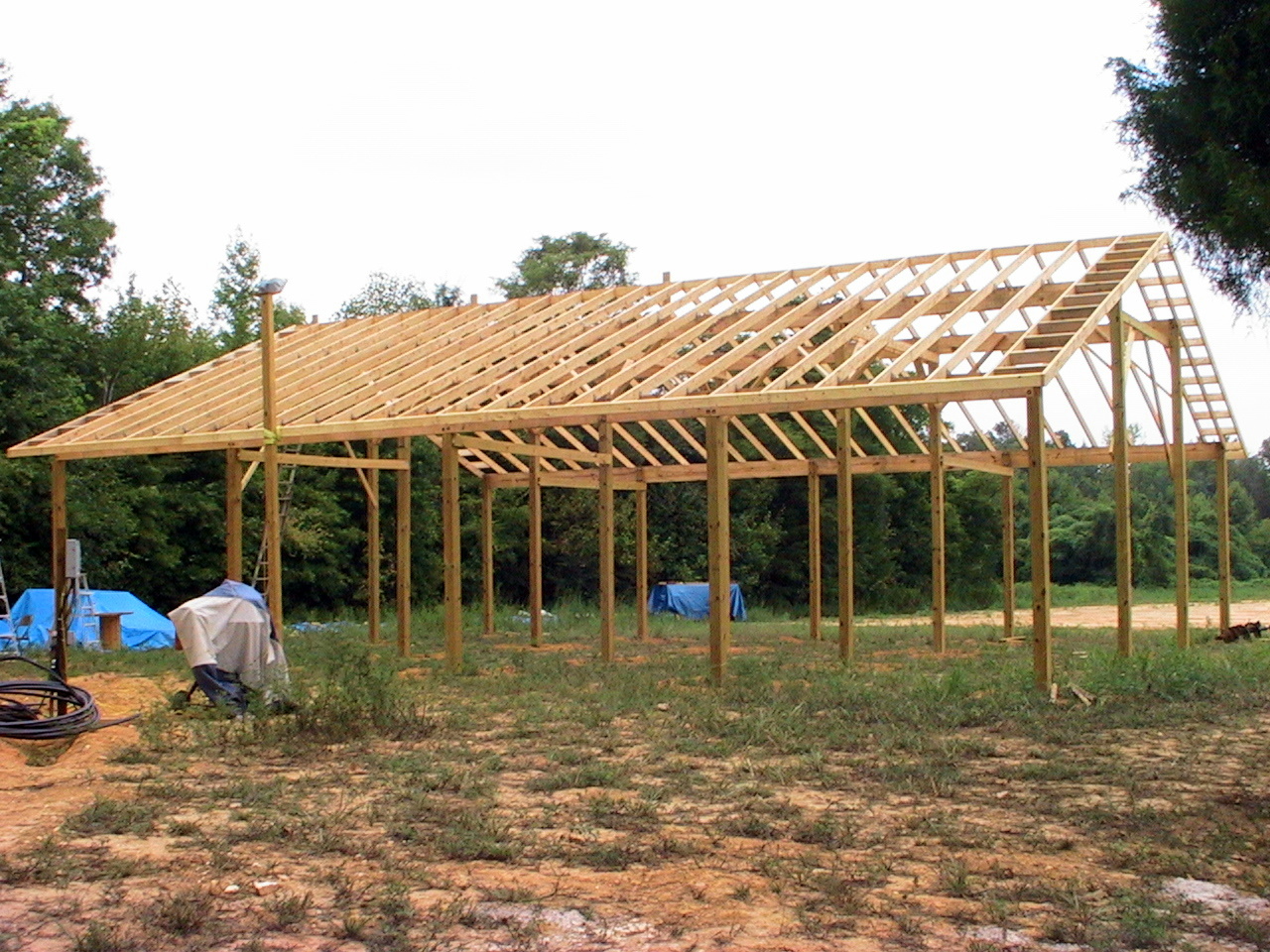

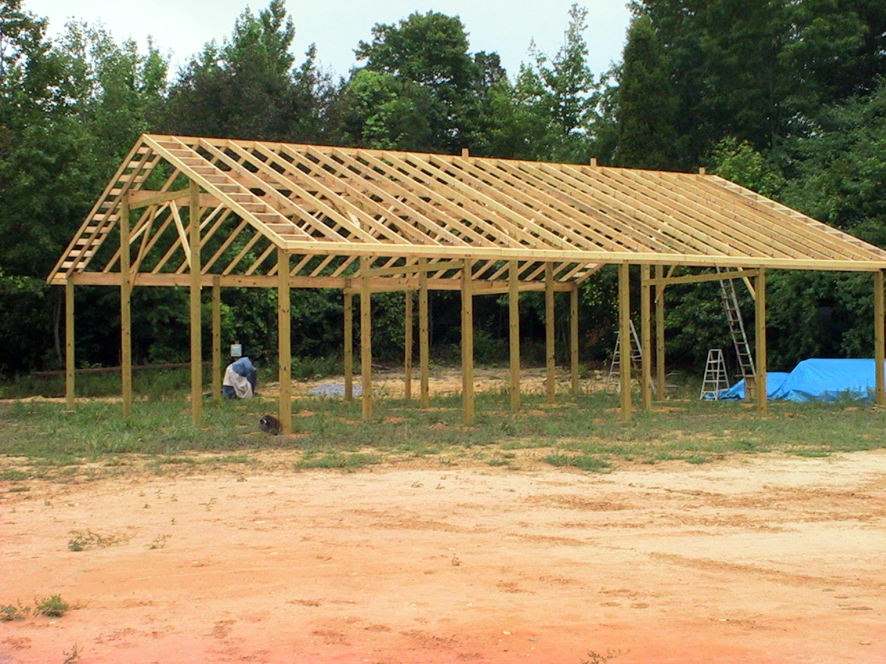

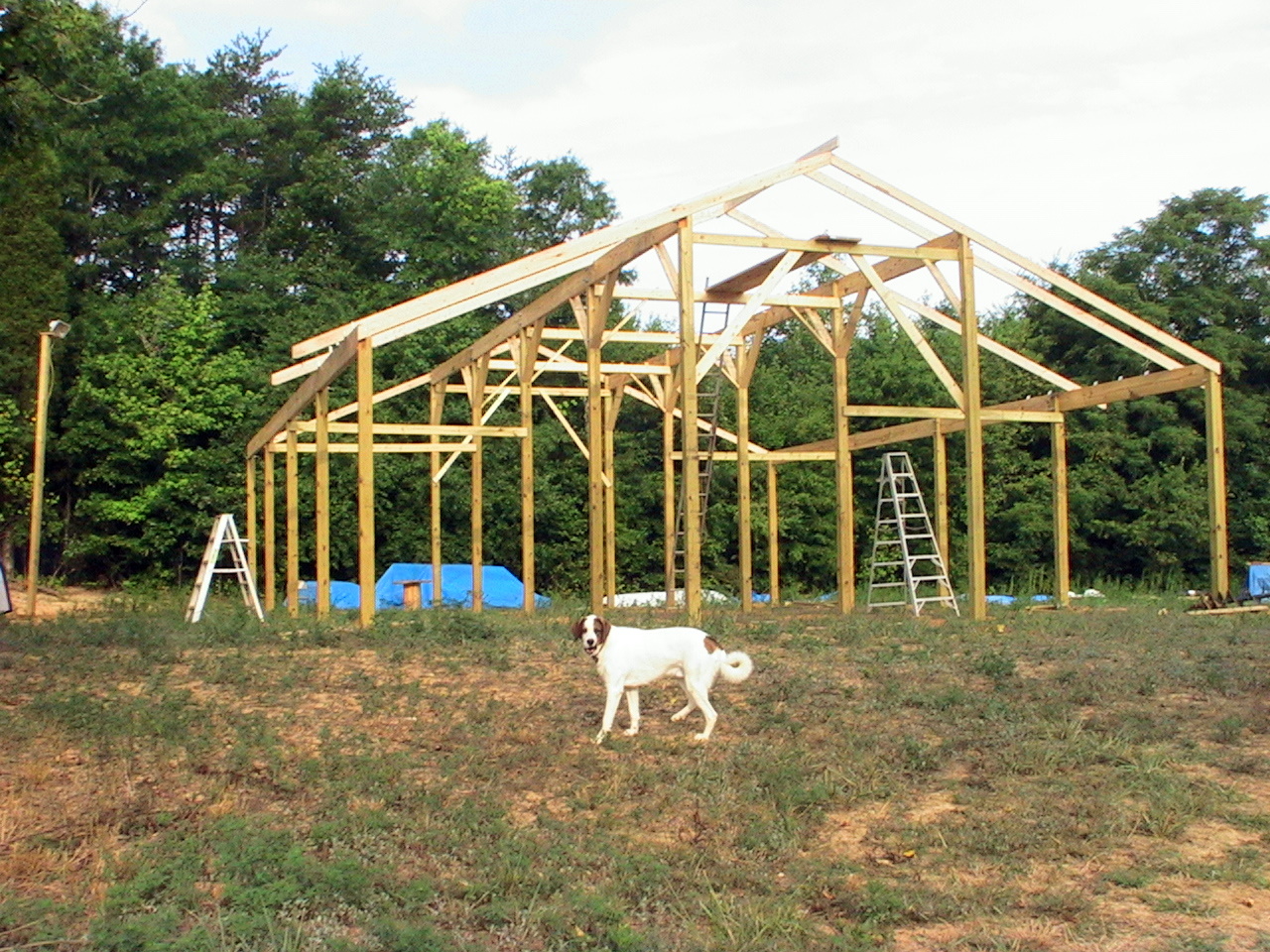

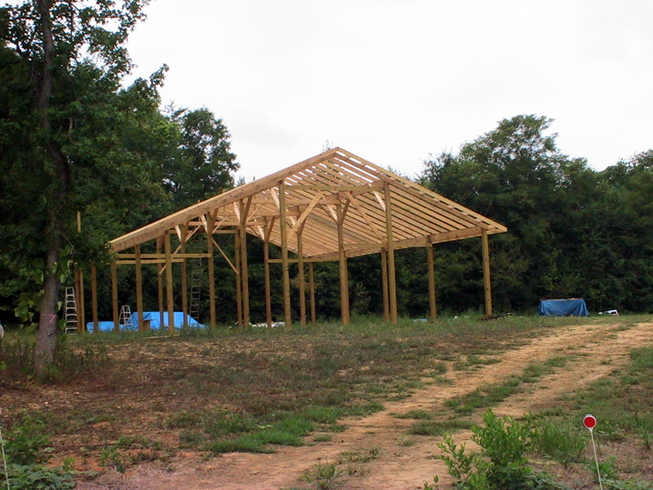

Step 5: Rafters
For the rafters I used full 24' long 2x6's. They're tied to the girders with H1 brackets. It's a pain working with lumber that long, especially since I actually had all 52 boards stacked in my workshop to cut all the angles and notches. Plus, boards that long always warp and twist more than shorter ones. However, it was nice when the time came to put them up on the roof, because I could lift one end up by hand and just slide them up as high as I could reach. Then I'd finish putting them in place from a step ladder. Plus, there was no precarious balancing act trying to lean them up against the ridge pole all by myself.
The gable overhang was a little dicey all alone. I put in a couple of the lookout rafters then added some temporary blocking for the end rafters to sit on until I could get them more permanently in place.
I'm planning to add 2x4 collar ties near the peak, though I'm not really sure they're necessary since the rafters are tied firmly to two different girders.

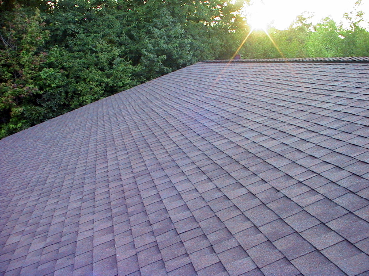

Step 6: Roof
In doing the roof, the tractor was once again enormously helpful, allowing me to avoid carrying full-size sheets of 3/4" OSB or bundles of shingles up a ladder. I could just lift a whole stack of sheathing or pallet of shingles with my clamp-on forks.
Finally, in addition to my trusty tractor, I got some help from a couple friends. One neighbor came over and worked with me all day getting the sheathing up on the roof. The next day another neighbor dropped in unexpectedly and spent the entire afternoon helping me nail all of it down. Then he ran home for a quick dinner and came back and helped me put on the felt. It's great to have wonderful neighbors!
The next weekend was time for shingles. I don't know about the rest of you, but I've never shingled a roof in my entire life when it wasn't at least 85 degrees outside, and that weekend didn't dissappoint. There was no way I was going to get 2200 square feet of roof covered in a weekend by myself, so I hired a couple of guys I know who needed work to help me out. They hadn't ever done roofing before, but they seemed to be fairly quick learners, and they worked really hard. By the end of a very long 87-degree day, I had installed 3 skylights and helped them put on all 70 bundles of architectural shingles. The bad news was that the roof ended up needing 76 bundles. :) I'm not really sure how I miscalculated so badly, but no matter. I had the entire following day to finish the last couple of feet near the peak, install the ridge vent, and put on the ridge shingles. It was 89 degrees that day, and I finished with the last of the ridge at about 7:30 p.m.
The following day when I was back in the office it was bright and sunny with a high of 67!!!! That was the end of August, and now that I finally have shade to work under, it's pretty much been cool ever since.
