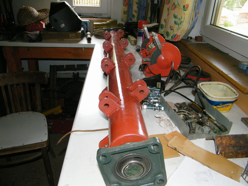

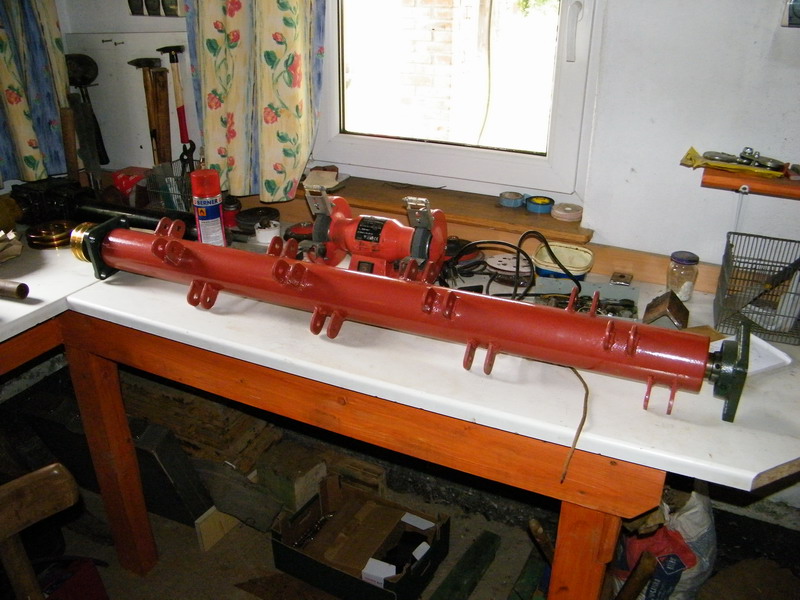

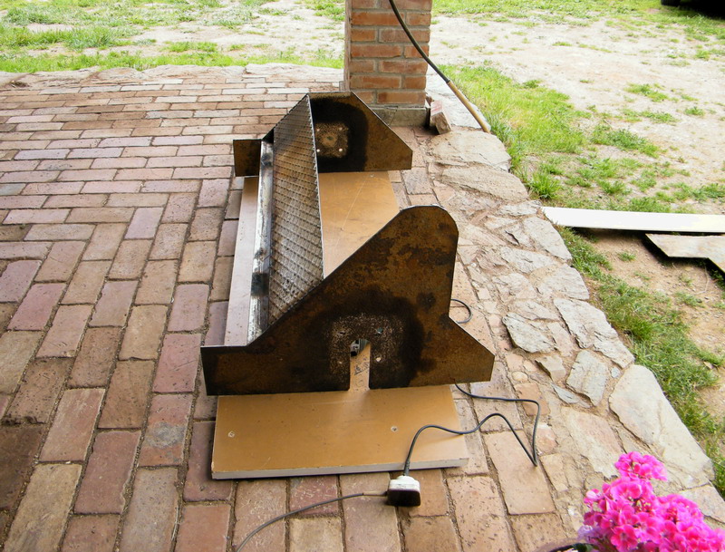

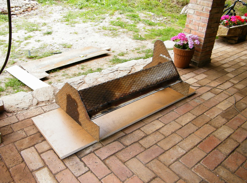

I found some pictures taken during construction:

Thanks for the picure! What are the dimensions of tube?!

The rotor is the most difficult part to do. I don't remember the dimensions of the tube. Tomorrow I will be measured.
