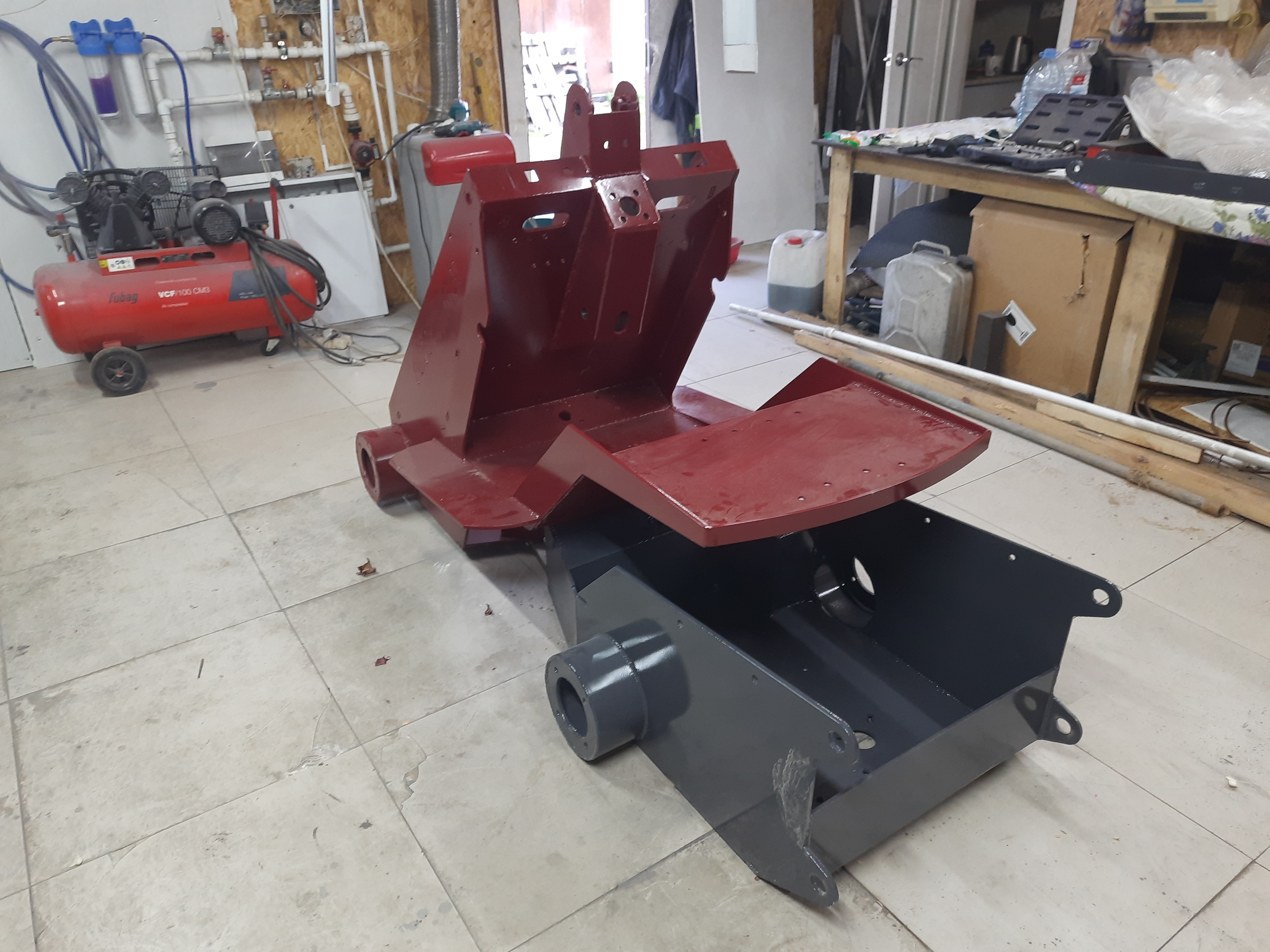

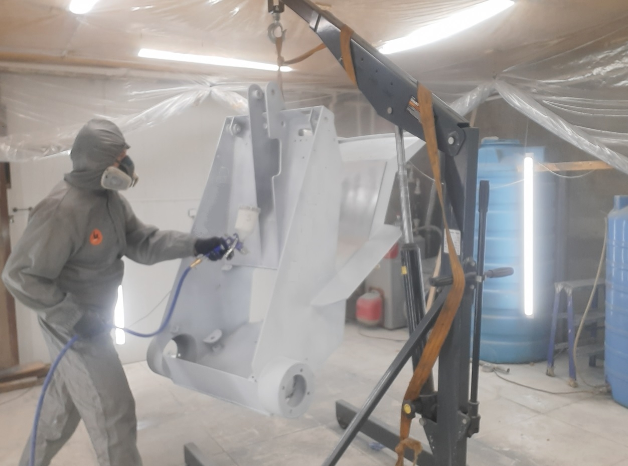

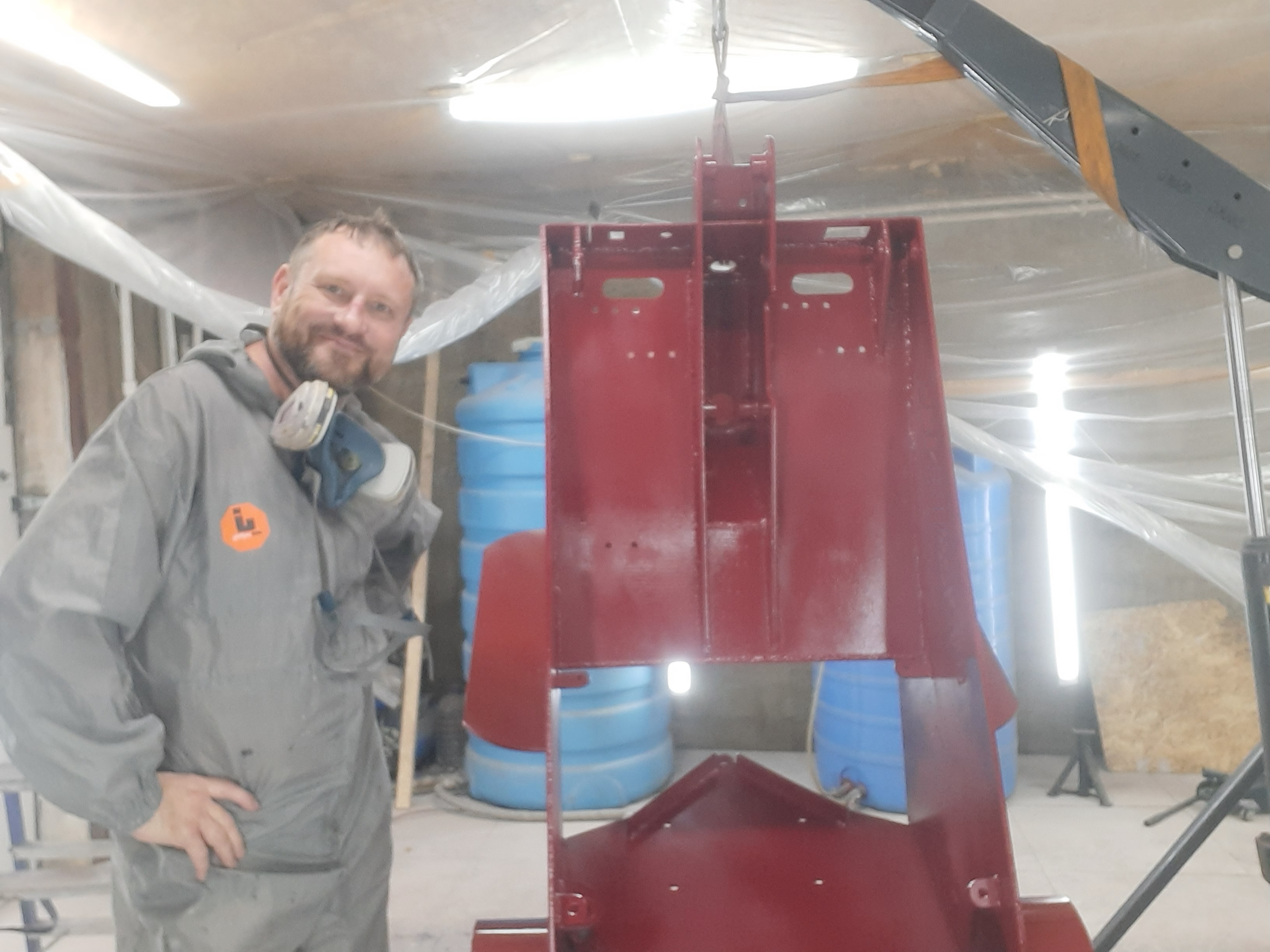

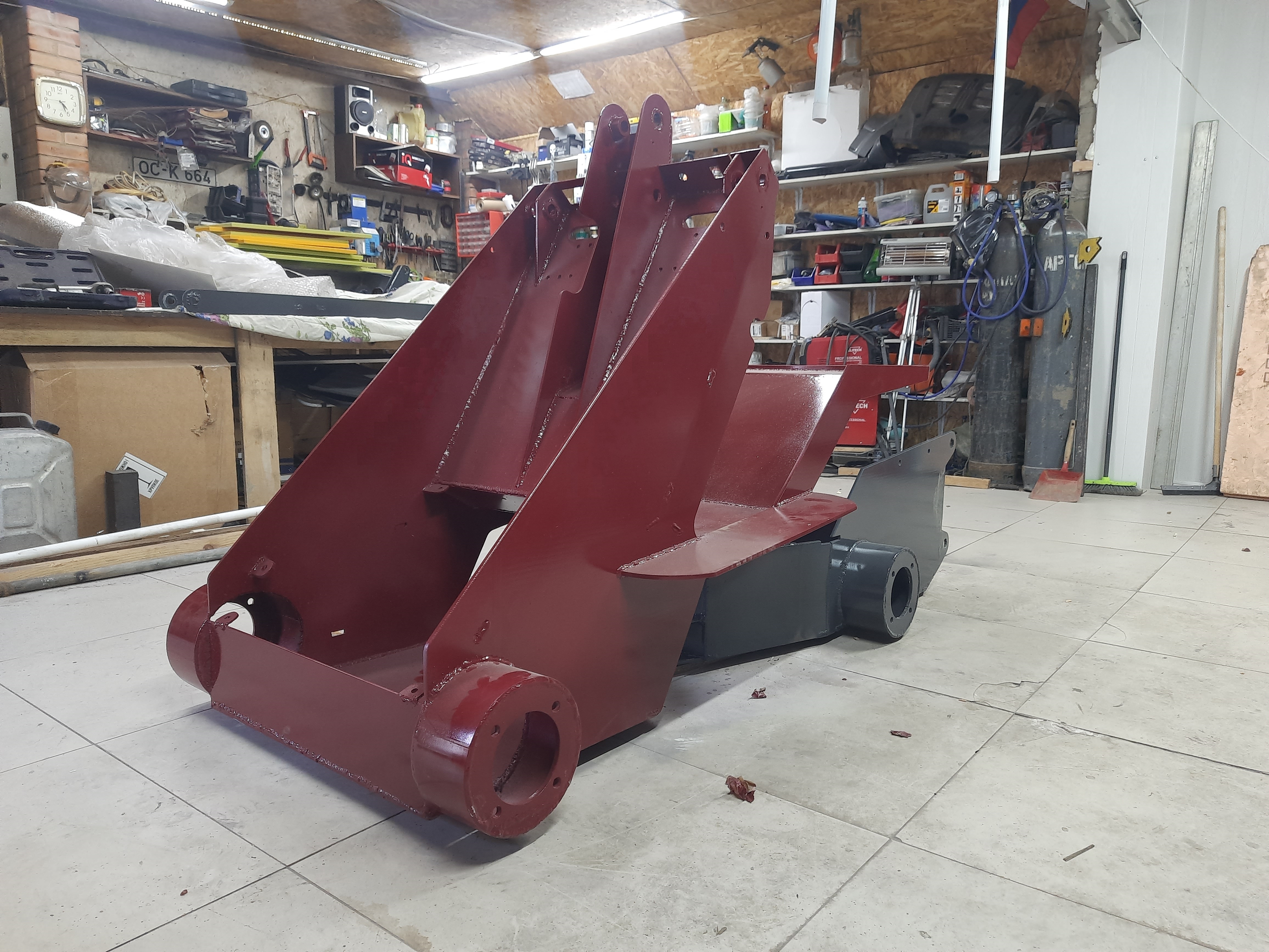

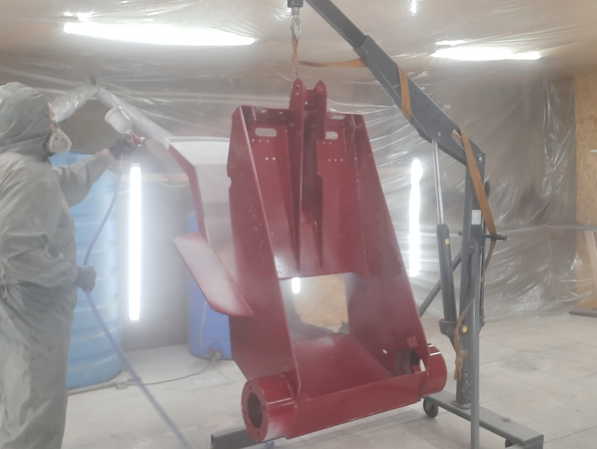

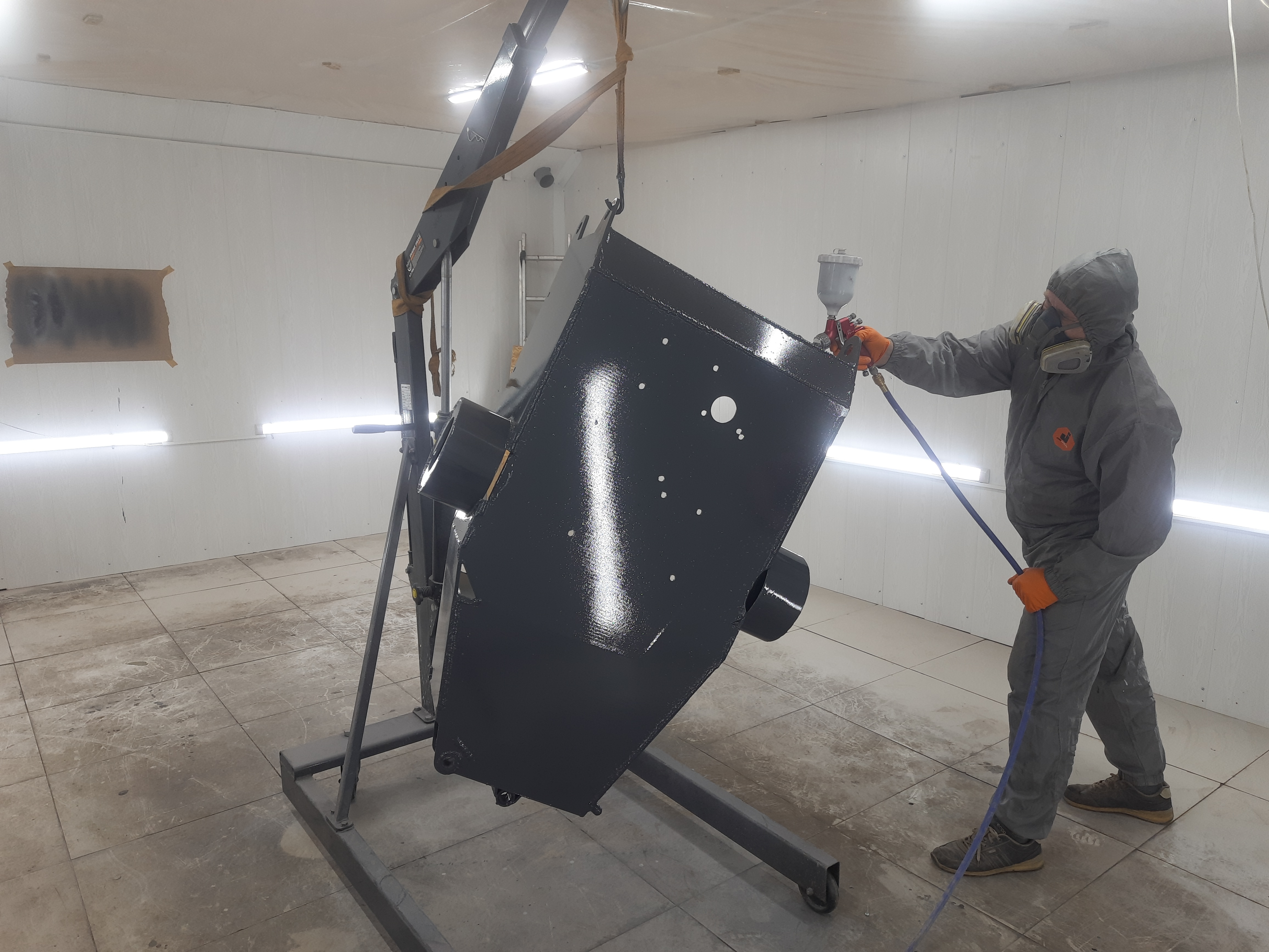

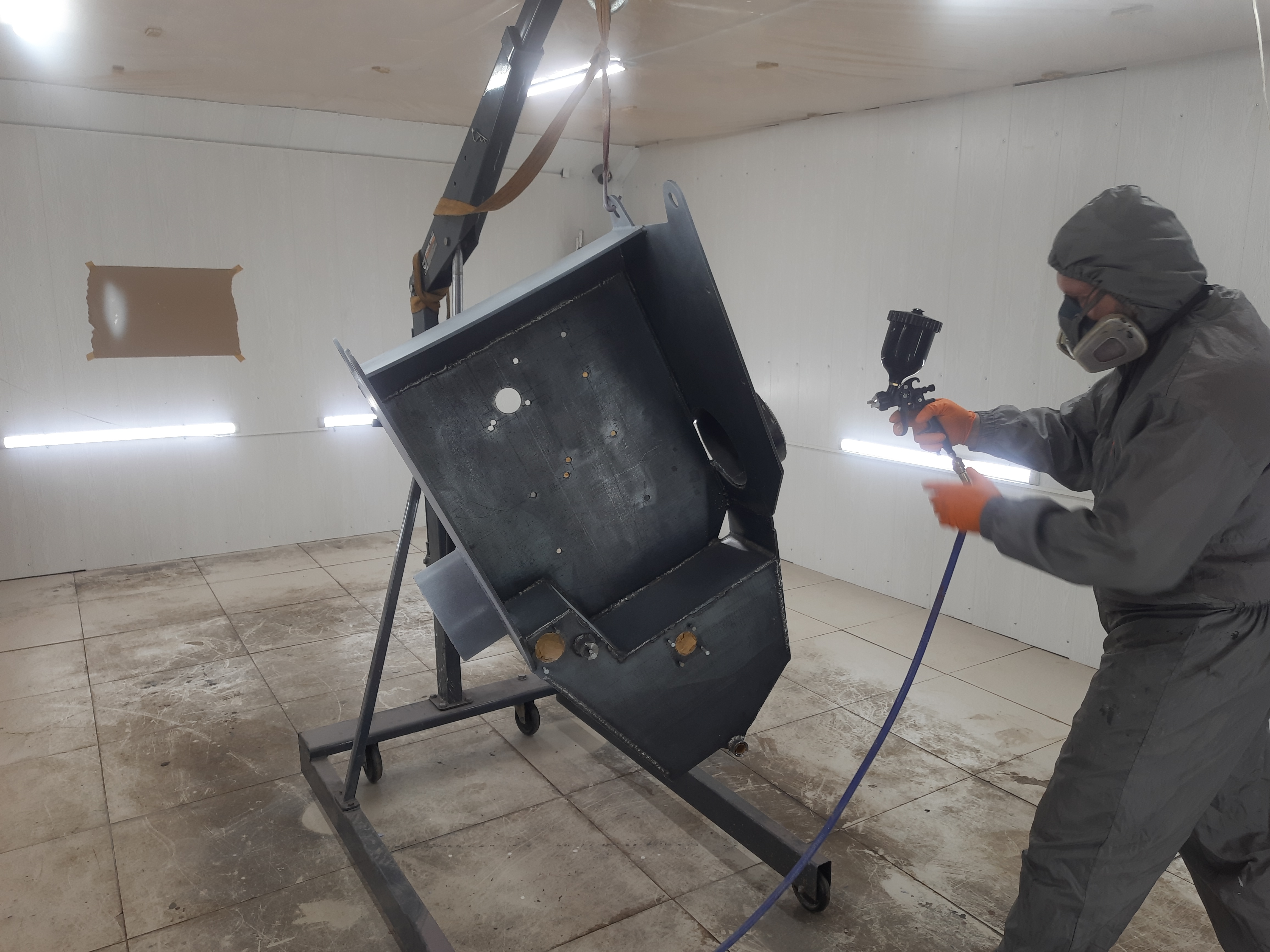

Thank you for the kind words. I appreciate it! Now, the continuation. So, I hung the parts of the loader in the air and started painting. First, the epoxy primer, then the enamel. Unfortunately, I miscalculated the amount of paint, and the front part received less than I would have liked.

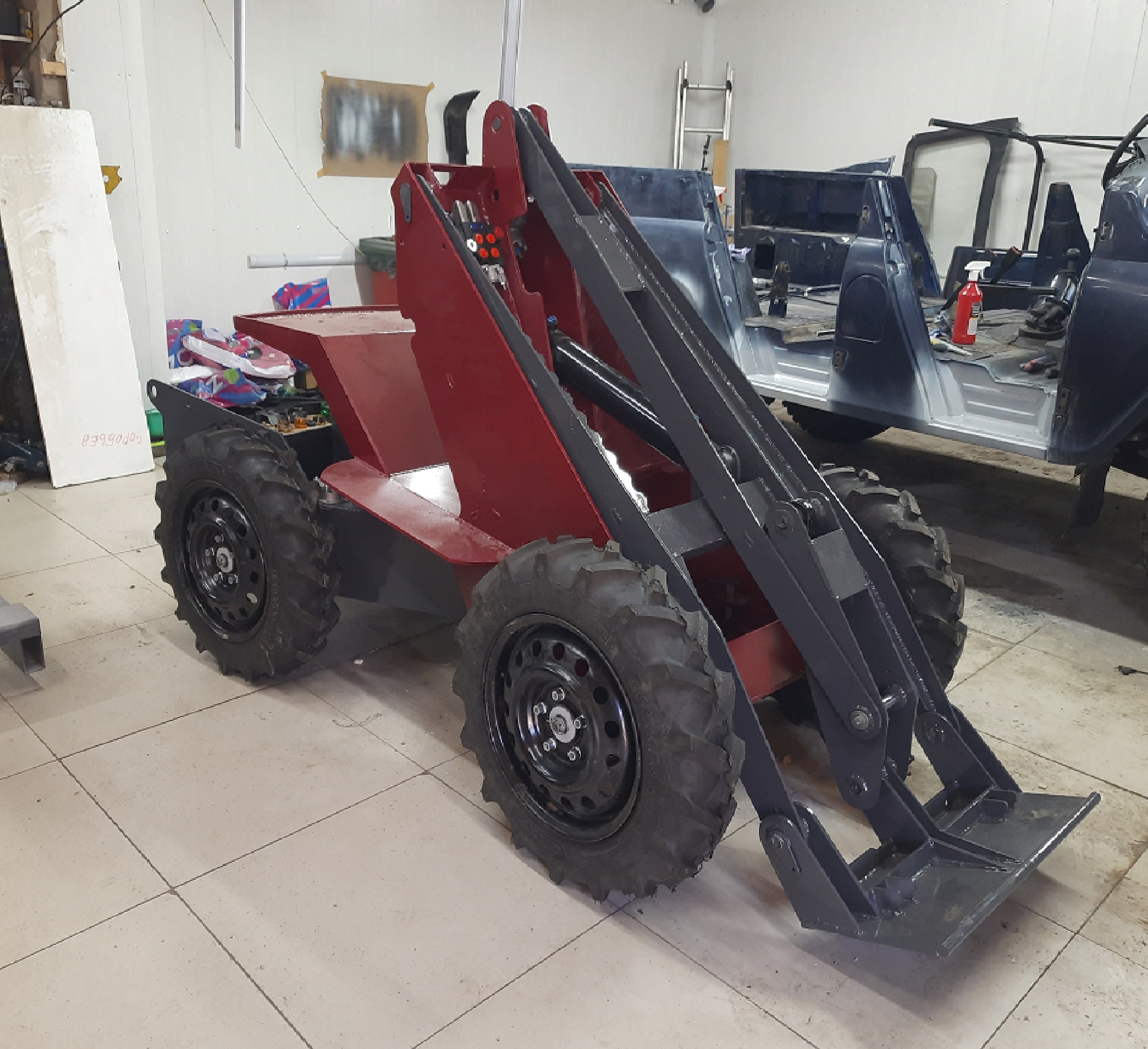

I think it turned out pretty well and, most importantly, it's unusual. I haven't seen this kind of color on work equipment before. I need to think, maybe I should make them my "Colors"?)))

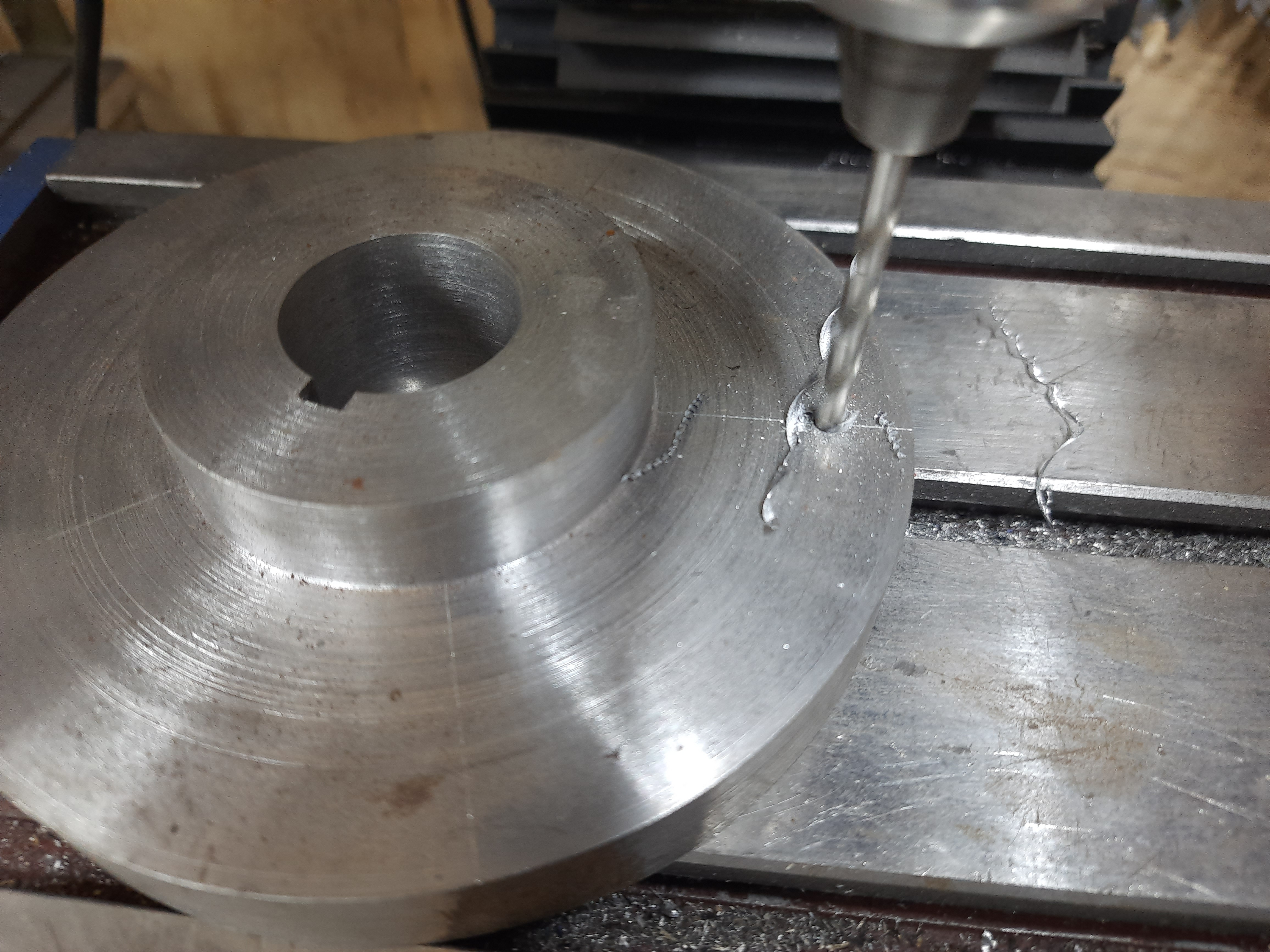

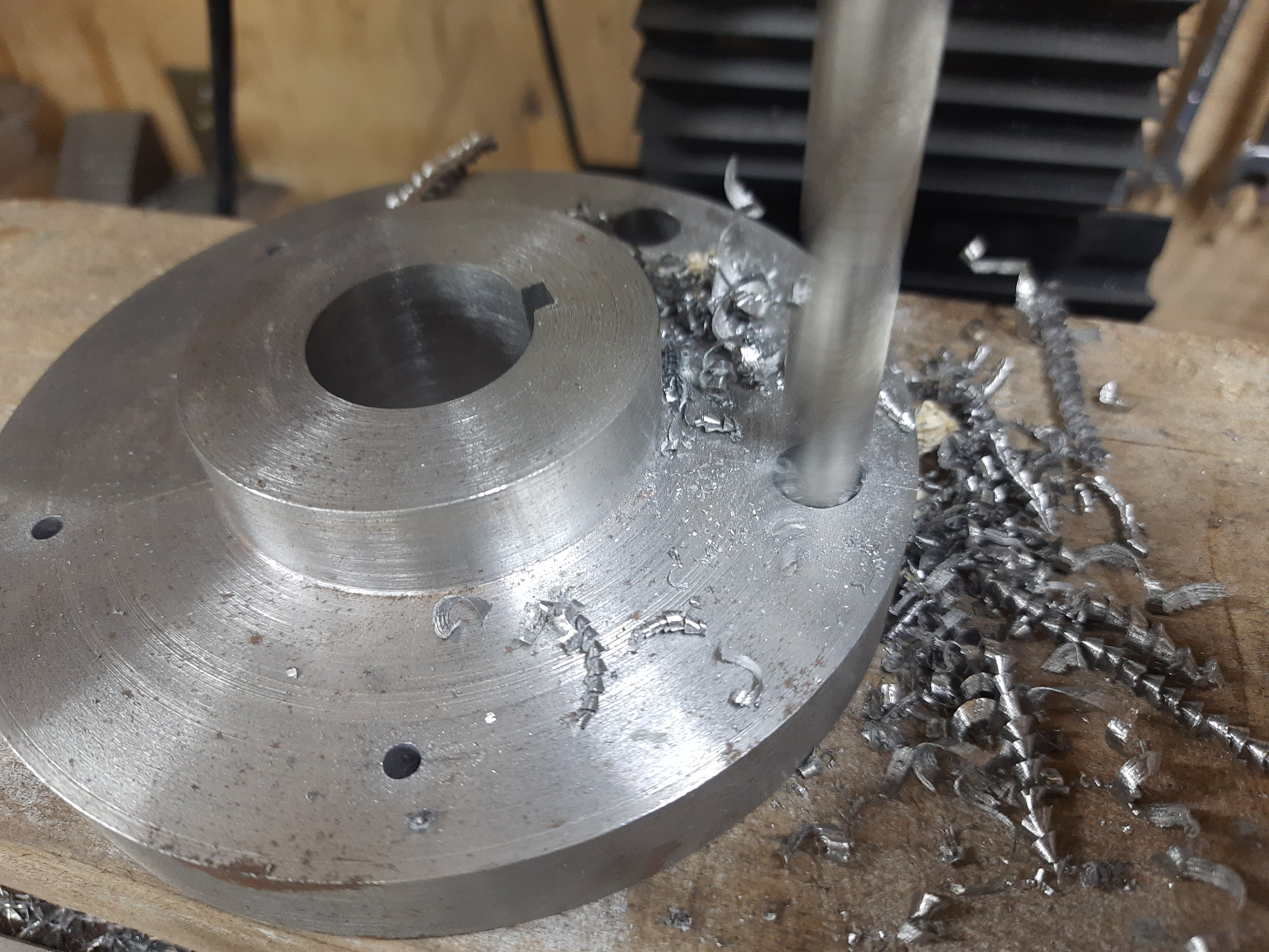

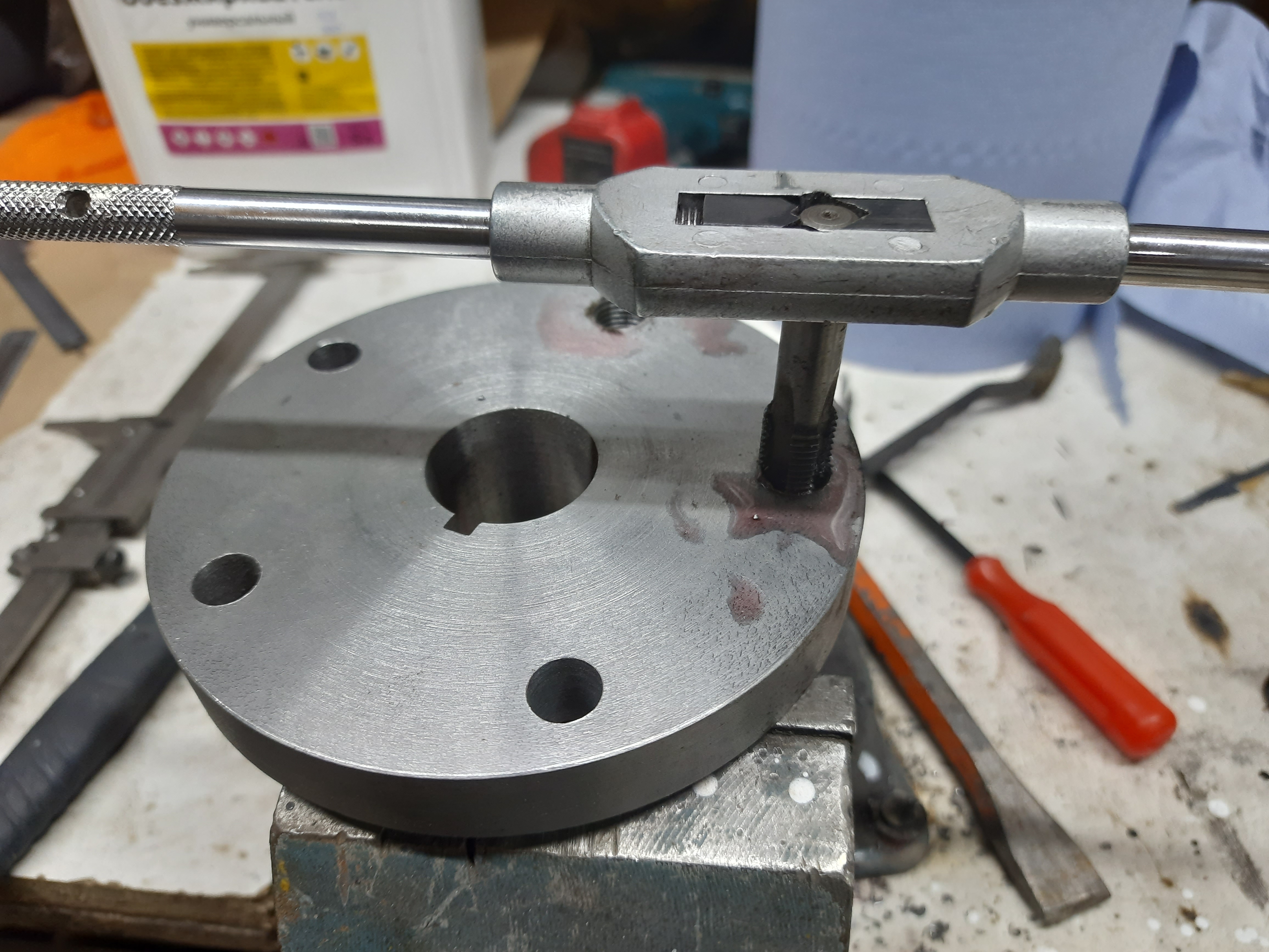

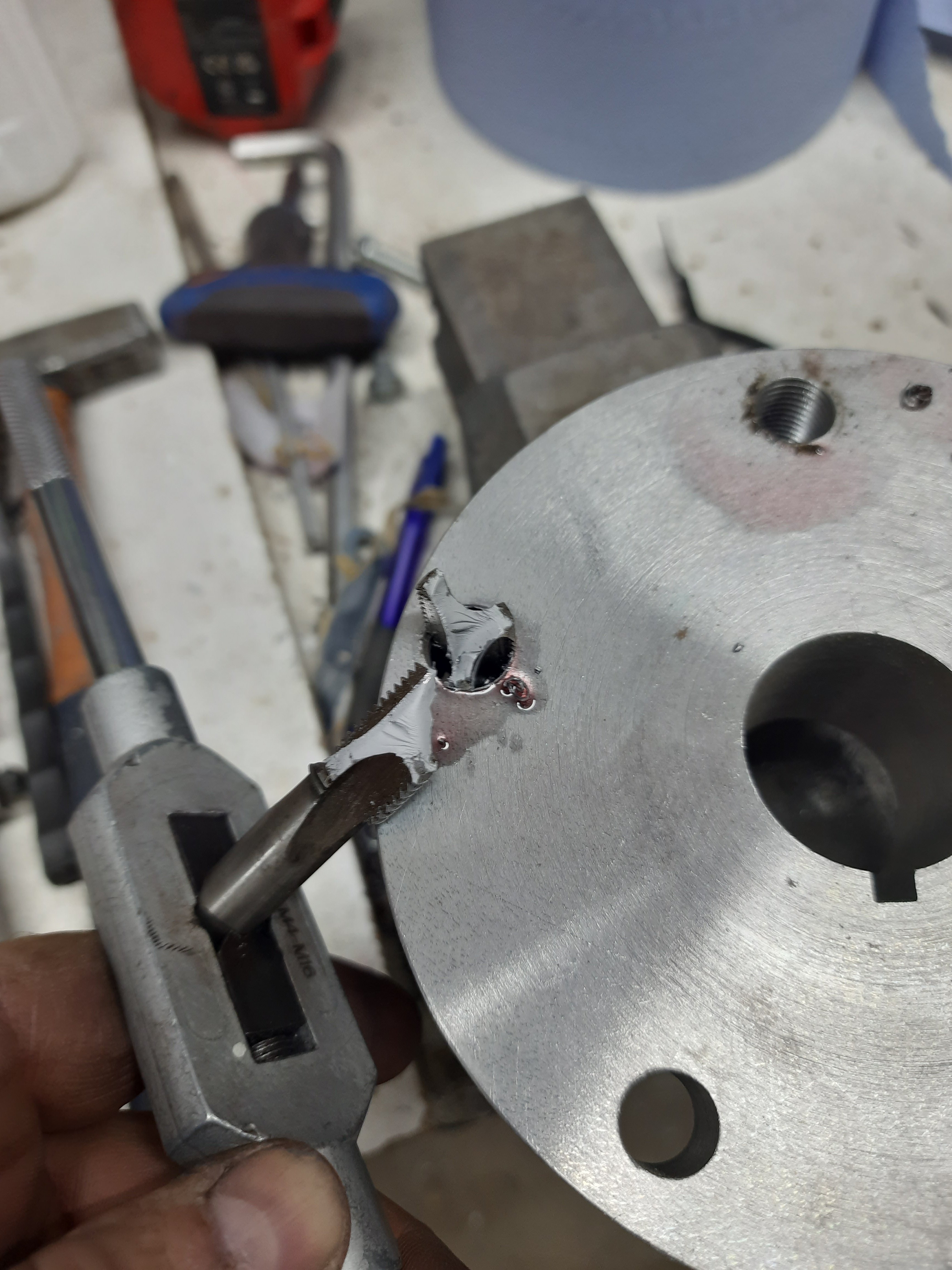

The paint has dried and now I can put it on wheels. For this, I need to finish the wheel hubs. I specifically use regular car rims so that in case of damage I won't have to look for special ones and pay three times more. I have already turned the hubs on a lathe. It remains to make holes and cut threads.
The old man's tool from the USSR couldn't take it...poor thing.

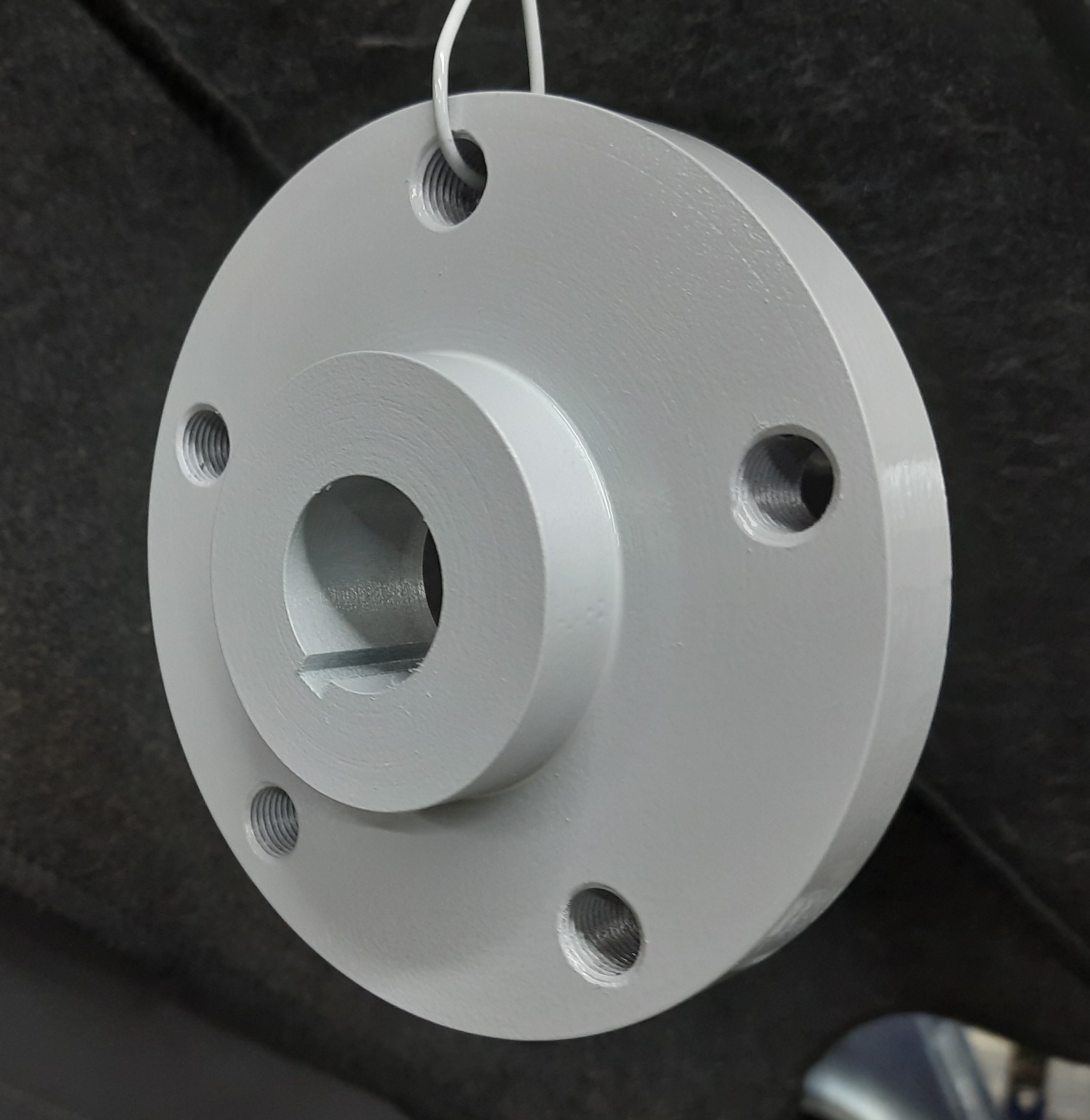

I also apply epoxy primer to the hub. It shouldn't rust.

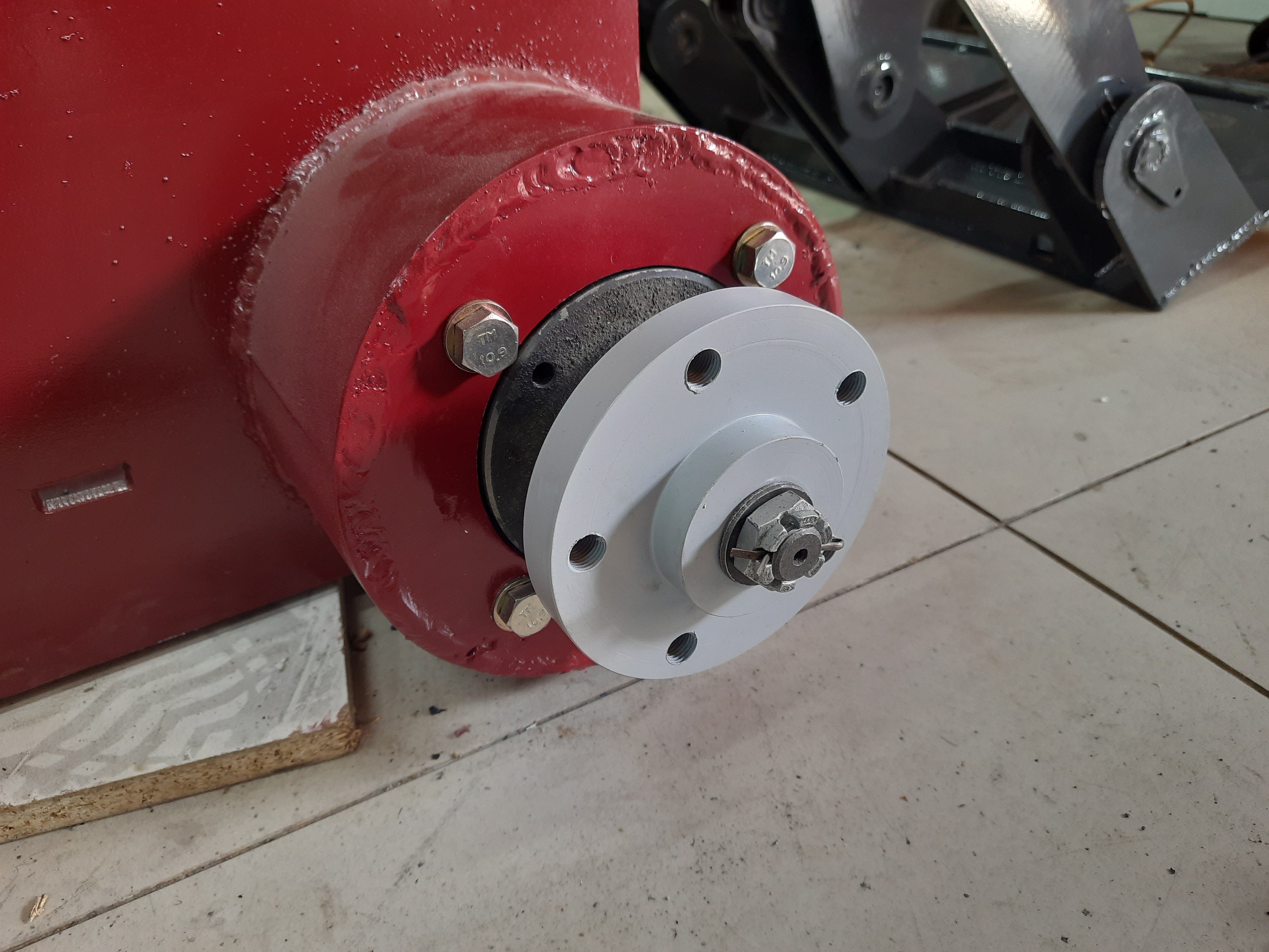

Sliding the hubs into their spots! We're talking cone-shaped fittings, snugged tight with a nut and cotter pin.

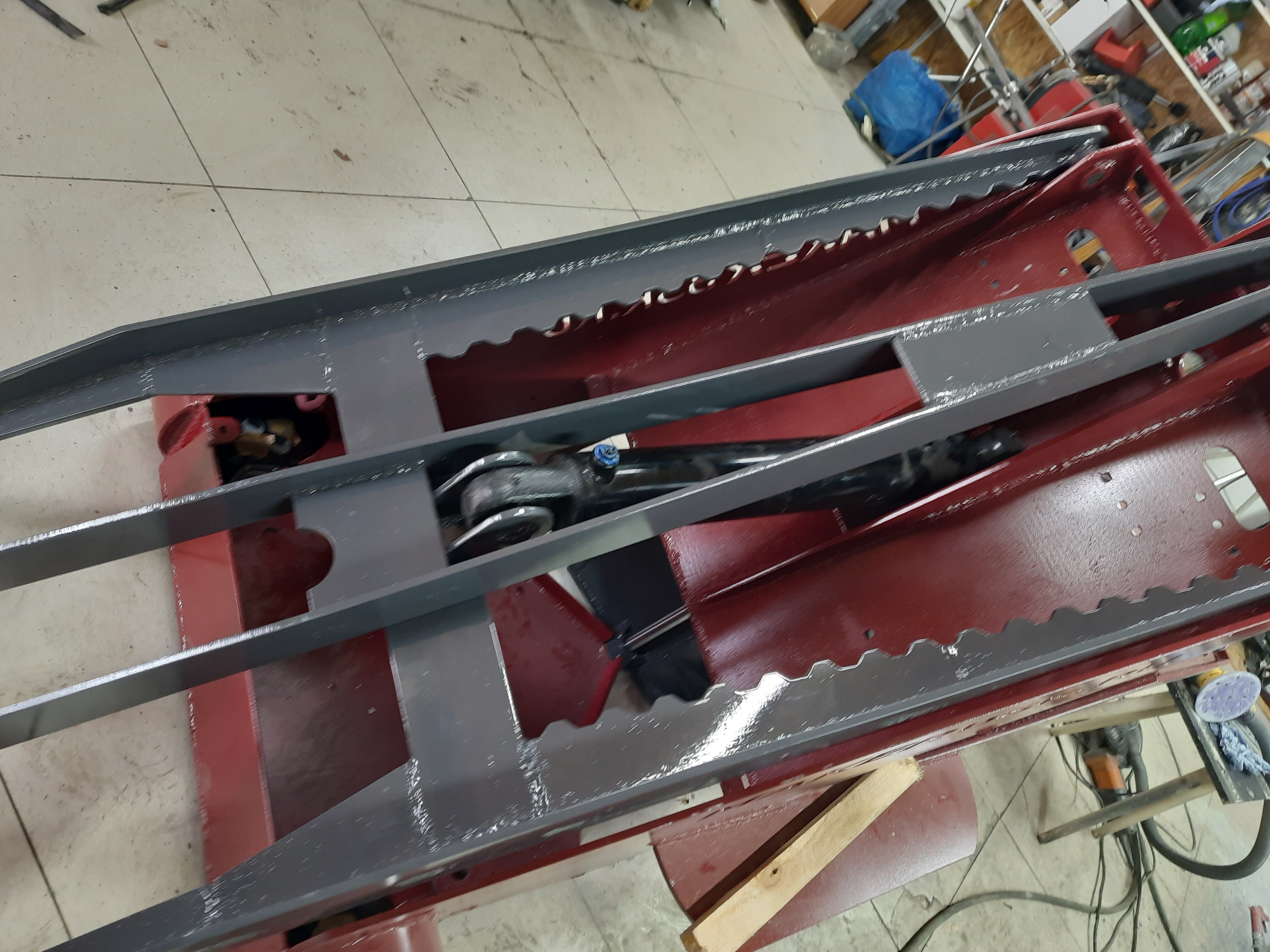

Just slapping on the boom, tipper plate, and both hydro cylinders now!

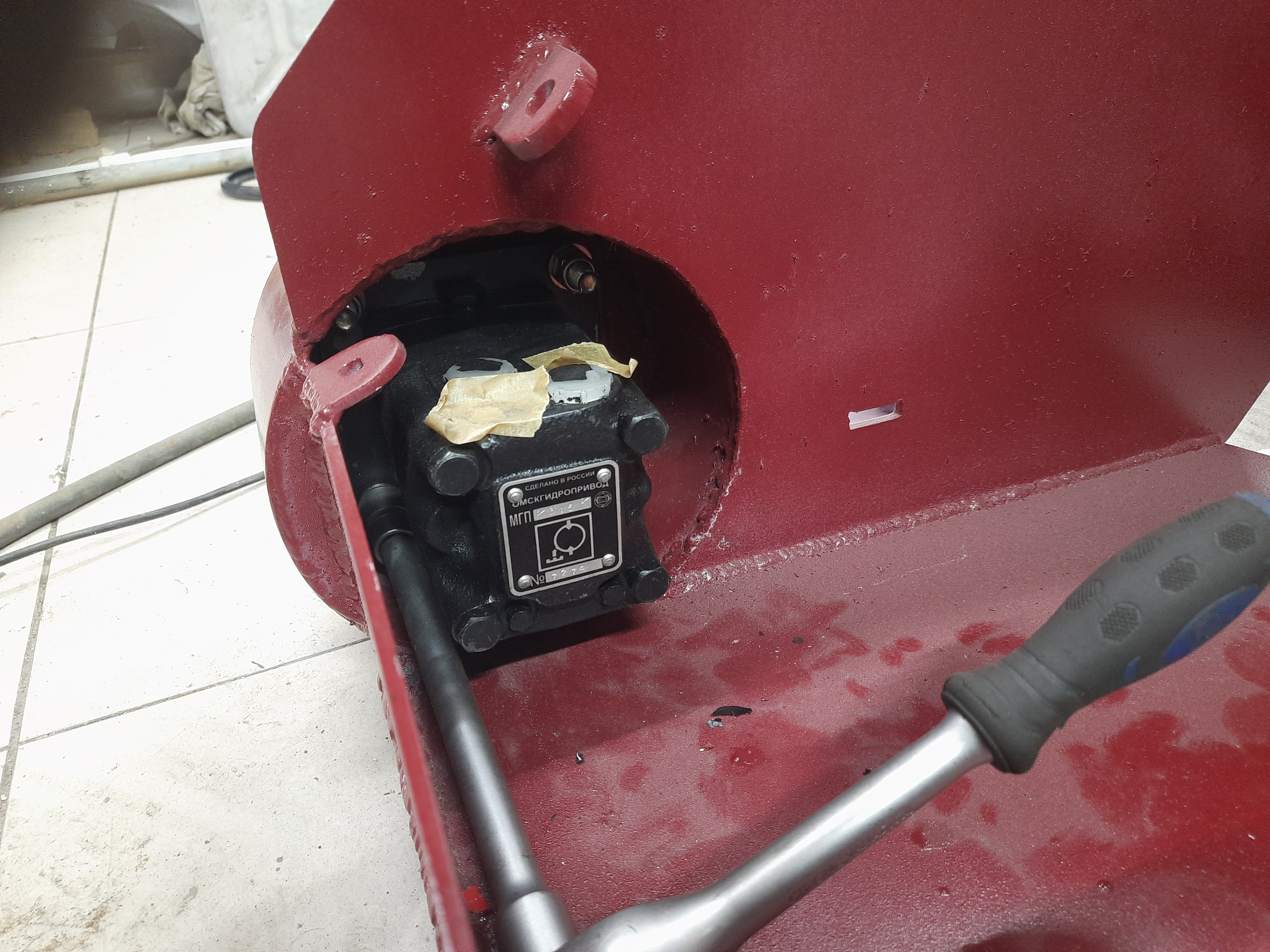

The main driving force will be oil. Therefore, a low-power motor capable of driving the oil pump is necessary. At first, I chose a single-circuit oil pump with a volume of 10 cm³. However, this will greatly limit the potential of the loader. Practice has shown that when all consumers - motors, hydraulic cylinders, and the swing pump - are connected in series, it is impossible to achieve simultaneous operation. Only one at a time. Therefore, I used a dual-circuit pump. The movement is one circuit, the lifting of the boom and rotation is the second circuit. Of course, three circuits would be even better, but the cost of such a pump is significantly inflated, and as I mentioned earlier, I am looking for a cost-effective yet functional machine option.
