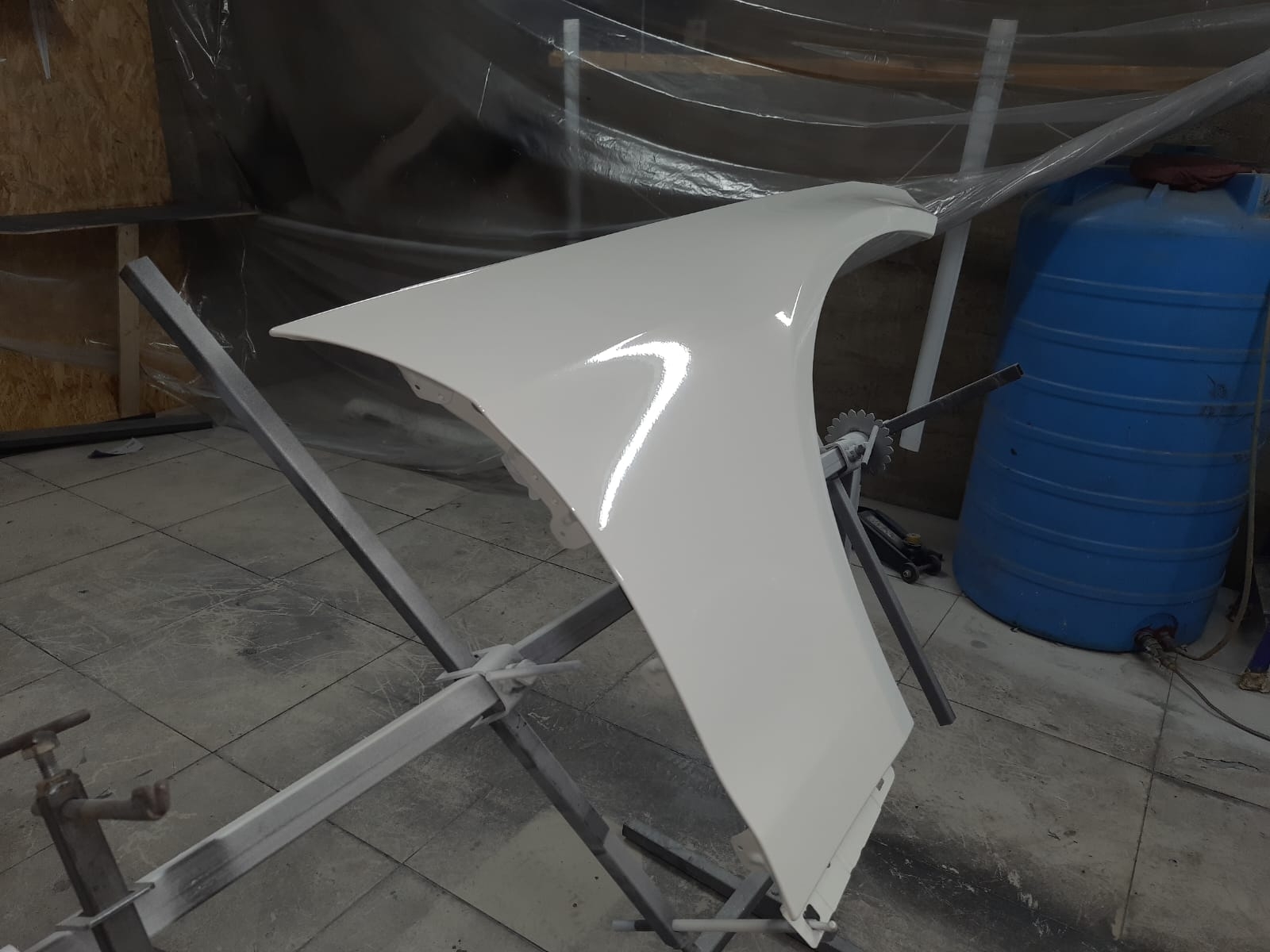

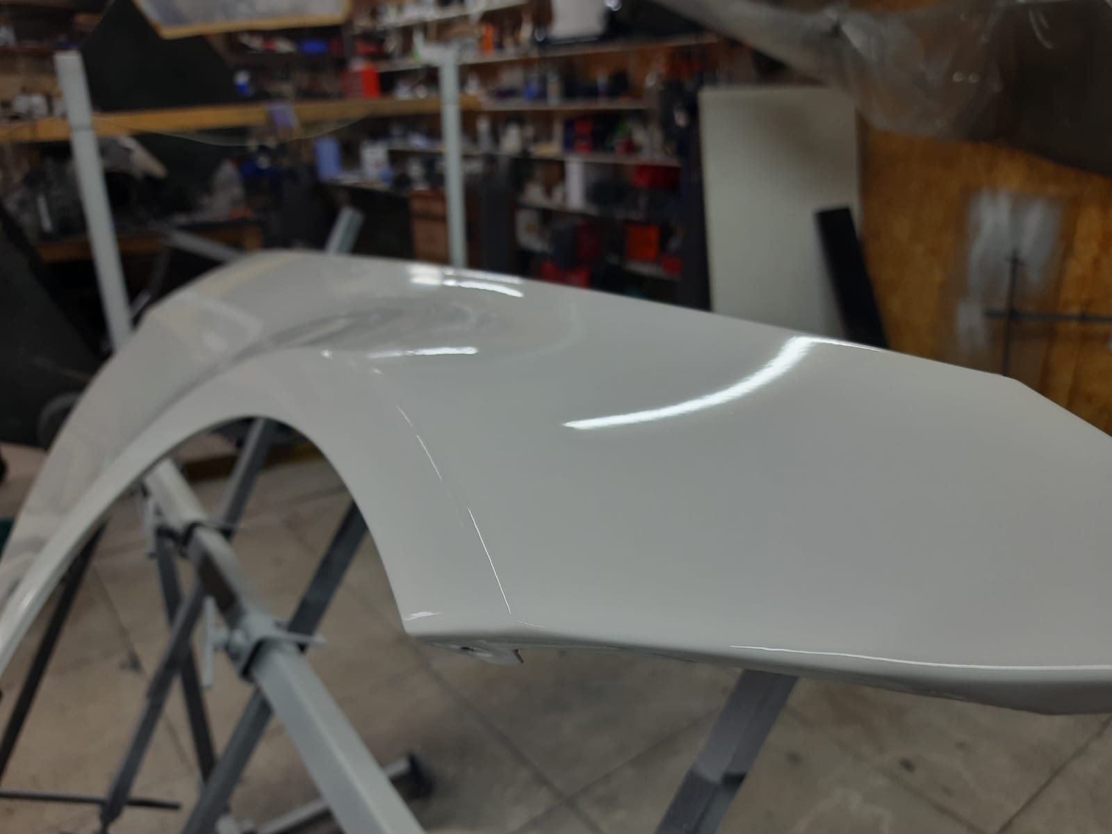

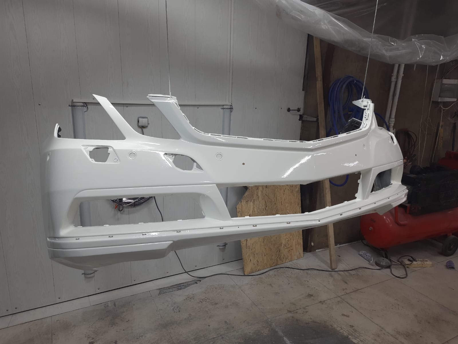

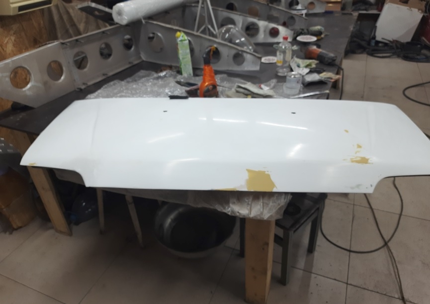

Dabbling between tasks, slapping some paint on another car!
