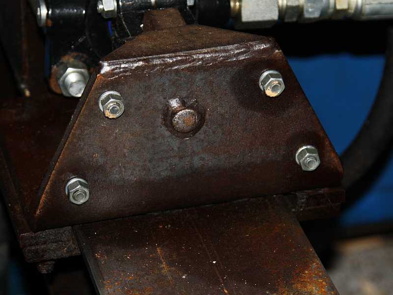

Thallman, you are going to have to extend the length of the push plate slide, the bottom of the push plate should be as long as it is high, if you look at the one we built we only have 6 bolts, 3 on each side. The bottom slide is only 1/2 inch material, this goes in almost all the way to the web on the Ibeam.
the other thing we do is to have a slight downward angle on the cylinder toward the push plate.
We also box in the ends of the Ibeam, this adds lot of strength to it and helps to keep the top plate from twisting. Looks like you are going to have to damage that nice paint job..... Jim

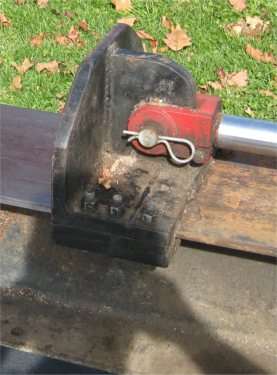

here's a better pic of the push plate, this unit has 646 hrs on it.

I would do as Jim said (;the other thing we do is to have a slight downward angle on the cylinder toward the push plate.;) and make sure the leading edge of the plate running on the I beam isn't sharp. Lee

Thallman, you are going to have to extend the length of the push plate slide, the bottom of the push plate should be as long as it is high..... Jim
Thanks Jim, this confirmed to me what I was thinking. I used some really thick material when building this push plate (1"+) --it's heavier than my tractor :D -- I think though you are right about it being as long as it is high. I really like how tall it is. I'm hoping I can get some left over scrap metal to fit under the cylinder and then weld on some gussets to fix my problem. I'll post pictures of the results.
For now it still splitts everything I throw at it fine, but I hate "splitting on eggs shells" and having to watch every step I make --though maybe that will help my keep all my extremities.

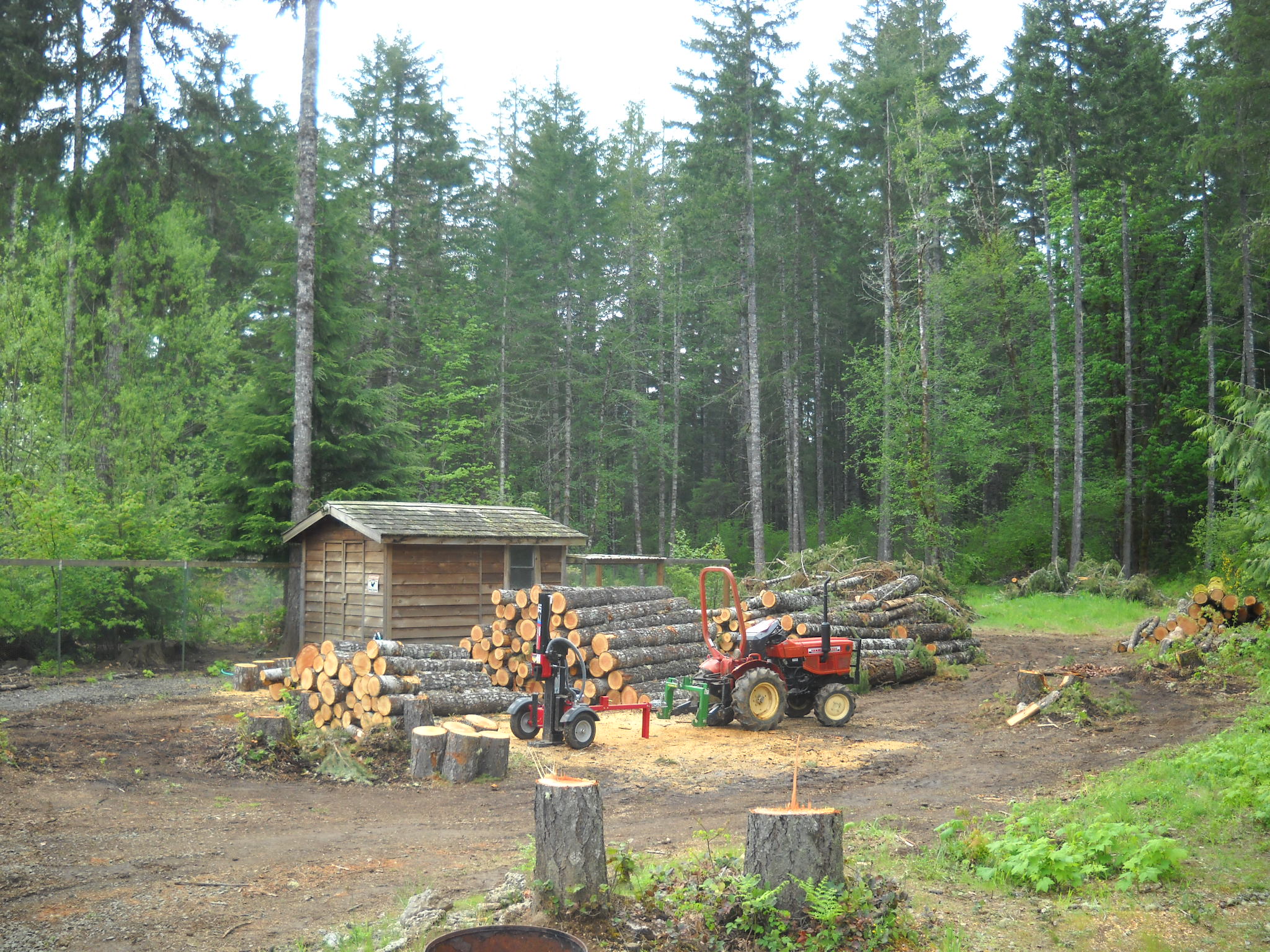

I built my splitter up from acquired scrap. The main beam is 4X4X1/4 tube. The foot is an old railroad tie iron. The wedge is built up from any scrap I could use. The slide is 6 inches of 5X5X3/8 tube (the only part except the cylinder that I bought). I put four nickel-sized blobs of bronze inside the top/front and bottom/back sides of the slide and two blobs to center it were put in each of the sides. I ground the blobs flat until the slide just fit over the main beam. I smear a little grease where the bronze contacts the beam now and then. It runs very smooth. When I hear the first squeak, I grease it (not very often).
I had not been around, or used, any splitters and I guess I just lucked out on that part. I made my mistakes on the size of the cylinder. I just saw those remote hydraulic connects on my tractor and thought, "why not?"
I mounted it on the right end of my box scraper and it tips from horizontal, with the splitting at belt height, to vertical, with the foot flat on the ground for those big rounds that I horse around with a pickaroon. I have just set up a linkage to the remote lever on my new LS R4010 so I can stand right by the splitter while I operate it (like I did with my old Cub Cadet). I have a receiver hitch on the scraper to pull my wood cart, which I jackknife to the right so the wood all but falls into it off the splitter.
When I get set up to post pics, I'll show it.

Thanks for the compliments. The push-plate problem was solved by making the surface of the push plate which touches the I-beam longer than the part that pushes the wood. I started out with the cylinder a hare from perfectly horizontal (pushing downwards just a smidge) which, in theory, should keep the splitter from binding. Instead of extending the bottom portion I simply flipped mine around now using the pushing part of the plate as the base and the base now, the pusher. I'll post pictures soon so those of you here can compare the before and after.

QUICK UPDATE:
I re-constructed the push plate as shown in the photos below. The photo's show and the "rough" looking version. I didn't want to grind and paint it to perfection until I've run this new design more. I worked with it tonight and it works so far (knock on wood) like a charm :D

I have a suggestion for ya. My pusher was smooth like yours except for 1 bump in the middle and I had a problem with wood that wasn't cut quite square trying to slide off the pusher. One popped out and almost caught me in the family jewels. I solved that problem by putting a few bolts in the perimeter of the push plate. Those nuts (pun intended) sink into the rounds quite nicely and stop any lateral movement.

I have a suggestion for ya.... putting a few bolts in the perimeter of the push plate. Those nuts (pun intended) sink into the rounds quite nicely and stop any lateral movement.
Ian
attachment.php
Thanks Ian, that was actually going to be my next step if needed. I already have holes there from the previous set-up that would work quite nicely.
