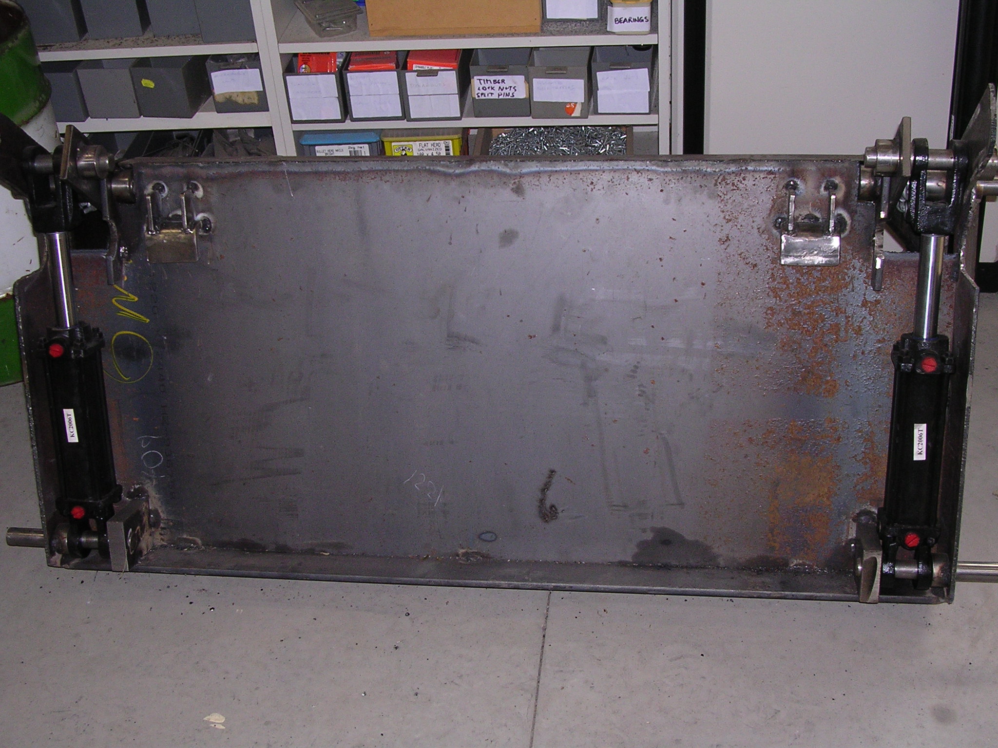

Rohan,
Could you take a couple more pictrues of your bucket quick hitch? Looks like a great method.
Thanks,
John
No worries, but it won't be until the weekend.
BTW its not really my idea, it's a rip off of the JD method.
Cheers
Rohan

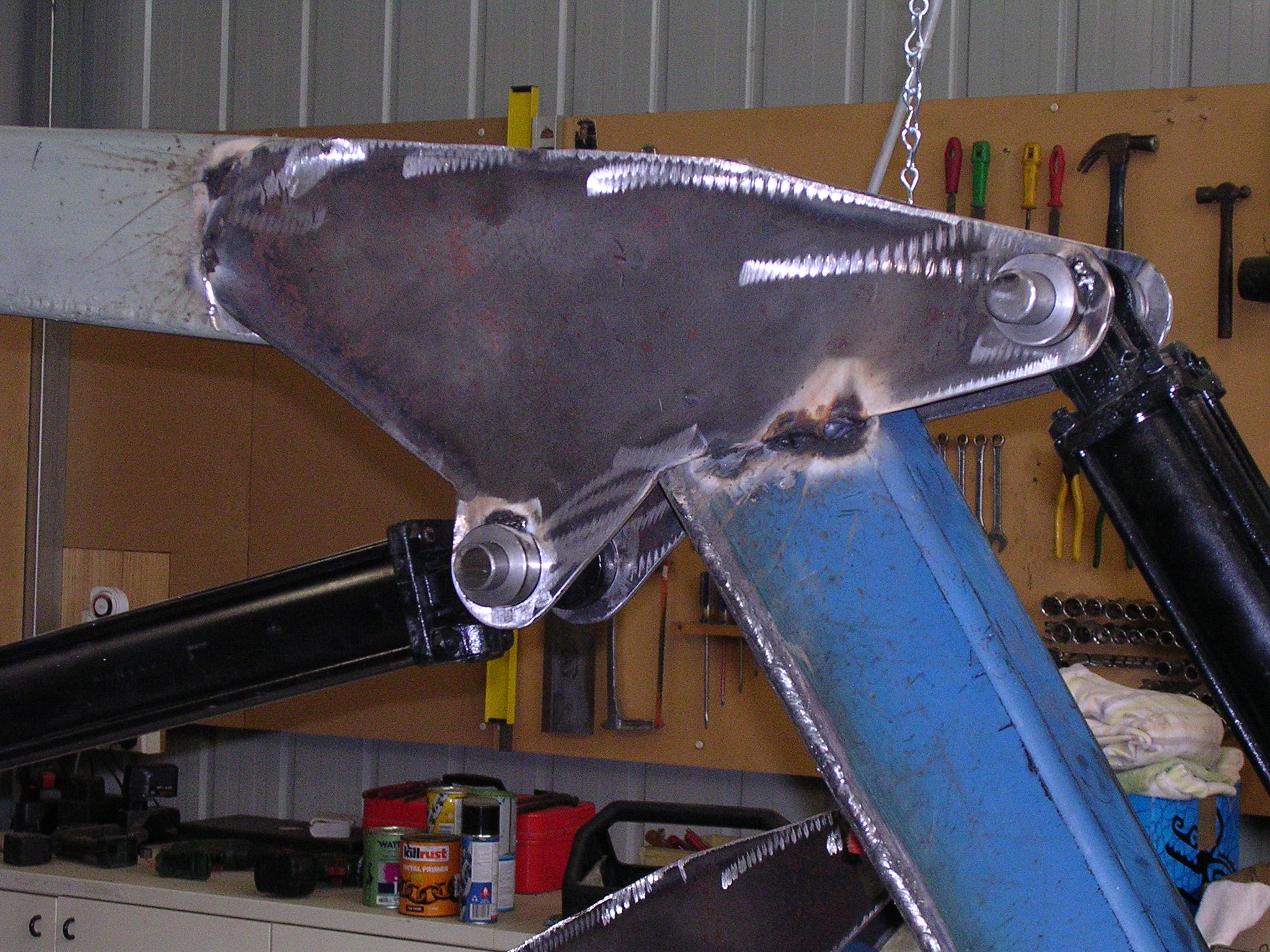

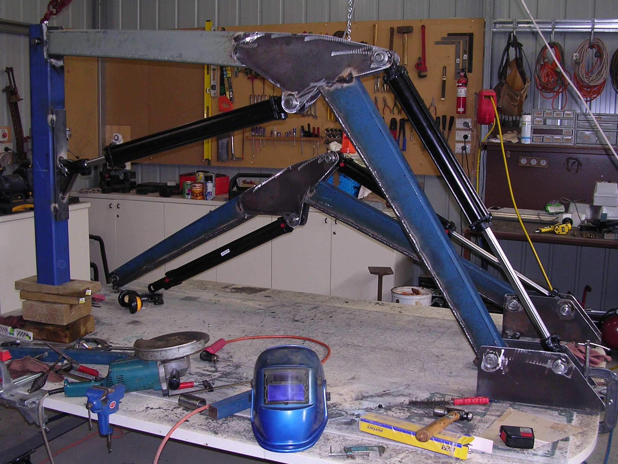

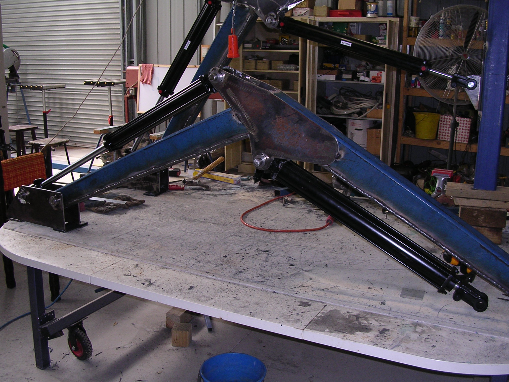

Ok some more work this weekend and some more pics.
It doesen't look like I've done much except turn it over, but there is a lot of work in squaring it up and getting all the moving parts to swing evenly, and not curve like a baseball pitch :(
It would be nice if I could make the hydraulics work as they are, just to make it easier to check everything is nice and smooth, but I dont have a portable hydraulic power pack, and it would probably just make a mess anyway.
I also posted another pic of the attachment points on the back of the bucket, as requested. The Pins that hold the bottom are not in place yet.
Cheers
Rohan

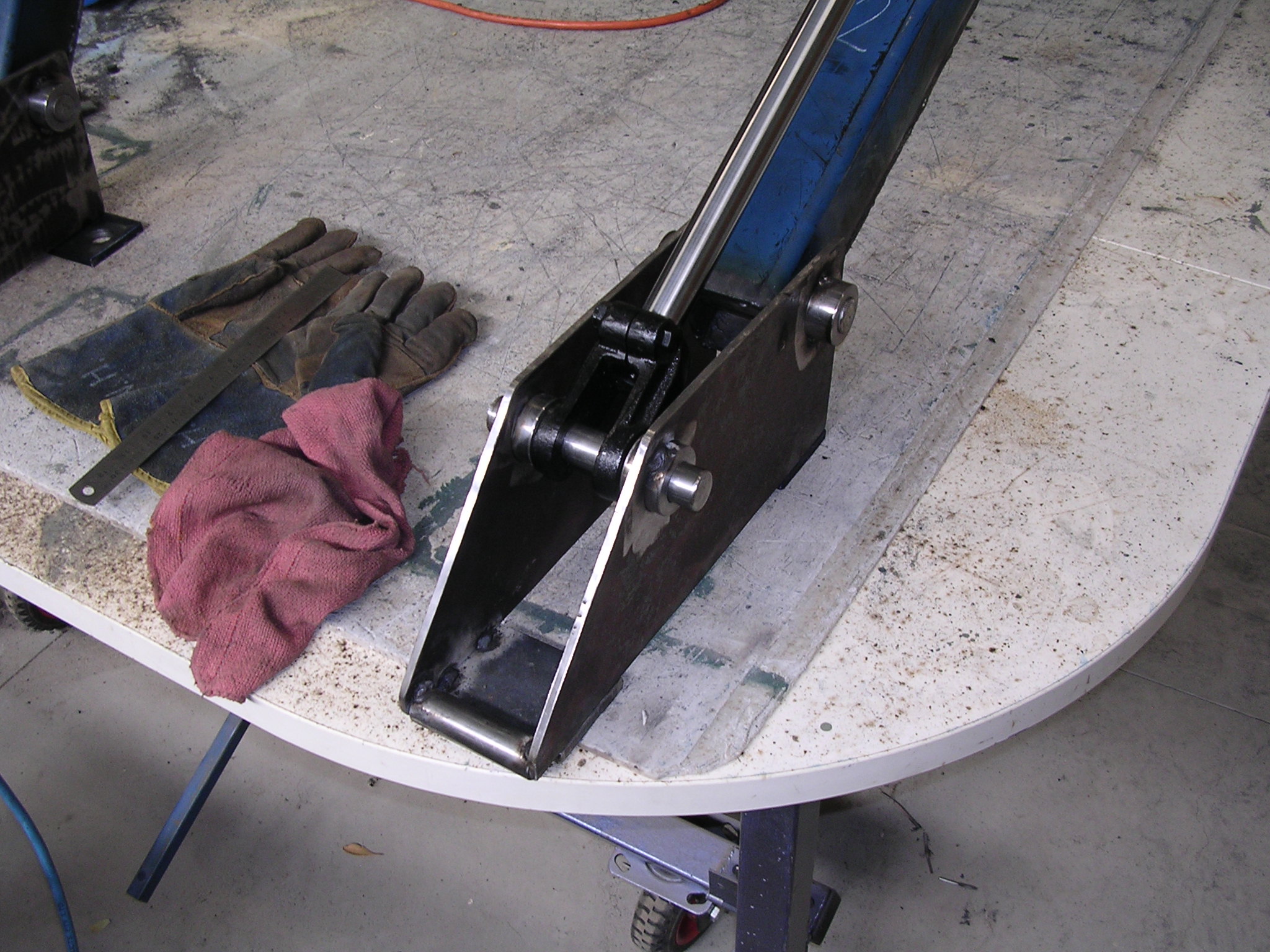

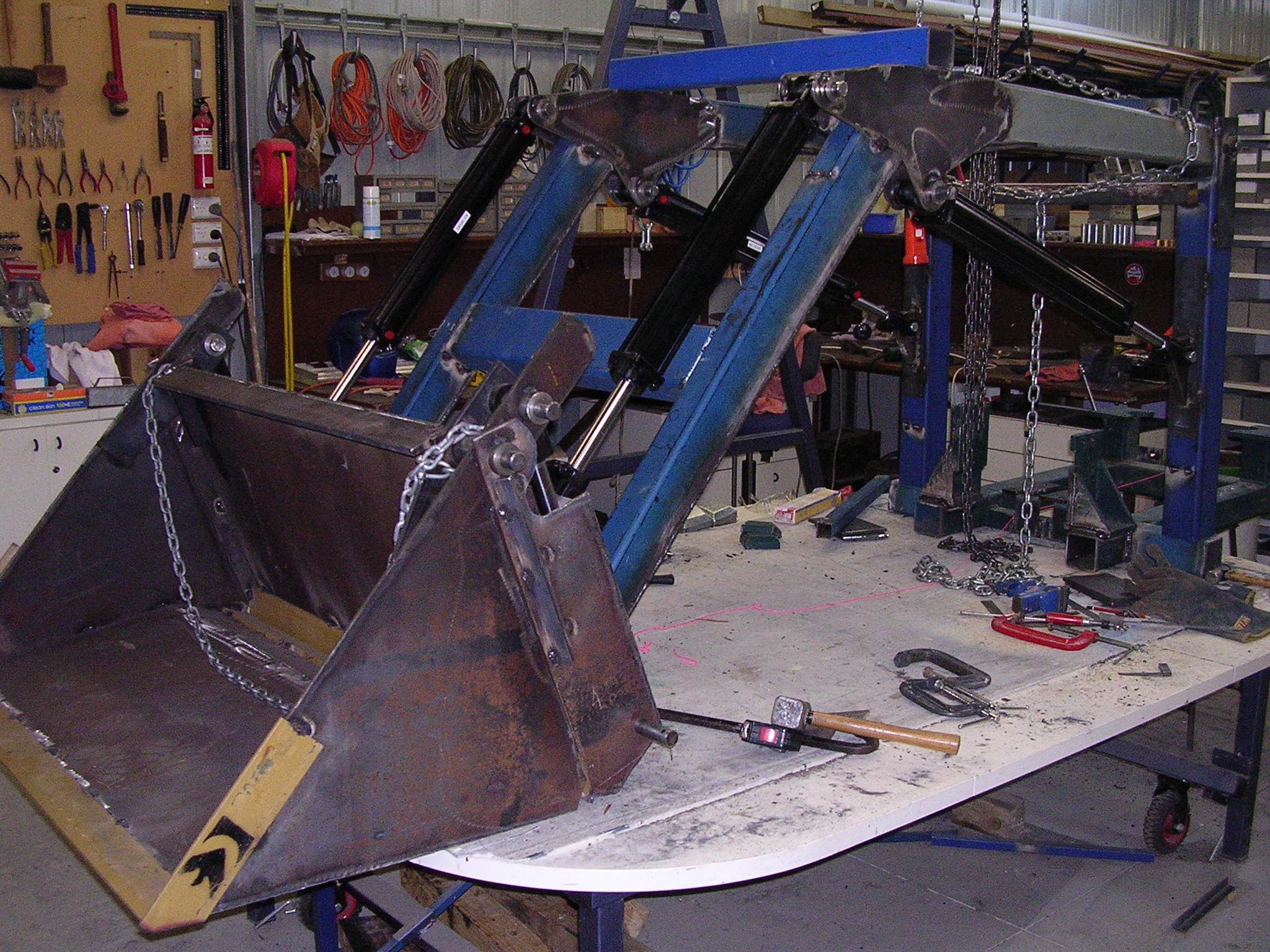

Well another couple of weeks have gone by and a few more days work on the loader.
It is really hot here at the moment, so working in the shed is like some sort of torture.
Anyway, I have made some progress, although it's the little things that take the time.
I removed the existing subframe from the tractor that I made about 6 months ago for my backhoe, and started adapting it to take the loader. There is still a bit of work to go in that area, but it's looking promising.
I had a bit of a scare today, when I ran a string line down the middle of the loader and the subframe to line them up, and they were miles out. I thought I had stuffed something up big time, until I remeasured and found the string was not in the middle at one end... much relieved.
I put the bucket on today to see how it fitted. It took me ages with the hoist and jacks and things to get it to seat in the right place, then I tacked it so I didn't have to go through that again.
I'm nearly ready to have a test fit on the tractor, to see how it all looks, hopefully it will be fine.

Hopefully I'll still be able to see the tractor. Once I put the bucket in place and stood back, it looks pretty big :eek:
I still have to cut some length off the main posts as they are about 250mm too long, but I thought I would wait for my new bandsaw to arrive for that cut :D

/ My Home built Loader #55

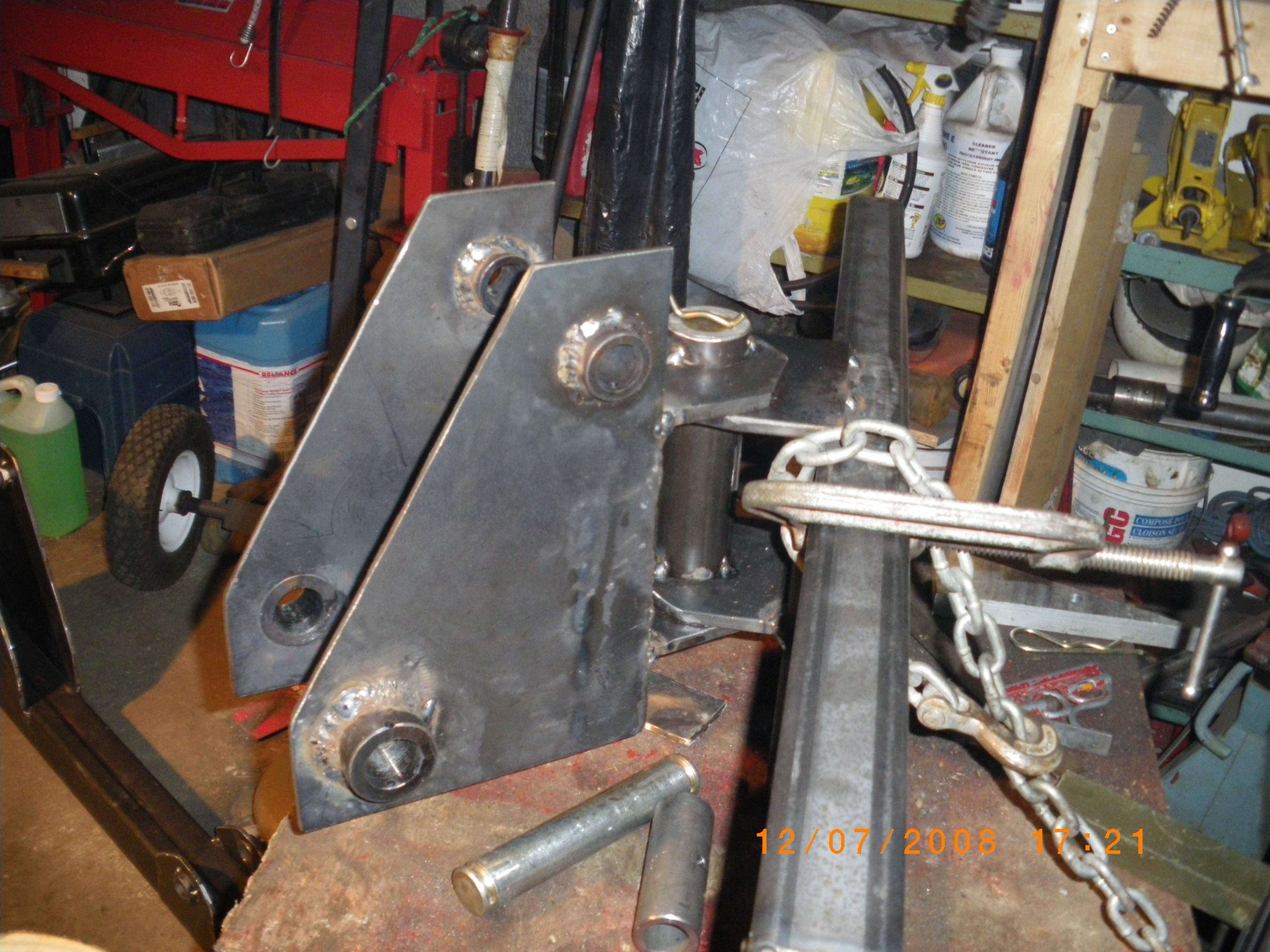

Looking good. Interesting to read about all the time spent making bushings. Bushings and pins were pretty inexpensive at the store I bought my cylinders. I would by a 5" bushing and cut it into 1" or what ever thinkness needed on the bandsaw. You can see an uncut bushing and a pin on the table in this shot.
David, the bushing on the table is relatively thin walled, did you get the thick walled one (as pictured on the bottom of your fabrication) from the same store?
I've never found much heavy wall tube unless I buy 6 metres of what they call "hollow bar" from a steel merchant and that is very expensive.

/ My Home built Loader #57
Rohan, that loader looks really good, you are a legend.
How did you taper the 75 x 125, was it freehand with the grinder?
Hope you're still married!
Most any steel vendor will sell you his minimum length, be it 10 ft, 20 ft or whatever. That tubing is called DOM tubing, and stands for Drawn Over Mandrel. You can get short length from this vendor.
MetKit Corp - Home Page
Select Catalog of parts, Select HTML, Select Bearings, Pins, and Tubing.
#60
I cut a wedge out of each side with an oxy/accet torch, then clamped the bottom in place and welded it.
However I probably wouldn't do it again. The problem is all this sort of fabricated stock still has inbuilt stresses from the manufacturing process, and when you cut it lengthwise like I did some of those stresses are released and it warps. Then combined with the welding heat, it made it very hard to keep it all straight. In fact each arm segment is actually bowed in the vertical direction. Fortunateley it's not enough to be a problem, and it's in the right direction, but it just shows how much steel will change shape when you work it.
Oh, and yes I'm still married :)
