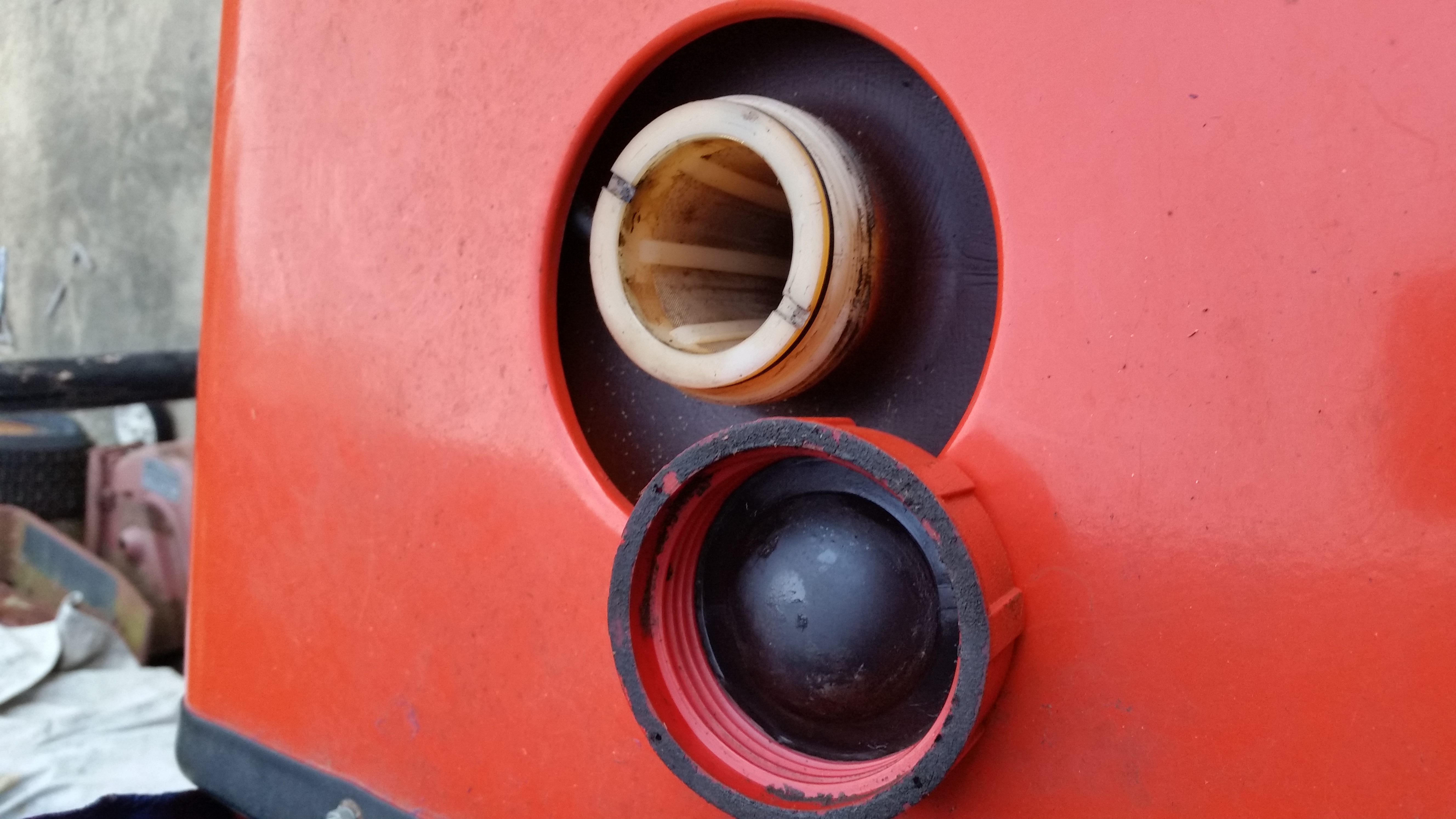

Here is a picture. Under the cap is is rubber like I thought. The strainer has a rubber seal under the lip and the Grove is in the top of strainer to let air into the tank. 20170929_185249.jpg

Well I'm surprised too , I guess it's a symptom oF the thermosyphan system. Cause mine can run at all rpms, but I too have a water pump.

Under the cap is is rubber like I thought. The strainer has a rubber seal under the lip and the Grove is in the top of strainer to let air into the tank.View attachment 523165
Wow, classy. My YM240 doesn't have those notches in its strainer. I assume the YM186 breathes through the gas gauge in its cap. (Because other owners have said rain gets into the tank via the gauge).
Neither tractor has any rubber gaskets, at least not since I've owned them.
