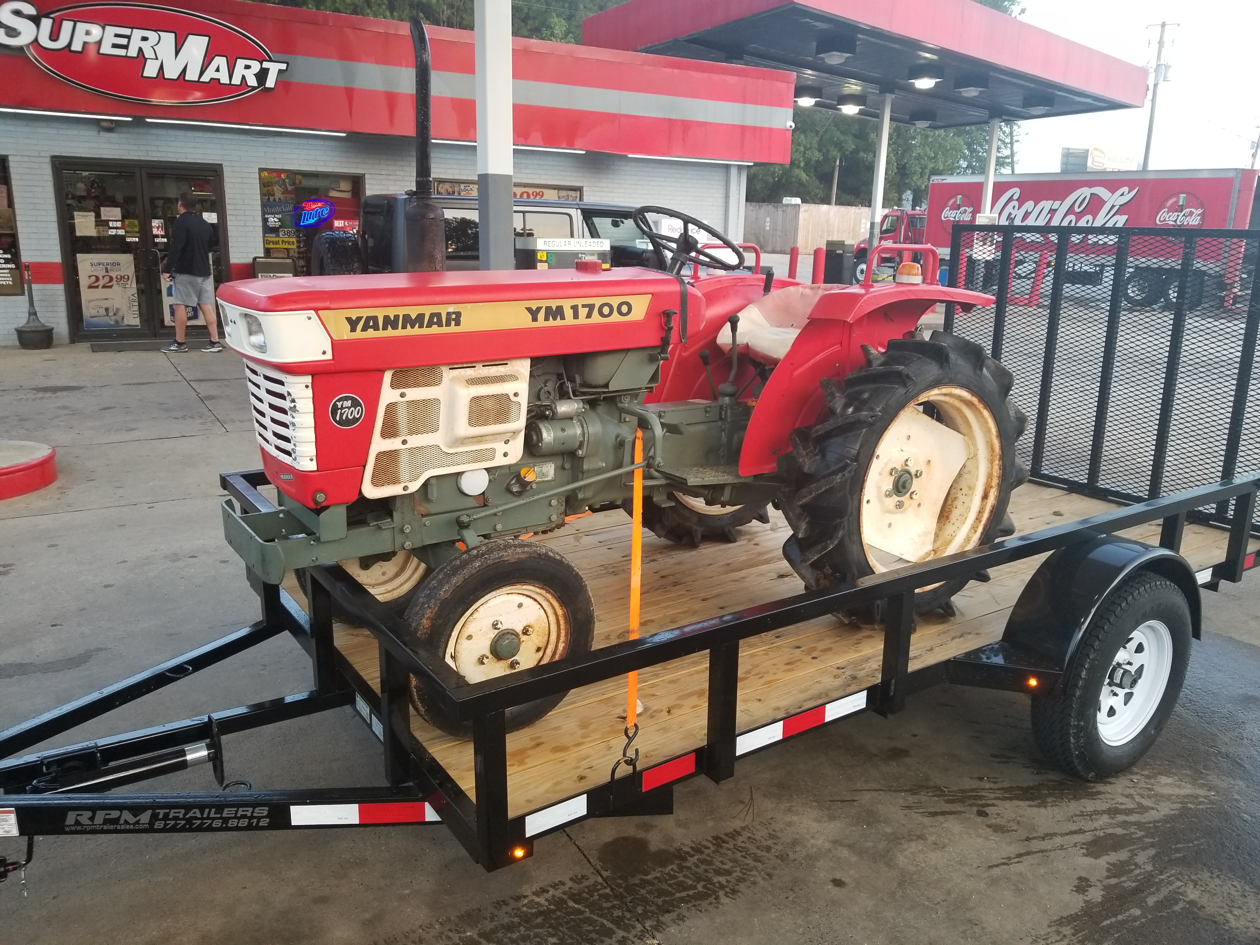

Picked this up today with 700 hours on it for $1,800! I'm pretty happy with the deal!
Clean oil, clean coolant, original paint, everything seems to work perfectly, good lift and PTO, hopefully a great little tractor! All gears are smooth, brakes good, and clutch seems perfect too. The only issue I can find is that it leaks a little at the PTO shaft, there is no play whatsoever so I am assuming it just needs a new seal.
I'll be using this to put in food plots at our hunting club so will be doing some light bush-hogging, single bottom plow or middle buster, and a disc a few times a year.

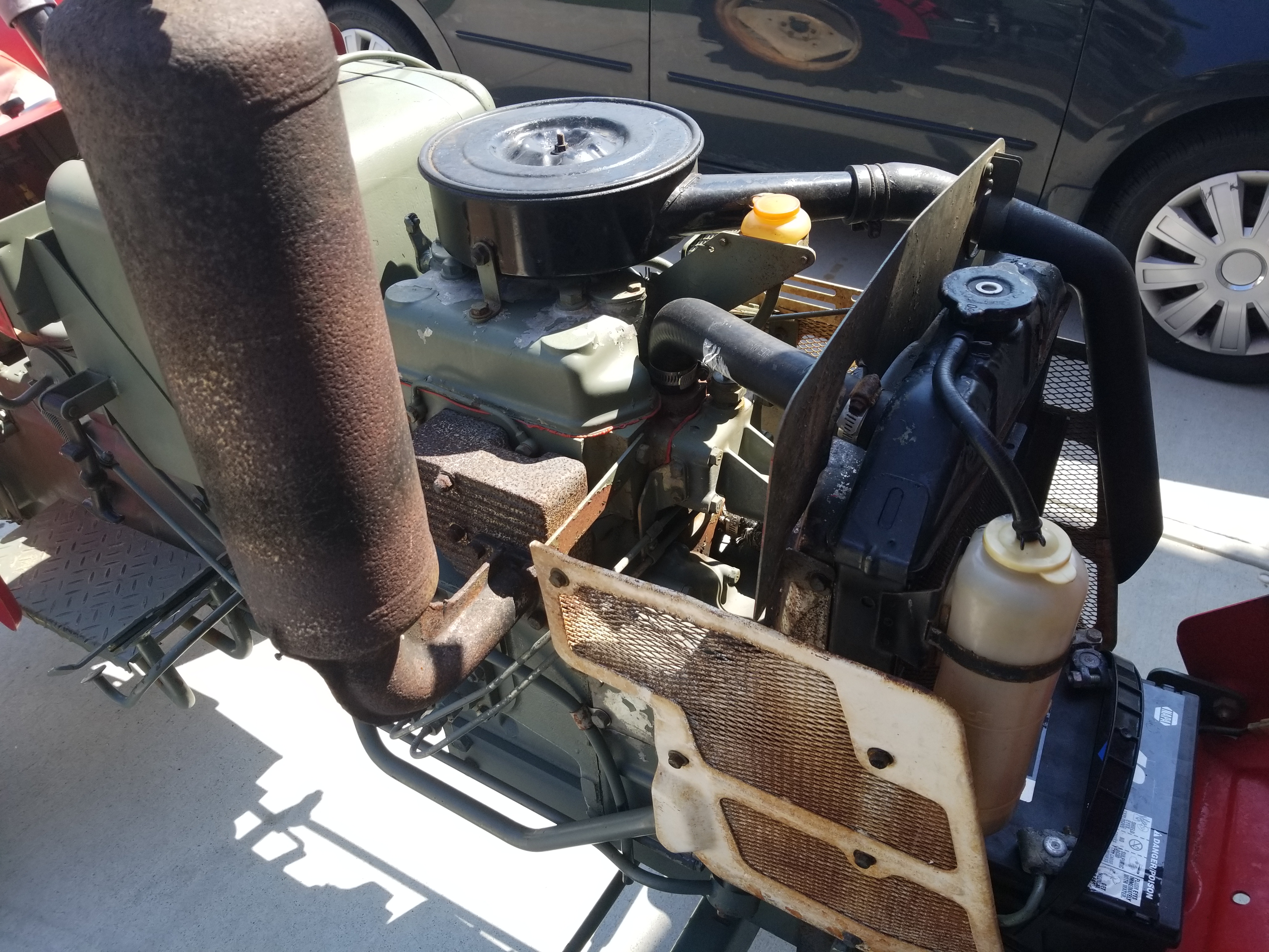

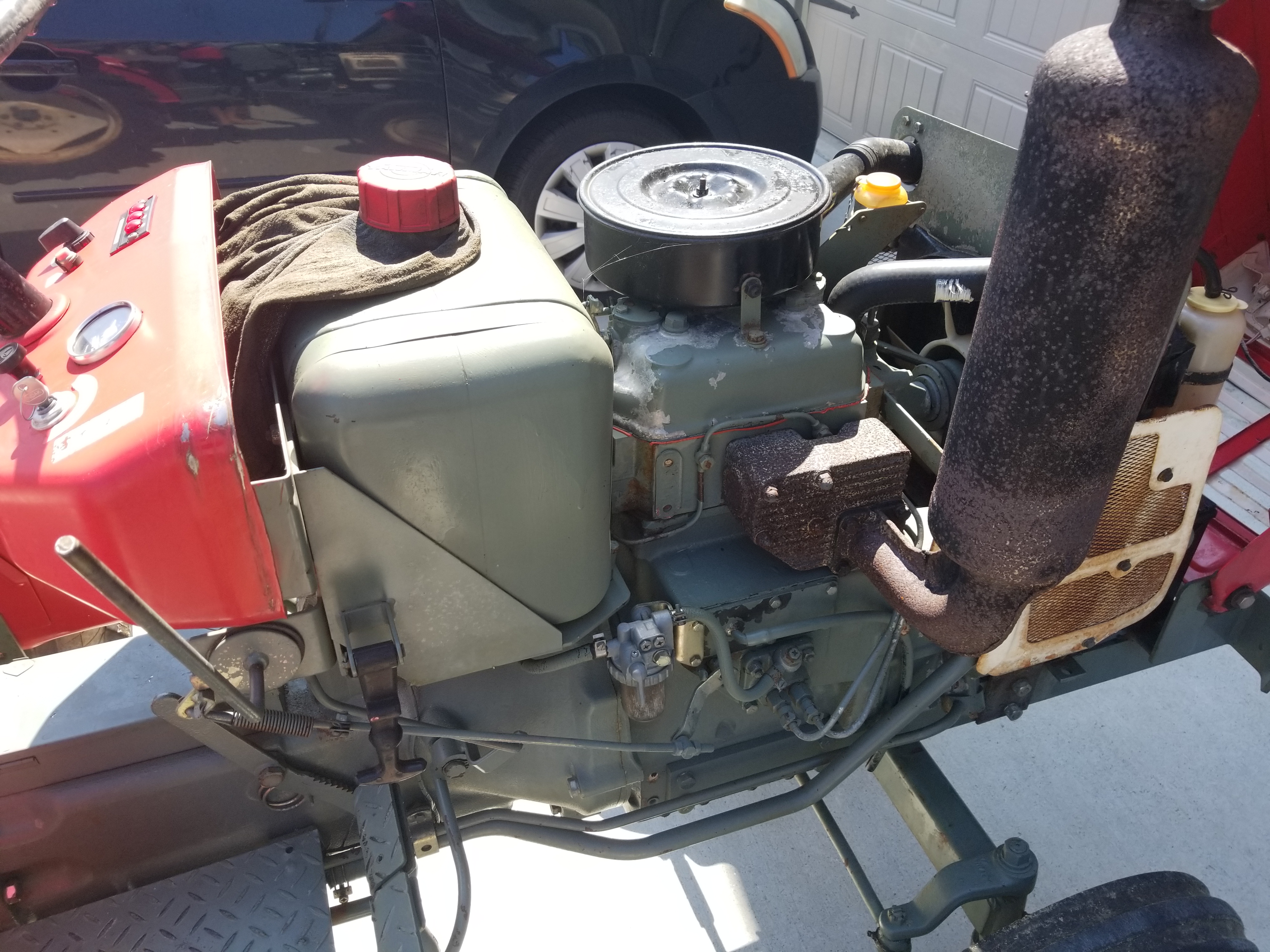

I'll think of more but thanks in advance and here's some pics!

There should be a fuel filter on the right side of tractor. Follow the line out of bottom of fuel tank it should go to a fuel filter boled to the block with a clear fuel bowl then into the pump. If it has one of those inline filters I recommend getting the correct setup from Hoye Tractor, their add is at the top of the main forum page. They also have the fuel filters and others as well. We can list the numbers but you can get the fuel and oil filters from places like carquest or napa if you like, but there not much cheaper in the as of fuel filters from there, the oil filter is just a common Japanese car filter that is used on honda and subarus so it's everywhere.

I see in the pic that you do have the correct fuel fliter assembly, now is there a filter in that clear bowl...I can't tell but I would make sure before I started it again that there was.

Yup, no water pump on mine - 25% fluid and 75% water from what I have read. Was going to flush the radiator tonight - I'll probably just order a new one soon anyway though, this one looks a little rough lol!

Got some more done tonight, flushed the block and the radiator - bunch of crud came out of both, flushed until water was clean. Refilled with new mix of 25/75 coolant/water. Soon as my PTO seal gets here I will be changing it along with the tranny fluid as well as fuel and air filters.

I think it looks in really nice shape. Wax it up and paint the muffler and it would look like new.
If it hold pressure I'd leave it. At most have it ridden out at a real radiator shop. There like $350 new

As for the fuel filter. IF your fuel shutoff at the filter works **** it off. Or pinch the line ahead of filter off with vise grips. Then take the ring off and the bowl will come out. Clean the crud out of rhe bowl and rinse with clean fuel. Put the filter and spring back like it was. Tighten the ring, replace o ring if it looks bad. You can either fill the bowl before you put it on with fuel or not. I dont. And then look on the top of the mount , above the ring. There is 2 Phillips screws. With the bowl on filter in place. Open the one on the top left, closest to upstream fuel. Open the lever or undo your pliars, open the left screw, the filter will fill with fuel and air will bleed out at screw. Levels it open till all air bubbles are gone and stop coming out at screw. Tighten it down, then go to the one right to the right of it. Do the same, fuel and air will come out till just fuel, then tighten it down when air stops coming out. Then look where the fuel line goes to the injection pump. Loosen that screw till the air stops and nothing but fuel without air bubbles comes out. Now your good. You can crank it up and not miss a beat.
Hoye has it also, I'm sure Winston or Claifornia will link you to the page that describes it with pics if you can't follow my description. If you pole around their site it's listed in some section about tech stuff, I just forget where. It might even have a link to it from the screen where you select the fuel filter from the parts diagram?

I have another question too, when I pulled the top radiator hose off the block, the post it slides over is awful corroded/rusty. Like I said, I reverse flushes the block until it was clear coming out but I don't want the post to just rust away lol. Any ideas?
Edit: just looked at a parts diagram and it looks like that piece is replaceable, it looks like a stand alone part that is threaded.
