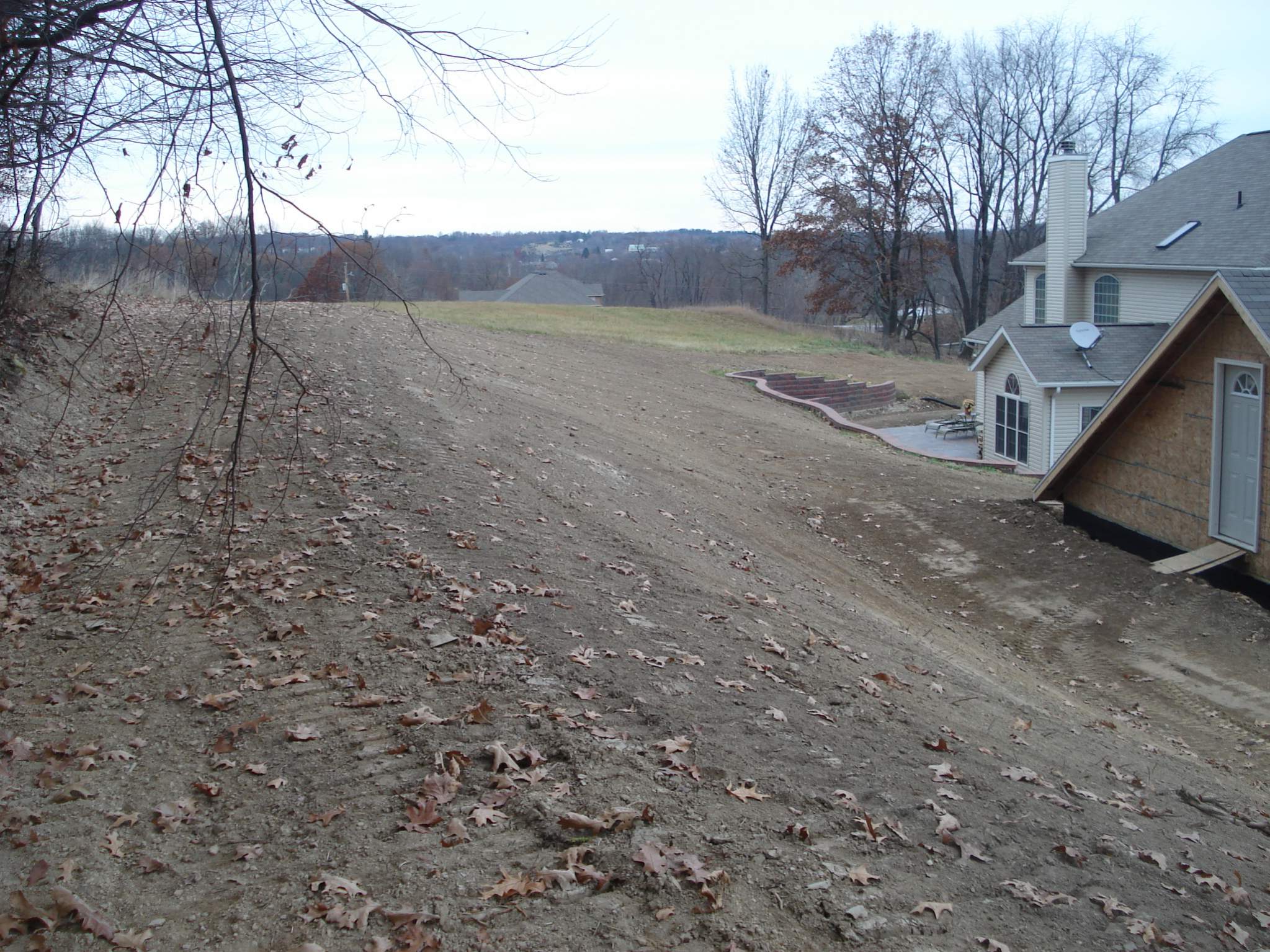

Thanks Eddie... yes both, I am dealing with a 20 to 25 degree slope. Up to 35 near the house. I am on sloping hill with no flat spots. The angle is too hard to maintain so we are terracing parts, putting in a large vegetable garden (just above this first wall). Some fruit trees, berries, grapes? in other areas... who knows. But what I don't want to be doing is weedwacking by hand. The retaining walls will give us some much desired level or gently sloping areas for easier maintenance. I am not getting any younger!

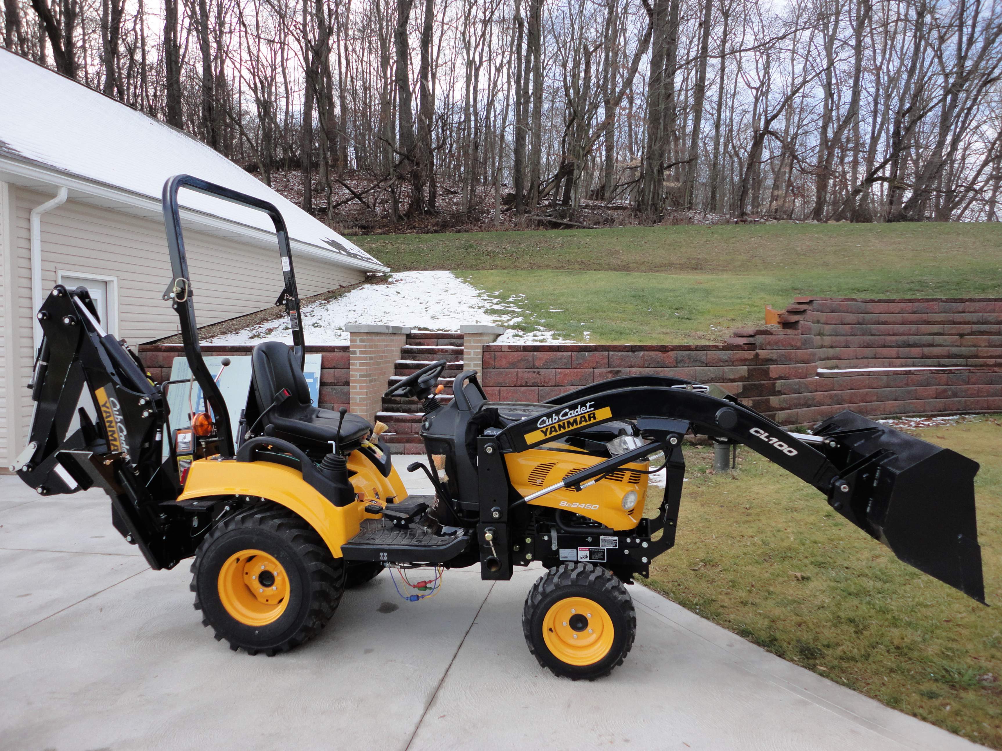

This is the same issue I had when we bought our house 3 years ago. Severe slope, essentially unusable. So I regraded the entire slope (with a dozer) added 2 "roads" one on top, one behind the garage that I built. Not only do they provide access around the property and to the garage upper level, but I angled them towards the bank with a fall in one direction for drainage.
Please excuse the tractor in the foreground, but I'm showing the stairs I built to access the top area. Had some blocks left over so used them as steps. 905.jpg007.jpg
Please excuse the tractor in the foreground, but I'm showing the stairs I built to access the top area. Had some blocks left over so used them as steps. View attachment 327897View attachment 327898
No excuses for the tractor! But I am drawn to the background retaining wall. Quite red and I love it. What block is that?

I agree with CurlyDave, the circular saw will take you forever. You know how heavy the caps are.....thats a lot of density! I used a wheel saw, with a 14" blade. Not as precise as a table cutter, but mouch more versatile. If you take your time and mark it correctly they come out fine. And, I've switched blades on several occasions to cut metal with. :thumbsup: I bought a used Husky from either a pawn shop or CL, can't remember, many years ago, still going strong.
   / My first of many Retaining Walls to tame my slope - DIY #47
What block is that?
Same ones you are working with! I really like how they're engineered....if only they weren't so heavy.....:tired:
I'm glad mine is done....:D
edit; This is the other side of the wall I sent you the earlier picture.....I also wrapped it around the far side of the garage in a 90 degree arc around the driveway.
