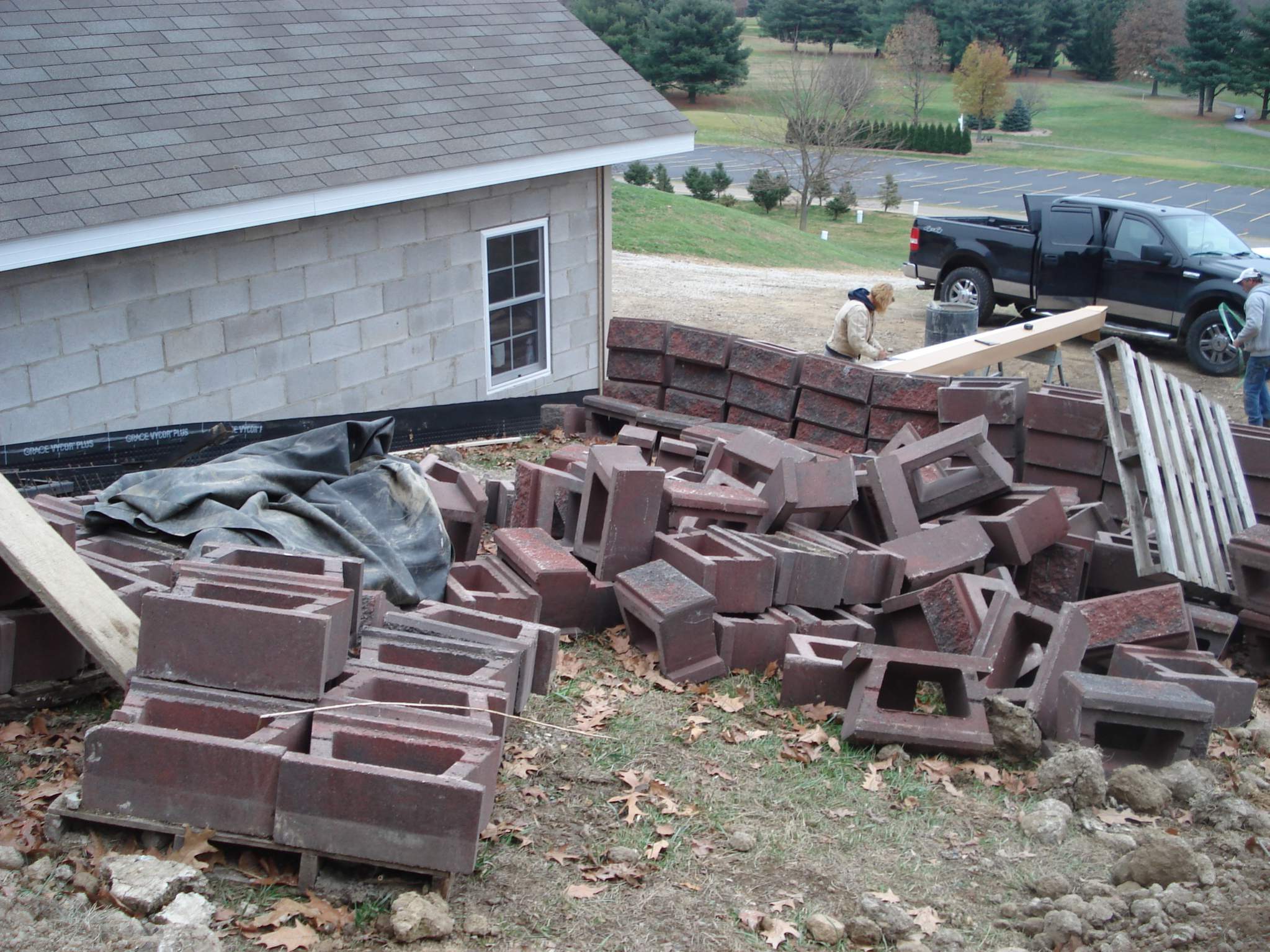

I've got the same blocks, they are definitely fun to work with. :tired: When I bought my home, it already had a 60' wall in place, approx 7' high. I then added another 50', and must've handled 6 pallets of those :censored: blocks 3 or 4 times.....:muttering:

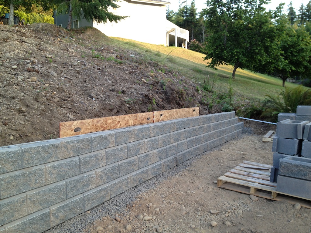

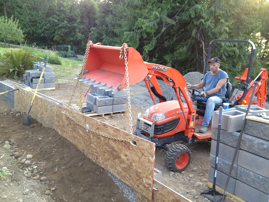

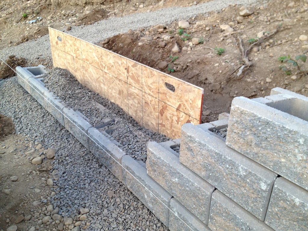

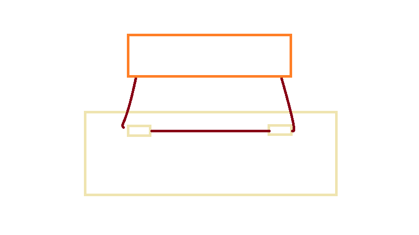

An idea for pulling the plywood...
I then could loop the rope around the two "handles" I had made on the sheet of plywood (the rope fits into the slot created from the shorter block that's between the wider block and the plywood sheet). I brought both rope ends up and attached to the draw bar.
Cross section of rope in slot.
---O
It worked - I was able to pull the plywood by the handles screwed to the plywood.
You may be able to create handles like this, only on the width side of the plywood. Then after you fill a foot or so, pull the plywood up by a rope looped around the handles with the two rope ends on your loader hooks.

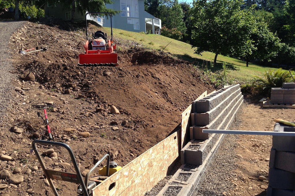

Mr. GolfAddict, I wish I was on the course with you... instead I was laying (not slaying) a course (actually 4). I ended up ripping two sheets of plywood and created 4 2x8ft backer boards with handles. This gave me almost 32ft of temporary retention wall while I filled gravel directly behind the wall and backfilled with fill dirt on the hillside. Worked beautifully. We were able to pull some of the panels out by hand but if not, I rigged up the chain as you suggested. Worked perfectly! Here is a pic...
Here are a couple more showing some progress...
More to come!
View attachment 327202 View attachment 327203
More to come!
Man I got to say that's nothing short of impressive. That's turning out very very nice. That BX is paying off big time. Now I bet your wondering how you ever got by without it.
Nice work. :thumbsup:

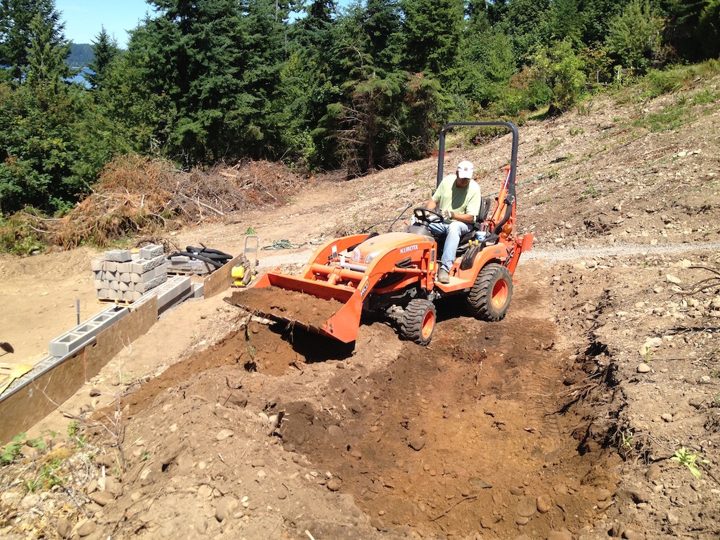

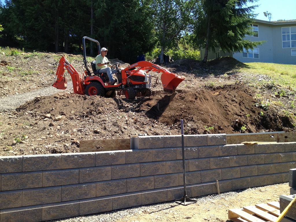

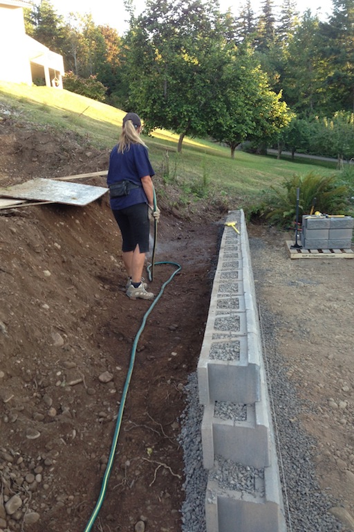

Update... got pretty much a full day in today. Spent a lot of it working on the slope above the wall. Two reasons... first I wanted to create another fairly level area behind/above the wall to reduce the 'surcharge' (pressure) on the wall, and second... I kind of screwed up and built the first row too far from the cut in causing me to need for a lot of backfill. Next wall will be built as close to the cut as possible. Because of all the grading work, I didn't lay as much block as I had hoped but do have 5 courses for much of the wall. One more to go and then the cap. Still scratching my head on the ends and how they will transition.
If you look close you can see the wall isn't perfect. A bit of rise in the middle which seemed to get magnified as the wall got higher. I really didn't notice it until the 4th course. Note the vibratory Plate I had to rent this morning from HD. I didn't want to pay the $90 rental for a day but last night after I got to thinking hard about it and the wife reading some do's and don'ts, I was guilted into it. I guess I am glad I did.

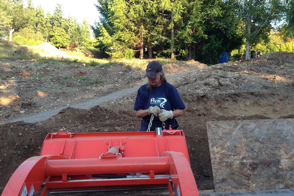

The Chain gang... I needed to pull the backer boards out with chains because after using the compactor, the boards were too tough to pull by hand. First time my wife wrestled with chains :D
Okay my BH (not Back Hoe... Better Half! :D ) watering down the soil. She also read that the soil when compacting should be not too dry and not too wet, so she took it upon herself to moisten the backfill. It is fairly straight and level but as they say... spend a lot of time getting the first course perfect!

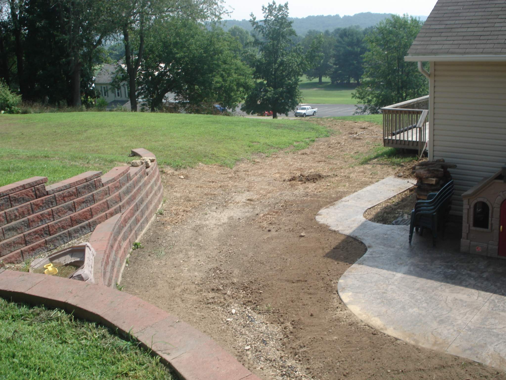

No permit or sign off....the 7' wall was done when I bought the home. I extended it out past the garage I built all being under 5'....very lenient building codes here. ;)
Here's a pic of the transition on one end....you have to buy the end square blocks, and step down.....then of course the caps.....

You are correct in making the base from 3/4 minus gravel, this is what the plan calls for. Drain rock goes behind the wall. I have used the plywood idea and if you burry the plywood more than about 12" you will not be able to lift it properly.
