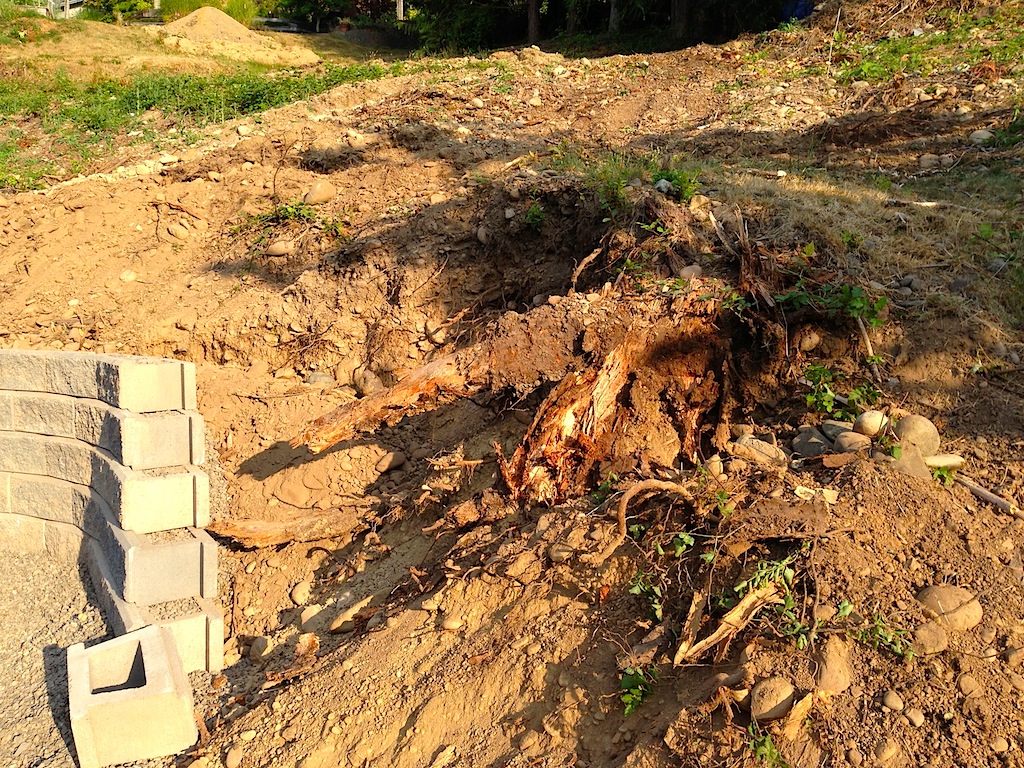

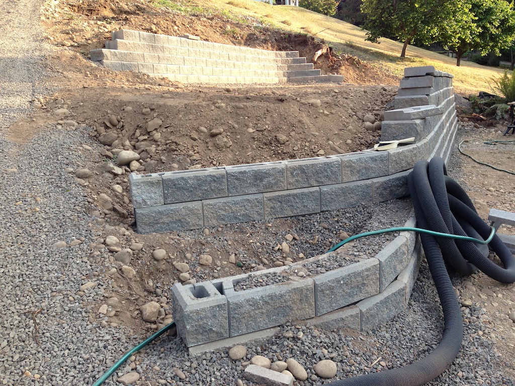

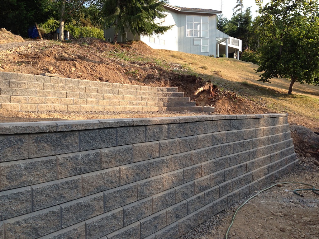

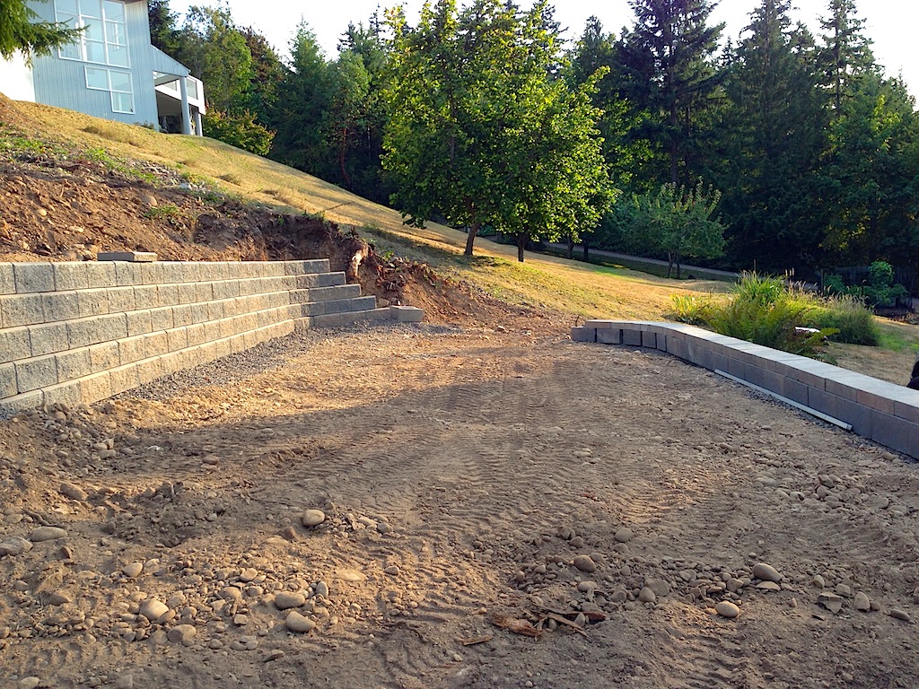

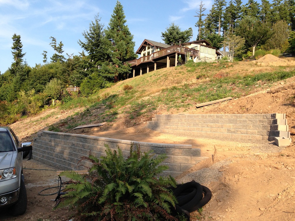

Okay... sorry for the delay but the good news is I am on to wall number 2! I guess the title of this post is outdated. Here are some pics. The area between the lower and upper wall will be my wifey's (stole that from 4shorts) garden.

Looking good and it looks like the weather has been cooperating!
