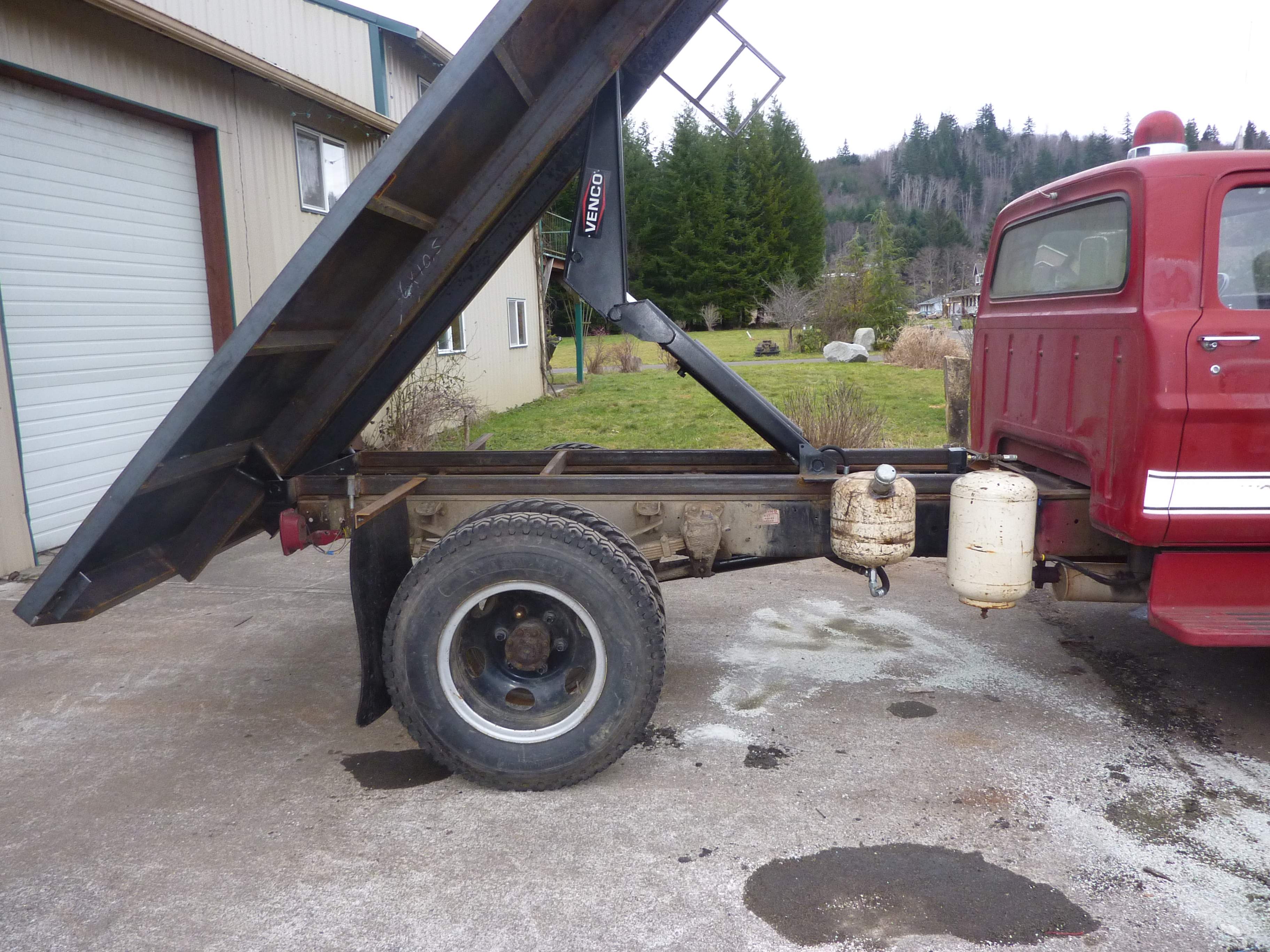

/ My dump trailer build #28
Here is a pic of one I just installed in my rig. When down, all the pressure is put on the scissors, as the hoist lifts, it is pushing straight up initially.
Could you post more pics of the scissor lift. I like the idea and would like to copy it if I could make it work.

Here is a link to a local to me hoist manufacturer. I have one of these hoist on my big dump trailer (14 footer) and it works very well. The pics on that site are not great, but may give you some ideas. I was trying to avoid building a hoist style lift for my small trailer, just to keep it simple, but in hindsite I think it may have been worth it, although I am happy with how it is working now. Here is the link Nordic I'm sure a Google search for underbody hoists would turn up better info, Greg
