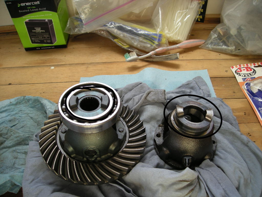

7800 dif lock repair.jpgI've lost 3 of them on my B7800 and I believe that it is mostly caused by poor design in that there is too much linkage and no adjustment. On the HST tractors the pedal is on the left floor and goes under the floor then across the tractor and then back to the axle housing where it connects to a cog type gear that Kubota calls a clutch. This then slides in to mate up with another cog type gear that is part of the cage that consists of the ring gear and rest of the differential. The cog type gear they call a clutch is softer metal that the differential that it mates with and the ears round off.I will try to attach a photo.
I was really intimidated when I first ran into this but found it wasn't that bad. You do need a WSM,a fairly well equipped shop and some determination.

On mine the lever goes directly into the housing. The pedal is a poor design, almost impossible to hold down when you need it.
After looking at the parts diagram I can understand why I'm having problems... the lock is just a couple of pins which slide into a thin piece of metal similar to the parking gear on your car. I did manage to get it barely working again, hopefully it will get me through the winter. I don't see me attempting the repair myself, and I may upgrading to something different.
