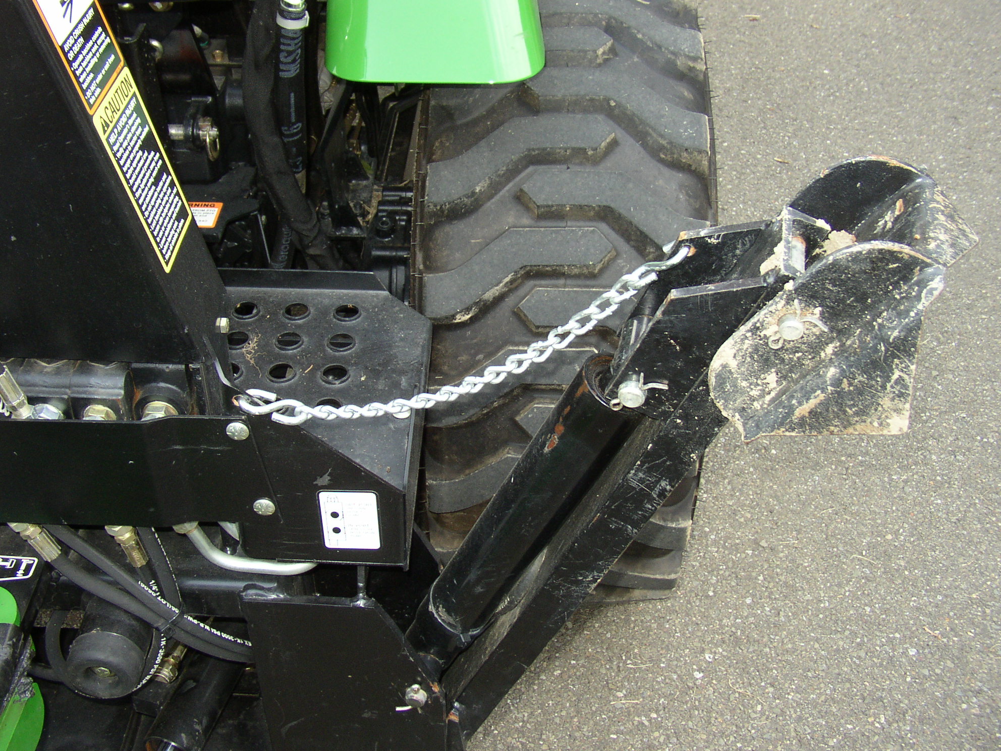

Just a few pics of my 2520 "add-ons"...

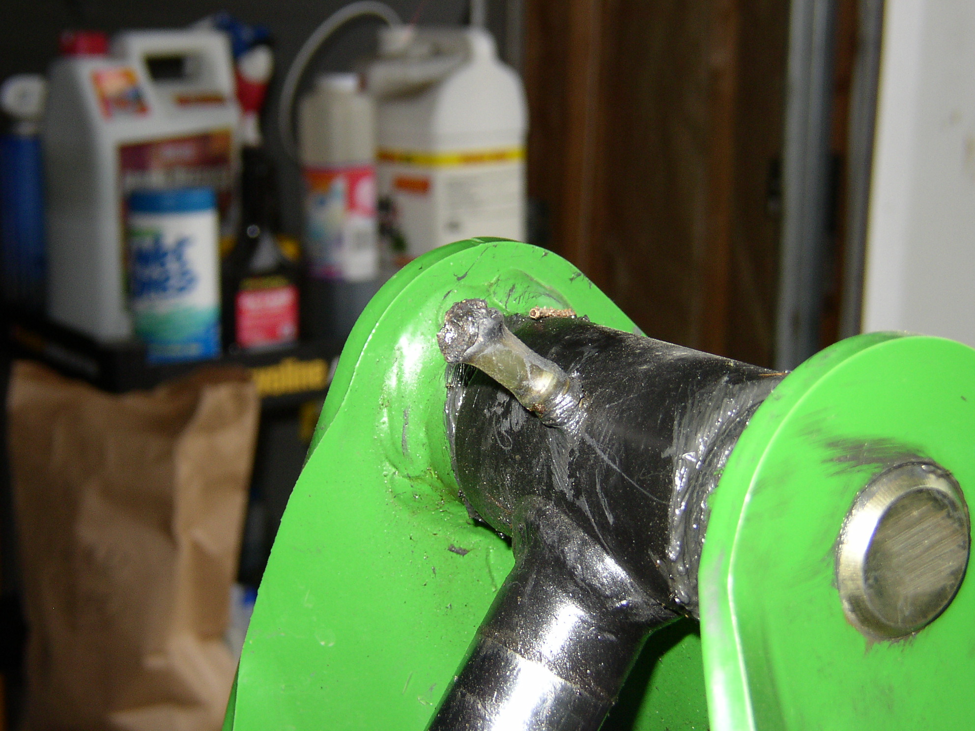

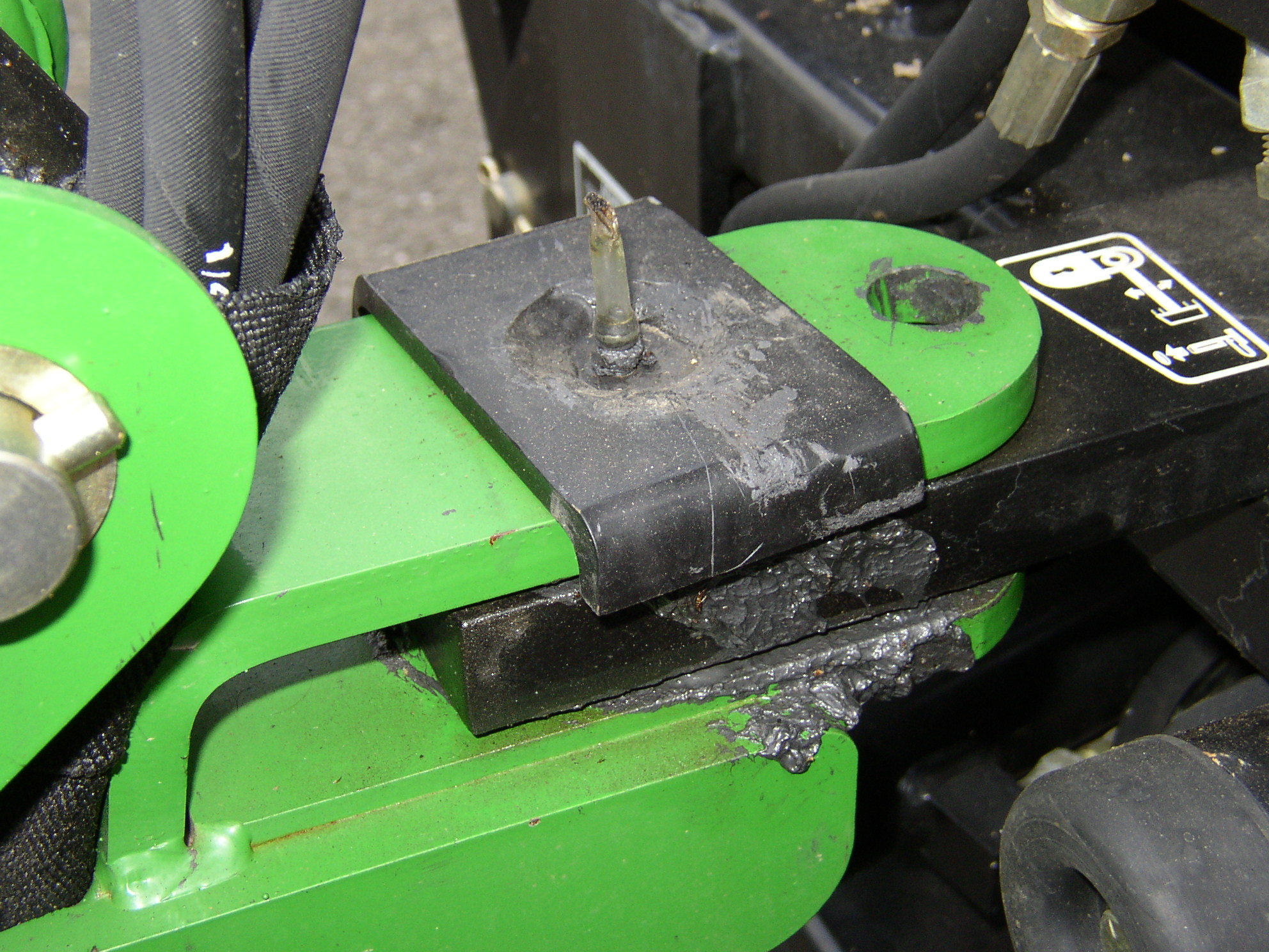

*Hoe stabalizer keeper chains.....they all leak down over time.

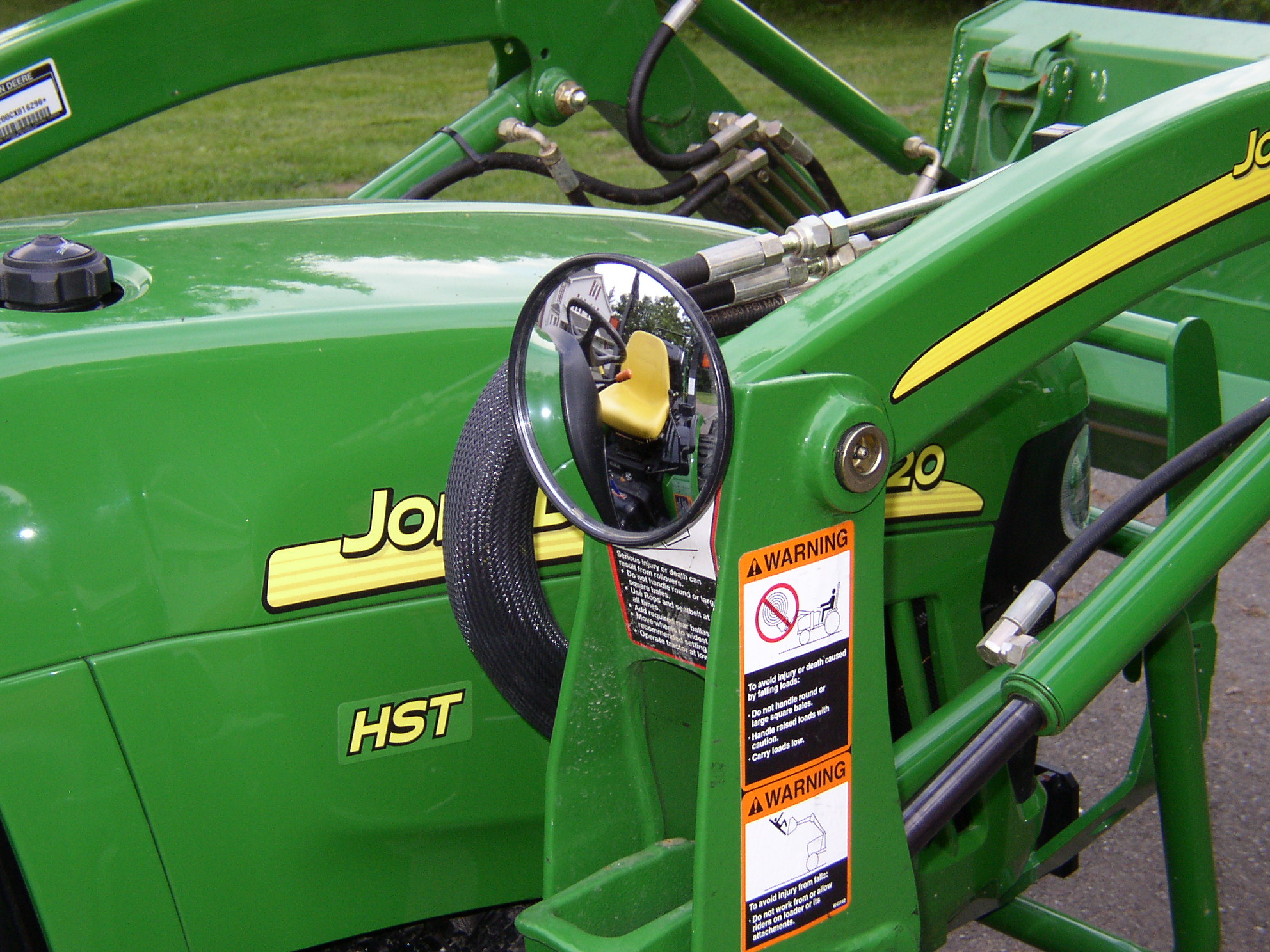

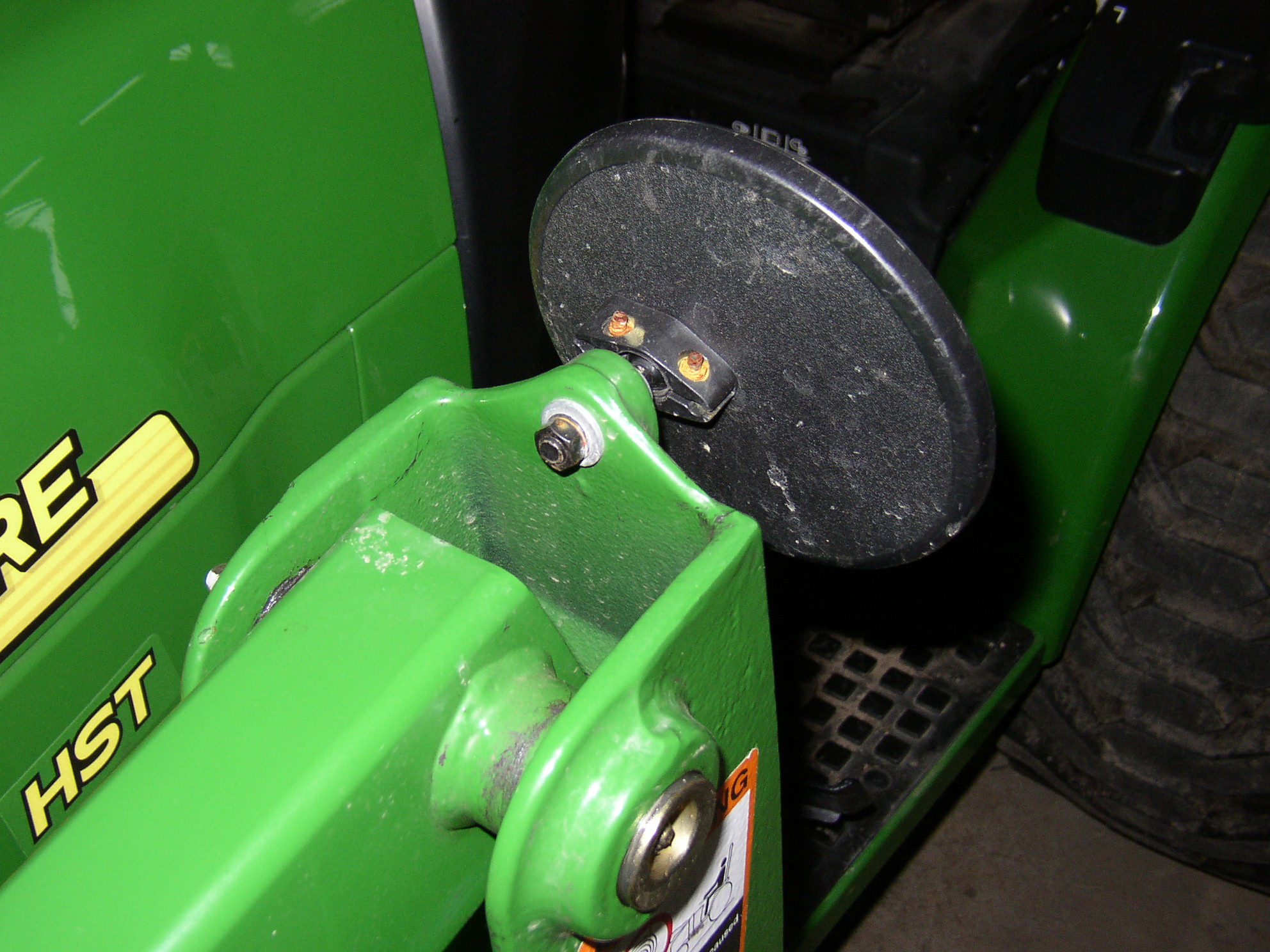

*Spot mirrors....you never know who/what has snuck up behind you.

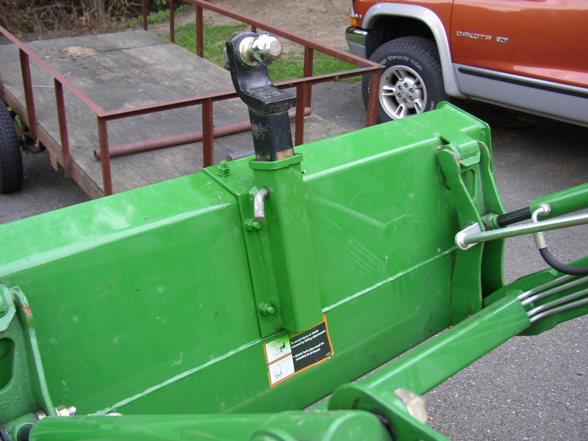

*Bucket hitch....for those trailer jockying duties.

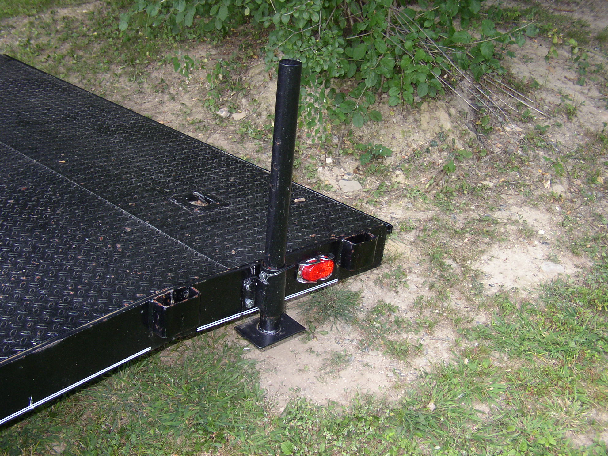

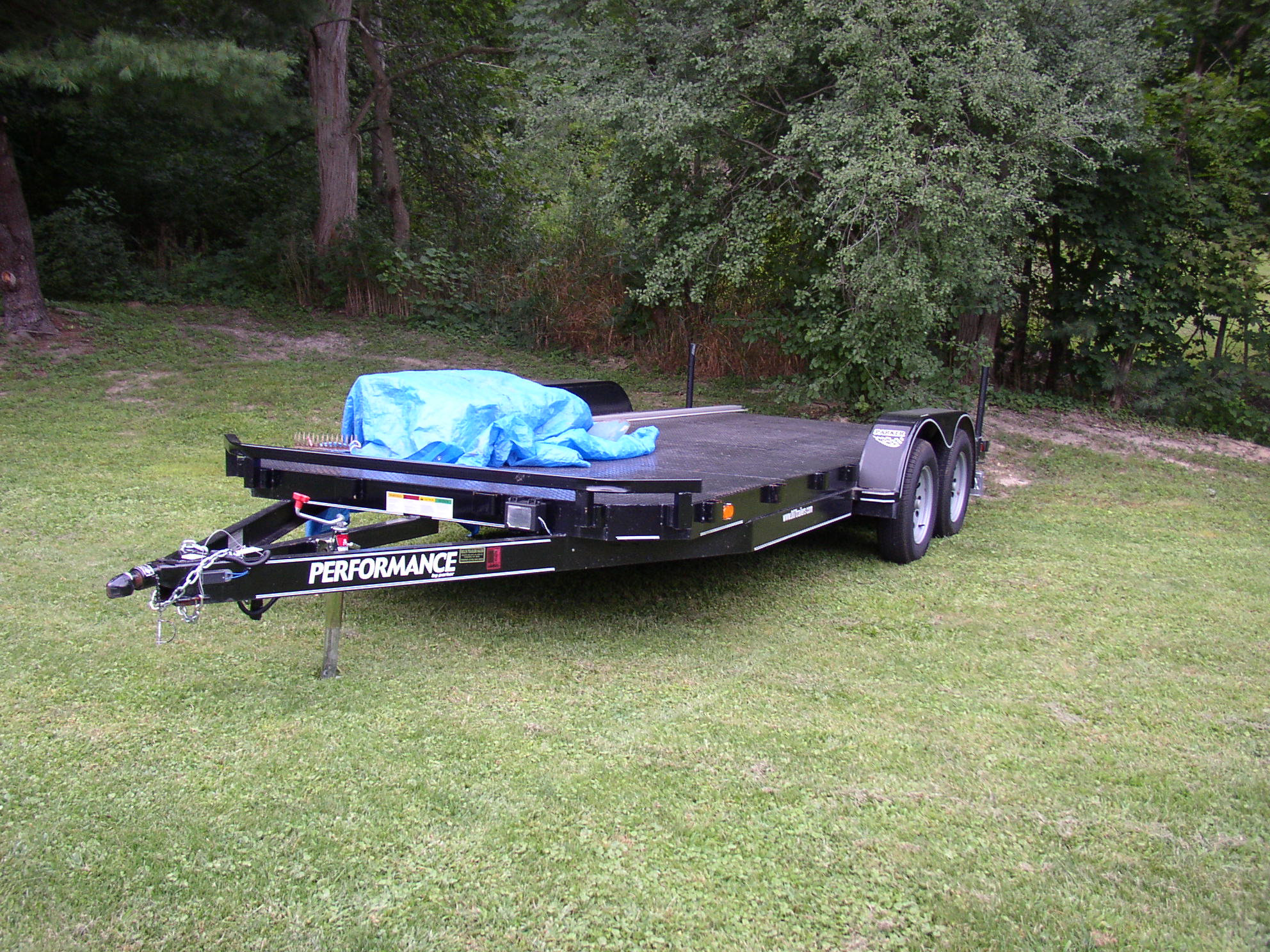

*Trailer jack post.....when I load the "big-boy" up for a ride.

That's a nice collection of add-on improvements to your equipment. I made a rear-view mirror for my JD almost like yours, mounted on the loader post.

Nice...I like your chains on the hoe idea...quicker than the straps I used on my 46 hoe.

And yes, I stood a long time staring at those holes on the loader post wondering...what ta heck?

All good ideas FP ! I own a similar trailer with a good friend of mine (50/50 ownership)...... he also made similar, simple "stands" on the rear of the trailer after his truck w/trailer took off down his driveway (slight downhill) the first time he tried to load his car on the trailer !:eek:

I did the exact same thing for a mirror, but I bolted an AL bracket on to raise the mirror 2 inches so I can see over the rear fenders n stuff.

Those are some cool mods, Pauly. Thanks for sharing and posting the pics and descriptions. Some great ideas there and it seems other have had similar ideas. I was trying to figure out the hitch mounted to the back of the bucket and realized you must be rotating the bucket forward to get that hitch horizontal to move trailers and such....also great idea. I think I like the idea of the red grease fitting covers a little better and the fact that they can be had for cheap. Was the trailer jack stand mounted on the back of the trailer just to add some strength and stability when rolling up or down heavy tractors or equipment?

netwayne,
Yes...I had to add the post on the rear of the trailer to prevent the excitement generated when loading the tractor on the trailer. It raises the rear wheels of my Dakota clear off the ground if the post are not used.....that can get very exciting if you are not on level ground.
I think I need a bigger truck.......:confused:
/ My 2520..... #12
I'd like to add some sort of rear jacks to my trailer as well. Right now I use jack stands under the rear corners but it'd be alot nicer to have built-in stands that automatically go wherever the trailer does. I need to learn how to weld!
