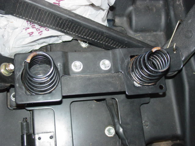

An update on my seat experiment, I purchased two seat suspension springs from JD (M153100 for and X series standard suspension) that were roughly the same base diameter as the rubber under the seat. I pulled the rubber and put in the springs and used a fender washer and small bolt at the bottom of each spring as a keeper and the ride is day and night. Rides like a it should have when new. I had cut the tops of the springs a bit to make it level when I am sitting on it. Overall took about 15 min and $12.64 to make a decent ride.
It is a cheap fix and cheap experiment. I mowed a bit today to try it out and my back it thanking me.

Here is a picture of the springs installed.

Forgot to mention and it did not show in the photo but I glued thin rubber disks under the seat (where the old rubber springs rode) so the springs did not contact the metal of the seat. So far so good, no problems but a smoother ride.

Hi - sounds great. Got my springs this weekend. Did you just do trials of cutting down the spring height or use some measurement to determine where the top of the spring should be?
Also, you said you used something under the seat to protect it from the spring - could you be more specific. I don't want to reinvent the wheel and you are so pleased with the ride if I can duplicate it I will be happy....

I installed the springs and sat on the seat to get a feel of the height and compression. Then to adjust the height I used a dremel to cut half a loop off at a time until it came out alright. Then I used a washer and small bolt to hold the spring in place (mine hasn't moved). Install, sit, take for a small ride then trim small at a time. Also if you do trim off some I ground the cut part flat so not rough edges, just like the spring came with the top loop ground flat at the end.
I used a rubber washer that I siliconed in place where the old rubber spings made contact. The washers were about 2" in diameter and I had them so I did not have to buy any. I only used them so there would not be any metal to metal contact. Heck if you like the ride cut a flat piece off your old rubber springs.

They should work the factory rubber springs are the same. I should have explained better before but I cut off half loops off the small part of the spring and not at the base until I got the ride I wanted.
