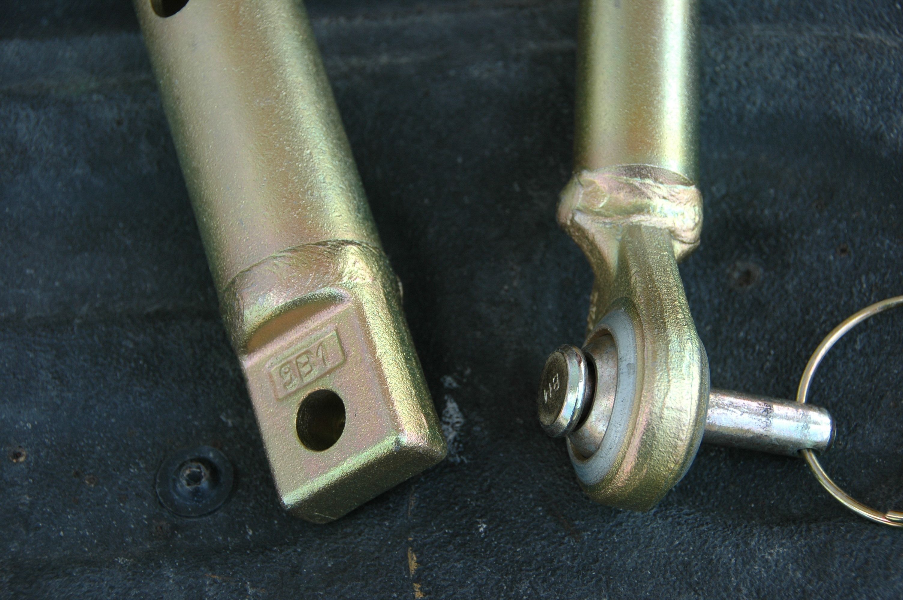

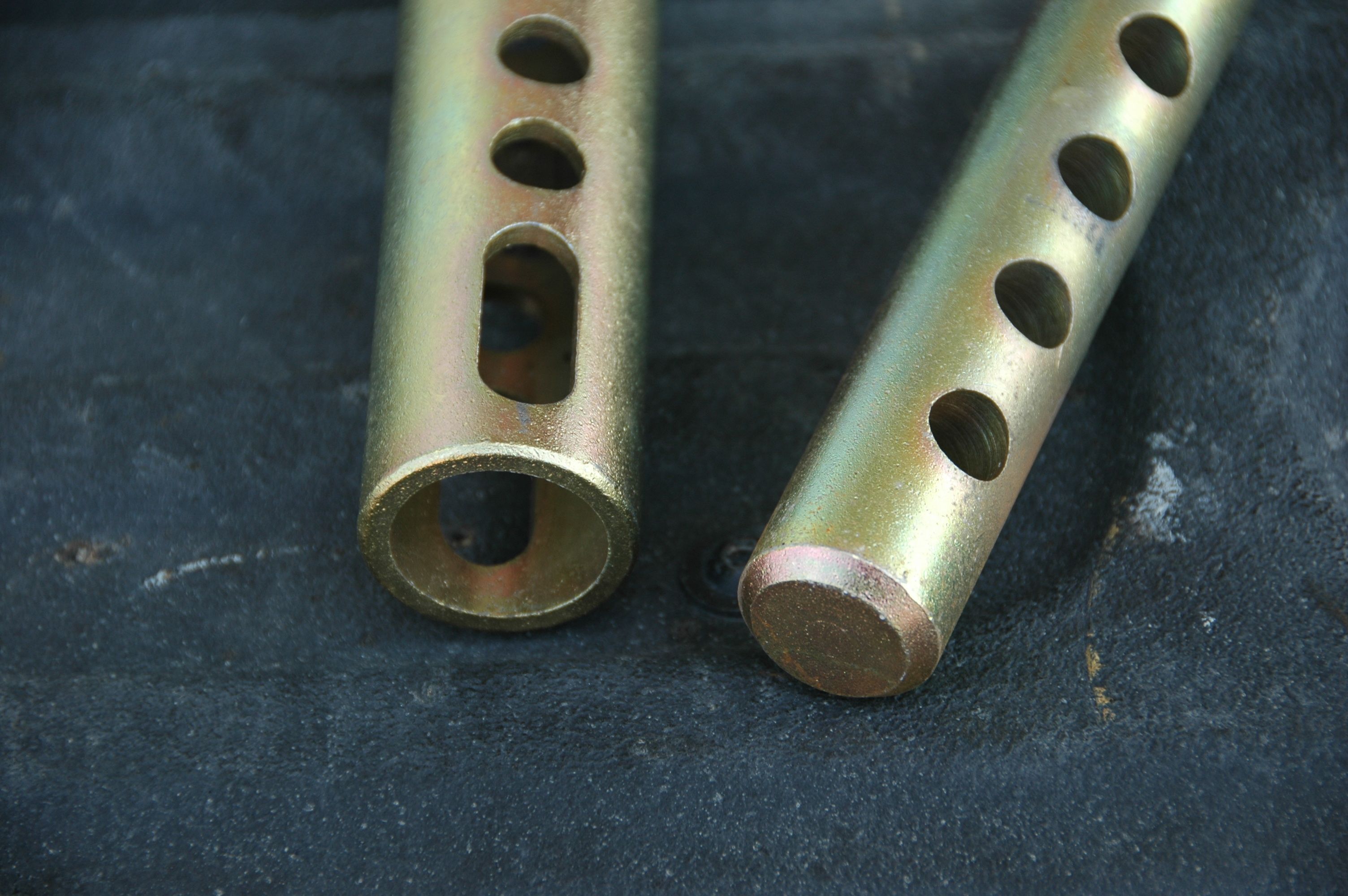

/ MX8 cutter snapping stabilizer bars? #26
Here are pics of the new arms. I think JD finally solved the problem.
D.

/ MX8 cutter snapping stabilizer bars? #27
Thanks for pics!
My 4720 is at the dealer and I am gonna have him order those arms.....What did you pay for the pair?
/ MX8 cutter snapping stabilizer bars? #28
Nothing - they replaced them under warranty.
D.

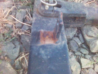

/ MX8 cutter snapping stabilizer bars? #30
Heres a pic of mine after my dealer did mine....under warranty of course....One big question....The pin doesnt reach thru the hole as the round bars are thicker than the old square ones, did you get longer pins? When I say dont reach I mean the ball bearing that locks in place doesnt reach all the way thru, its short by like 1/8 inch or so.....
