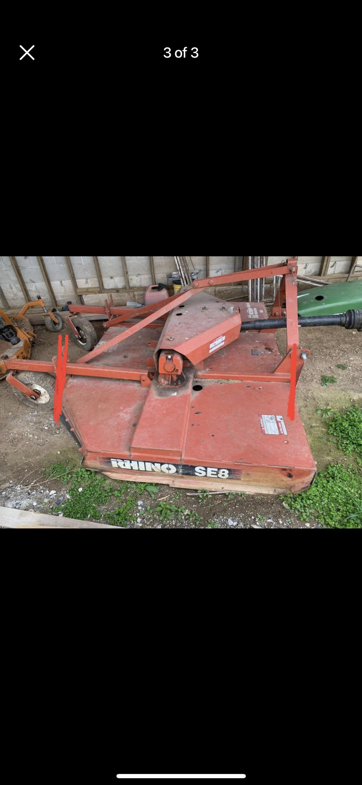

I’m looking to upgrade from my 6’ cutter to a 8’ or 10’ cutter for cutting the more open spaces on my property. I’m looking at used models on marketplace since it’s occasional use, trying to keep costs lower.
I’m seeing 3 point and pull type models. Is there an advantage or disadvantage to each? I normally lean pull type but see more 3 point hitch models for sale.
My property is hilly so I feel like the pull type would be easier on the tractor and not cause excess weight on the back for which to tip over easier.
Thoughts?

What tractor? And can it even lift a 10' cutter because there is a BIG jump from a 8' to a 10'. The lighter 8' mowers start around 1600-1700lbs. The lighter 10' cutters push to 2400-2400# and hang back alot farther so it feels like even more.
That said, if you have enough tractor for either, you can always use a 3PH as a semi-mount. Or just keep the tail wheels on the ground when going up hills that way you are only carrying half the weight of the cutter.
The 10' cutters are gonna cut tall stemmy stuff better just because its a bigger (longer) deck and the vegetation spends more time underneath. But it may do worse on uneven ground and more prone to scalp and/or leave high spots as the terrain changes simply because its a wider rigid deck.
ANd if you have enough machine to even consider a 3PH 10' cutter, I would think you have enough machine to look at a 12' or 15' batwing

I’ve got a Case 75C so I would think it would handle a 10’ cutter but figure 8’ 3 point would be better and 10’ pull type better.
Bat wings are the eventual goal but this is to leave on a remote property for cutting 1-2 times per year so I don’t want anything too fancy.

IF you are ever gonna trailer it while on the tractor, 8' and 3PH is certainly the easiest. 10' and you are too wide to trailer unless you put on trailer sideways and have a way to unload

Well I’m going to try the 8’ 3 point model. Picking it up for $2700.
