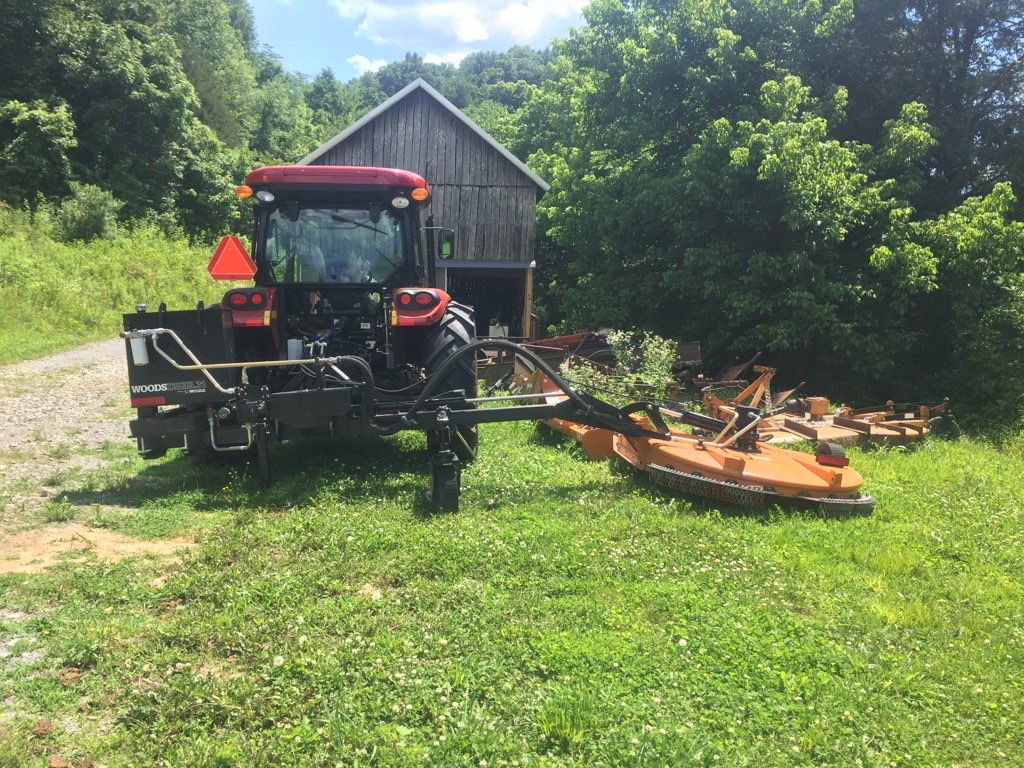

It's been a couple months since I updated. I only have opportunity to use the tractor on weekends- but I'm up to about 108 hours. I took the standard rotary mower off a couple weeks ago and put my ditch bank mower back on. Now I'm cutting along the roads, pond bank, and creeks again.

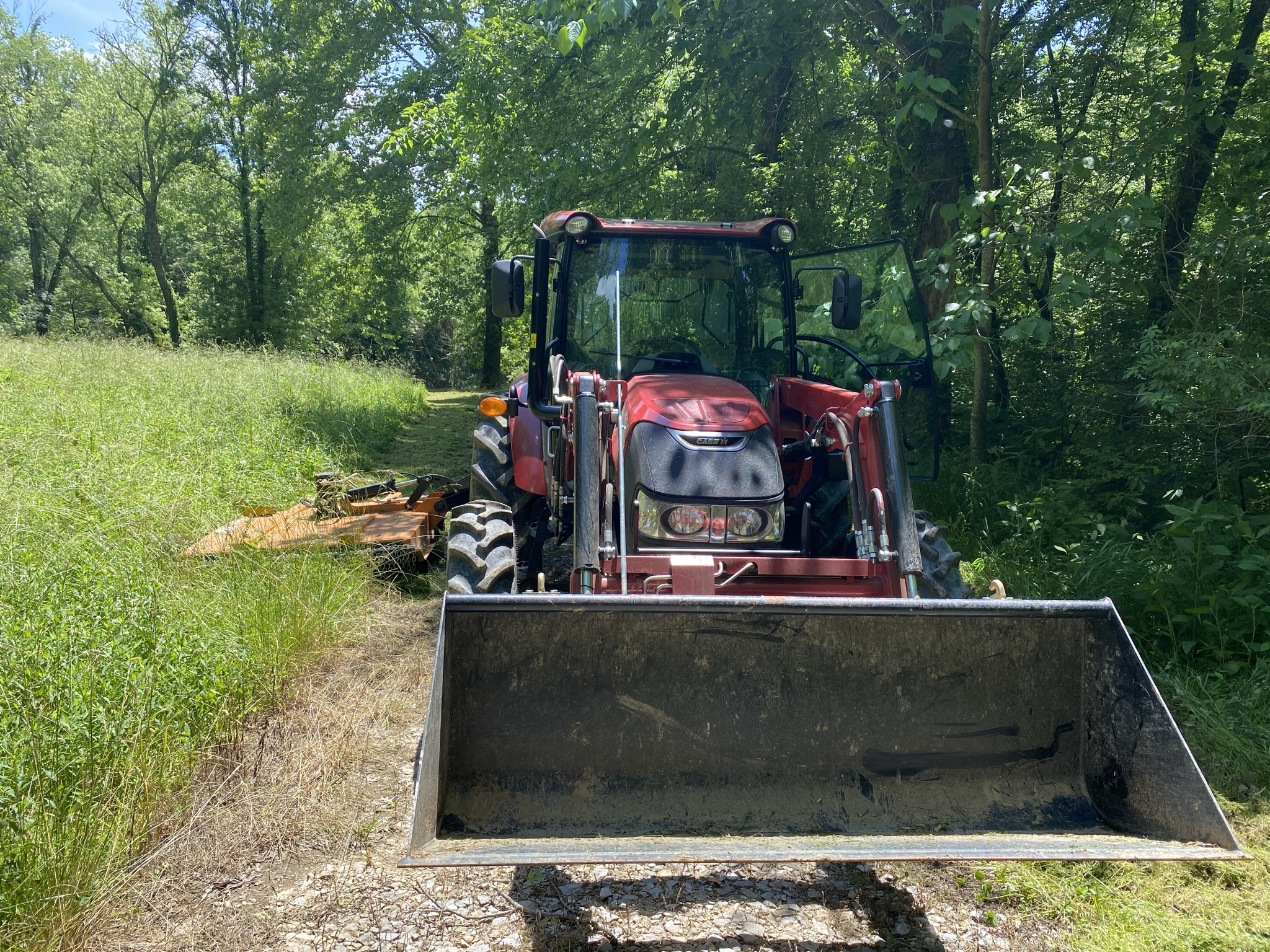

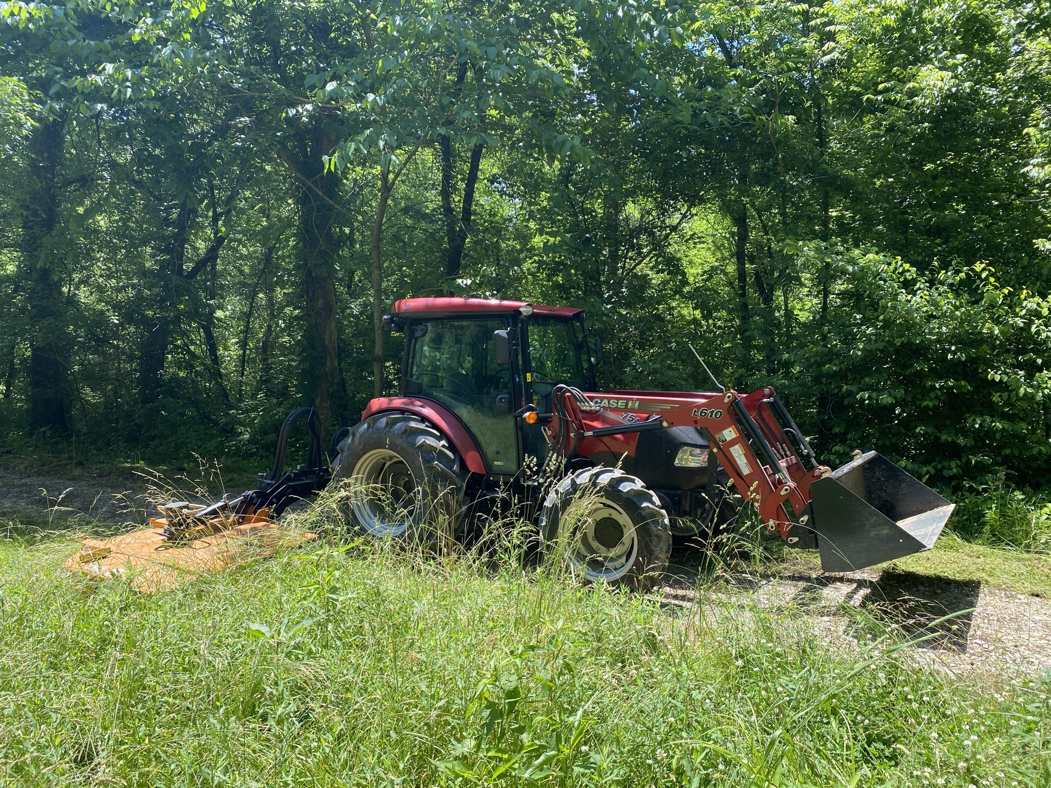

Grass and weeds are growing like crazy, so I've been back on mowing. 3 point attachments are getting easier to connect as my experience with each of them grow. I switched out the 8' rotary cutter for the ditch bank mower last week and it only took about 10 minutes to get hooked up. Not bad for a 2,000 pound implement.
Mowed some ditches, drop-offs at the side of roads, and edges of a couple small fields right at the tree line.
