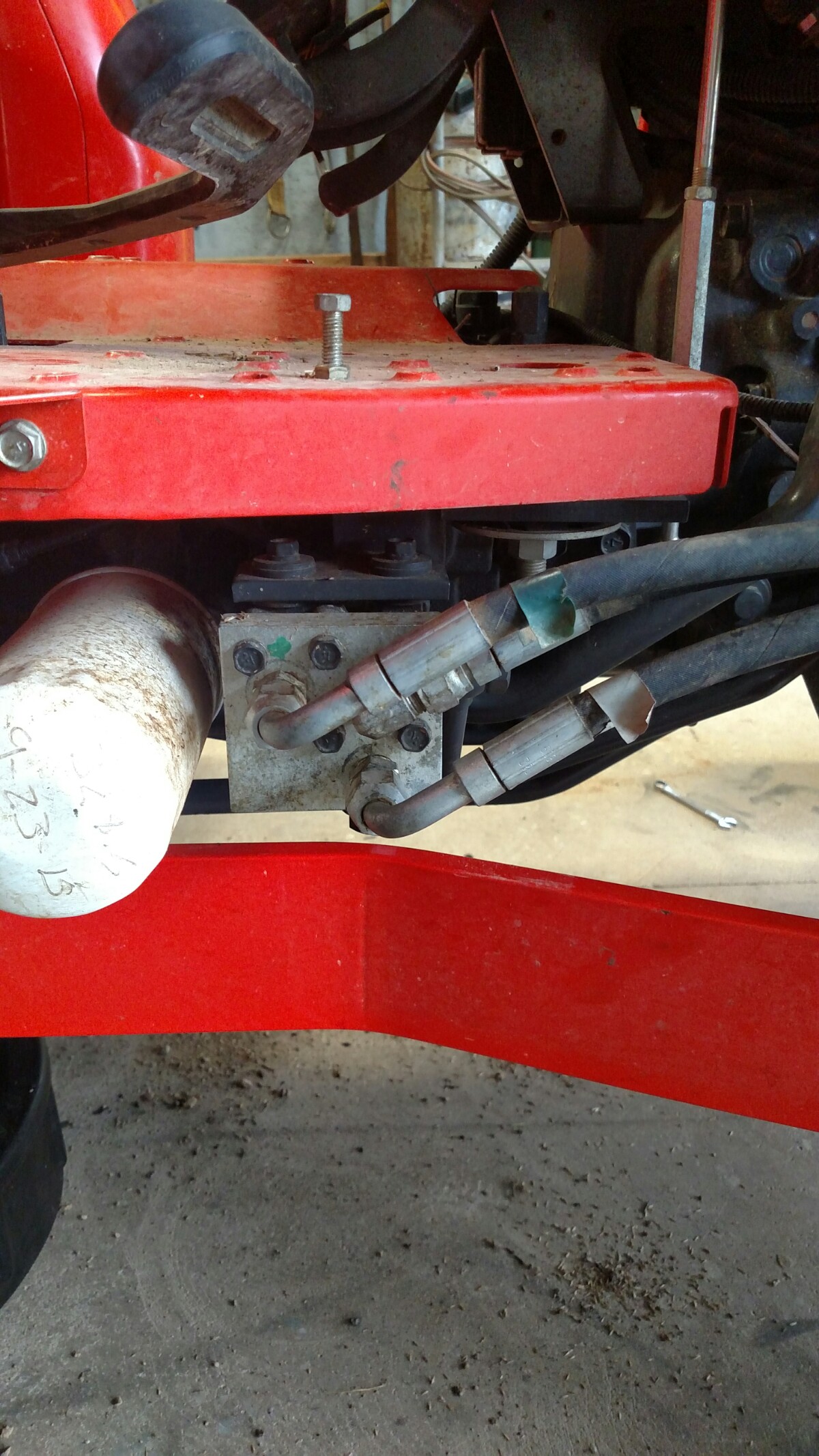

I think I got my plan together for now.
Gonna pull off the green marked hose here
Which the other end attaches to PB at the loader.
Then I am gonna run a hose from the PB port on the loader to a triple or quadruple spool valve back beside the seat where the oem remotes mount.
Then PB out of there back to where the green hose is in the pic.
That "should" splice the remotes in after the loader valve, but before the 3ph.
Hope all that is correct.
Now just time to find a valve. Probably just gonna go with an 8gpm valve, as those seem pretty common. Even though the tractor is just a tad over 9gpm...it still uses 3/8 hoses.
I like the monoblock valves. Cheaper, compact, easier. But cannot find a 3-4 spool with anything other than spring return 3-pos spools. Would like to have at least two float, but preferably all 3. An all spring return 3-spool unit is $200-300 depending on brand.
Only way I seem to be able to find float valves though is stackables. And that pushes valve cost to about $450. If I could only find a triple monoblock with all 4-pos float spools for $250ish.
From there, motion industries can get me 1/2" again couplers with two-way sleeve for $18ea. So 6 of them+dust caps should be in the $125 range. And I will make my own clamp mounts.
6 short hoses and fittings to connect the couplers, and the hoses supplying the valve and return....prolly looking at $200 there and I'm done.
So $200 for hoses and fittings
$125 for couplers
$250(best case) $450(worst case) for a valve.
Should be able to get myself 3 remotes for $600-$800

Yes that will work just fine for the supply lines, don't forget though, you will need a line running from the new remote set to the tank return line, it can tee into the existing line running from the loader valve to the tractor.

That's pretty much exactly how the setup works with the factory kit on the L. Just need to find a place to tie in the return from your valve stack (may be that you can use that block attachment point after all, but for a return fitting only).
