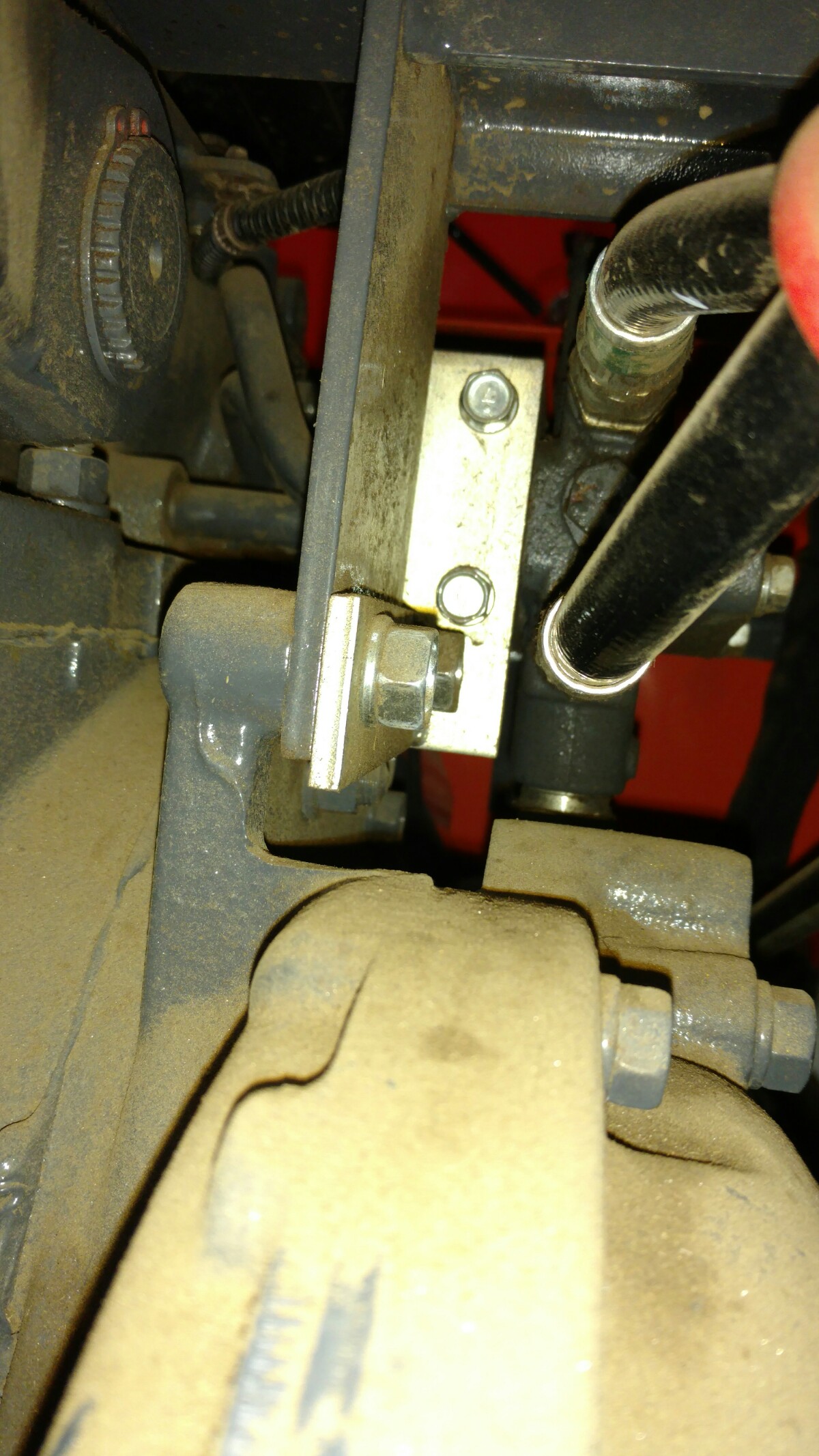

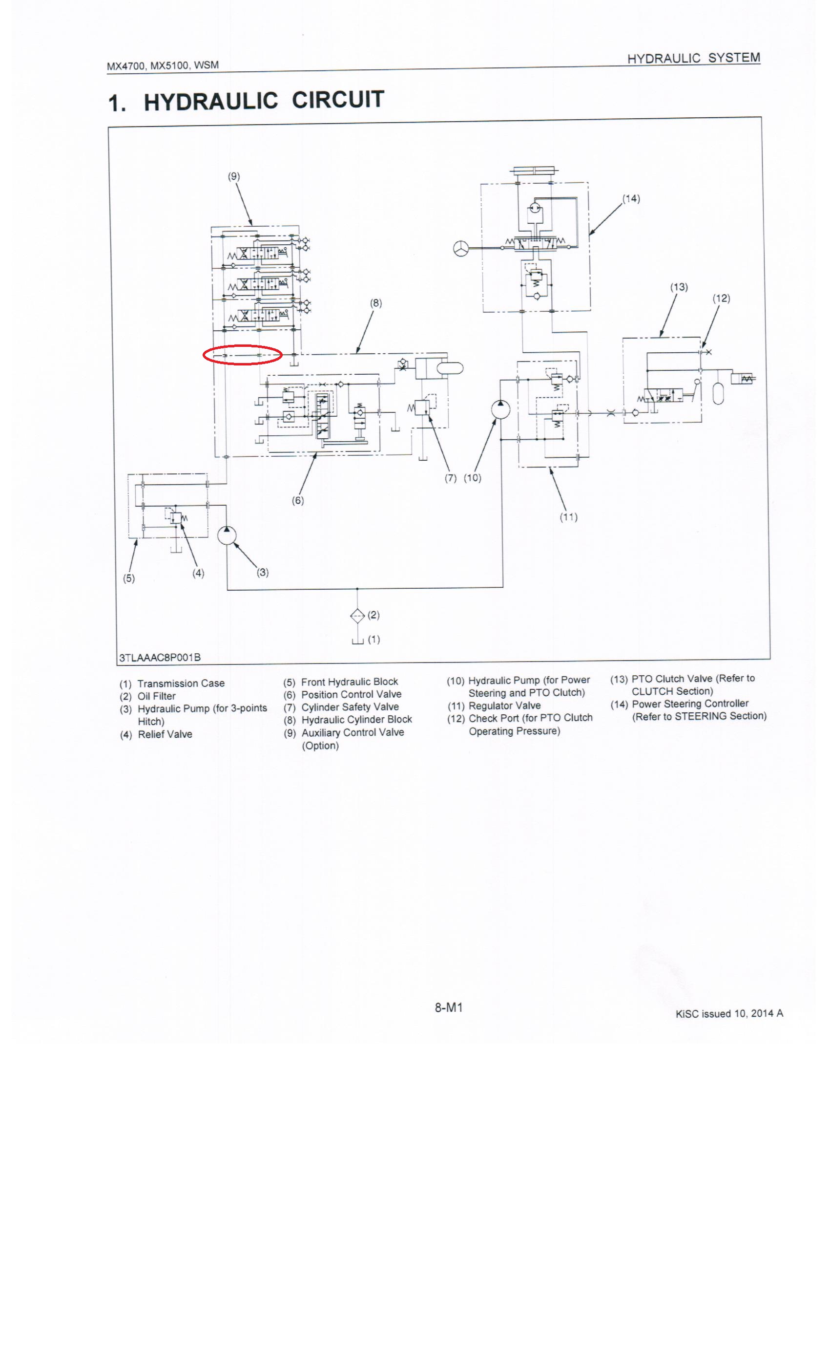

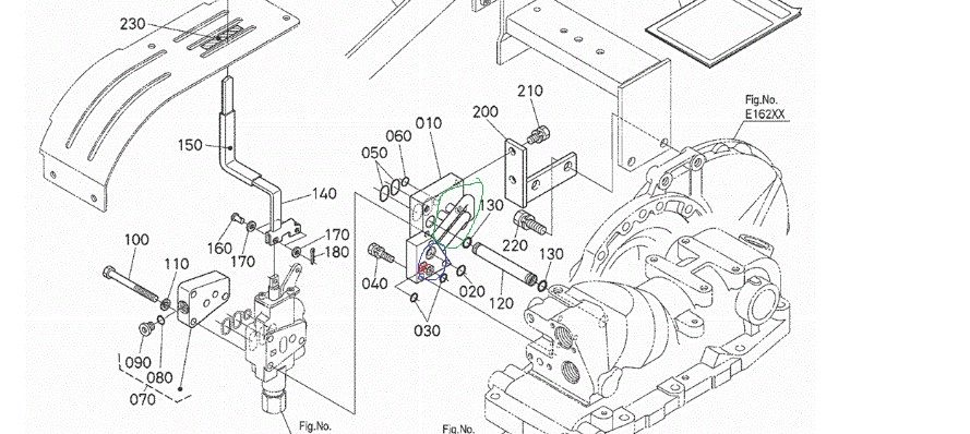

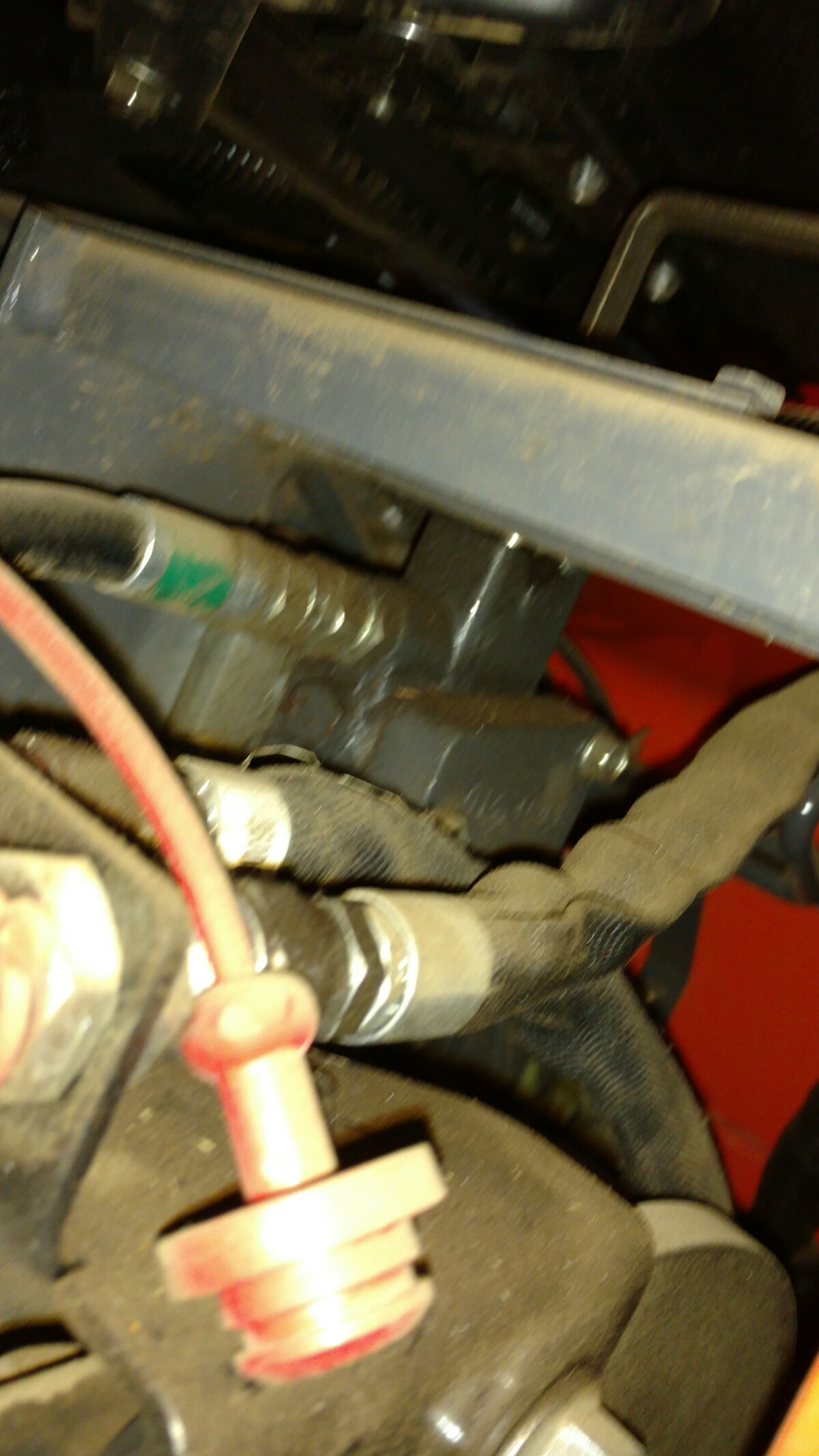

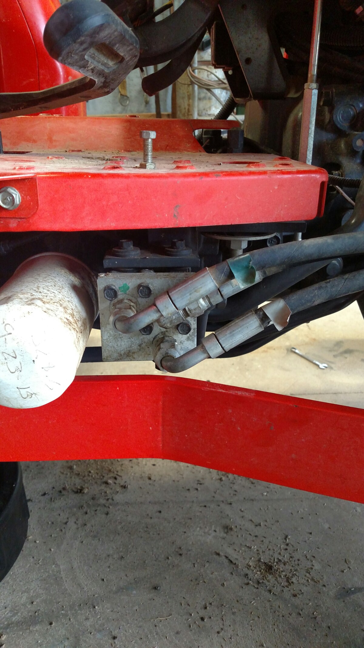

I think I got my plan together for now.
Gonna pull off the green marked hose here
Which the other end attaches to PB at the loader.
Then I am gonna run a hose from the PB port on the loader to a triple or quadruple spool valve back beside the seat where the oem remotes mount.
Then PB out of there back to where the green hose is in the pic.
That "should" splice the remotes in after the loader valve, but before the 3ph.
Hope all that is correct.
That's pretty much exactly how the setup works with the factory kit on the L. Just need to find a place to tie in the return from your valve stack (may be that you can use that block attachment point after all, but for a return fitting only).
