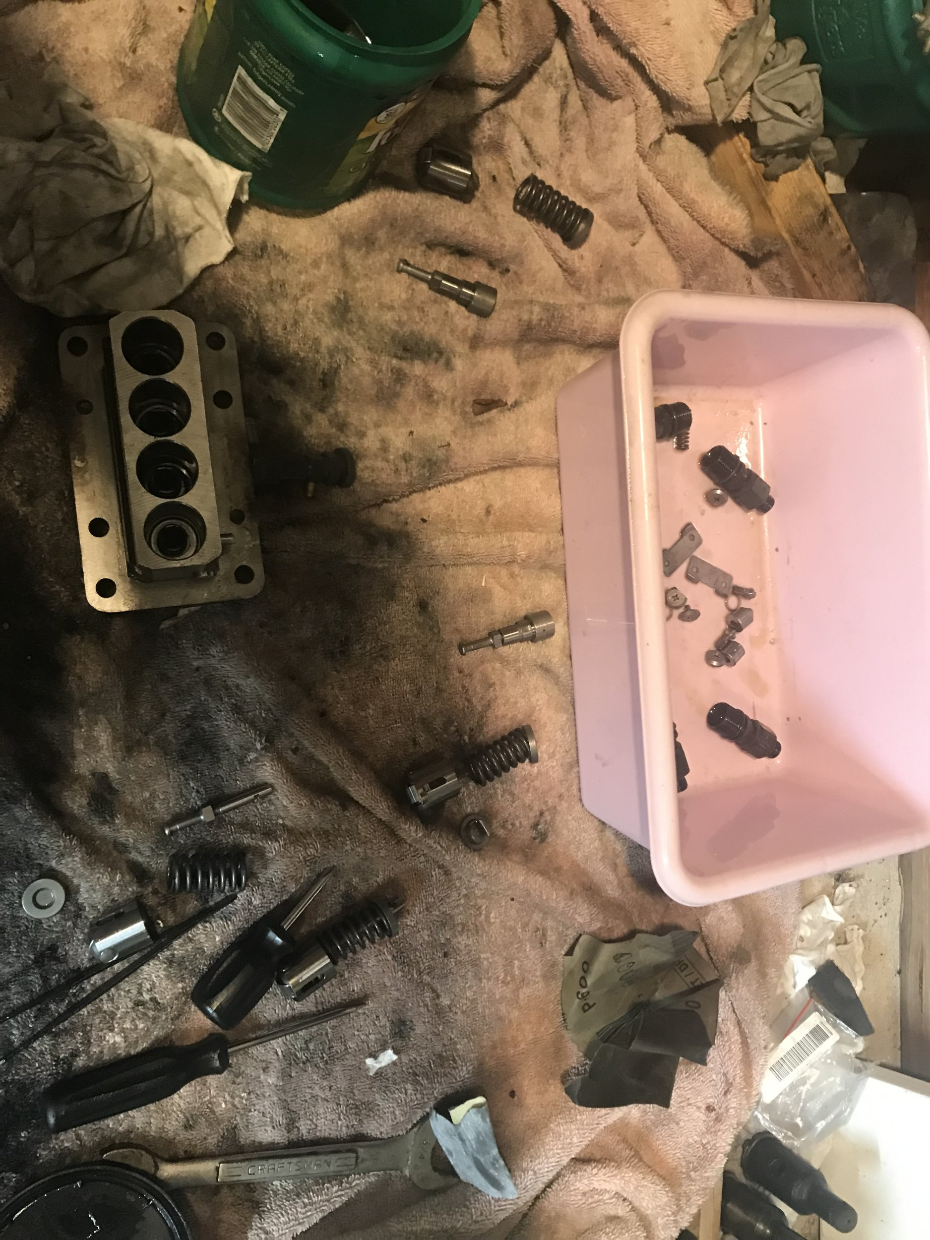

Sorry for the delay. Here’s what happened.
At roughly 215 hours the v2403 developed a dead miss on cylinder 3. I determined this by loosening the injector lines.
It was noted that there was no fuel coming out of the number 3 delivery valve on the IP.
I removed and pop tested all injectors and although they looked ok I would not say they looked great for having only 215 hours on them. Spray pattern was not perfect. I’ll obtain new nozzles and address that later.
Meanwhile, I removed the IP, which is a Denso pump, tore it down to try to determine what failed.
I saw no scoring or broken parts. Everything looked very good so I put it back together and reinstalled it. Now it runs just fine.
I am puzzled as to what happened.
It did run out of fuel prior to this event but ran ok after refueling for a few minutes.
I’m thinking I got some contamination in the refuel and maybe caused one delivery valve to stick. Who knows…
Now, to try and sort out why the loader hydraulics bypasses when warm. She really looses power and barely lifts a bucket full of dirt when it’s warm. There must be a way to adjust the pressure.
