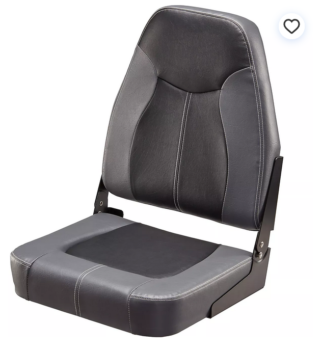

Atwood makes this really nice seat,
Needing orange, there are far and few choices. People just go with black or the camo.
You get two of the seat for the price of 1 lousy tractor version sold today.
  • DESIGN:high-back boat seat design ideal for fishing and boating, aluminum hinges enable backrest to be flipped down, creating more space.
  • DURABLE: durable seat can withstand the long-term rigors of a marine environment.
  • BOAT SEAT DIMENSION: Height 21.5 ” X Width 17.3 ” X Depth 17.5 ”, Weight Limit :250 Ibs.
  • MATERIAL:compression foam padding remains firm after long-term use.Marine grade heavy duty polyester.
  • INSTALLATION: easy to install on any standard 5" X 5" fishing pedestals or swivels, 4 stainless steel mounting screws included. No swivel/pedestal included.
  • NOTE: Photo may slightly different from Actual Item in Terms of color due to the lighting during Photo Shooting or the Monitor's display.
Some of the Deere 50, 55, 70 and 90 series compact tractors have the option for the 30 degree seat swivel. Basically it's just the boat seat swivel. And much of the time the seat mounting is identical to plenty of tractor seats too from the 1980s to now.
I found a Wise boat seat at an estate sale this past summer for a mere $15. And it came with the swivel on the base. It was never used.
Yes, this is a very low end marine seat as the bottom uses the plastic typar, yet it will outlast any of the modern tractor seats out there today. I have laid in an underseat bezel to keep material from coming loose. Hey for $15, I couldn't pass up the deal. :) The seat goes for $25 and the swivel for $20.
Atwood does have one with some orange in it,

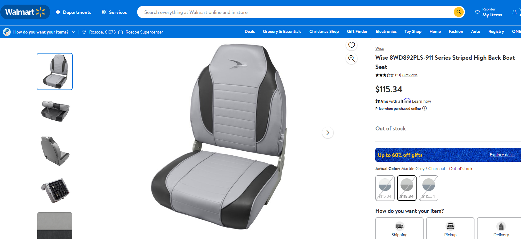

Wise makes this one,
other gray/black types,

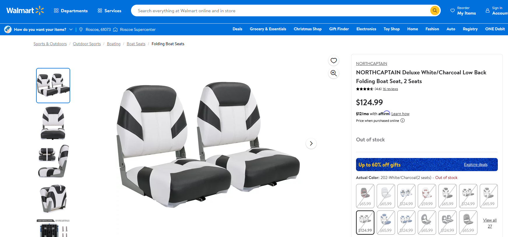

Get 2 for the price of 1. Thus, a spare,

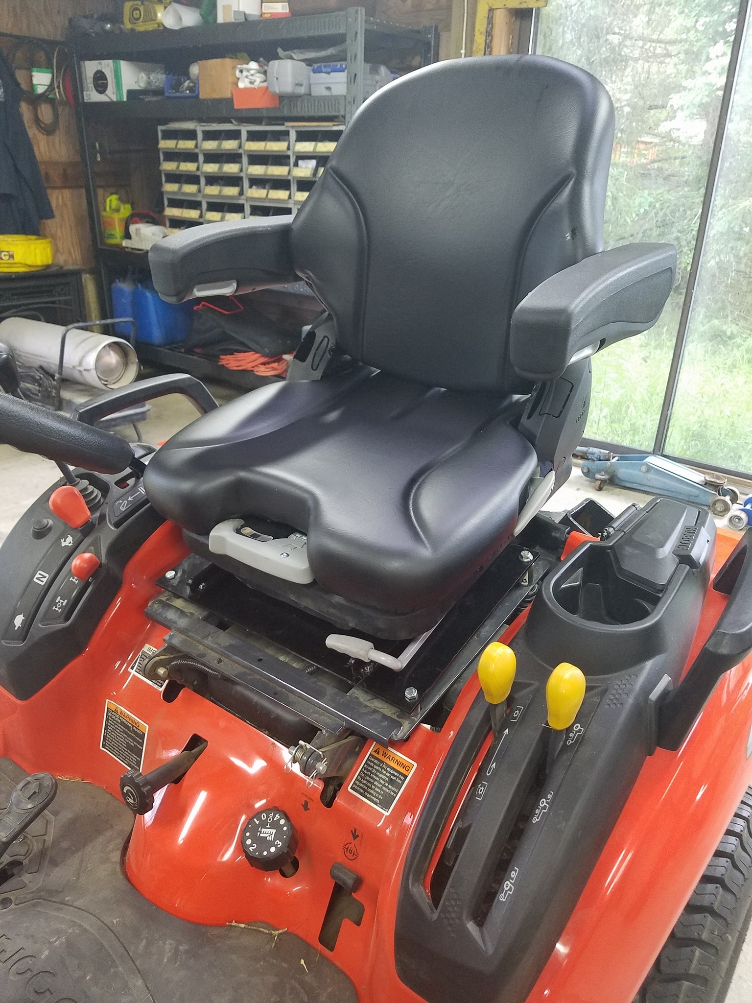

My MX5800 came with a MILSCO XB200 as the OEM seat. After 8 years, the foam cushion separated from the plastic shell. I replaced it with the same MILSCO XB200 seat purchased on Ebay for $145+ tax with free shipping. This is the second time I've purchased the MILSCO XB200 -- had to replace seat on New Holland TC33D (2003). Highly recommend this seat. Easy to install with predrilled holes to accommodate a variety of tractors.
