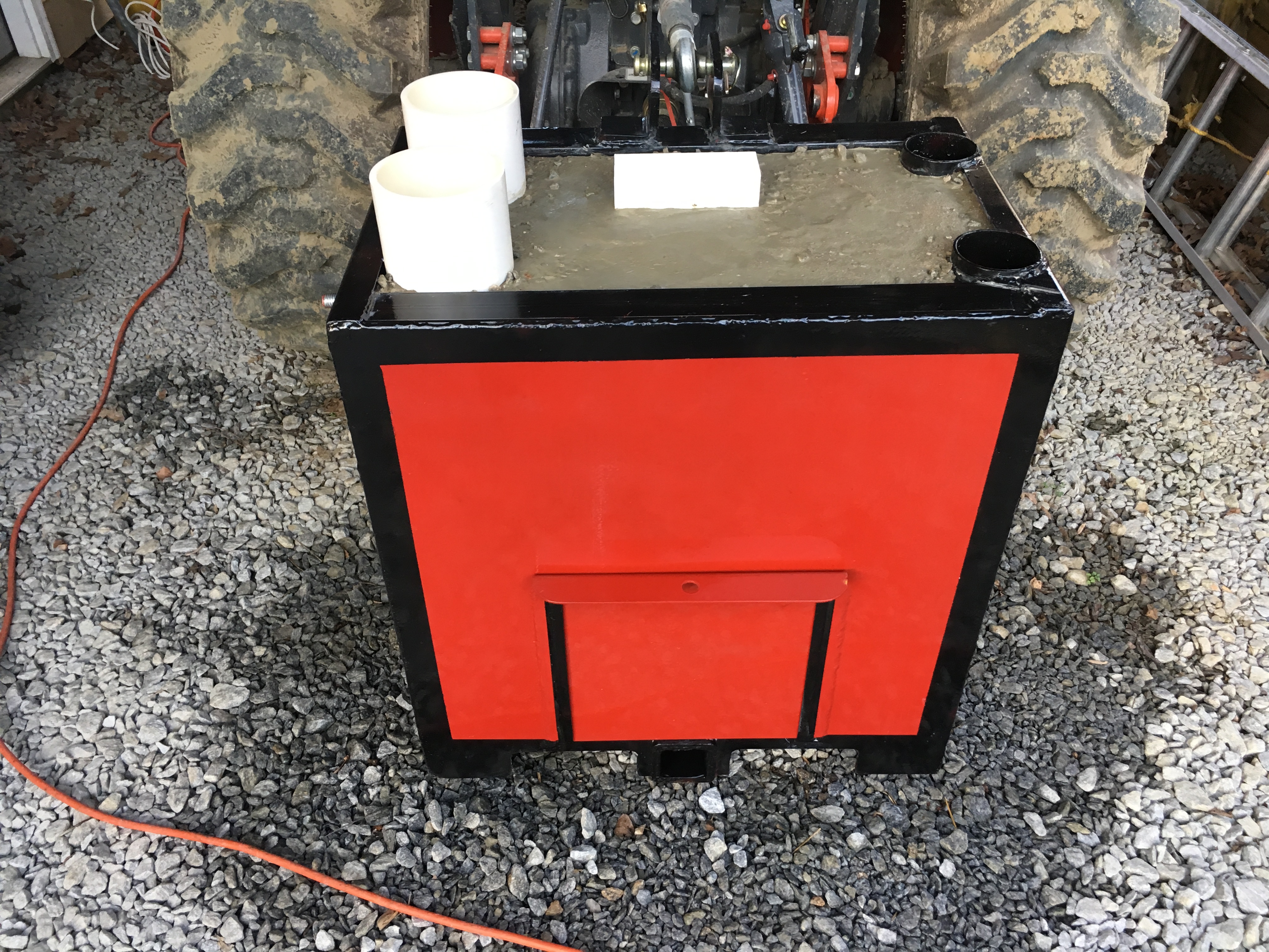

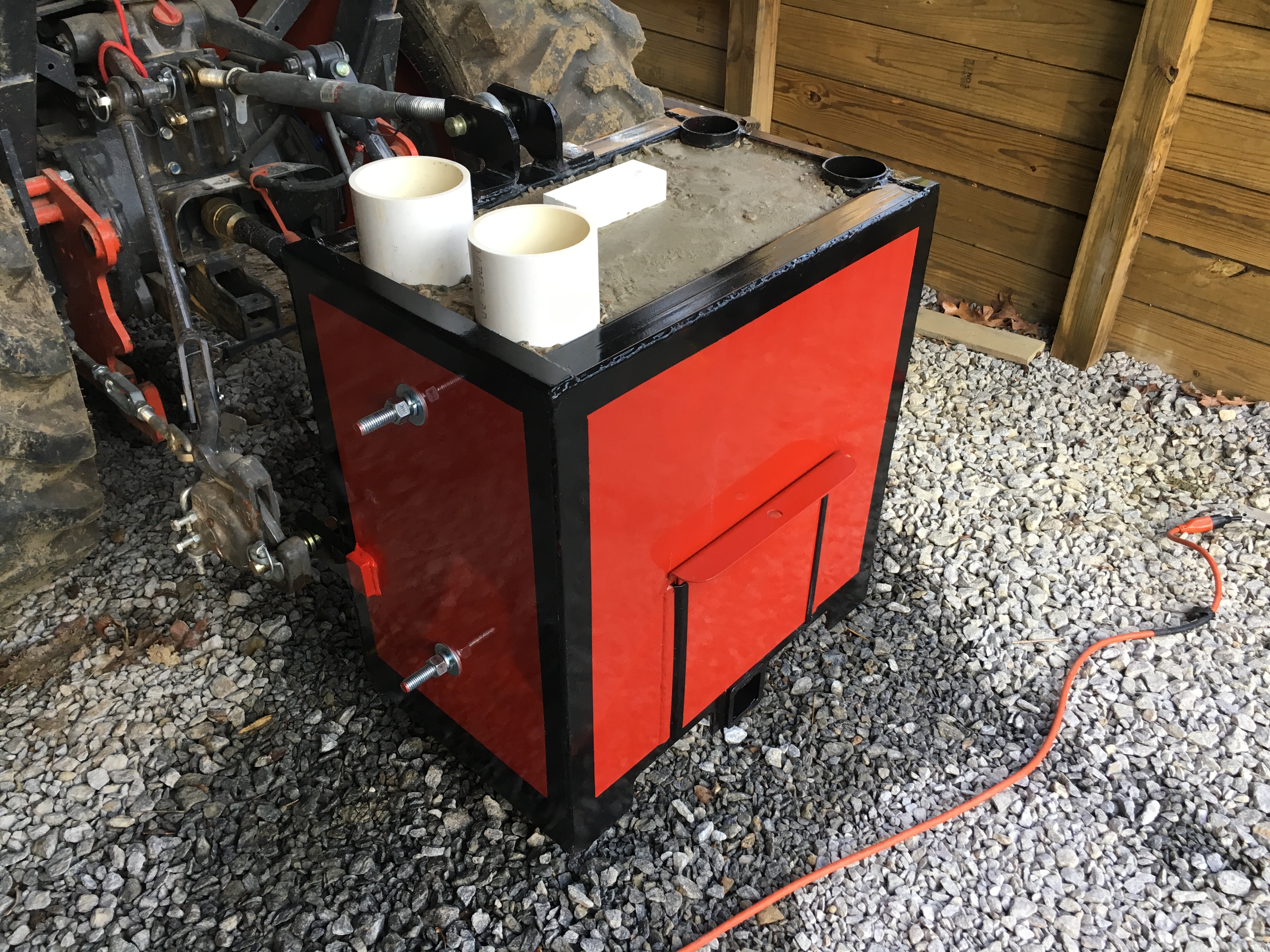

   / MX 3pt ballast? #16

I use the Titan ballast box behind my MX5800 and L6060. I load it with gravel and it weighs in at around 900# with a few wheel weights stacked on top. I like its compact size when working in close quarters. Filling it with concrete would add a bit more weight but I like to use the box empty on occasion to carry material, tools, etc. I have filled rear tires which also helps.
