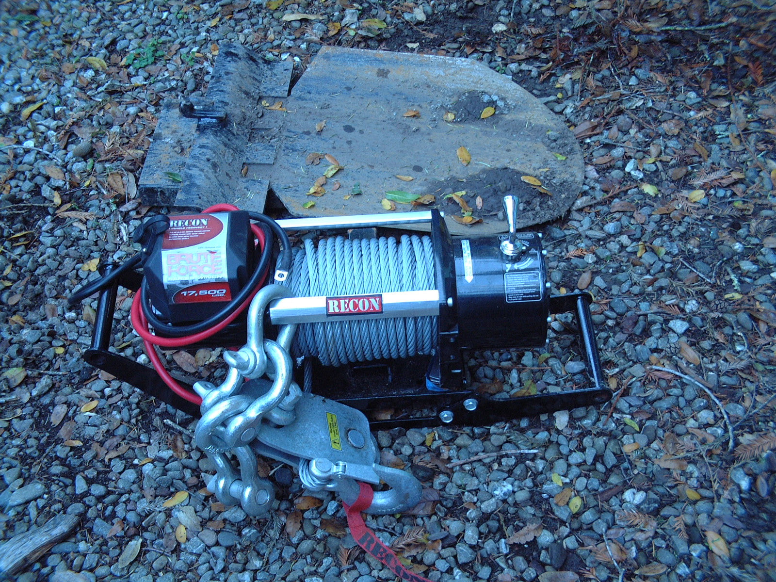

Your rig is very heavy. If it gets really stuck an 8000lb winch is not going to do it. For a full size truck at least 12000 lb winch minimum. If you can, go hydraulic... no batteries / charging system concerns etc.... The portability of electric is nice as well. I went through the same trials and tribulations when buying a winch to recover a stuck skidsteer on my property. I settled on a RECON 17500 7HP electric winch, purchased at auction on Ebay for $480 if my memory serves me correctly. The portability and ready out of the box aspects of a DC unit outweighed the duty cycle of a hydraulic unit for me (not to mention the cost).
Recon Accessories: Products
One fair warning. This thing is muy grande. It will not fit on a standard receiver mount (bolt hole spacing the the same, but the overall size interferes. I have attached a picture of mine on a receiver mount. I used a stock receiver mount and flipped it upside down and popped in some steel spacers. I was in a hurry, with a vehicle to recover and have yet to make a proper mounting setup. It quickly yanked a 8500 lb skidsteer up a 45 degree slope and paid for itself.
After much research I realized that most of the big companies are not using re-branded Chinese made winches and OEM'ing them. So if you wanted made in the USA that is difficult to find.
Steve
