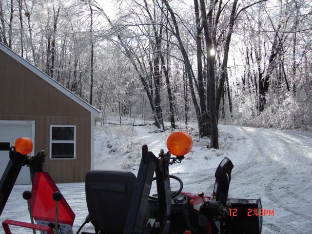

Here's a coupla shots of when mother nature wasn't quite so accomodating- last December's ice, a January storm. Only problem with driveway is that it's really a bear in the winter!!

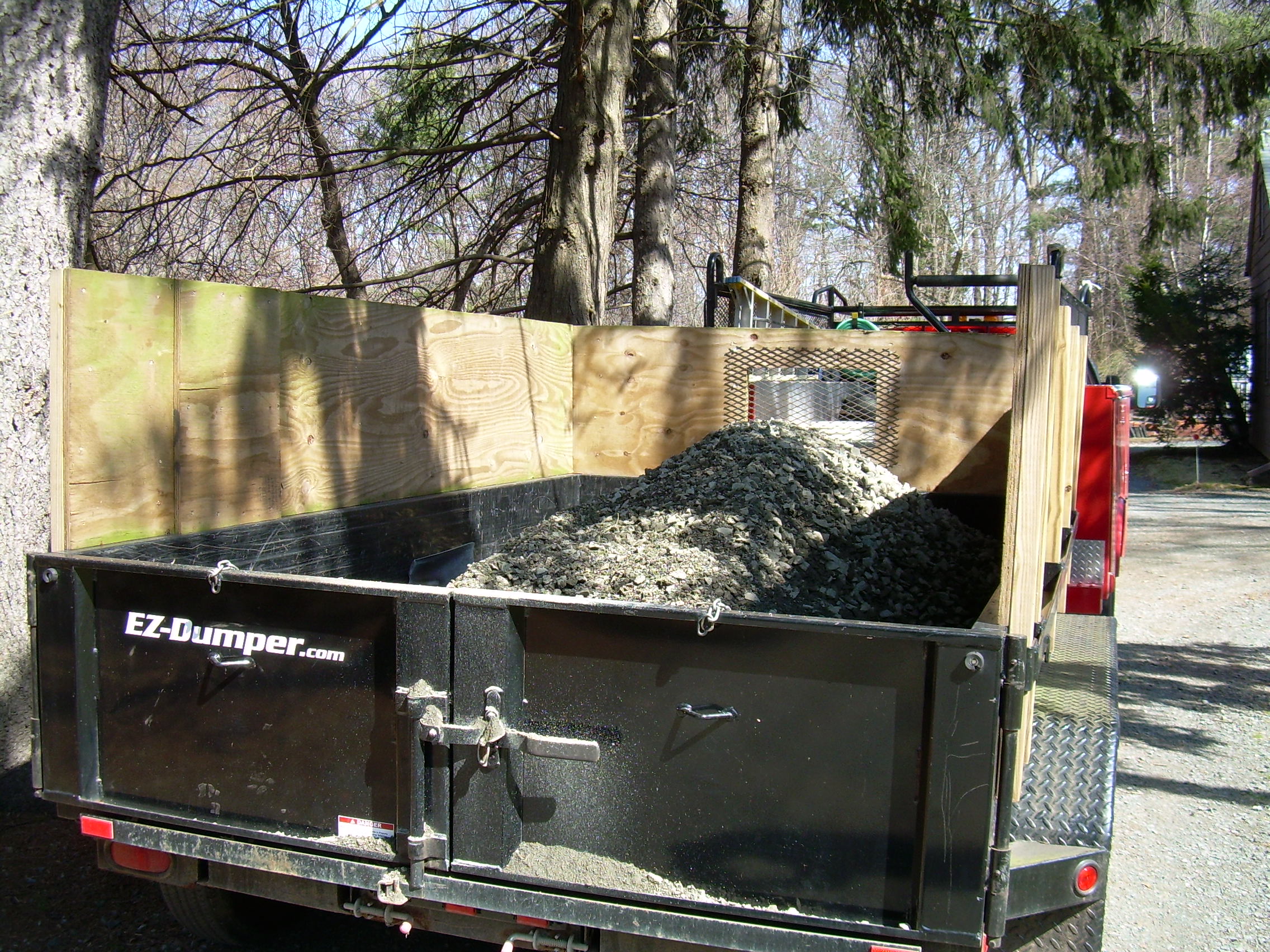

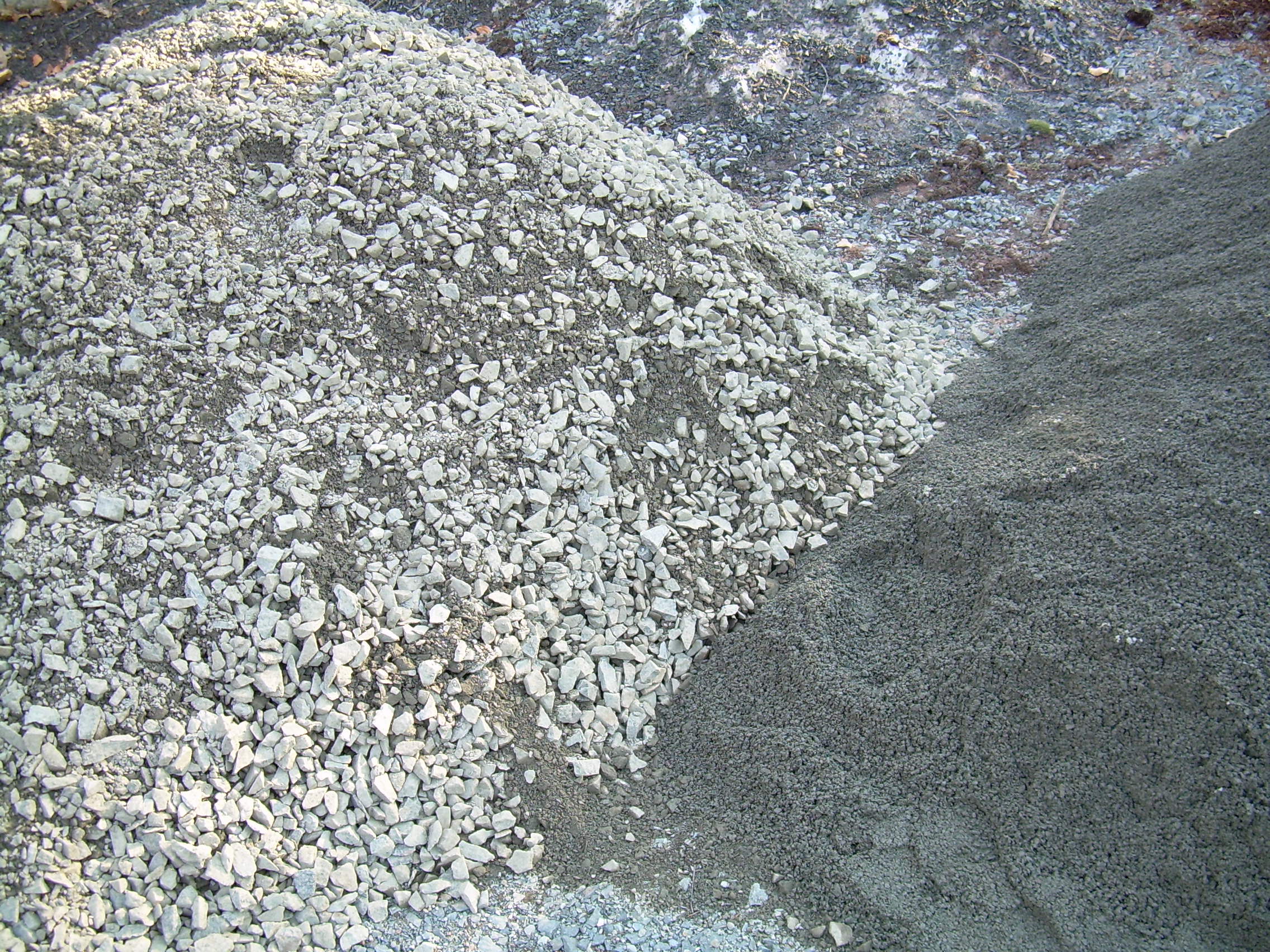

9 ton of 3" crushed concrete has provided a very temporary "band-aid". I see now that quite a bit more crushed concrete will be needed, in addition to the topping material, and perhaps some geotextile.
Most important is the need for drainage, which is the first recommendation I made when I saw the situation. That will probably be best tackled in August when the water table is down.
