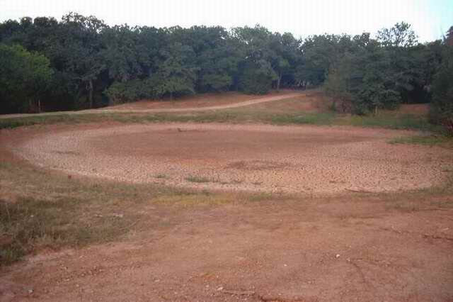

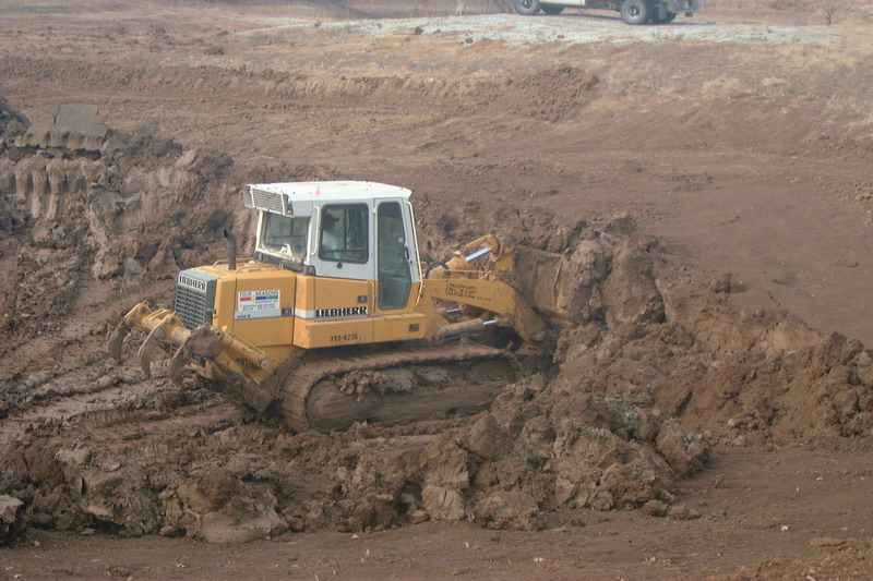

Here is a small dry pond.

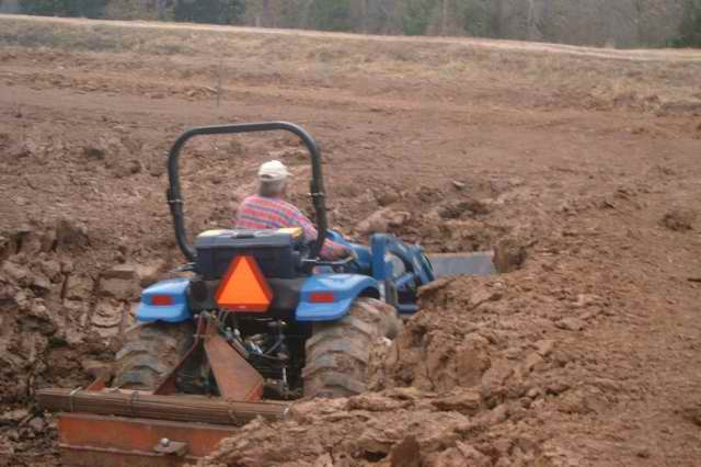

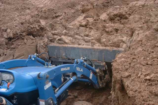

Here is my tractor searching for the bottom of this "dry" pond.

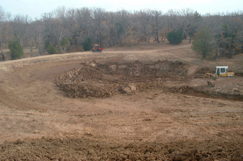

Here is the track loader I hired and the true depth of the muck.
Don't ever think that mucking a pond is a trivial matter. If you can't afford the right equipment, can you afford to have your tractor stuck in the bottom of the pond with a big rainstorm on the way? Just a thought. . . Good luck and be careful.

case245: My pond is about 125' x 200' because it has a little peninsula sticking into it on one side. It was built in 1941 as a fish breeding pond for the soil conservation lake we have. It had silted in for 65 years before starting. The dozer I hired was essentially $1000 per day. He was here for 2-1/2 days and my bill was $2425. I wasn't really happy with the work because the young operator had never done a pond before and I had to tell him how to get started. His boss didn't show up until about noon on the first day and never returned after that. With track loader, you can dig fine, but the muck wants to stick in the bucket. He spent probably 1/4 of his time cleaning out the bucket. I also had a place for spoils immediately outside of the pond. I think a dozer would have been better because you could start at the edge and work across with straight pushes. That's what another dozer operator with lots of pond experience had suggested. Anyhow, after 2-1/2 days, the job was still rough and unfinished, but the operator had to go to a contract job building pads in the oil/gas fields where they were contracted. I did a tremendous amount of work by myself on the banks and dam (my avatar is from that). My tractor did a lot of work, but the muck was out of the pond and there was no danger of being stuck; just long hours of hauling load after load up and out. In the end, I am very satisfied with the result.
Dean: That pond had been bone dry for six months. It was so dry on top that I could easily drive my nearly 6000 lb tractor across the surface. However, down 18" and the "pie crust" turned to filling. The more muck there is in a pond, the worse this situation is because the crusting surface will prevent evaporation and all that water will be sitting in the muck. I don't think it would have completely dried up in two years. That's about how long it took for all the spoils to dry after they were piled about 10' high.
pjbci: That's exactly why they used to use draglines for ponds. However, draglines are now rare. These days an excavator with a long reach arm is preferred. If I ever redo my job, I'll get it done with an excavator, but I'll have to build a better access road because big equipment requires lots of room to maneuver.

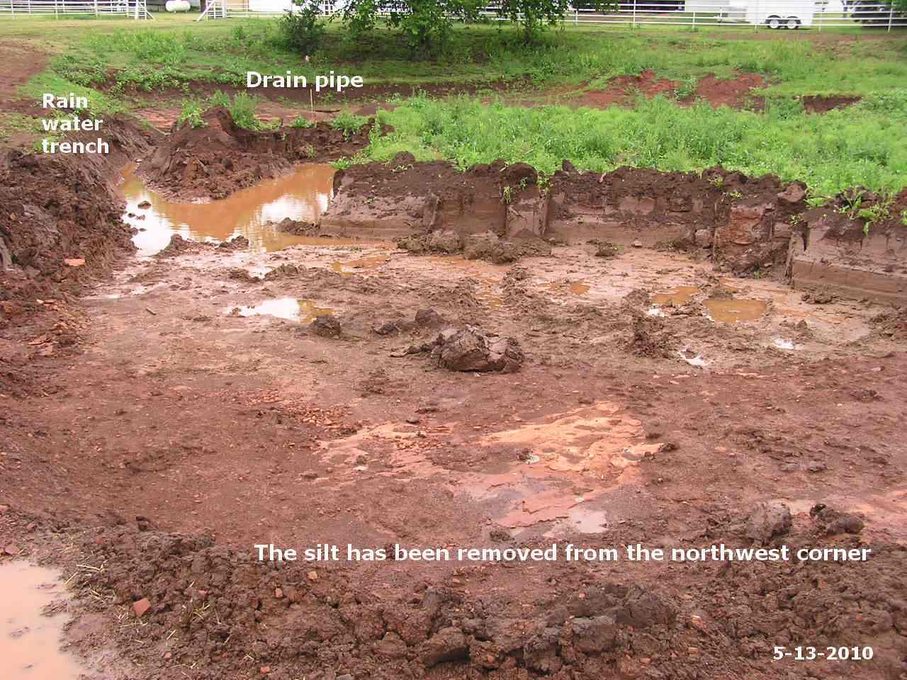

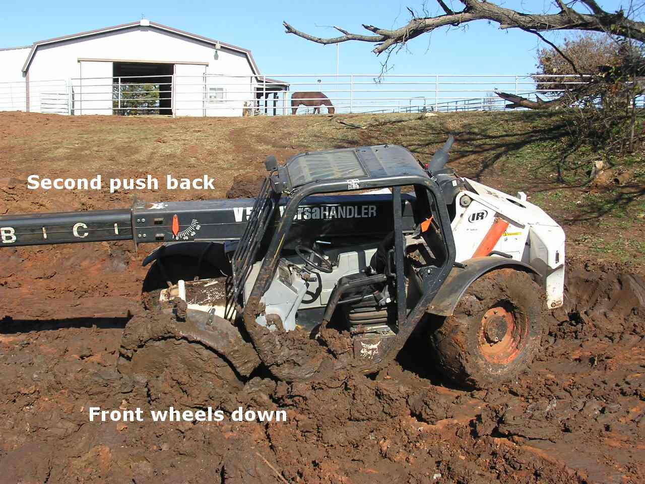

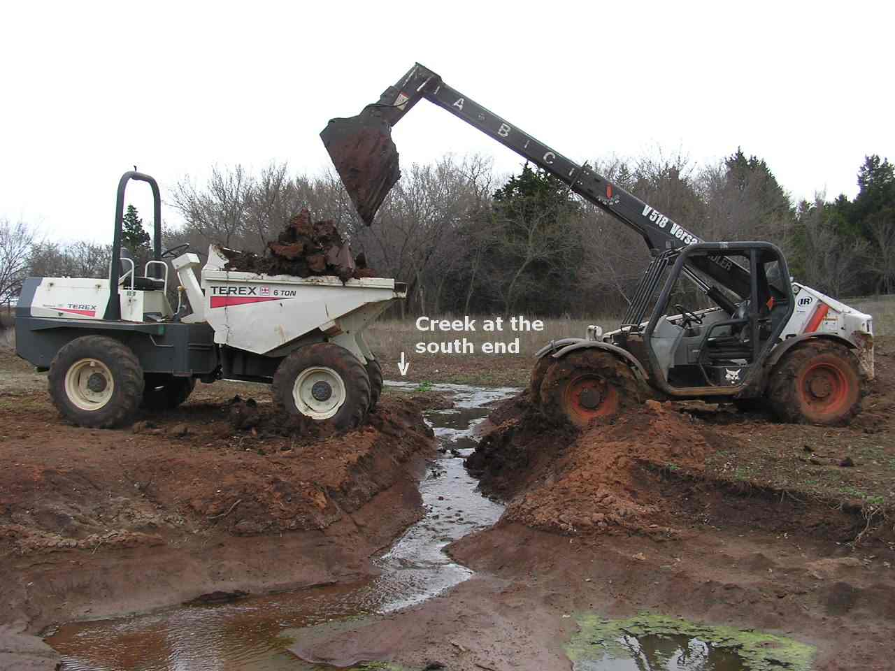

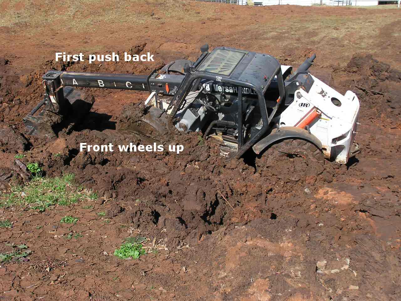

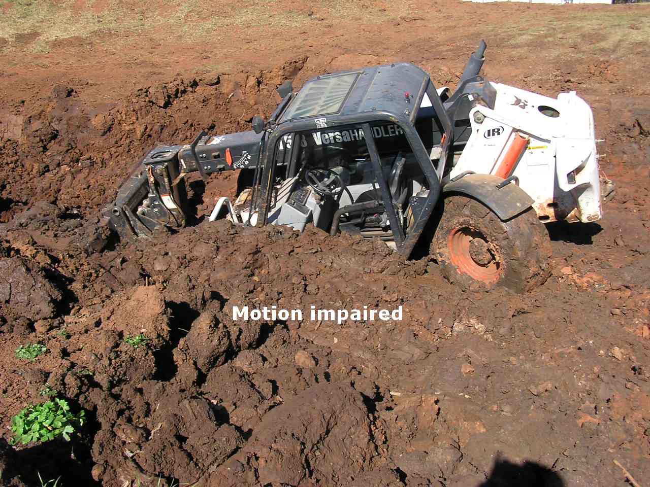

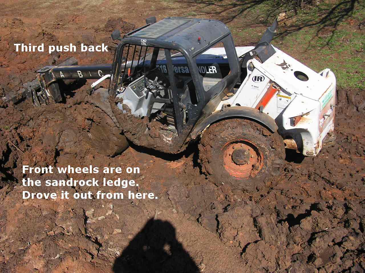

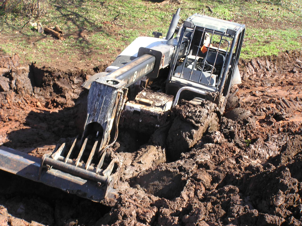

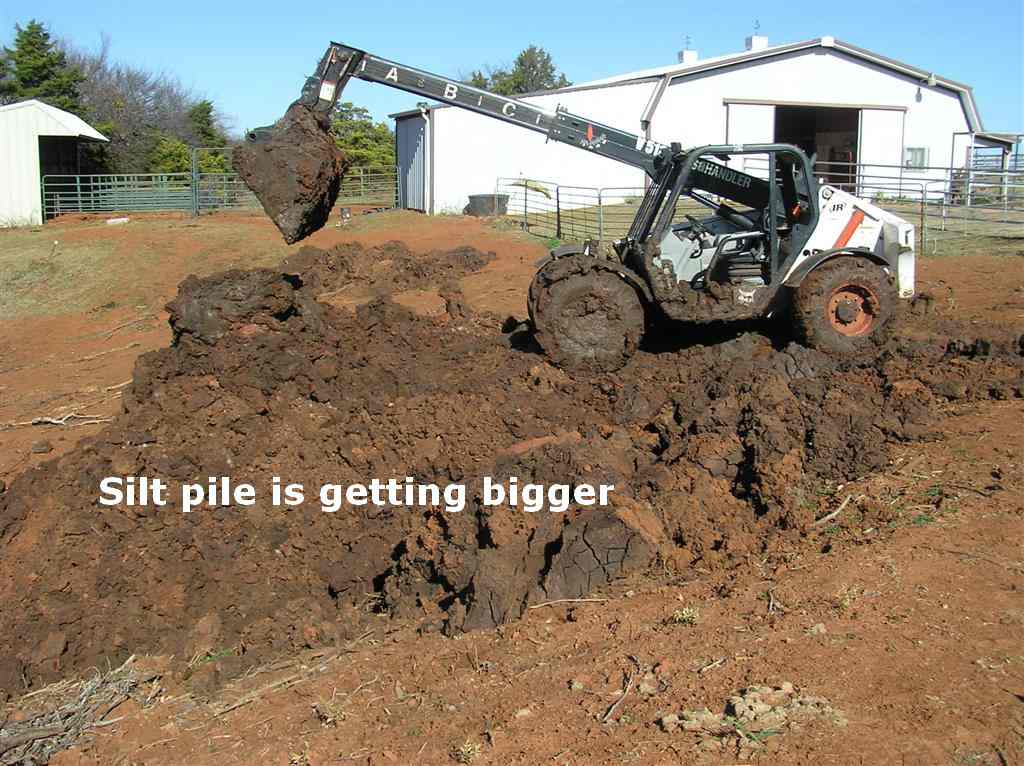

Yep, been there done that, The first pictures are from November 2009. Silt was 5' deep.
The bucket is 7.5' wide, 1.25 cubic yards.
PB300008.JPG PB300020.JPG PB300023.JPG PB300025.JPG PB300027.JPG PB300030 (Large).JPG

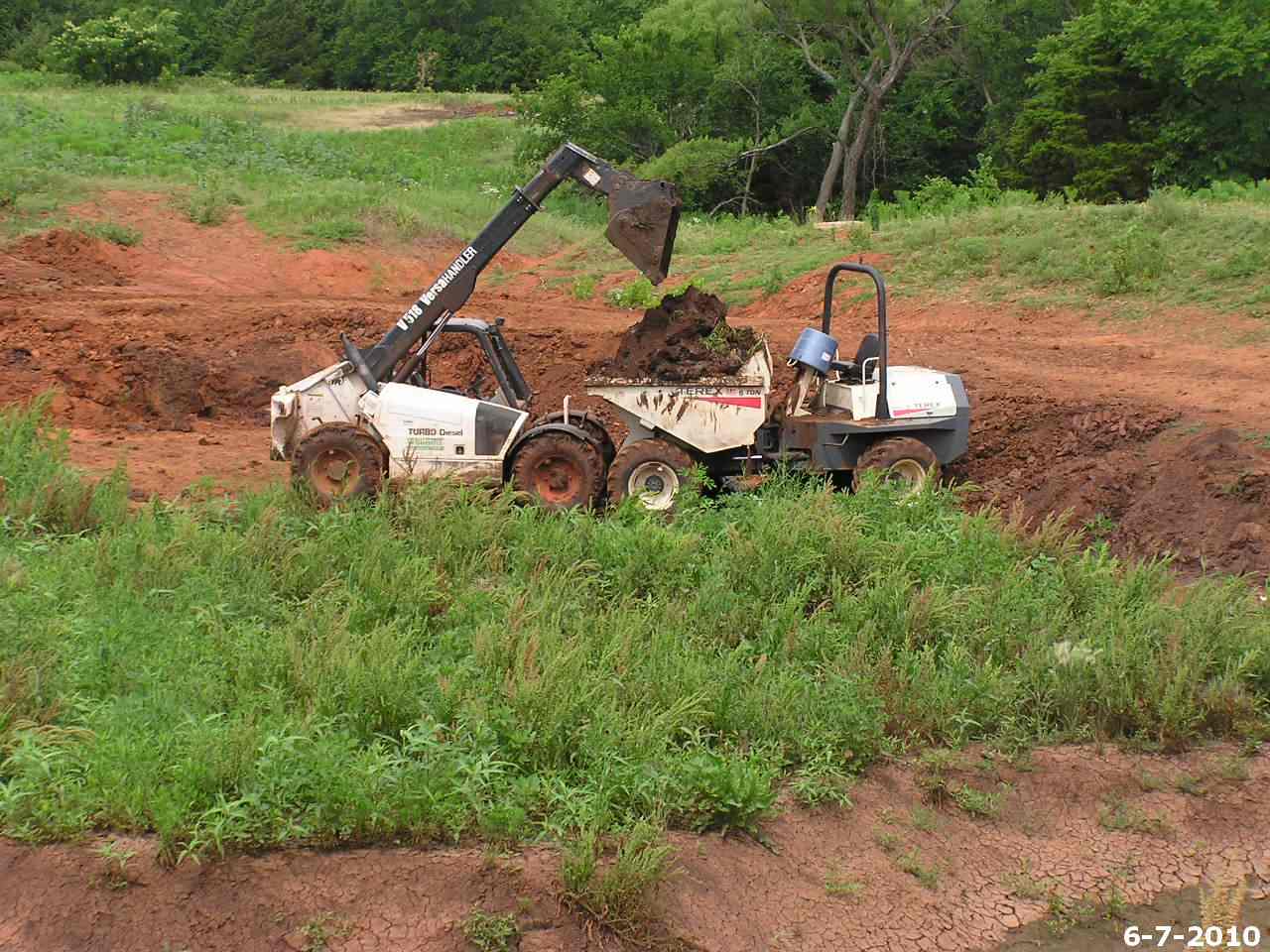

Moved 4.5 cubic yards at a time with the dumper.
