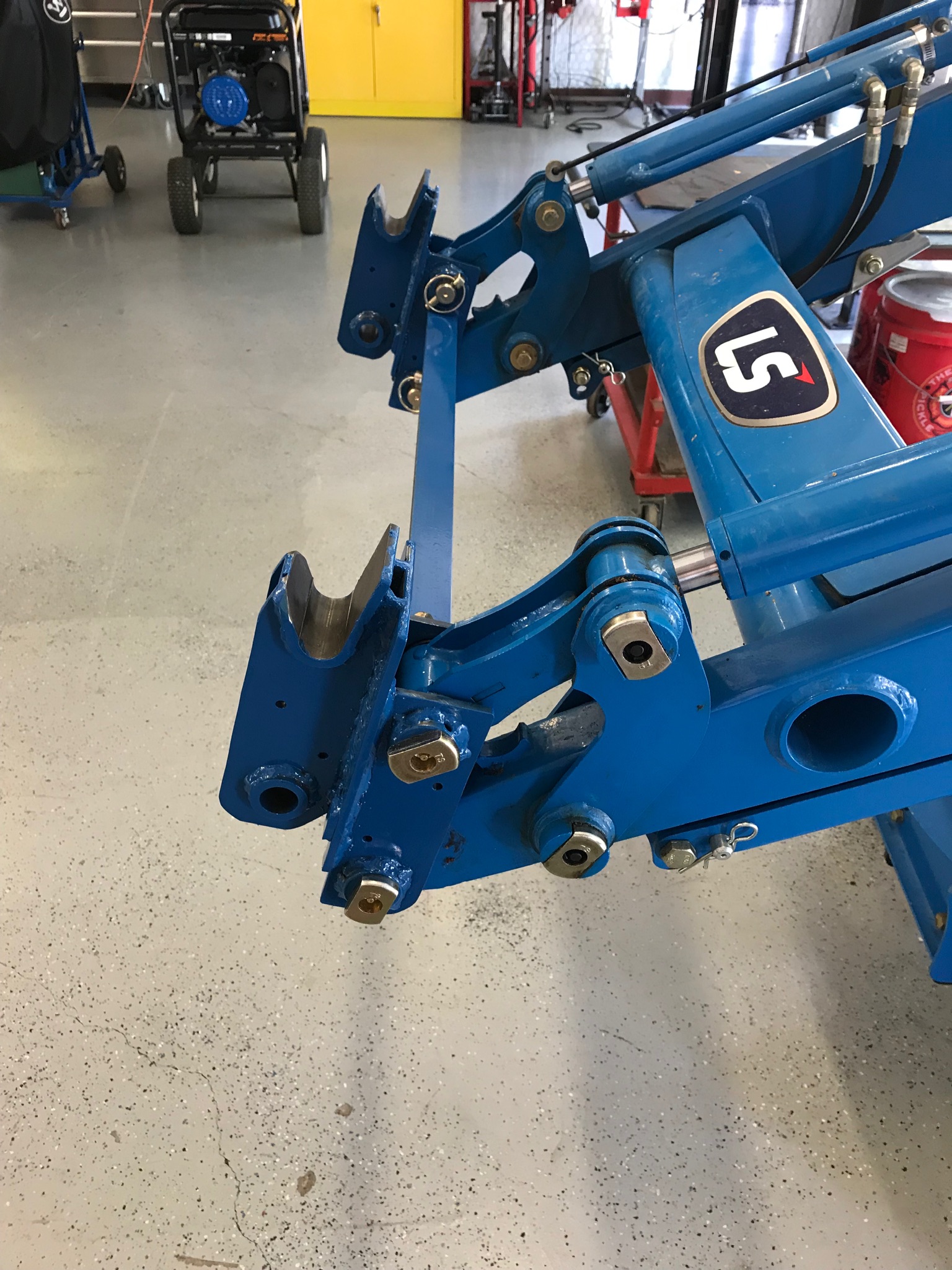

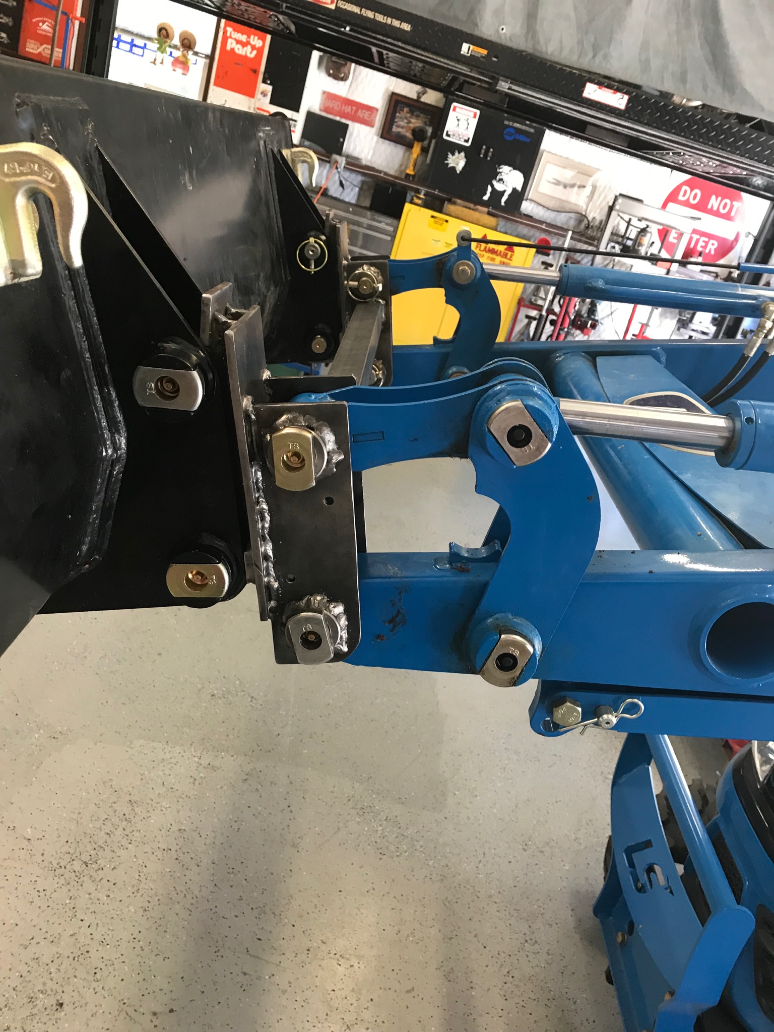

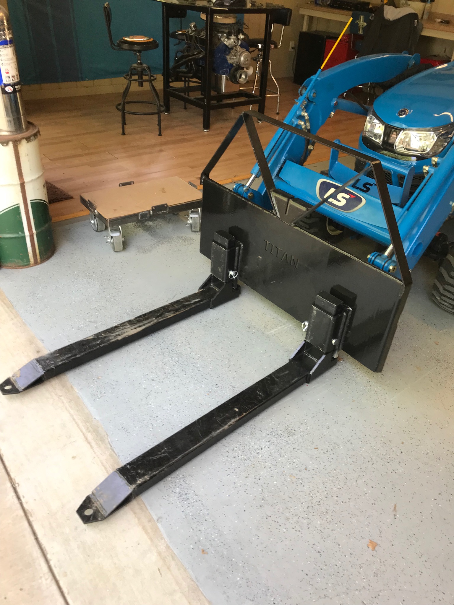

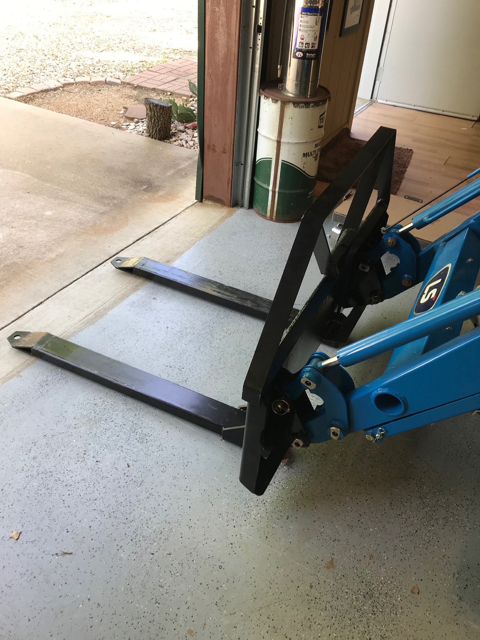

Since the MT125 didn’t have a quick attach, I had to cut the brackets A975BE7F-D280-4ABF-B5F4-A5B938F96E2A.jpeg990E3762-4A36-4A32-827B-FF1EFC979D07.jpegB99EC3D3-59A0-43E9-A331-965BB4F1ECB6.jpegand modify a Titan forklift attachment to work. Really get a lot of use out of this.

Nice job on both projects. Did you make a quick attach or is it still a pin on?
/ MT125 customization #33
It’s still a pin-on. I thought about building a QA plate but in the end decided I couldn’t think of another loader implement I really needed so just duplicated the attach structure on the back of the bucket. Also with this Titan forklift setup, you can remove the forks and insert other things into those brackets if i wanted to mount something.

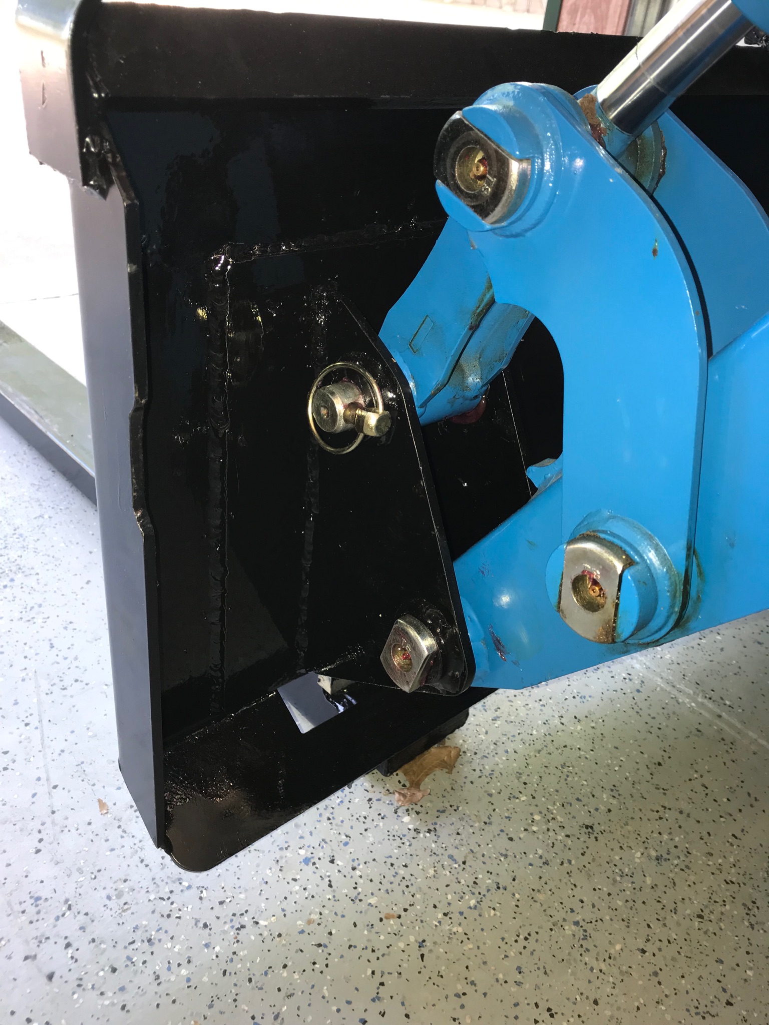

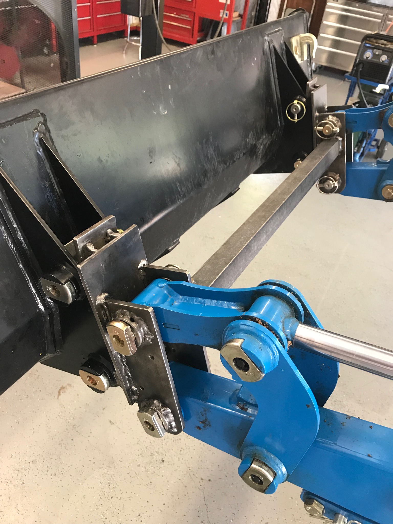

Had some vacation time so I built a quick attach for the FEL to fit the original bucket and the new forks. Not as smooth as a SSQA setup but it works pretty well. No comments on the welding.. some of these were work in process shots that got cleaned up later.

Yes. Top two pins stay in the bucket and you drive up, hook in, tilt back, then climb down and wiggle the bottom two pins in. Saw this design used on the small Kubotas and copied.
