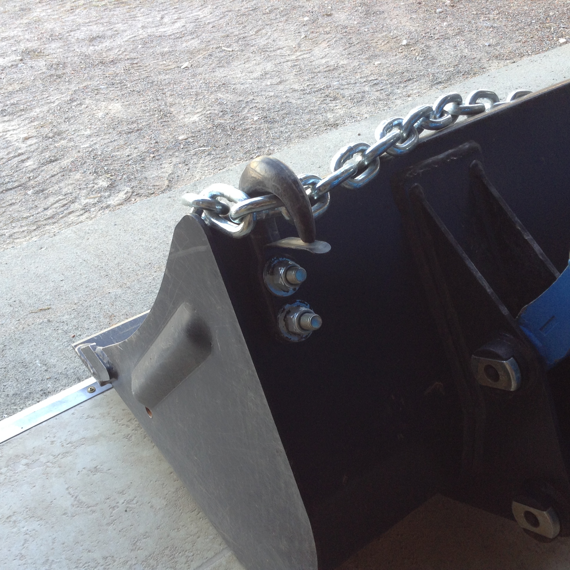

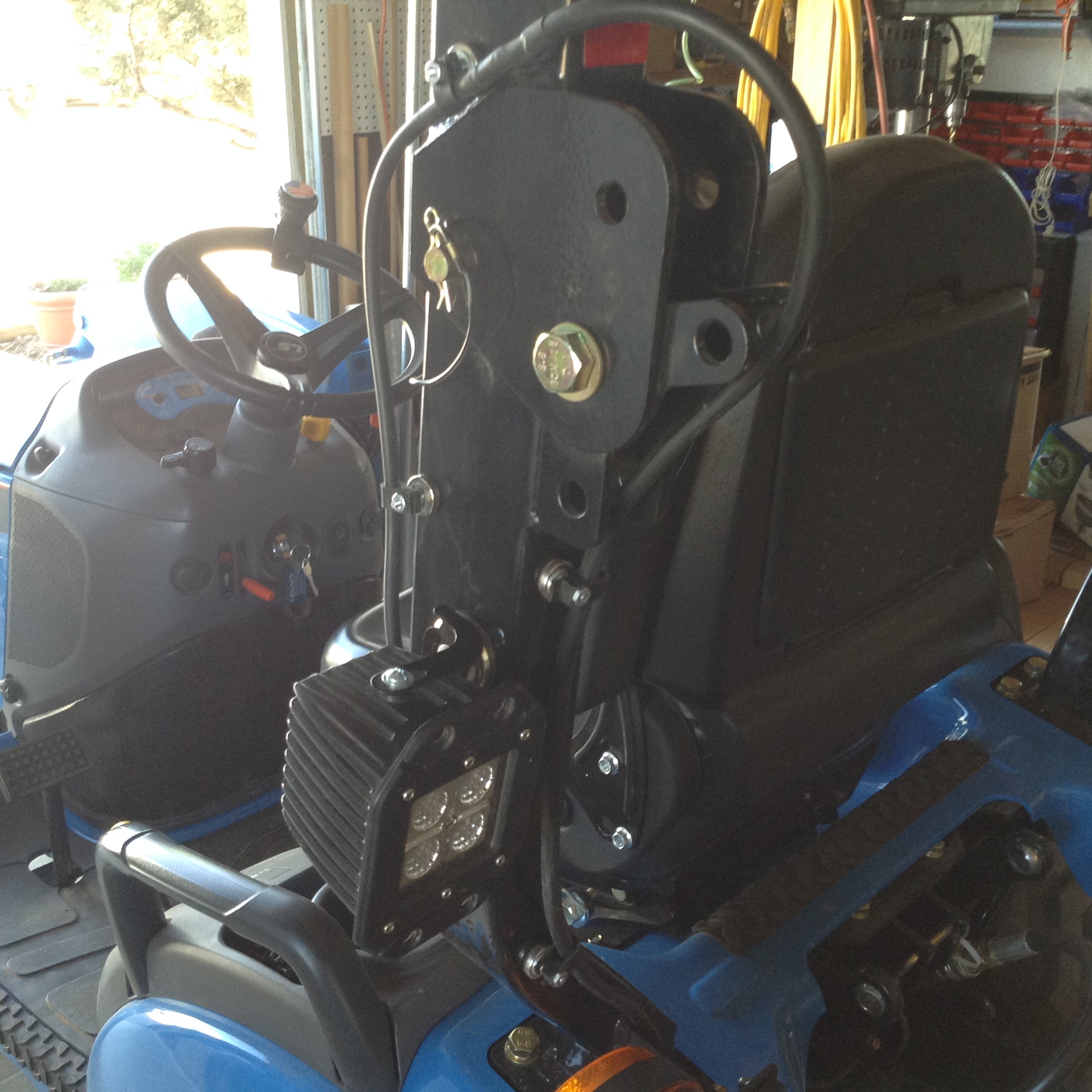

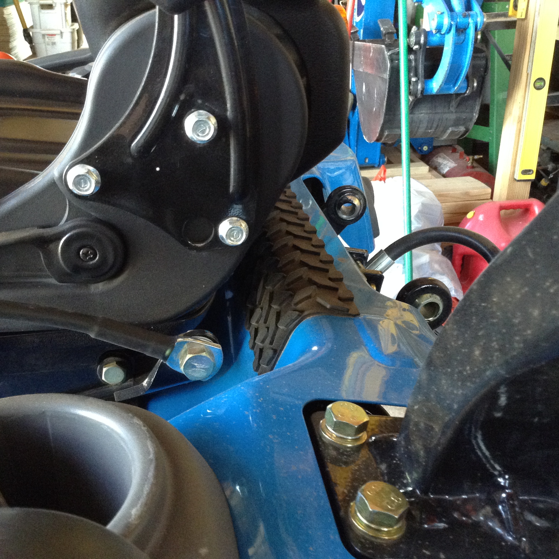

Finally got to finish up some extras on my little MT. Don't have a pic of it on, but added a Neat Farms tooth bar on the bucket. Also a couple of hooks. Definitely need to add a third one in the center, as I quickly found out using them today to pull out 16 - 4x4 fence posts that have been in the ground about 15 years.

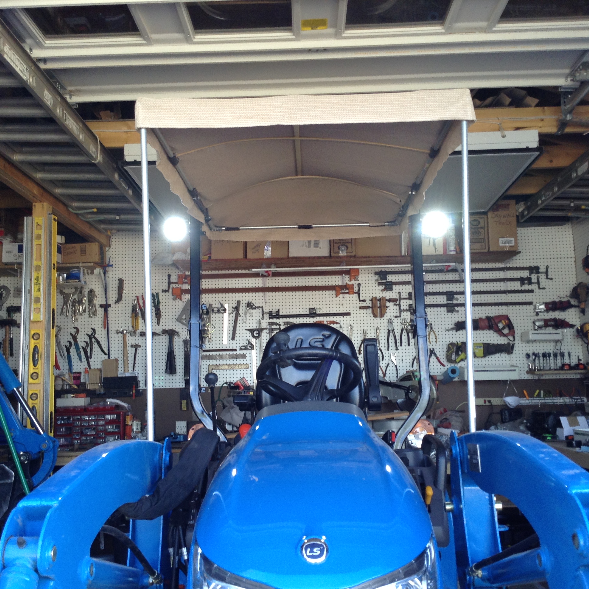

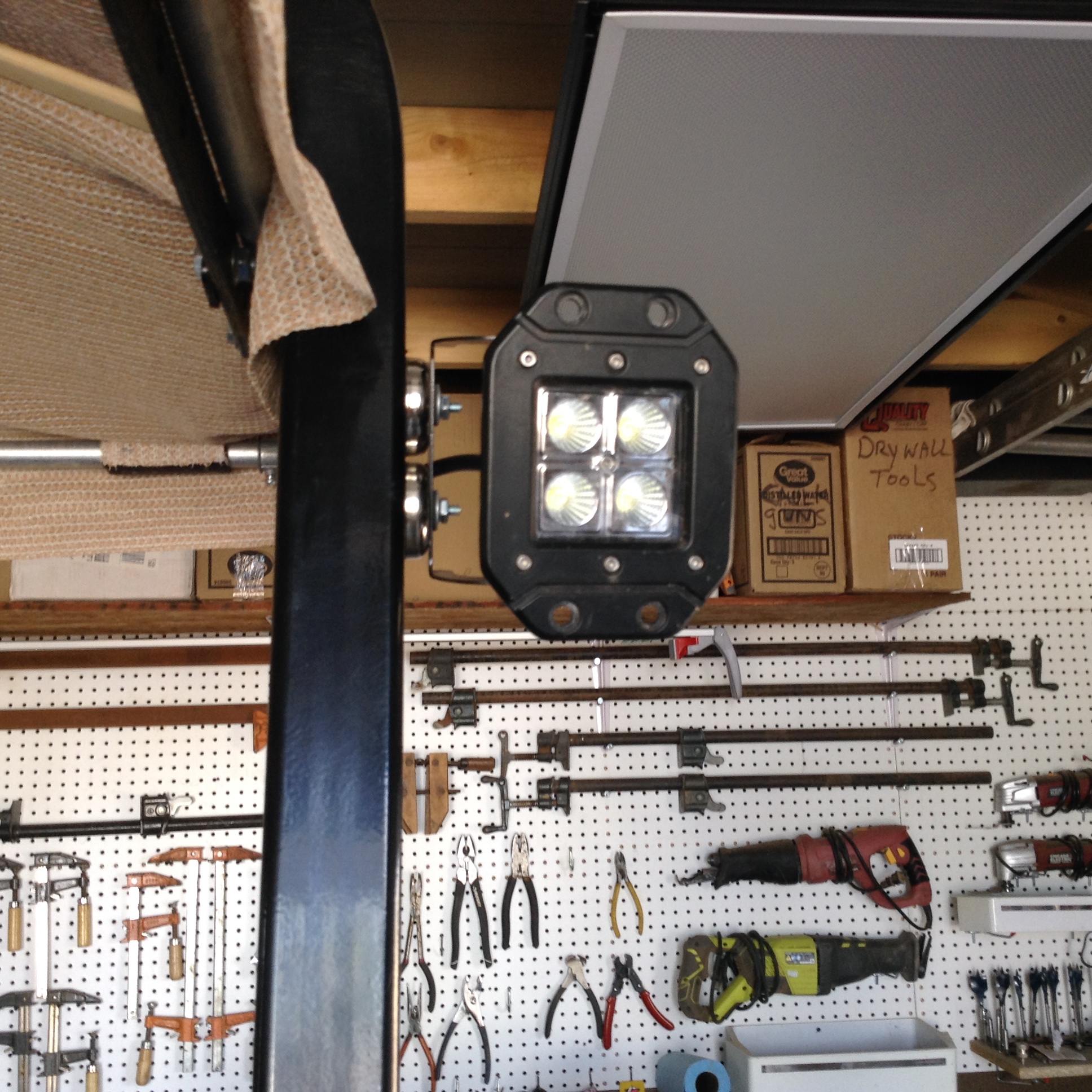

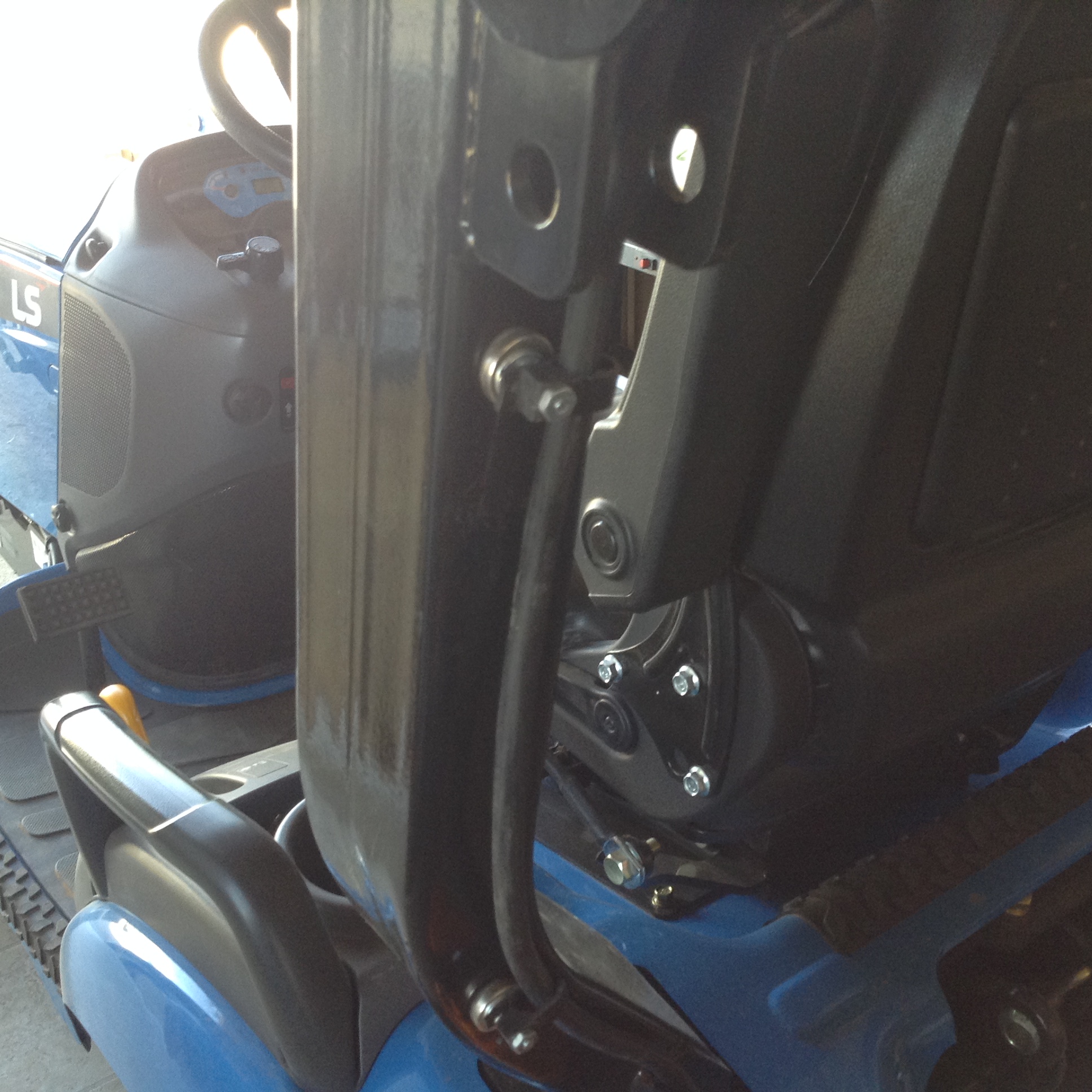

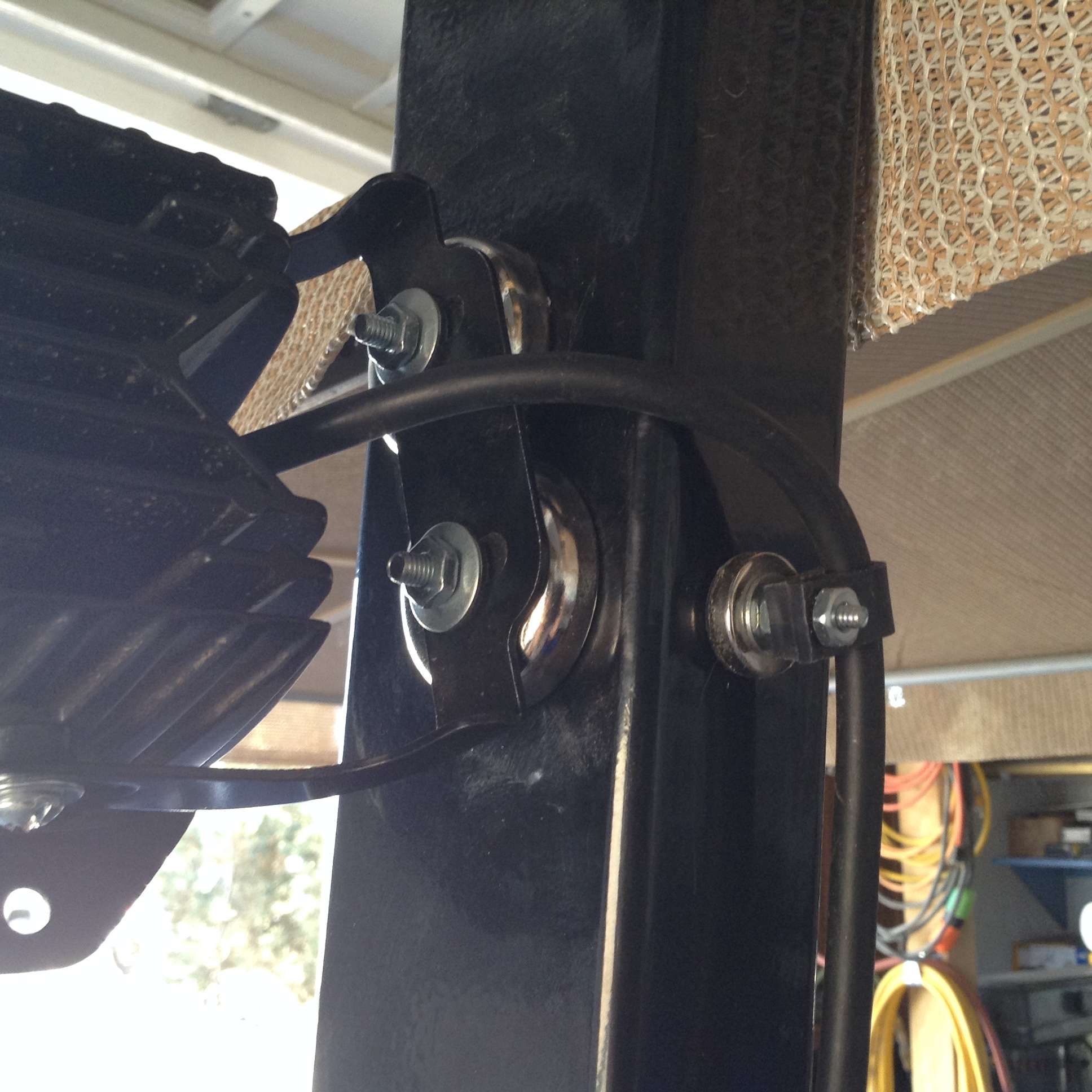

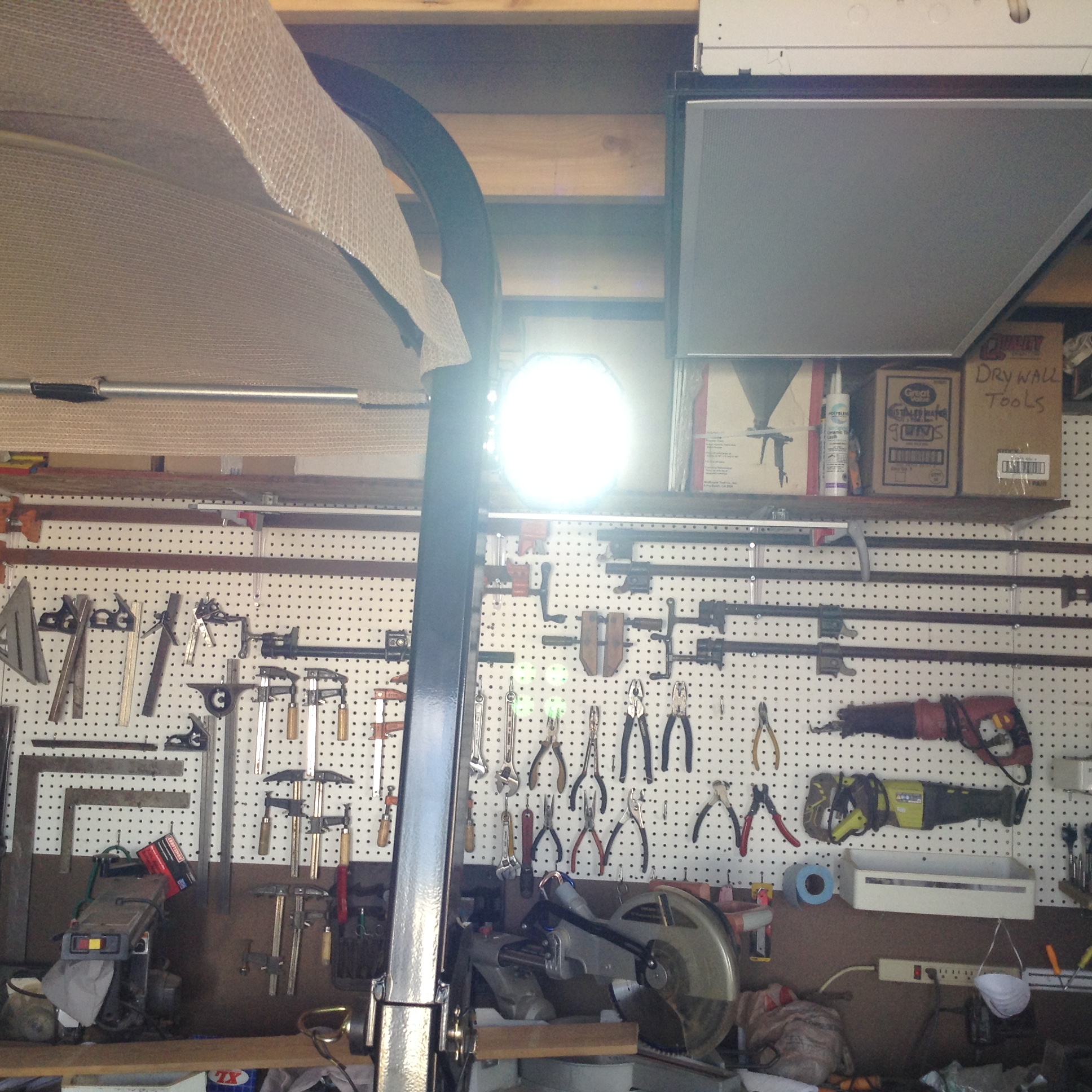

Next added some LED light cubes. I used 2-30lb magnets on each light, this way I can easily move them to the rear, or bring them down onto the fenders, or even underneath if needing to fix something. They also swivel, so can be and led out to the side. With that in mind, I used smaller magnets and small screws / nuts to use cable clamps to hold the wire. This way, no zip ties to cut or reinstall. Wire can get routed and held in place to wherever the light gets mounted.

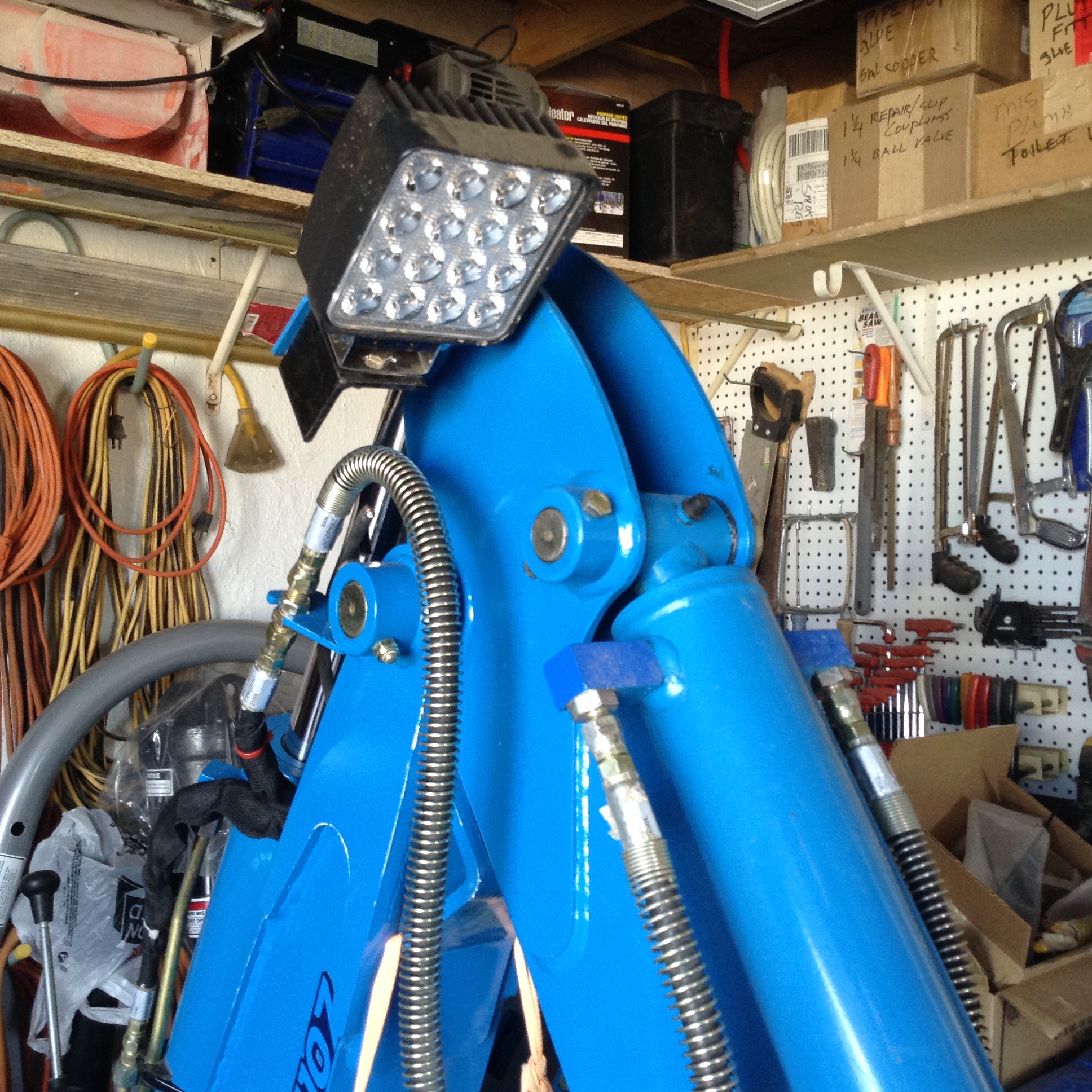

Next up was an LED flood light for the backhoe dipper arm. Shines wherever the bucket goes.
Got the lights off eBay, $30 for the 2 cubes and 2 of the 4" floods. They are better and brighter than expected.

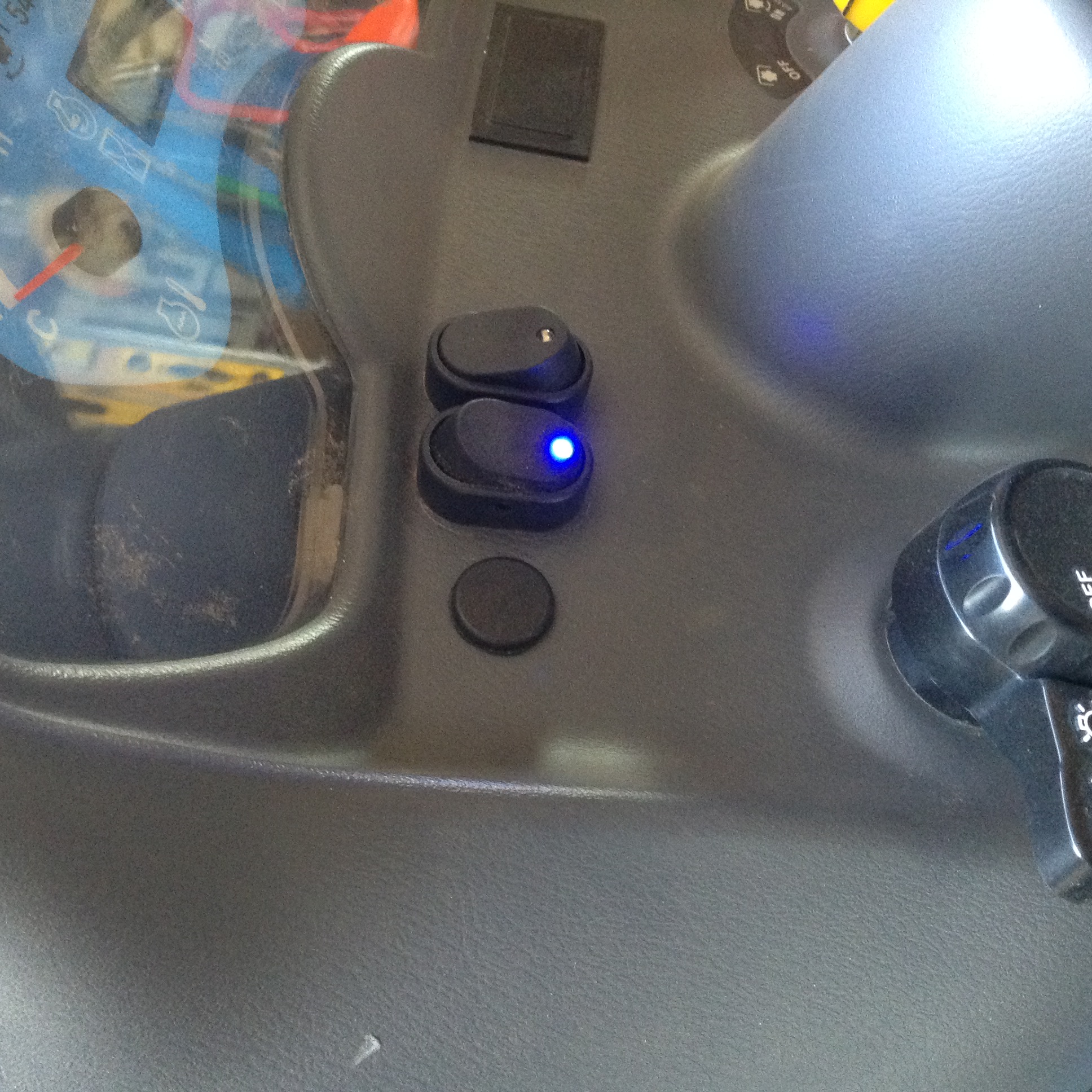

Wired them using relays direct from the battery, blue (of course) LED lighted switches. One for the tractor lights, one for the BH light. Used automotive pull apart plugs at the rear for when the BH comes off.

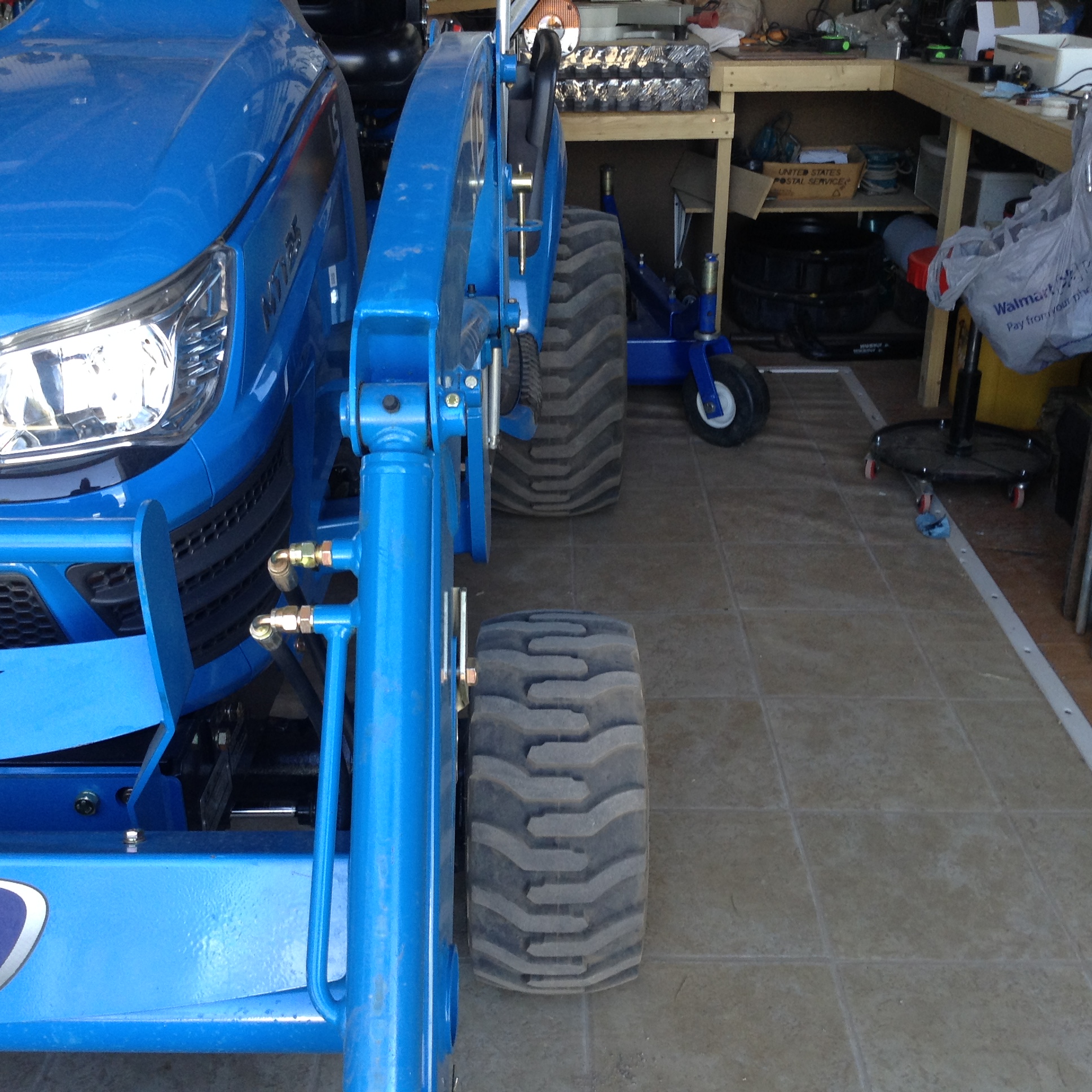

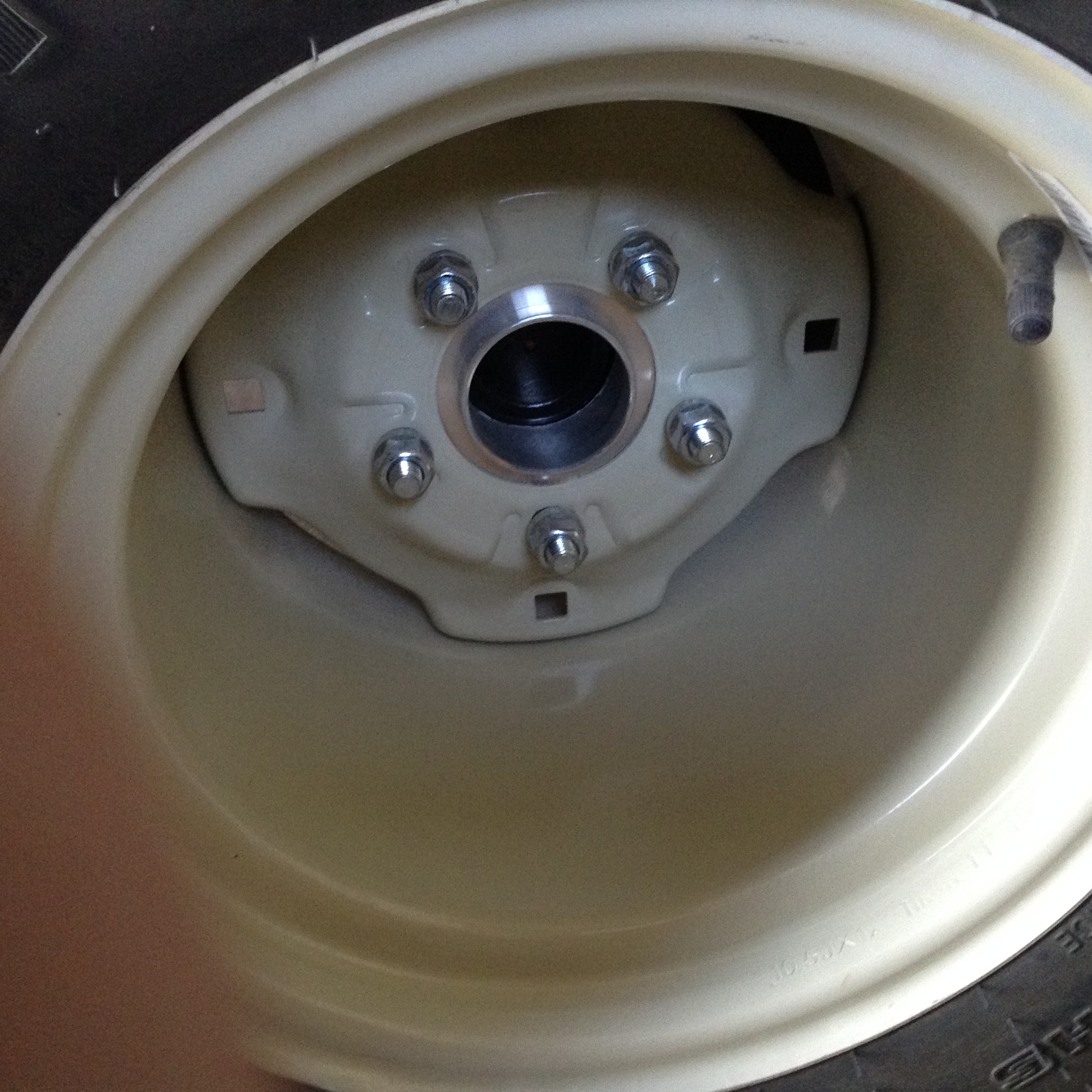

Couldn't stop there, so added 1 1/2" wheel spacers on all 4 corners. Really makes the tractor feel much more stable, especially with a loaded bucket on rough terrain. Rears are 'flush' with the sides / edges of the front bucket.

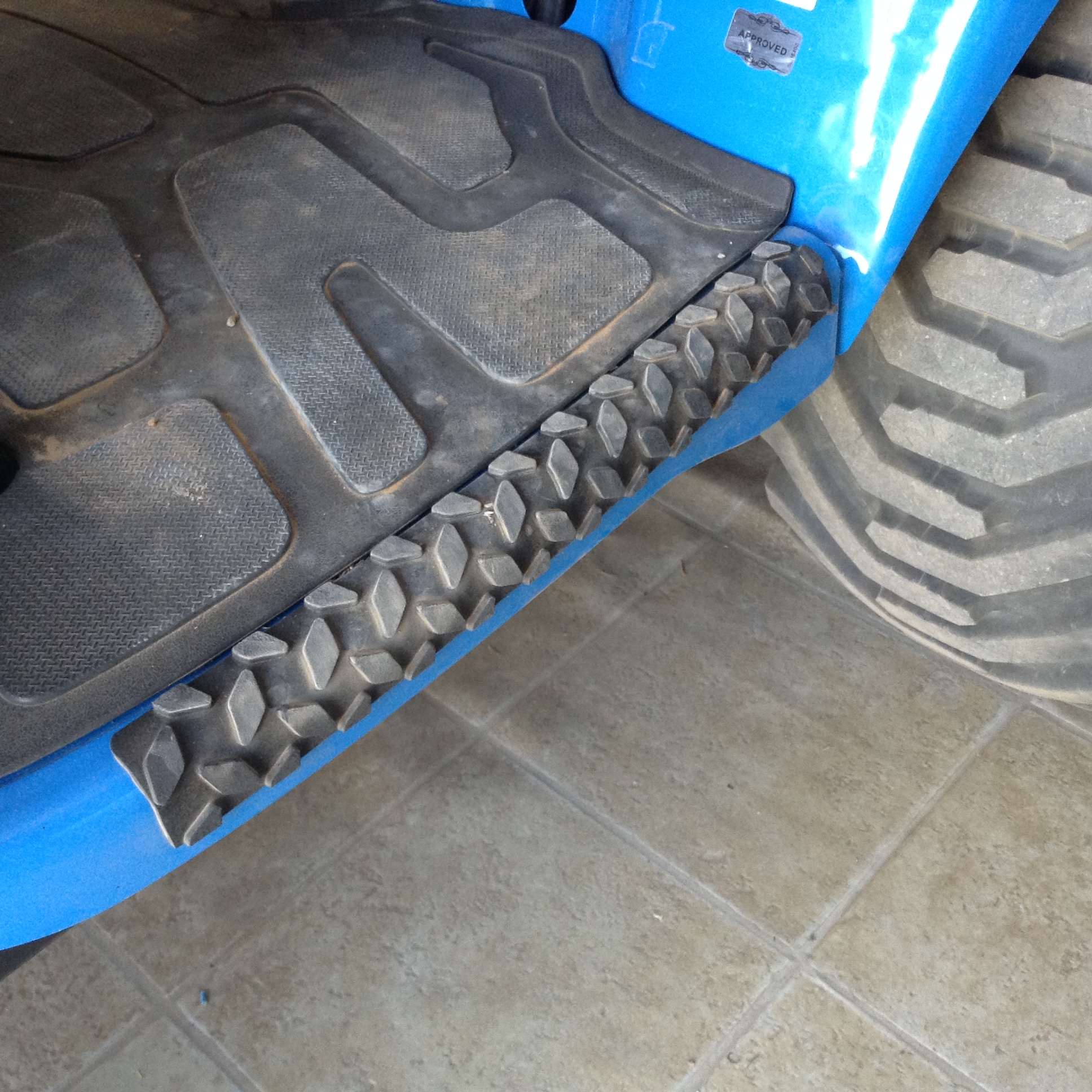

I noticed that I was scratching the outer edges of the floor board getting on and off the tractor, where the rubber mat doesn't cover. Also the area right behind the seat (part of fender / rear body) was getting scratched from turning the seat for the BH operation. Happens if you drop the seat when it is only partially turned. I found rubber diamond plate, self stick step treads at Walmart for $8 for 2 treads. Put one behind the seat, cut the other one in half (surprisingly easy with a razor knife) and put them on the floorboard on each side.
Found the self stick worked on the full piece behind the seat, but the 1/2 cut pieces on the floor board started peeling in the middle. The bend is real tight in that area. Took them off, removed the remaining adhesive with mineral spirits, and reapplied them using exterior double-sided Gorrilla tape. They have been out in the sun, stepped on multiple times, and 50 degree temp swings. They are on there now!
Next project is going to be a static thumb for the BH. Eventually I'll plumb a couple of rear remotes, but that will have to wait for some better financial times (can't believe how much they cost, then of course top and tilt stuff for the implements).
Thought about fiberglassing up my own canopy, but decided that would really take a lot of time, effort, and would be a real PIA, so my current electrical conduit and sunshade cloth will have to do for now.

Here's a couple pics of the wheel spacing and front hooks

Some very neat and nicely excuted idea's there. I love the the rubber diamond plate stuff. Yea, behind my seat in that exact same area I have gouges in the paint from the seat. Gonna get that rubber stuff and use your idea there. Now on the lights, they were nicely excuted also. Love the magnets for the cabling.
Love the wheel spacers but I'm too old school as I remember the nightmares and stories of knocking outer wheel bearings out on our cars with the off set wheels. It truly shifts the load way outbound of where it was designed to be carried. I too wish our tractors weren't so short coupled and that side ways stability gives me the pucker factor too. I love the spacer idea but I can't take the chance of overloading the bearings. Just my thing.
Great idea's and being our backhoes are wired for the light with a bracket and everything there is no reason not to do that other then I'm not going to get caught out at night digging a hole. As I said earlier in another post, that gets into my wine time.

Thanks for the pictures of your work. There is an unused set of wires on the BH, did you look at using those for the lights? I will be interested to see what you come up with for the thumb. I joined a LS Tractor owners group on Facebook. A man named Jeff installed a BXpanded ripper on his BH as he says the measurements are the same.

Well, for the wire in the BH, yes, I did use that. Had plenty of length to get up under the dash.
For the stabilizers, I bolted on two pieces of 1 1/2" x 1 1/2" angle on each foot. Dramatically improved the grip when digging. I forgot about those, put them on about a year ago. The day after the first time using the hoe, sliding all over:shocked: Had the angle as scrap, used grade 5 - 3/8 x 1 1/4" bolts / washers / lock nuts. Hardest part was drilling the angle.

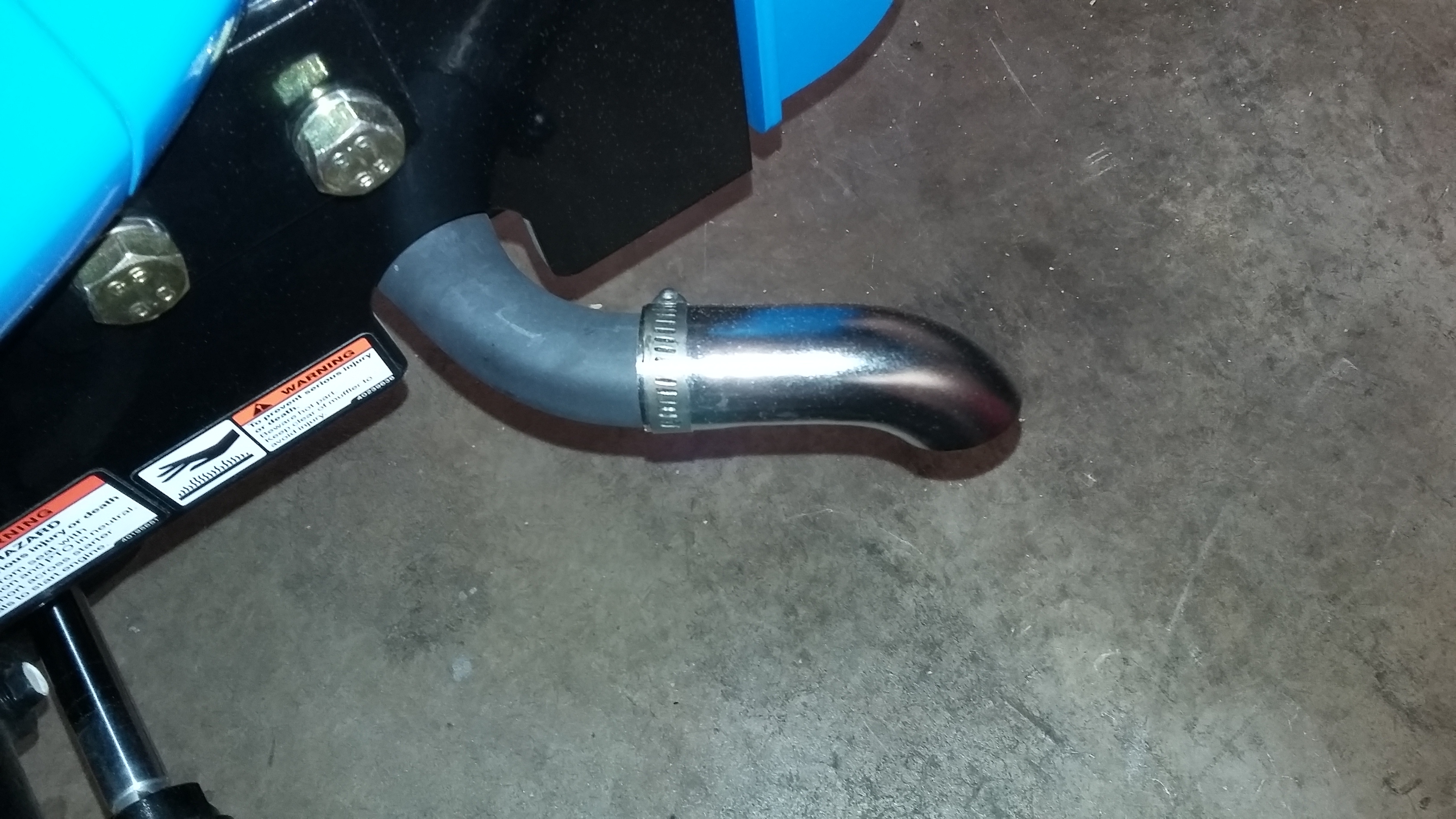

Well gentlemen, the lady has to have a chrome tip on her tractor................
Under $5 too. My kind of mod.................:dance1:

Good ideas you have there! I need to add some hooks to my bucket aswell for lifting and hauling/transport on the trailer.

Also I wonder how the wheel spacers will hold up? Will it cause any extra stress or should the tractor handle any extra stress if there is?

After speaking with the mechanics at my dealer, they say no harm to the axles / bearings with spacers 2" and under. At 3", starts to add additional load. I got the spacers off ebay, The 5x4.5 spacers are the correct bolt patterns, you need to specify the center diameter of the hub.

I put 2" spacers both sides, front and back. I could definitely "feel" the difference. Total 4" wider stance. I don't have the rears filled, if the backhoe isn't on, then my box blade is...that weighs close to 500#.

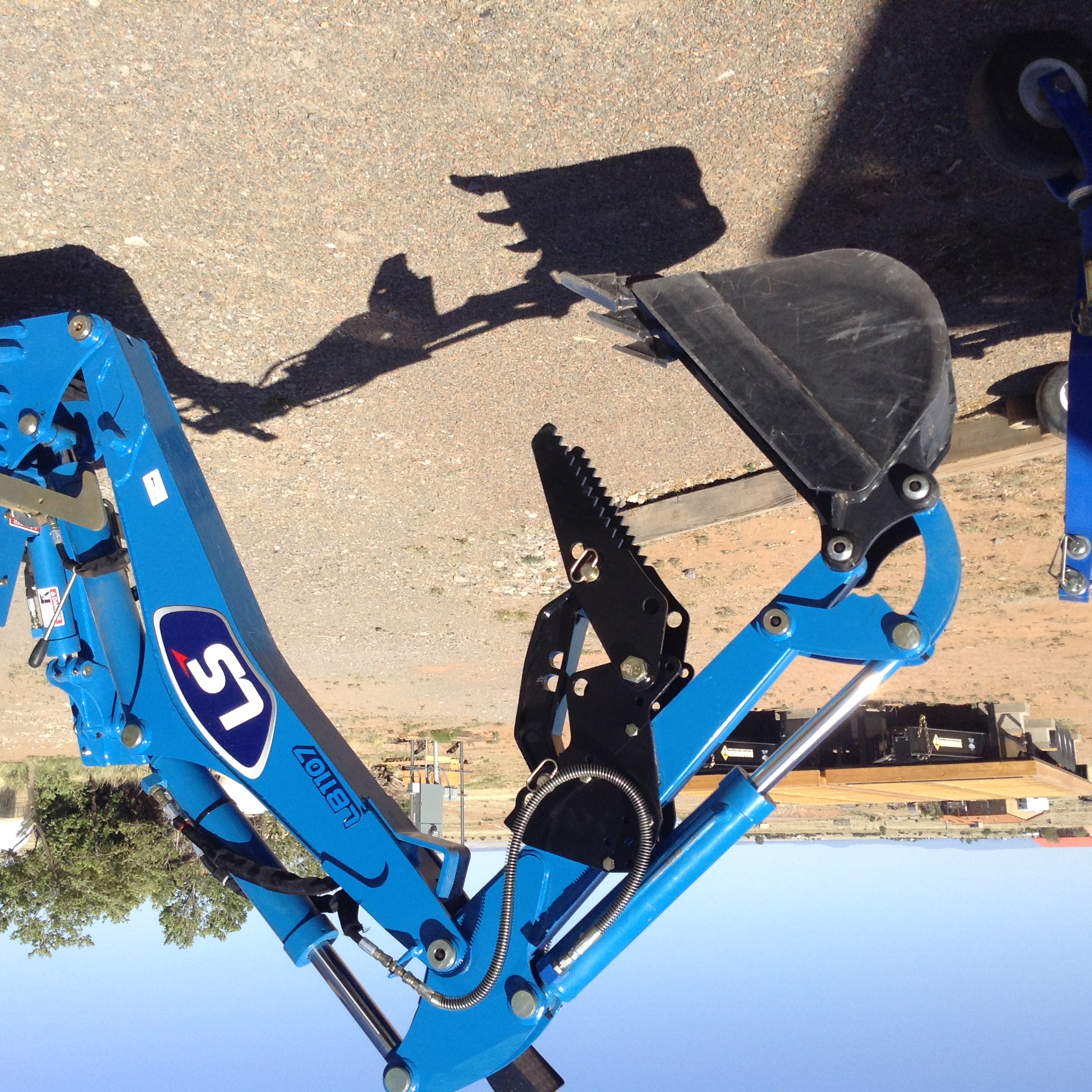

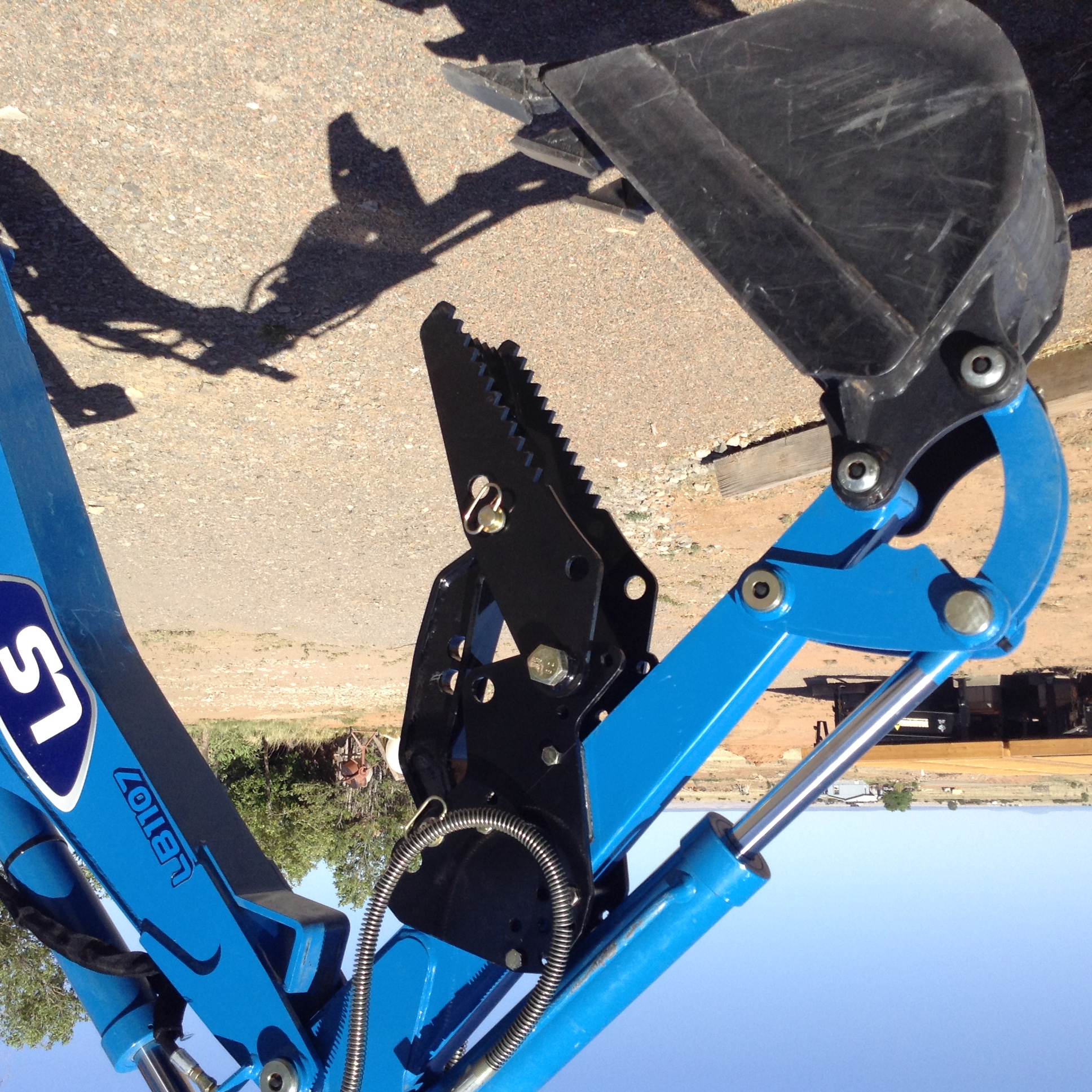

I don't have any pics of the stabilizer "feet" with the angle iron, I'll take some tomorrow. Here's a pic of the thumb I added. I mounted it higher up so I could grab bigger 'bunches' of brush.

Looks nice. I'm ordering a Piranha tooth bar and Thumb from BXpanded. Do you have a good source for bucket hooks?
