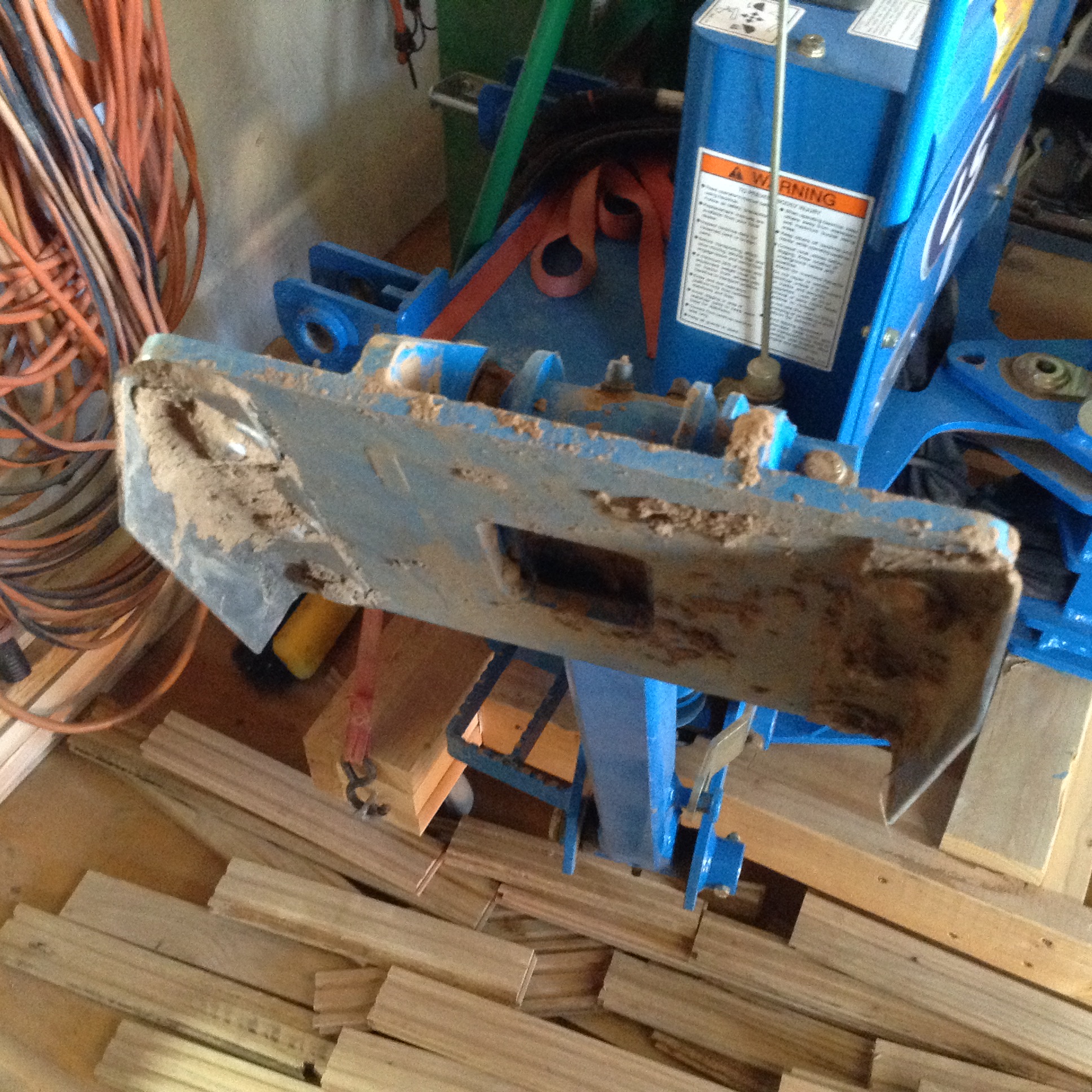

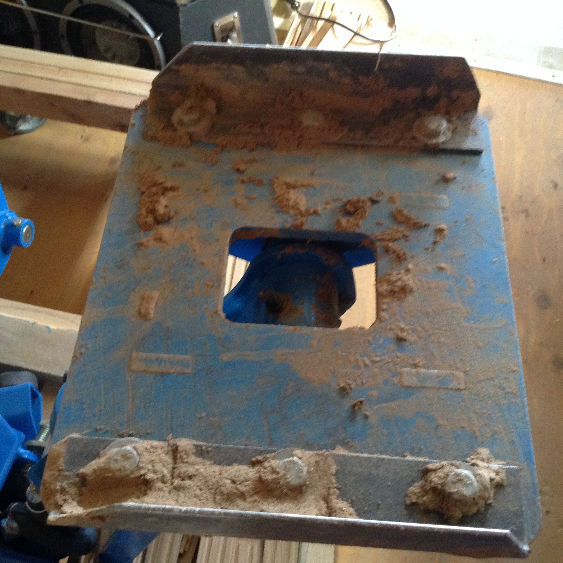

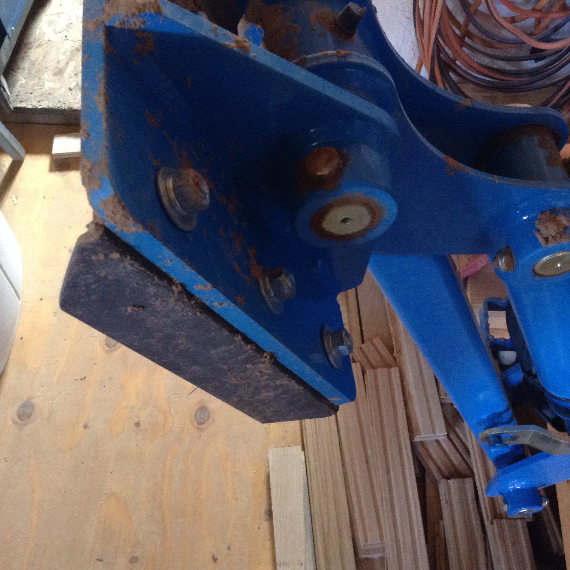

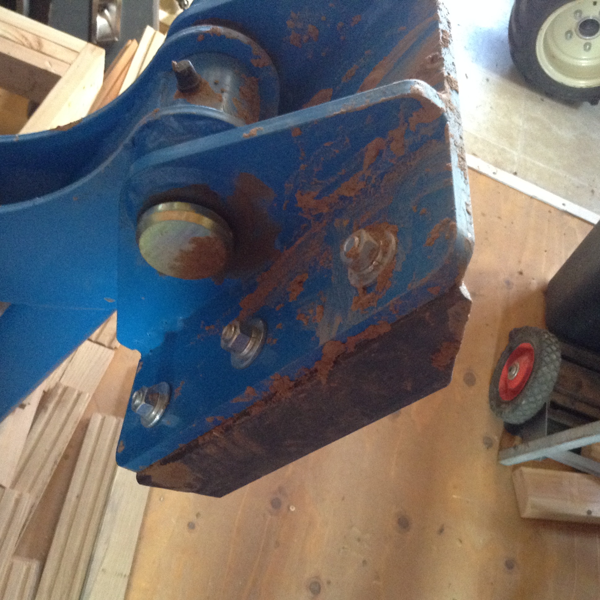

I just remembered to take pics of the stabilizer "feet" that I put on the BH. The holes were there on the BH stabilizers, just had to drill the angle iron. Took all of about 30 min to do. Made a BIG improvement.
That is a great idea. The angle iron must act like cleats. I need to learn how to weld but nice that you didn't have to drill the stabilizer feet.

#27
You don't have to weld for these. You can get a 3-4' stick of angle iron at pretty much any hardware store. Just cut it to length, drill matching holes to the stabilizer feet and bolt on.

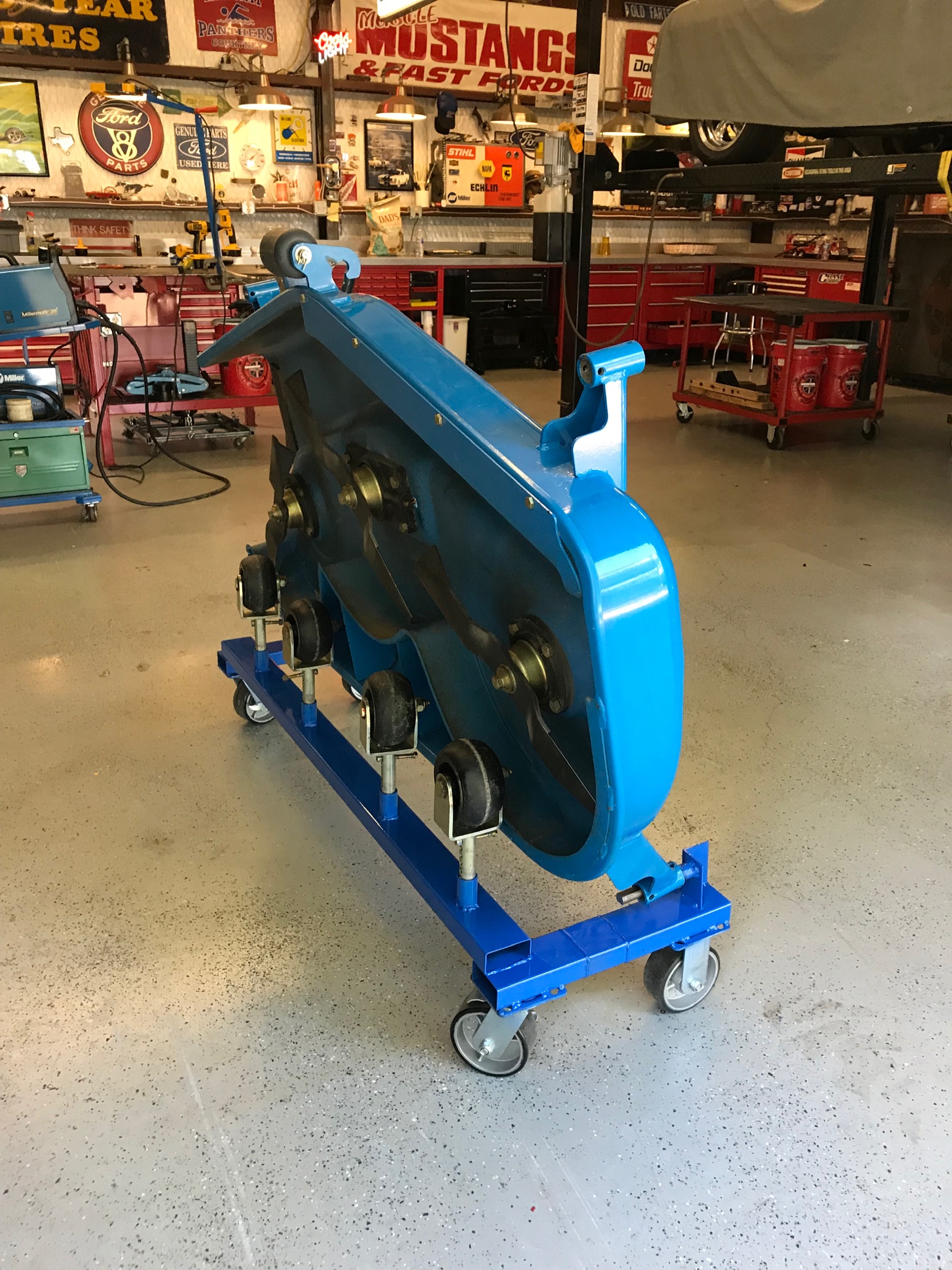

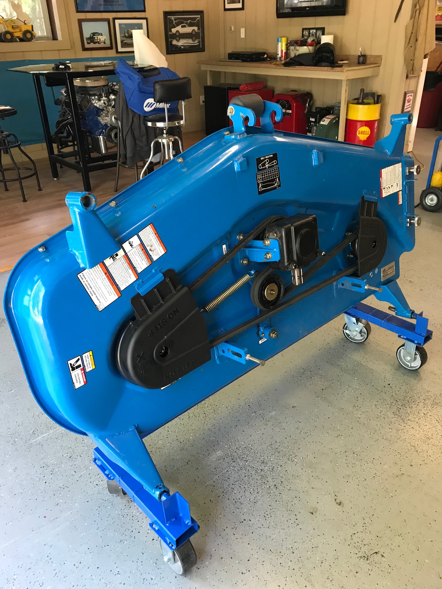

I致e been making a few 奏hings for my 125 and will be adding, such as this storage dolly for the MMM.
