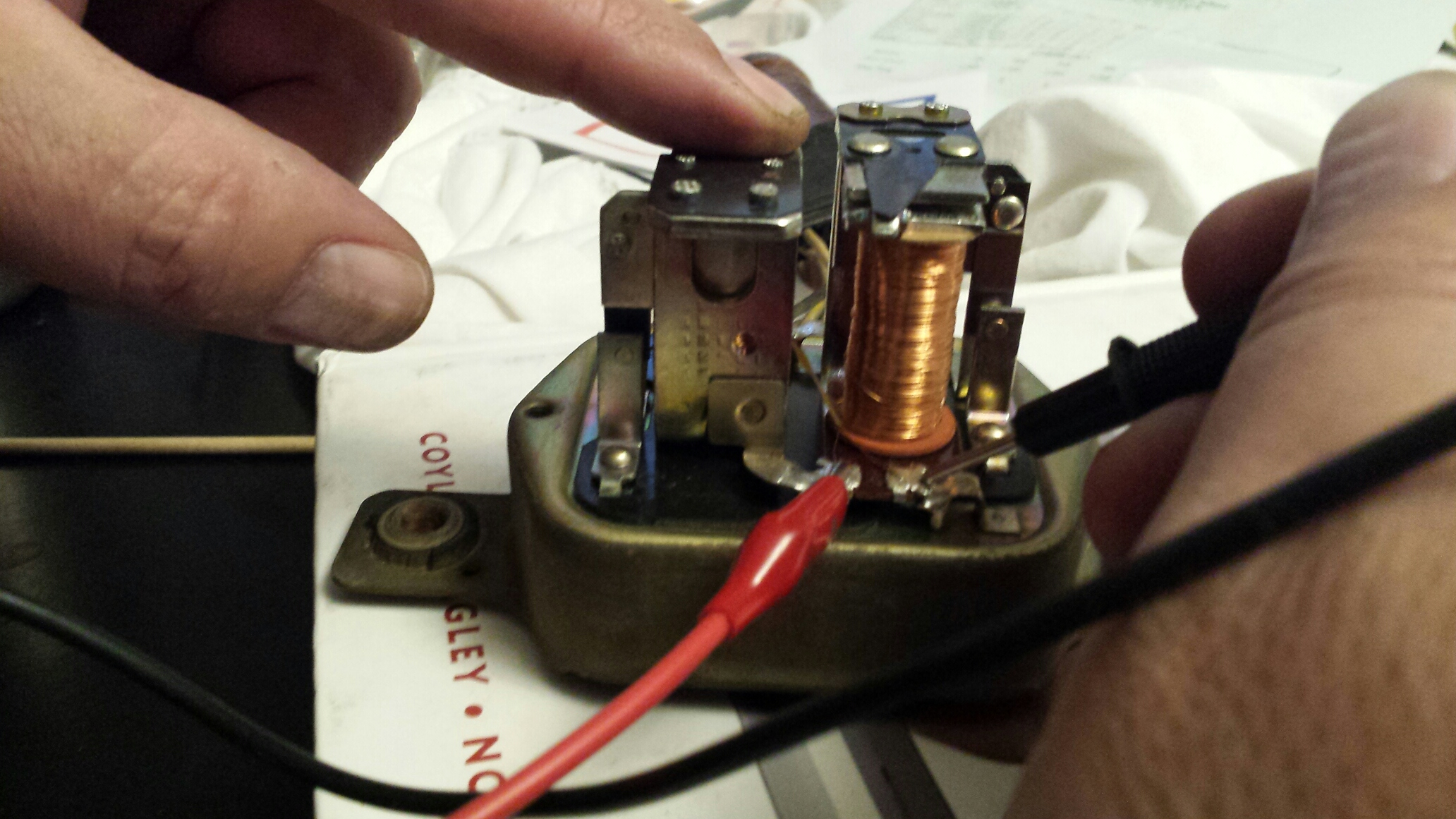

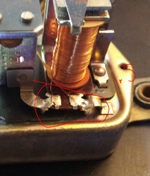

Which one has the .5 ohms? The field or lamp coil?
/ MT 372 dummy lights
#22
I am not sure so here is a picture and readings i get and from where I took them. marked up vr 1.PNGmarked up vr 2.PNG
/ MT 372 dummy lights #23
Something doesn't appear right on the wiring diagram in the manual page I uploaded now that you got me looking at it. The lamp relay should have a resistance around 22 ohms. The field relay will show near zero ohms until you open the lamp relay manually since it is normally going through to ground and this is where one side of the field coil attaches. Once the lamp relay switches the field relay will read 90-100 ohms, at least on the two I tested. Check that and see what you get. If I get a chance I'll draw up a new schematic based on the regulators I have. There is a resistor on the back side of the regulator that is around 10 ohms. I'm not sure where I got the 35 ohms in the diagram but I bet it was likely to represent the field coil value at the time I wrote it but that doesn't match what I'm getting now. Again, I only visit this when I have problems and I have no idea if there are multiple versions of the regulators used floating around.

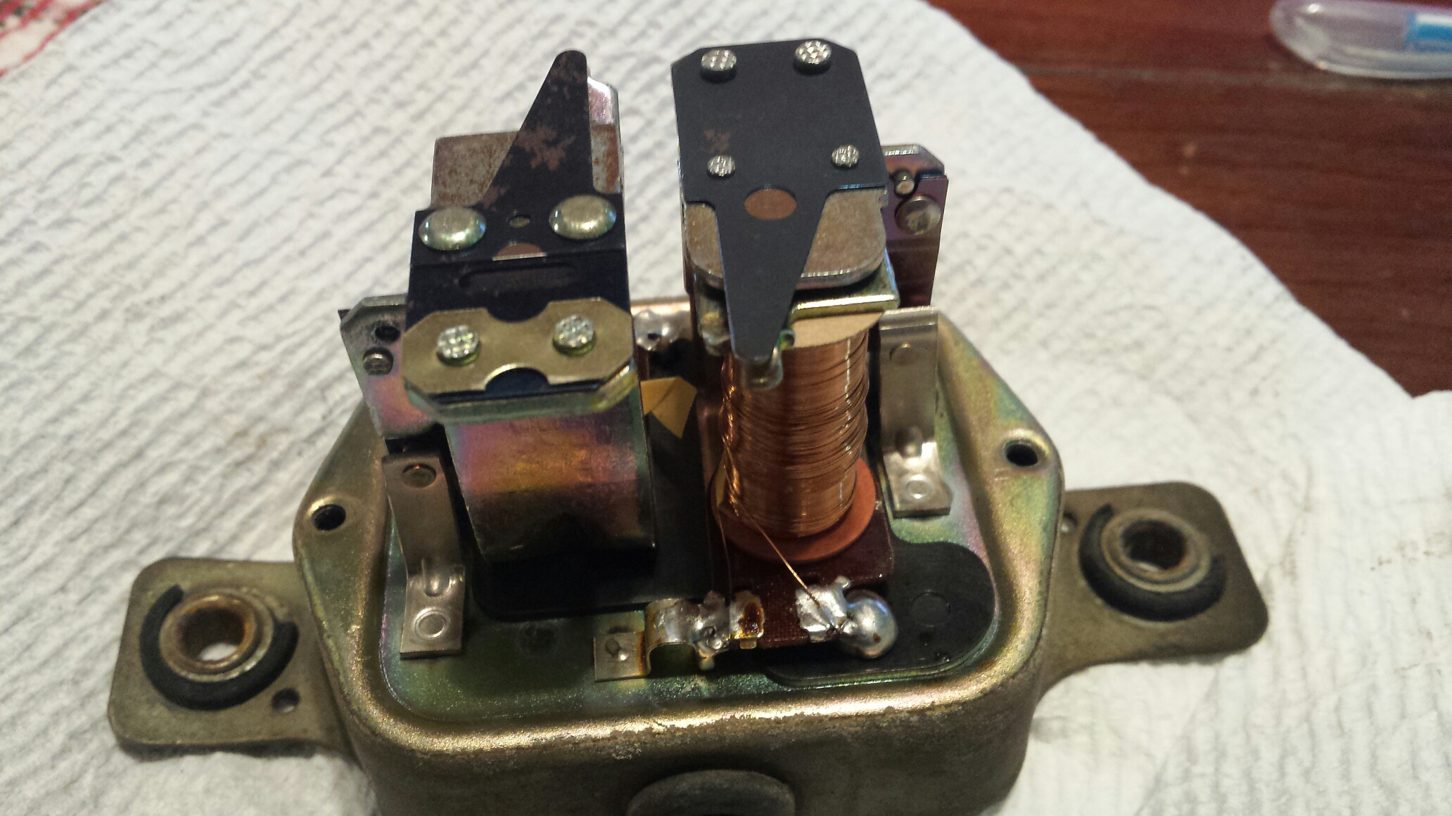

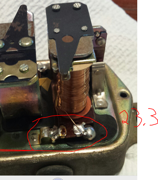

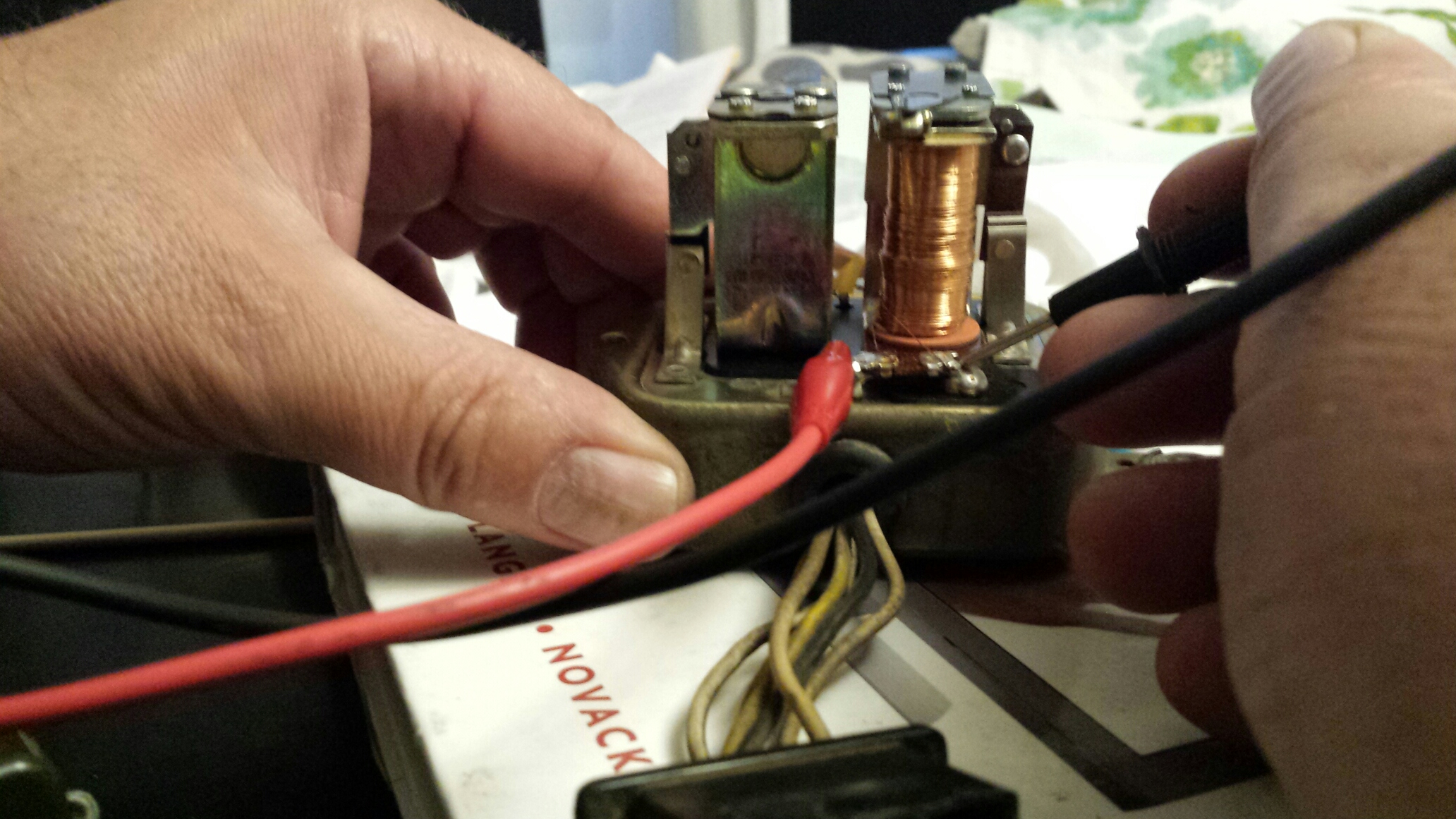

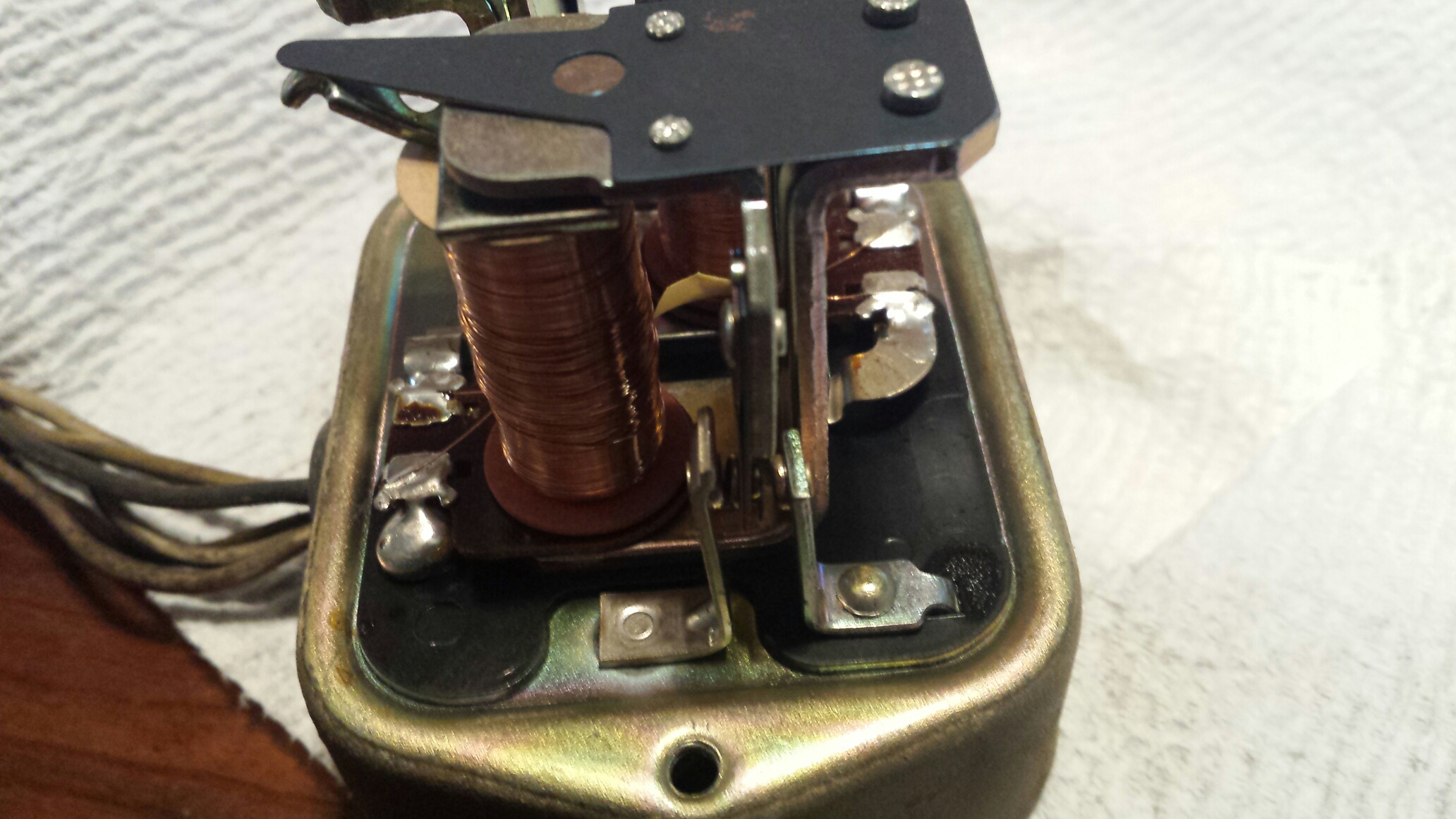

Well I am not sure if I am testing the right things but I am getting those readings on mine too. .5 and then make the contact and around 100. I checked the resistor and it was around 10. the other coil is 23. Crazy man. I chased the wires to define the field coil and looks like I have it but I am just a hack so not really sure. I took some pics of what and how I am testing to be sure I am on the right path.
field coil test is 100 with contact closed by finger
light coil test is 23 and no difference with either contactor manipulation
Once again, thanks a million for helping me out.
/ MT 372 dummy lights #26
Isn't this fun??? You're doing it right. Wait until you get to testing the solid state ones ;) It will make the mechanicals look like child's play. The light solenoid coil is not affected by the position of the solenoids so it will stay at 23 ohms. It's starting to look like your regulator is ok. If your voltage goes to 18V that probably means your field solenoid coil is not getting energized for whatever reason but the problem is outside of the regulator. The fact your charge light comes on when the switch is off is very strange. It could be the switch or a short somewhere. Is the charge light on when the key is on? Both when the engine is running and not? You're welcome for the help, but I haven't really helped you yet as you still have a broken tractor :( Actually you've helped me (and others) by uncovering a problem in the schematic. All this time spent now will potentially save me, you, or someone else a lot of frustration in the future.

I don't think that is possible as I only had one wire out of the connector. Pulled the female spade out, attached the new one to the wire and shoved it back in. That goes for both. I looked at the wires connectors and the alternator. The A is definitely connected straight to the battery as it has 12+v just sitting there. Now according to the diagram it should be a white/red wire and it is. I will admit that this is the wire I fixed. I did trace it and it does go into a yellow wire as it should but when I check resistance in it that wire it goes into both coils. And holy crap it sounds when touching the body of the regulator. Not supposed to do that is it?
/ MT 372 dummy lights #33
Ok so the wires shouldn't be crossed at the plug but we're getting somewhere. I'm thinking no on your question. Unplug your regulator and check for continuity on the A terminal to ground (use the regulator body for ground in this instance) in the regulator plug. It should be open/no alarm. If that checks ok, then I would take the + terminal off your battery and check the tractor side plug of the regulator A line to ground for continuity. Use the "-" terminal of the battery in this case for ground. It should be open also. If it's not, unplug your alternator plug and test it again. As a last check while your alternator and regulator plugs are disconnected, check the continuity between the A and N lines at either the alternator or regulator plugs on the tractor side. They should be open also. We've got to be getting close!

Ok according to my diagram the IG (black) goes to body with .5 ohm and the A (yellow) wire goes to body with 23 ohms. I did this from connector to the regulator body. These are with the regulator off of the tractor and only testing the regulator wiring.
/ MT 372 dummy lights #35
"A" should not show 23 ohms to the ground/body. It is going through the light solenoid and the light solenoid should only be supplied by the N wire. What reading do you get checking continuity between A and N on the regulator plug on the regulator?

I show open between the A and N. But if I close the coil it show 100+ ohms.
/ MT 372 dummy lights #37
What is the value of N to ground?
#38
I am checking the white wire which in my diagram is N and it shows no continuity, but if I close the coil again it is 100+.
/ MT 372 dummy lights #39
A and N are swapped at the regulator apparently. I don't know how or why but that seems to be the problem. So a new regulator will fix your problem but swapping those should make your old one functional. How long have you owned the tractor? What were the symptoms that caused you to replace the connectors? When was the last time it was working correctly?
