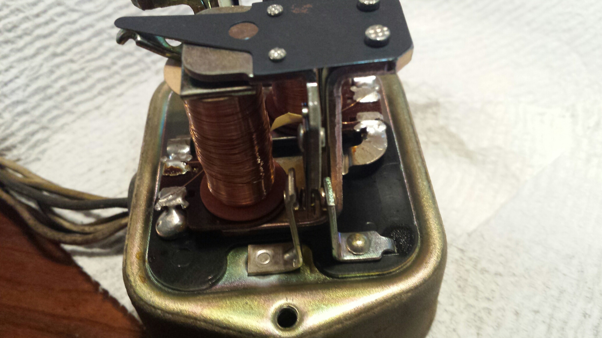

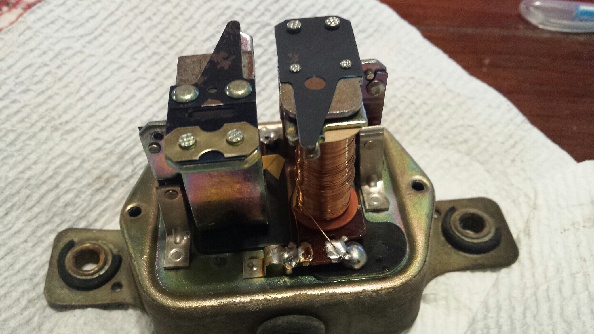

I just pulled the regulator and it is clean as a pin inside. Contacts don't look burnt at all comparing them to burnt points I have replaced before. But I can't really open them far to really see. What do you think?

/ MT 372 dummy lights #11
View attachment 509785View attachment 509786
Regulators usually stay pretty clean inside if the cover gasket is intact. Just another good reason to repair them. Clean and properly functioning aren't always related though of course. An open coil is probably as likely to occur in either case. I still have a functional regulator that lost it's cover years ago. Looks much dirtier than yours. I'm actually surprised it still works.

/ MT 372 dummy lights #13
I cannot tell for sure from the photos but the one open coil with fine wires almost looks like it has been overheated in the middle. If you see any signs the varnish coating on the wire has overheated and bubbled or disentegrated you could have a shorted turn in the coil and it is all she wrote for that solenoid coil.
