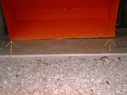

It is possible that the loader frame was fitted to your tractor on uneven ground and has a twist in it. It can be straightened by loosing the frame bolts on level ground and adjusting. Get your dealer to do it and also get him to show you how to R&R the loader since you are having diffuculty with the operators manual. In order to pull the loader pins you have to lift the front of the tractor with the loader--going on and off. It is not possible for the loader to be "wedged" if the loader pins are installed and I assume they are. Hey, look, this is very easy to do--my wife does it---my neighbor who is an electrical engineer and has sissy soft hands can do it. I bet that pig of yours can do it---and so can you--if you read the instruction manual. /forums/images/graemlins/tongue.gif J

Read your note regarding you problems with the FEL. When I put my FEL down when parking the 2200 I have, one side hits before the other. However, my unit is easy to remove and install. I have the pleasure (?) of having to pull two pins on the right side as I have a cab and cannot use the one pin method advised by the manual. You might want to check whether your FEL is level when it is raised. Check side to side and front to back. A long construction level will help.
However, any hydraulic system with more than one cylinder is going to act a bit crazy as each cylinder will be a bit different. Hence one side hitting the ground before the other.

Thanks for the good thoughts!! /forums/images/graemlins/smile.gif I played around with this tonight and here are a few pics of what I'm dealing with.

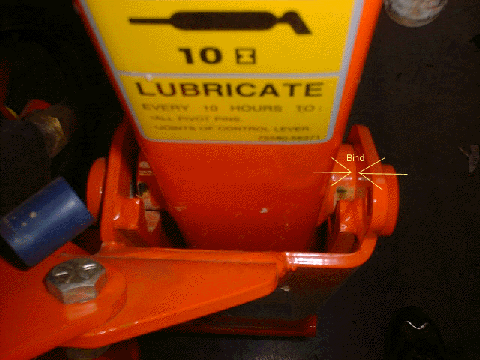

Here is yet another pic of the BIND that I've encountered. Now after I took these I jumped up and down on the opposite arm of the loader and the thing popped out. I was able to re-attach with a little persuasion. I can live with it if it's not going to cause any problems.
   / mowing WITHOUT the loader and weights! A O K!!!!! #20
Once you have the pins out (and tractor idling) tap the joystick like you are raising the boom. Leave the tractor in neutral and it should roll back and kick the upper attachment points loose. Then rotate the bucket in a little and the bottom pins will disengage.
