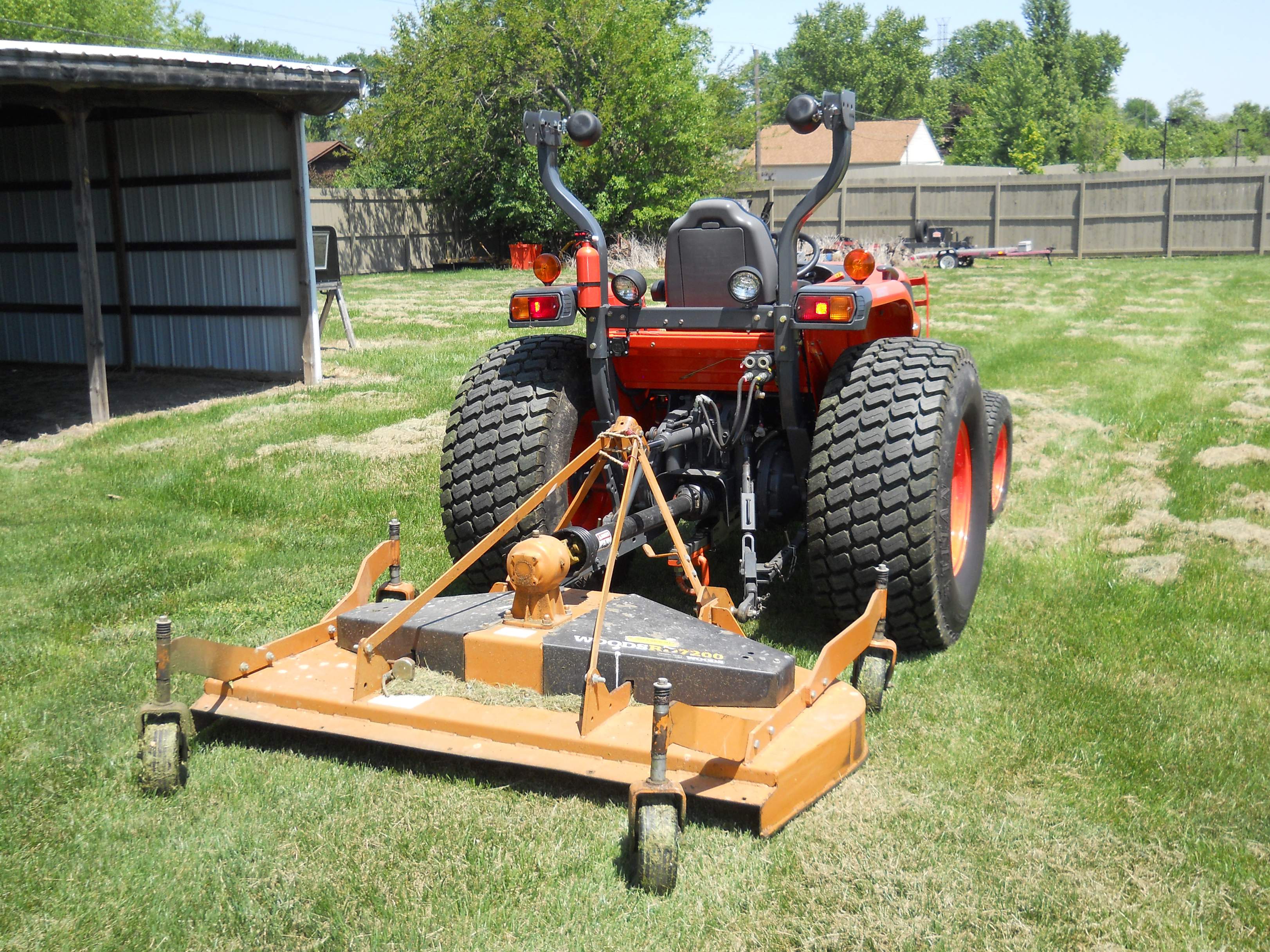

1) If HST+, it works great. Cruise control and hst reversing is nice feature.
2) From what I have heard, pretty bad. I use R3's.
3) RFM. I don't think any brand will be faster or more manuverable. I suggest a reat discharge to spread clippings. I like Woods or Landpide for a well built mower.
Good Luck.
Philip

You'll get lots of opinions. Here are mine after having 4 different tractors for finish mowing over the past 24 years. Acres of mowing varied from year to year - from a bit over 2 acres to around 7. Used different tires (turf, R1 & R4), tractors (one 2WD gear trans, three different 4WD hydro) and both side and rear discharge finish decks. Things have settled down so the only mowing for others I'll be doing is a half acre for a nearby widow lady. We have 2-1/4 acres in grass right now and will be planting another 1-1/3 acres this year. We have trees and a couple sheds, a creek and a few other things to mow around. The lower part of the yard near the creek gets flooded with some regularity. Just last Summer we bought an L3200 and 6' RFM. Couldn't be happier
1. I like the size and comfort of the larger tractor. It isn't too big to control, and handles the 6' mower easily. For loader work, I either leave the RFM on or swap it for another attachment. With the RFM for ballast I can pick up the back of my Jeep Wrangler.
2. The L3200 is easier on the soft ground than my B7500 was. Both have filled rears and I always remove the FEL & frame for mowing.
3. I prefer the RFM. We have a weedeater and a 6' RFM. The only two tools we need for mowing. I do 2 acres an hour.
