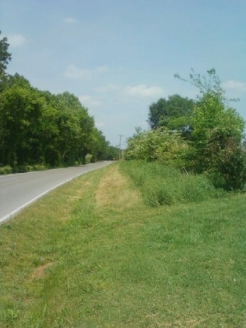

blount2000 said:
Thanks for the response. Below is a pic of the ditch. The county cuts the left side of the ditch (by the road), and you can see where I made one pass on the right side of the ditch. You can also see where I need to make another pass or two up to the fence line.
Maybe it just feels steeper than it really is.
Picture is not like 'being there' but that slope does not look bad. You can always back up the slope. 8N are pretty stable. Go slow, follow your gut. If you feel like you are sliding in the seat that's a great indication that you are getting too much slope. I would walk that area to be sure there are no washed out spots or 'humps' that can quickly change things for you. I would mow by hand the first so you can see what's under there.

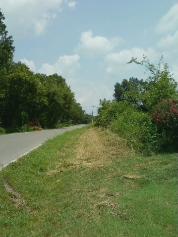

Well, I succeeded in mowing up a little bit higher on the ditch. The county has not cut in a while, and the tall grass was blocking my view whenever turning out of the driveway so I went ahead and cut what I could. As described in my original post, it was still a bit spooky mowing on the incline.
I wasn't able to cut the entire length of the fence line, but at least I can see now when pulling out of the driveway. I still need to try to get a bit closer to the actual fence, but that will be a challenge for another day.

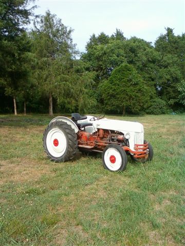

The first picture is from back in May when I was originally asking about mowing the ditch, the second picture is from when I cut the ditch this weekend (you can see the cut is a little closer to the fence), and the third picture is of the ol' girl who is doing the work!
It may not be the prettiest tractor, but it still works mighty fine!

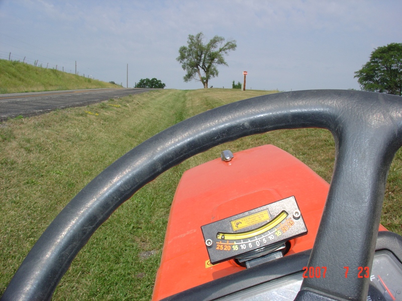

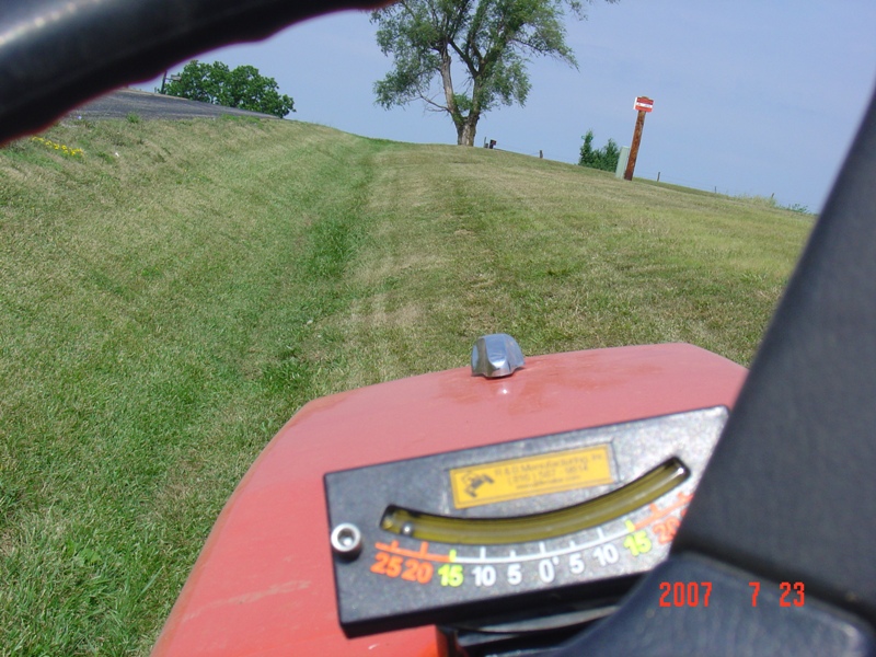

As said before pictures don't do slopes justice. Here's some shots of my old Kubota B2910 on a slope that I mow regularly. I took these shots in response to those who had told me you can't run on 15 degree slopes. :)
Great pictures.:thumbsup:
