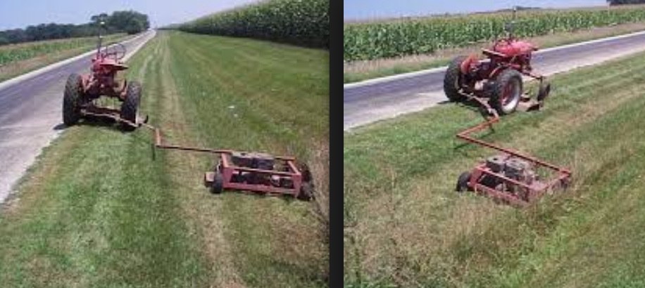

Self-powered mower and a side boom to tow it. (found photos-not me)
Maybe use an old riding mower with a bad transmission as the towed mower.

I have considered a mower much like the one pictured, but don't think the water would take to it very well, but if I built a bracket across the loader so that I could hold it slightly above the water level, it might work.
I remember seeing an ad with a hydraulic powered mower bolted to a FEL, that might work, if I can't get my batwing to do the job.

I've considered something similar myself. I used to know a fellow that had one he built from the deck and engine of a derelict riding mower. The frame was built from some square tube and a carry-all frame he had laying around. It seemed to work well enough.
