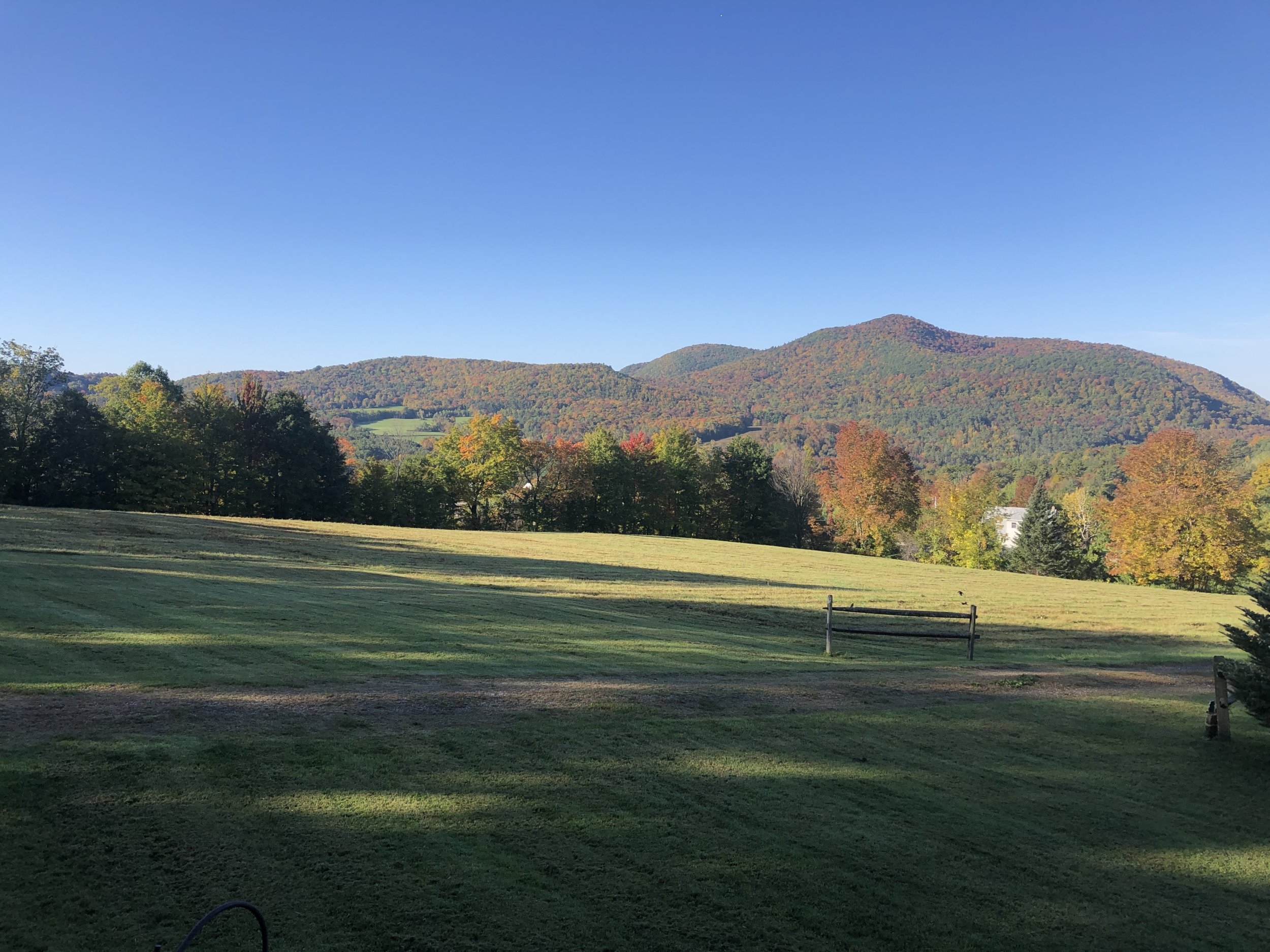

I have this scary field.
It drops 200 feet to the road. Ford 9600 no way, 5600 have to for baling, be very careful, 2810 is almost comfortable, but there are bumps and depressions that are still scary. The taller the tractor the sooner the COG is over the downhill tire, I find!

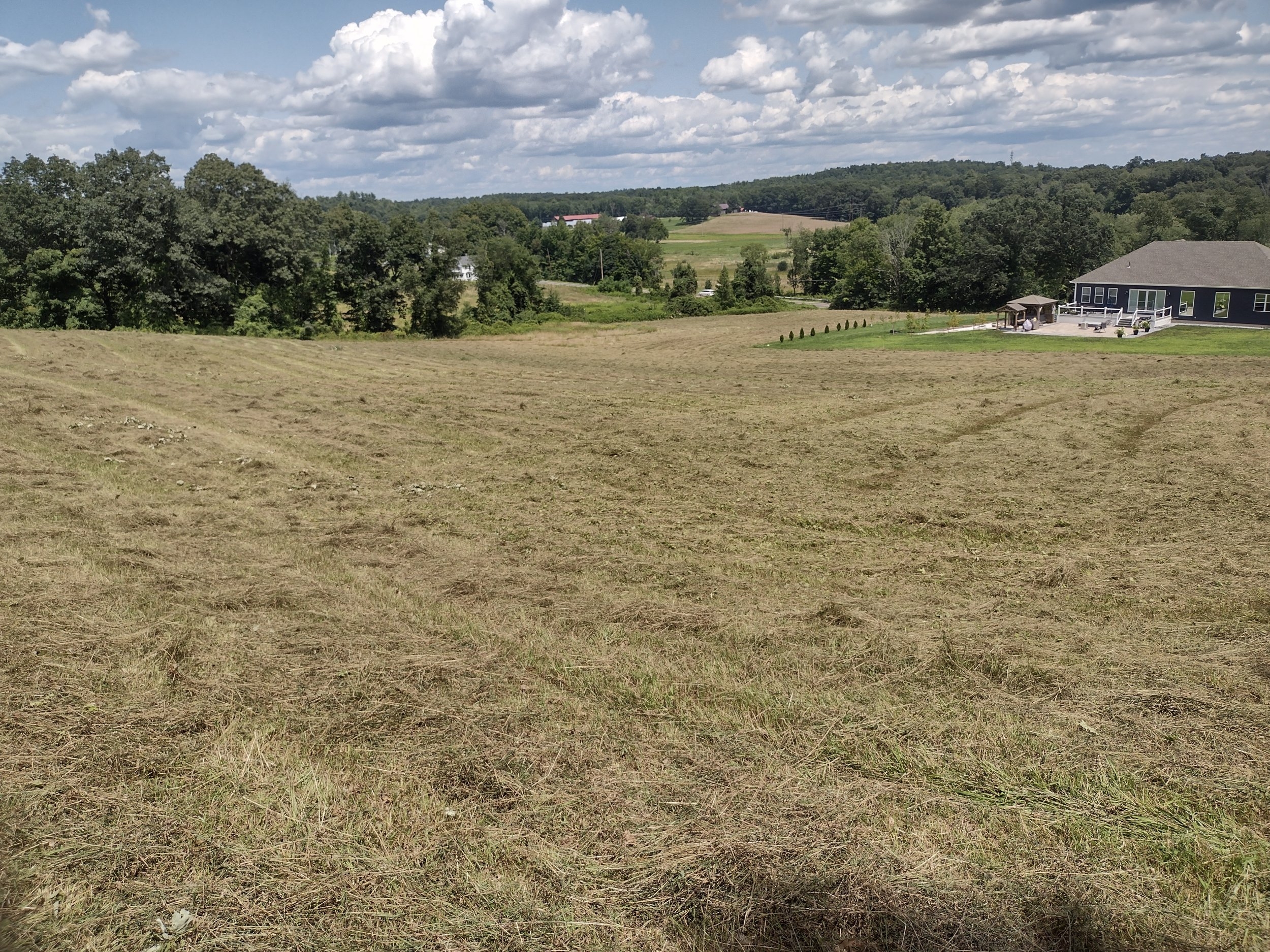

Some steep property I mowed today….

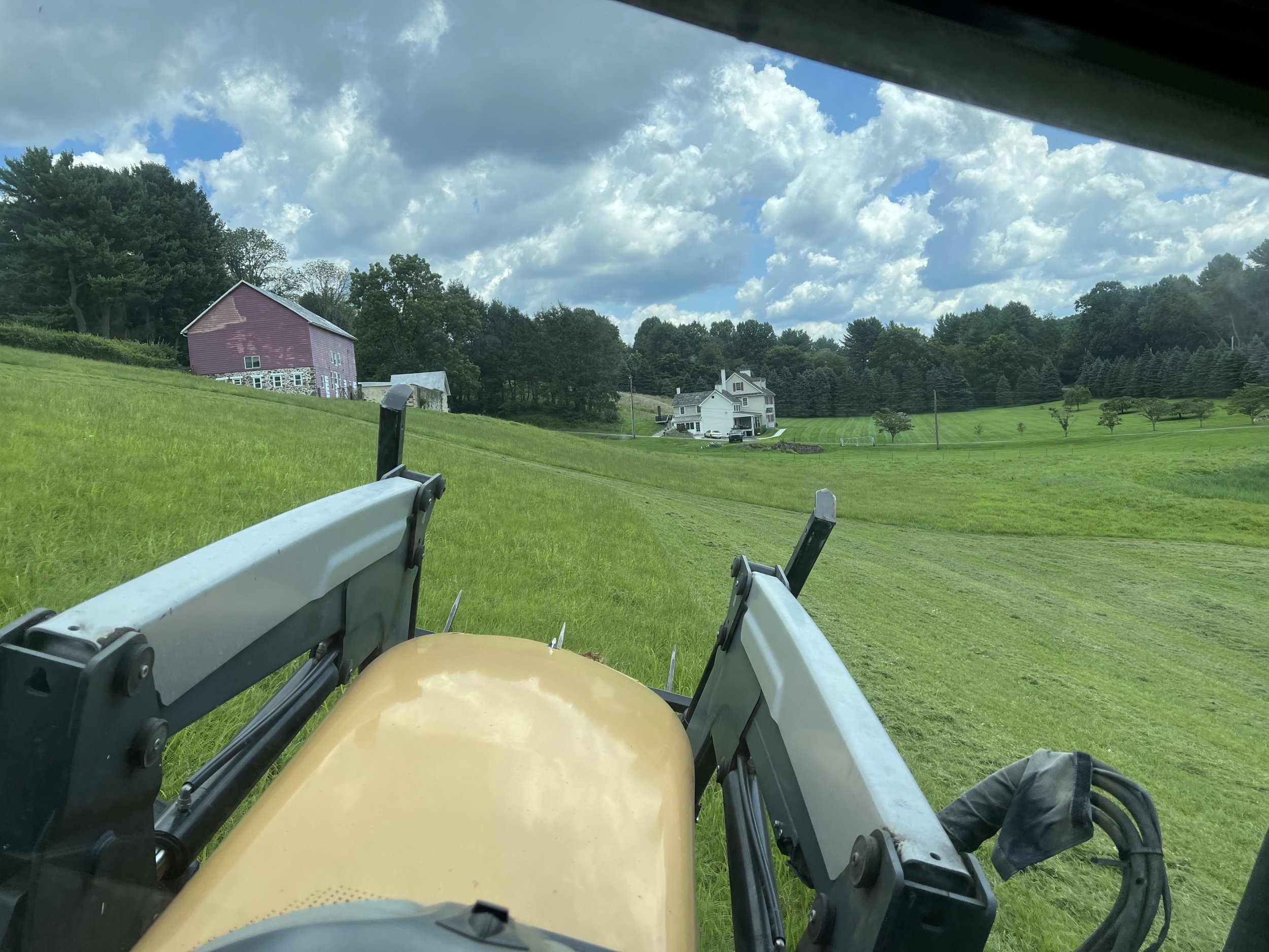

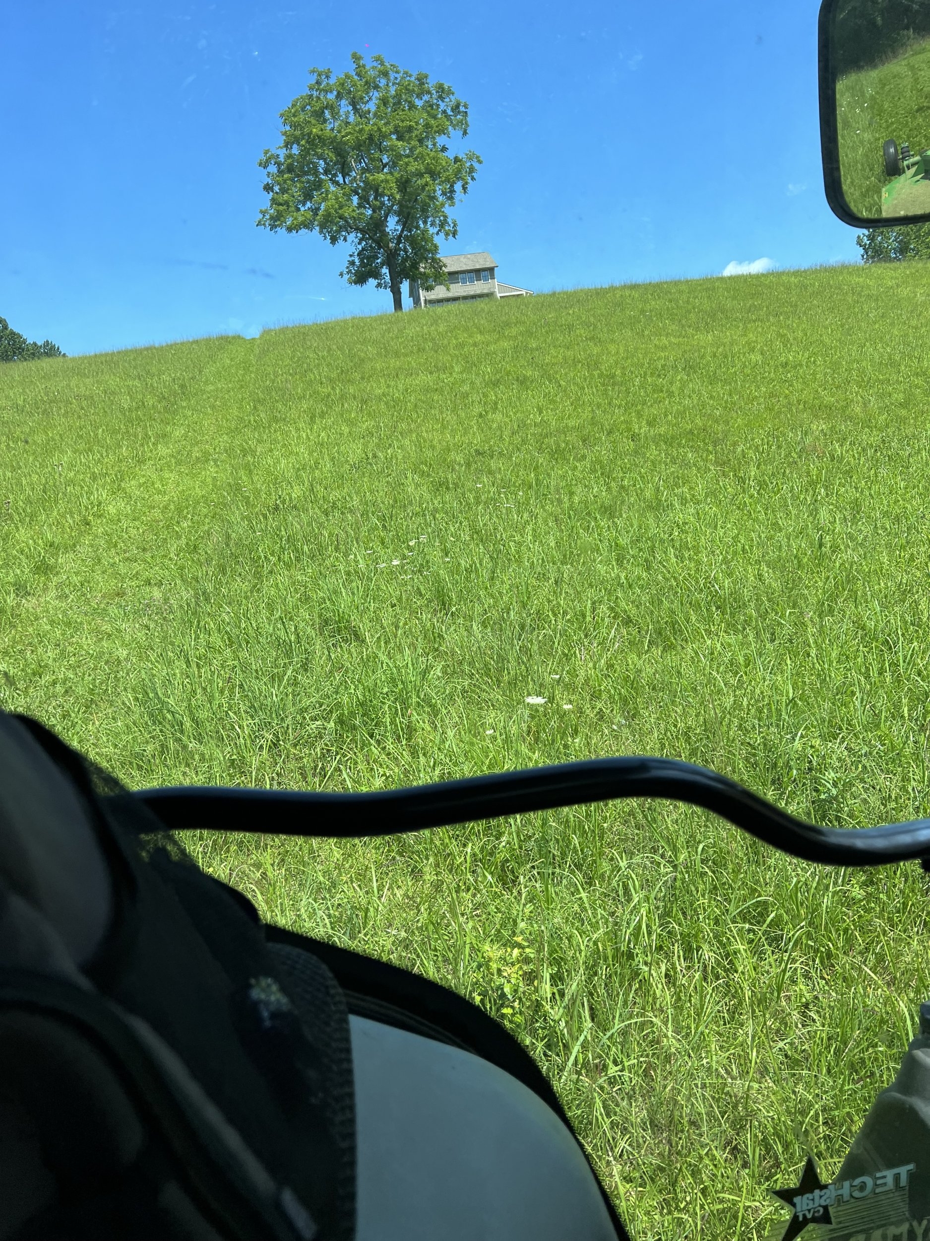

Good Morning Guys,
Some excellent posts on here already! There are so many variables that go into this equation, it’s almost impossible to give someone a specific answer ! What I have determined though years of mowing on steeper slopes, I will try and mention here !
My property is steep, especially the lower part. I know others on here have stated they go cross slope, I do not, although I could on the higher elevation portion of my property ! For me it seems easier and faster to go up and down the slope !
I also keep my 6 ft FEL lower to the ground especially while making the turn at the bottom of the property! Also be aware of woodchuck holes if you have that critter on your property! They normally don’t last too long around here because of that, 22/250 😁 !
I also bought an angle gage for my Massey, this is just a reminder for me, because I can usually feel the pucker factor before I see red or yellow on the gage !
I also have my rear wheels spaced out wider for more stability!
I’m sure there are others on here that have much more experience than me, but these are some things that have worked for me !
Not sure go slow or no go ! 🙏

I have this scary field.View attachment 813737
That’s a cute hill compared to the ones @Hay Dude and I are mowing. Not trying to brag or pick on you in the least, just making the comment that it would be nicer to mow those kinds of hills than some of the madness I have to deal with. The ones in your photo are definitely sketchy when the grass is tall or if a guy didn’t know where the draws/depressions/saddles were located and started cutting across that them and caught a tire in the wrong rut. Serious pucker factor for you I can imagine.

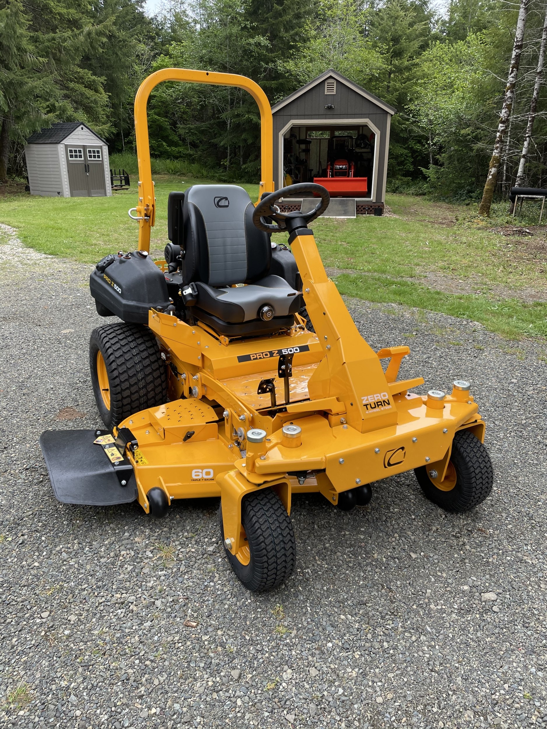

As an alternative to the more expensive commercial mowers on the market, I highly recommend the Cub Cadet Pro Z with 4 wheel steering.
I can safely and confidently mow 20-30 degrees hills and do so on a regular basis on my property.
