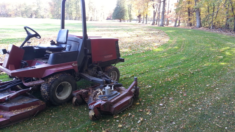

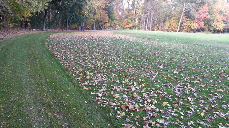

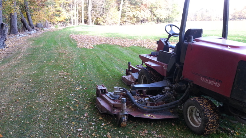

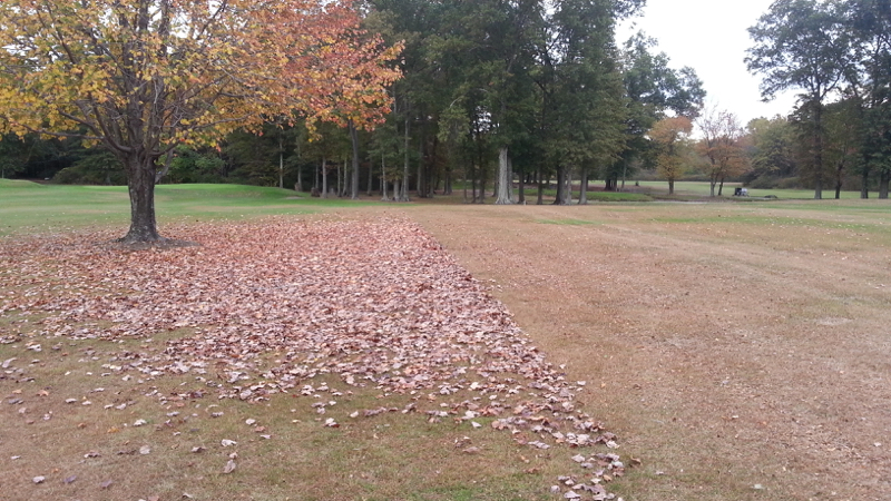

Here is a spot on our course that I mulch the leaves on,I do this year because it's very far from a Woodline to blow them and wouldn't make any sense. This is two passes with the Toro 4000 I used to use this steiner with two mower decks and it works great also.this area is rough it's not irrigated and it's just It 2.5 inches all your long no fertilizer no pesticides,just the rough area between holes.With the 11ft cut it literally takes 3 minutes to double cut this entire area where the leaves fell,for,our customers this is absolutely fine,again they shouldn't be hitting here so no need to have it perfect...
Here's another area that's a little more maintained but still rough,again 2 passes with a basic mulching mower and the leaves are gone,the toro has hydraulic driven decks,which do not have quite the same blade tip speed as the traditional below driven decks,the ventrac decks blade tip speed is definitely a little higher,but. This still does well,my baffles are beat up a little but all intact,machine has 6900 hrs on it, on the left is a single pass,where the machine is is a pass and backing up,which really disperses the leaves.
