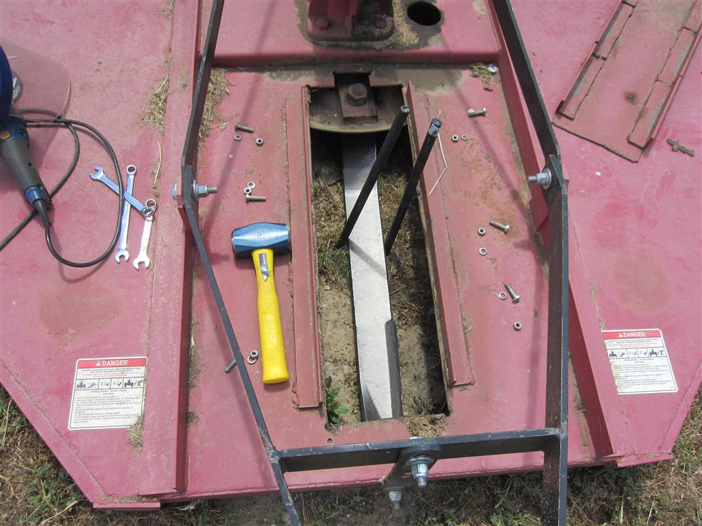

On my 10 acre ranch I ran a 6-ft hog with my Mahindra 5525 (55 hp engine, 45 hp pto). To make blade sharpening easy and safe, I cut an access door in the top deck so I can quickly sharpen the blades with a 4-1/2 inch angle grinder. Eliminates the hassle of lying on my back under the mower with a grinder a few inches from my face.
