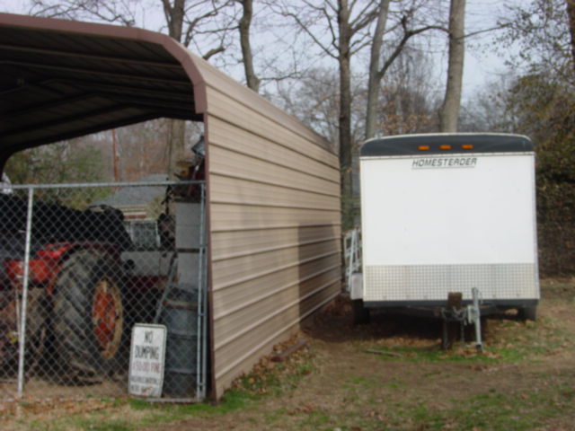

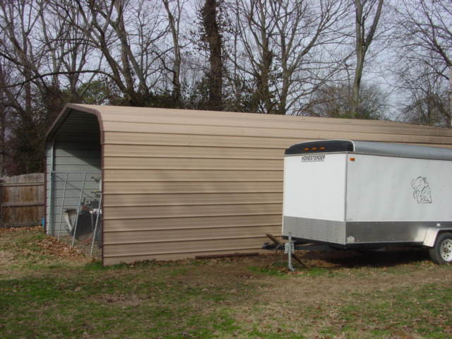

To address this same propblem, I took my FEL on my tractor, put a pallet on the forks, drove under the center of the carport. lifted the loader under one of the roof rafters until the shed was just off the ground and drove it to where i wanted it to stay. Lowered the bucket, drove out from under it, did a little leveling and drove in the anchors. Whole project probably took me 30 min.
