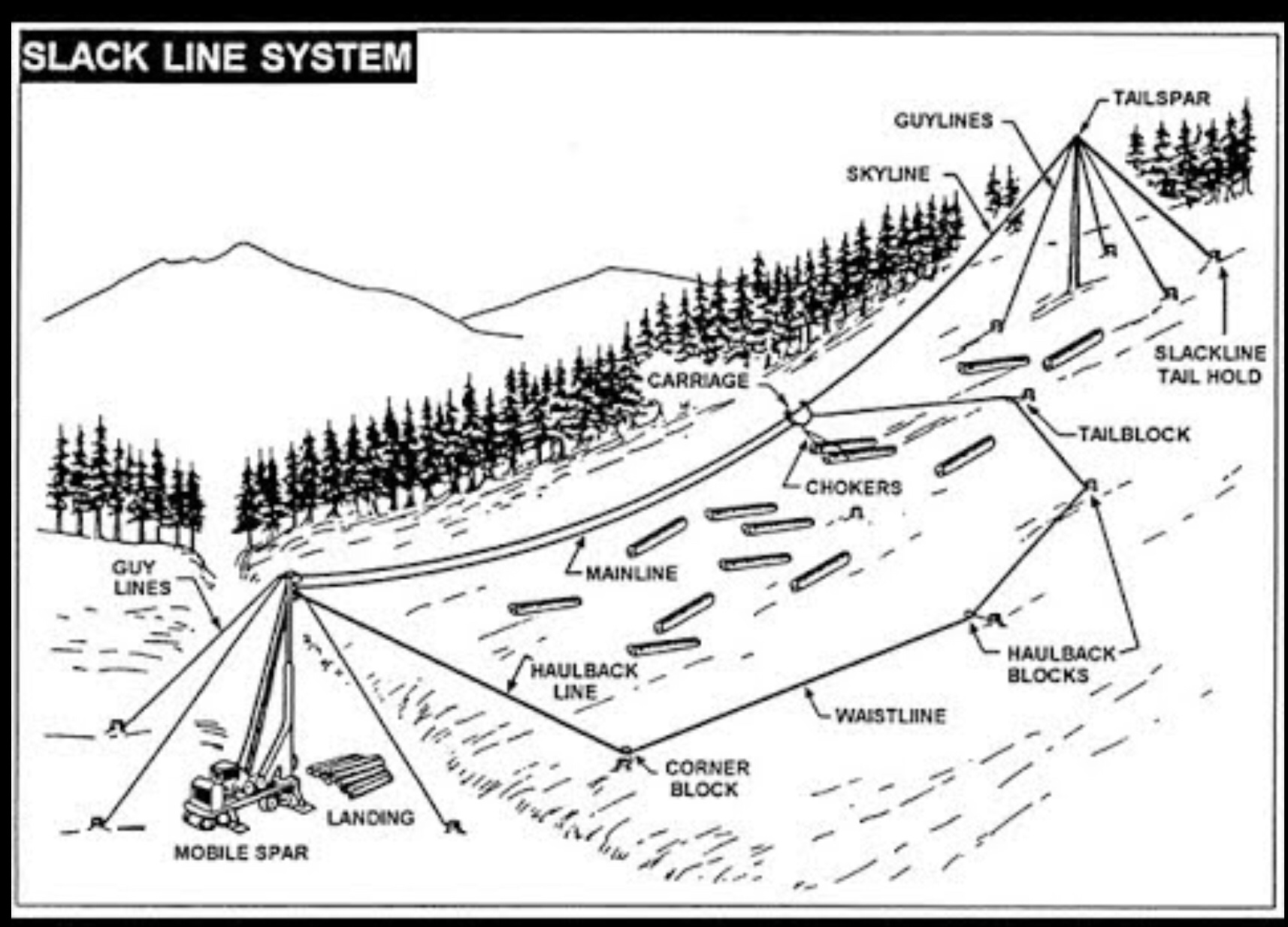

Outside the box:
Maybe a dolly under one end of 12 footer and lift other with 3 point hitch. Fewer trips with log off ground.
Or a skyline, cable yard, slack line (whatever they call it). Too bad the they didn’t leave you some long logs for your tailspar.

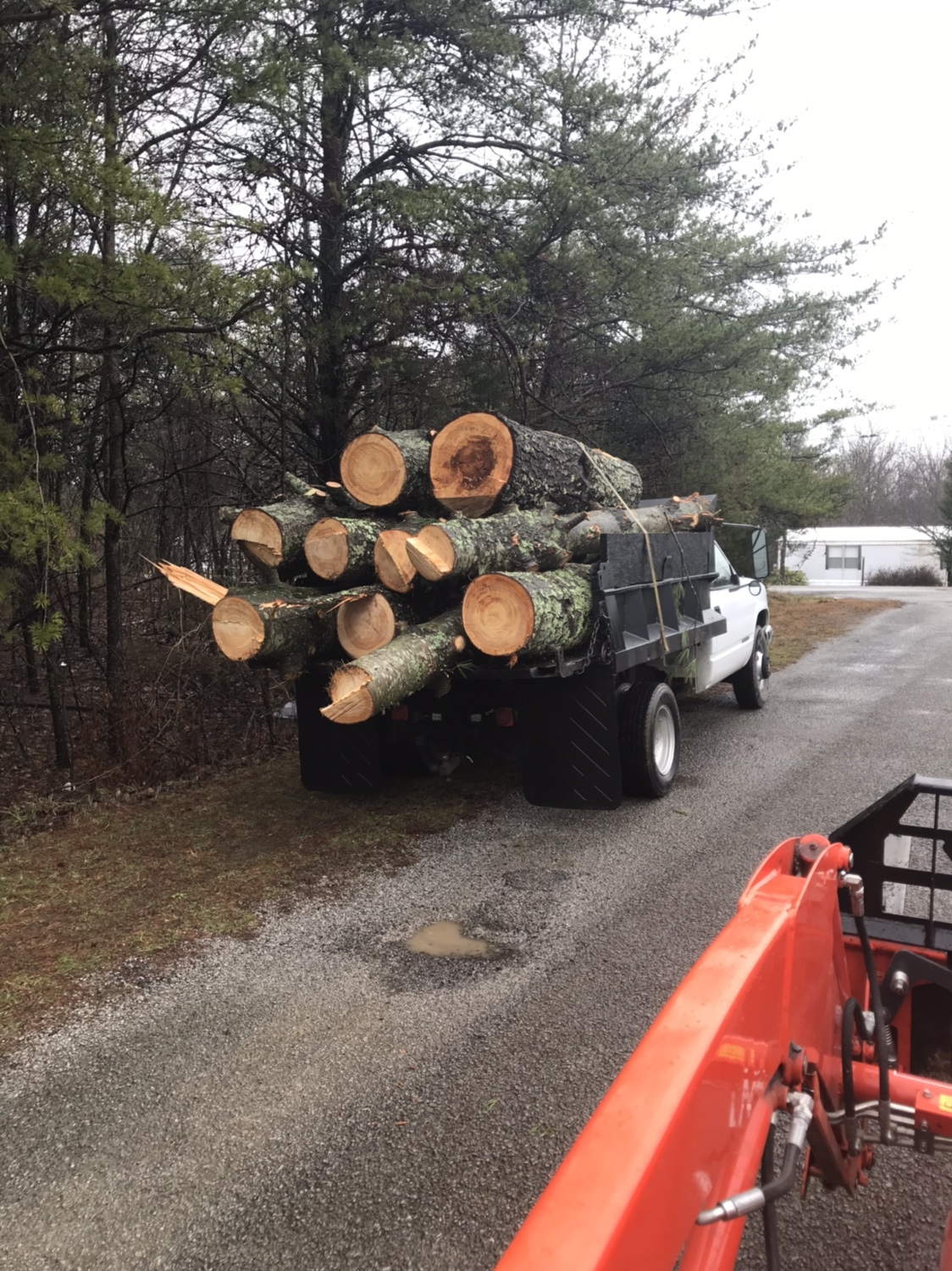

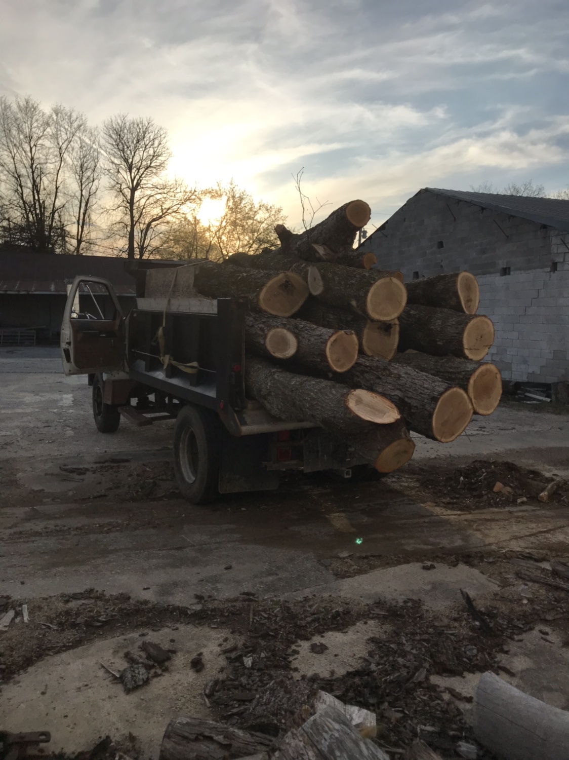

/ Moving logs #8
Ditch the trailer and the unloading part. View attachment 683232View attachment 683233
Yea! A $60K dually makes so much sense to bring $400 worth of fuel wood in over 200 feet! Go for it! You have always wanted a real truck.
I just made a purchase of 7-8 cord mixed hardwood logs (20ft) stacked in my yard .. $800. The logging operation is only a mile down the road...
/ Moving logs #9
Well if you feel the need to spend 60k for a truck that’s your own problem. I didn’t pay the first digit of that for either one of those trucks. Sure they’re not pretty or nice but they’re hauling the wood just the same.
