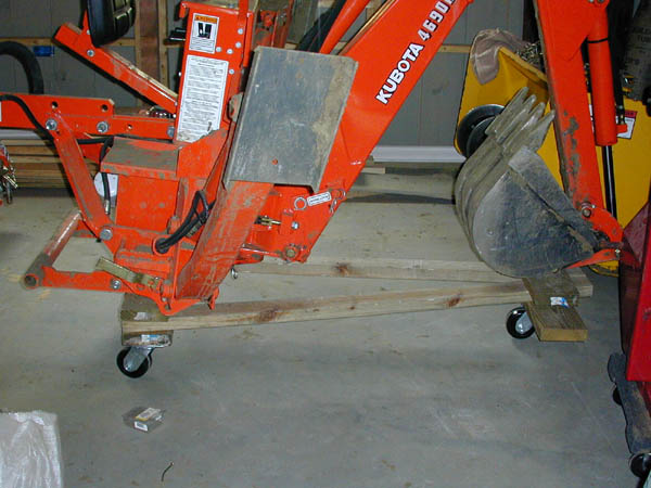

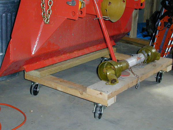

Re: warning warning - cheap casters
The dollies claim to be rated for 800lbs, which is almost double the weight of most of my implements. I guess that's their collapse weight. "Oh, you want to roll it... well that's another story..."
From what I've seen, most all casters have roller balls between the mounting plate and caster wheel frame, but the post they swivel on can bind under load. The good ones I got for the BH actually have the wheel frame sandwiched between two sets of roller balls so regardless of the pressure angle, they still swivel easily. Now that I have the problem I'm noticing these details.
Rob, be careful with buying hard rubber tired casters. Some are good, but I've found that some are not, even though they look good. What happened was that they looked great, but after sitting for a few days without being moved, the bottom of the tire flattened out from the weight and it's hard to roll one with a flat spot on it.

/ Moving and storing implements #24
As per my earlier posting, I'd like to recommend all-steel casters. I purchased my 2 1/2 inch casters from Tractor Supply for less than $5.00 each and they are rated for 175 pounds each--more than adequate for my chipper, front-end of the shredder, box blade, etc. I have large metal cabinets loaded with tools, bolts, plumbing stuff, etc. and I have these mounted on 4 inch steel casters which I purchased from Northern Hydraulics (now Northern Tool & Equipment) many years ago. The cheapest 4-inch steel caster in Northern's present catalog is rated at 500 pounds; the "heavy-duty" 4-inch caster is rated at 1000 pounds. These steel casters have really worked great, but of course they are only useful on a smooth concrete floor.
