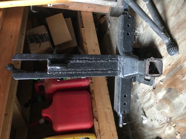

I built one of these, it's nice to be able to lift tongues up an down.
We have one of those as well. The nice thing about a three-point trailer mover like that is that it pushes the pivot for the tongue of the trailer back a couple of feet from where it would be if you attached to the back of the tractor.
That means that it moves more for a given movement of the front wheels and it lets you turn sharper, perhaps even to 90° with a boat trailer.
