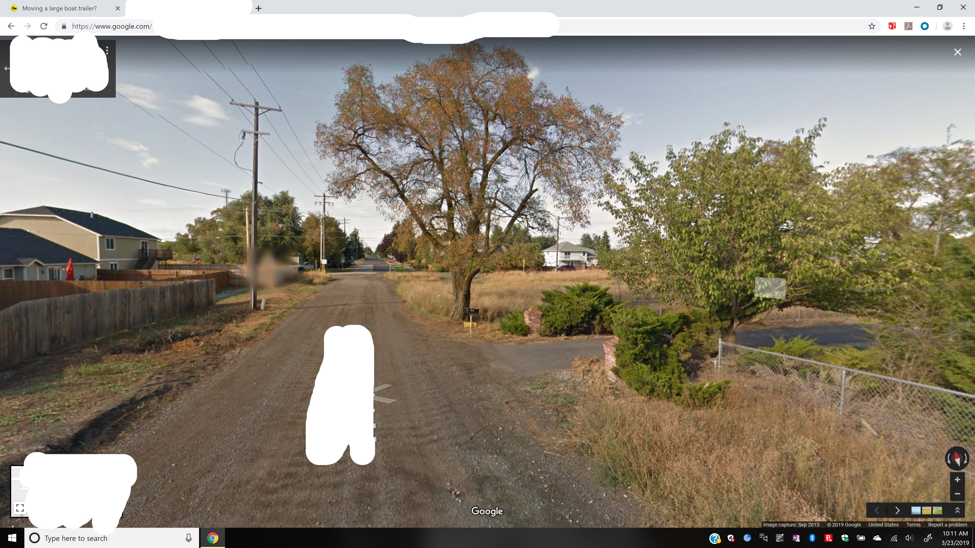

I have a BX23s and am in the process of a getting a 24ft boat - total weight of trailer and boat is about 6500lbs. I know many here can thread a needle with their truck/trailer, but the dilemma I have is a 24 foot wide dirt road at a 90 degree right before my driveway and my driveway which has two pillars on either side that are extremely narrow. I have no problems getting this with a 16ft trailer, but the additional 10ft of trailer is going to be daunting at best. The grade is flat.
The question - I know the towing capacity of the BX23s is limited - especially compared to the 6500lbs boat/trailer, but all I need it to do is make the turn. Once there, I can hook the truck back up and complete the travel down the driveway. The other option is to get a Trailer Valet vs a ParkIt360, but those options are several hundred more and since I have the tractor - why not use it if I can.

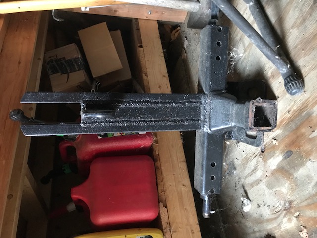

the dirt road is compacted and the driveway is asphalt going into concrete. The tongue weight is supposed to be about 750lbs. Though hopefully, the weight will be well balanced since it is a tandem trailer. I was thinking of this as an add-on - Quick-On Receiver Hitch

this is a way old picture from 2013 from Google Maps - told ya the pillars were ugly. The tree and junipers are gone. thanks for all the awesome replies. So far, it seems using the tractor is not a terrible idea. I have every intention of taking it slow.
Looks to me like you have plenty of room across the entrance of your driveway. The other side of the road is wide open. With half way decent towing mirrors on your truck, I can't see this being an issue at all. And that's assuming you have to back it 90 degrees into the driveway (as opposed to a "pull through" type drive).
I would call this a non-event, and just use the truck.

If it was me, I’d remove those pillars and clean up the entrance. Then you should be able to get in and out without the hassle.

Sadly, the other side of the road is no longer wide open. the google image is from 2013 and a lot of undergrowth has taken over. there are a ton of hedges now in the way.
I certainly could be making a mountain out of mole hill. I am not inexperienced when trailering though I like to over prepare. A 20ft truck plus 26ft boat/trailer on a 24ft wide can still be intimidating. What I didn't want to happen is get the boat home have trouble threading the trailer and end up with hedges all over the truck. If anything, having a back-up option in that event would be awesome. I agree with the trailer mirrors though. Another thought I had was either backup cameras or a go pro. An awesome spotter would also do the trick, but my wife has never trailered or really even driven a truck. Also, getting rid of the pillars would make this even easier. thanks for the input - I will be giving it a shot with the truck for sure.

You could but I would want to make sure the loader will lift the tongue safely before you alter anything.
Point well taken. I think what I am going to do is get the hitch adapter from Bxpanded - take slowpoke slim's advice and try to work it with the truck. If this fails - then at least get the corner taken care of. And lastly, get rid of the pillars. For $89 for the adapter and with several trailers, it will get it's use:) If that fails, I will try the front-loader approach.

I built one of these, it's nice to be able to lift tongues up an down.
