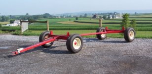

Can you do this after hours and go slow? Do you know any farmers? If so go talk to a farmer about renting running gear for a wagon from him for a day or two. You can't go fast but it'll get the job done. Lots of farms have spare gear so it shouldn't be hard to find. I've even seen them used for sale for cheap. They don't have brakes and are only designed for slow speeds but they are rugged so they will have no problem going up a trail.
