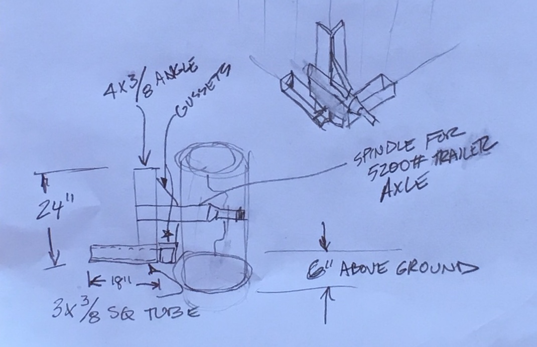

Yes Sodo, I know my trusty Henry can do the job, but I'm looking for some plans (i.e., drawings w/ dimensions) to build corner post wheels.

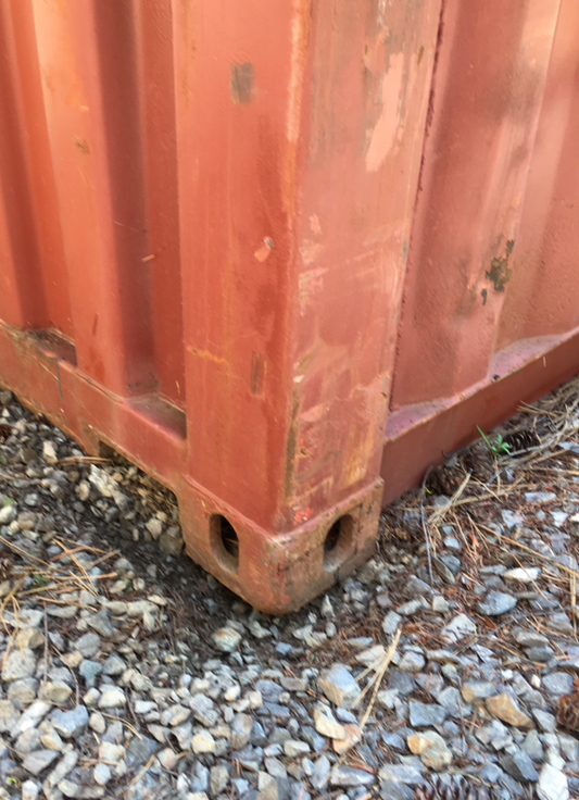

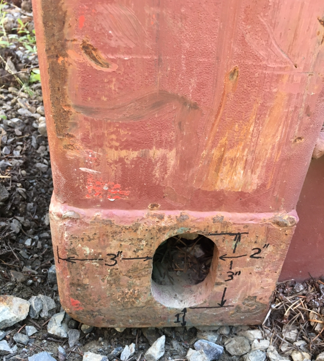

Heres some scribbling.
You make 2 lefthand and 2 righthand.
Note they can install BOTH long way and short way so you can re-mount the other way and shove the container sideways.
Or even pivot.

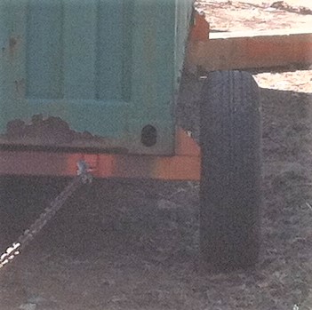

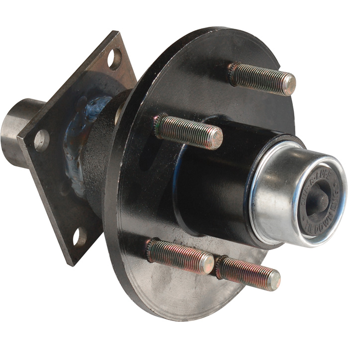

Sorry I can't give you dimensioned drawings. I attached a couple of photos.
I bought the trailer hubs from Northern tool. I did weld a piece of plate to the inboard stub end the of the axle to give it some support where it inserted into the 3.5 x 3.5 tube steel. The part that bolts to the container is just a 4 x 4 gusseted clip angle. You just need to measure any container to come up with the width of where the clip angle welds to the axle beam make sure you add 3/8 or so. That way the assembly will sip on easier. I welded A couple of D rings to the axle beam to connect the pulling chain bridle.
