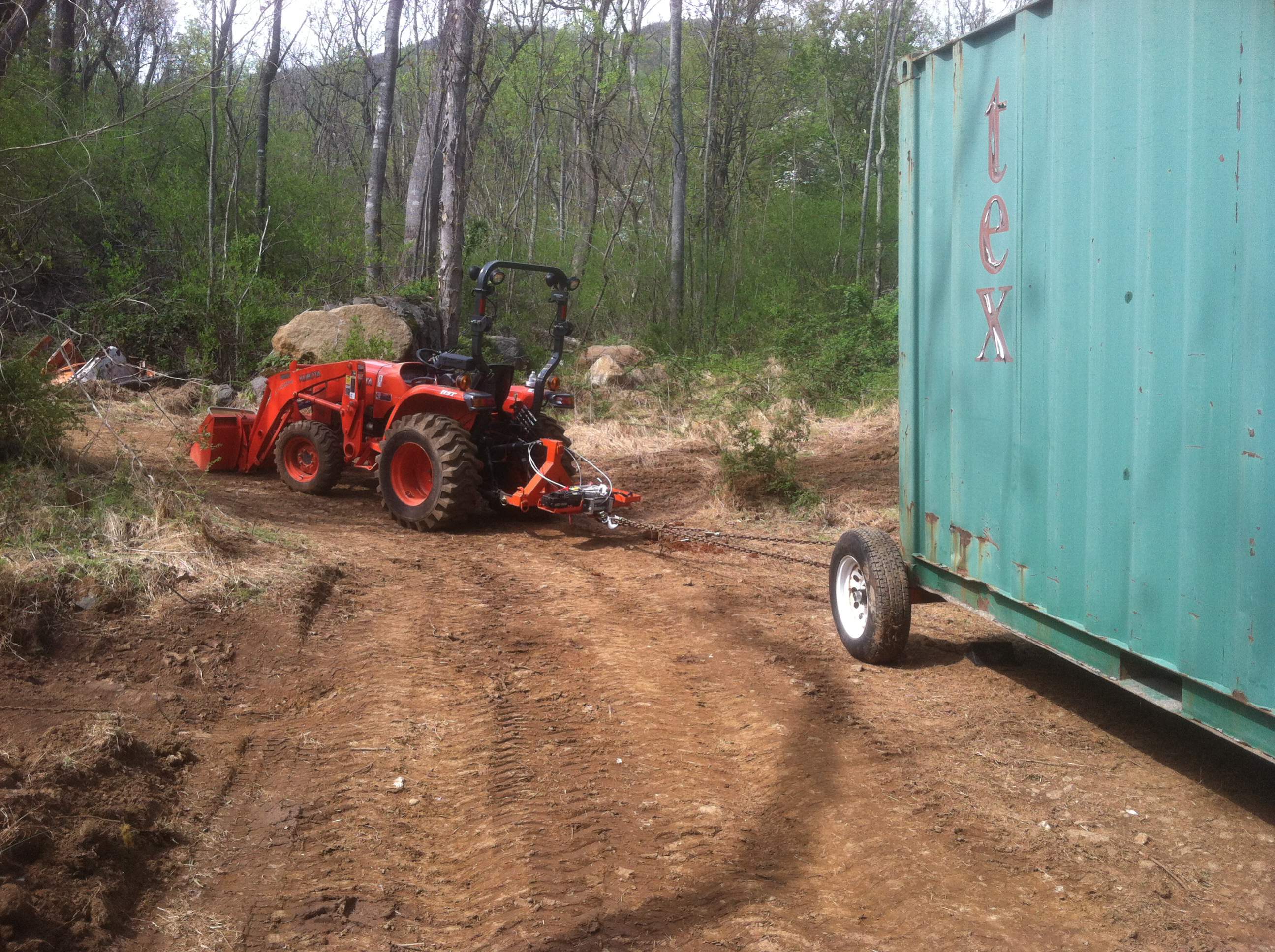

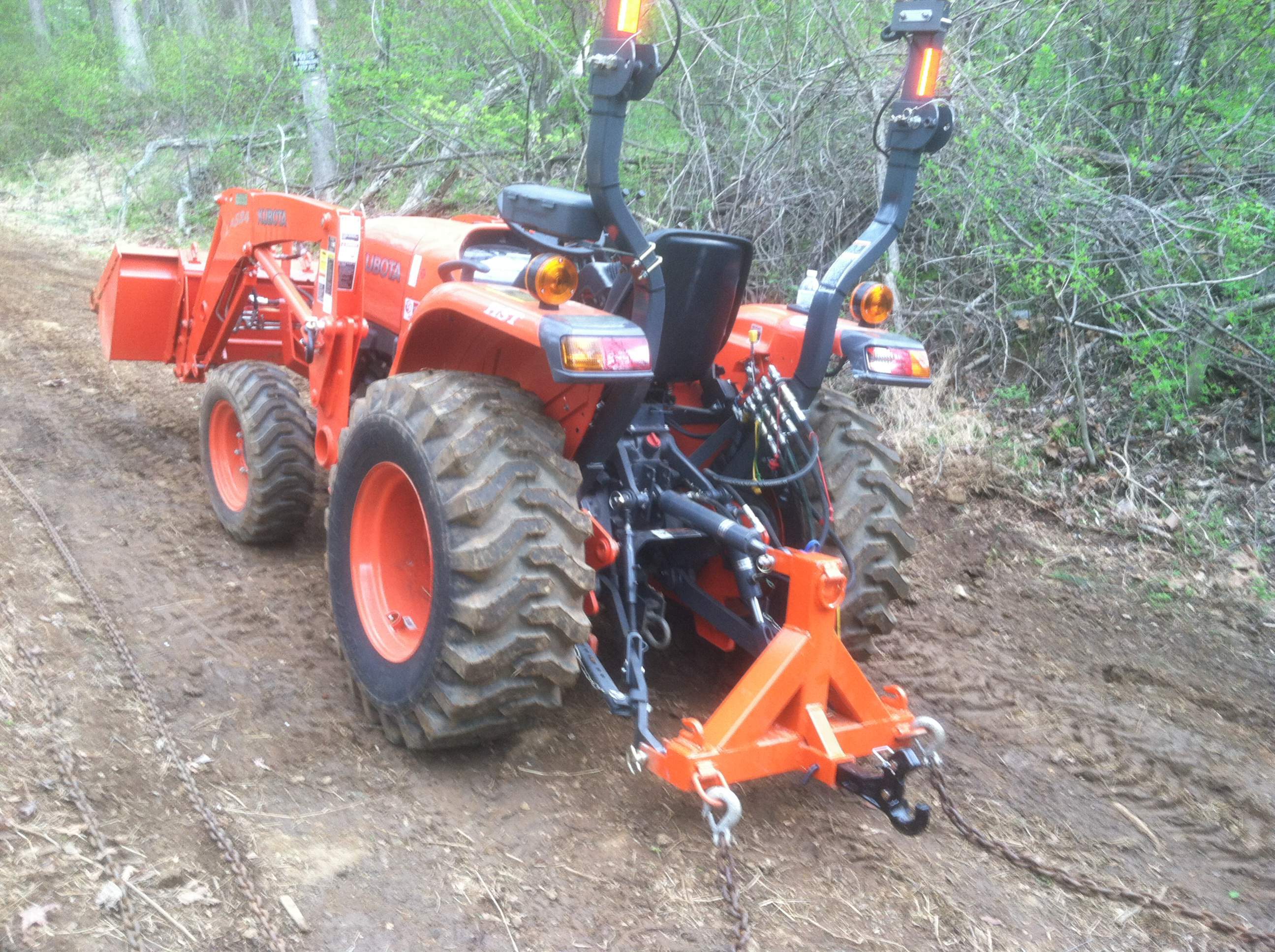

The next one I no longer had the loader dozer on site and built some axles that bolted to the container corner pockets, and winched it up the access road.
View attachment 450284View attachment 450285View attachment 450286
I need to move a 40 ft. container with a Ford 4000 (3 cyl. diesel). Can you turn "gentle" corners with your "four corners straight wheels" design and can you post a drawing with dimensions of your design (...because I hate to redesign the wheel and it looks like you are turning quite a sharp left turn in your 3rd pic! Lol)?
BTW, I would have posted some similar online versions of shipping container corner wheels and I have found (all without dimensions) but can't seem to find any way to post them from this 'droid. :-(
   / Move 20ft ocean container on car trailer
#90
Weight of 40ft is 8800 lbs. so each corner wheel has to be built for half (4400 lbs) which is easy for a non-hwy device.
Common road-going axles like a car trailer can be 5200/axle 2600/wheel at a low level.
4400 is easily doable for your project.
If you have to scrub the tires around a turn can you shovel a few inches of pea gravel in the tire path?
Or jack it up on 2 blocks in the center and pivot at container center, which topples the blocks but maybe you have to do it a couple times.
